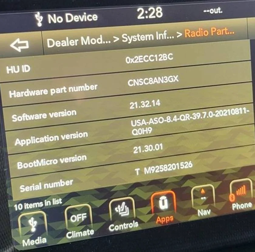

Hold the short cuts on the bottom left and right. As seen below until screen changes and you will get into "Dealer Mode".
In this mode, you want to get into the Radio Information.
You will see a very similar screen below.
In the "Application Version", you see USA-.......39.7.0-......
That "39.7" is the Application version.

Everything was going fine with a few mins to go and I opened the door to check progress like a bonehead. Of course this caused the power to turn off. Luckily everything still seems to work. However, the SW version is still showing 22 on the dealer page, but when I put the USB drive back in the port, it says same version 40.
Scratching my head a bit on this one. Wondering if it just needs time to update the SW version in the dealer page… that’s a hope, more than an expectation. Just curious if you might have some insights into an interrupted update like this. Appreciate it.

.... Luckily everything still seems to work. However, the SW version is still showing 22 on the dealer page, but when I put the USB drive back in the port, it says same version 40.
This is why I kept the engine running to prevent something like this from happening.
Post up the screen. Are you reading your version number correct?

Yeah, I was thinking that right as I grabbed the handle. I’ll take a pic of the dealer screen and post it.

Okay, it’s late and I’m stupid. It did update. I was looking at the SW version instead of the application version. App version indicates 40.

You will get a directory named: "\VP4R_Update\" with bunch of files inside.
Format a good functioning USB drive with enough space to Fat32.
*This is done by right clicking on the USB drive then selecting "Format". If you don't know how to do this. Then you should look it up on Google How to format USB drive to Fat32. MAKE SURE YOU DON'T FORMAT YOUR HARD DRIVE.
I personally used Sandisk 16gb USB 3.0 capable drive.
https://a.co/d/bsWqDfp
Move "\VP4R_Update\" and all of its contents into root of the USB drive.
Plug the USB drive into the dash USB A port.
I started my vehicle and kept it running as I wanted to have stable battery voltage during the entire update process.
And you will get a prompt asking if you want to upgrade. Proceed through that prompt and you will get the following timer. Let the timer expire. You can see where I plugged in the USB drive.
Once timer runs out, you will get the following screen.
While the count down stated 30 plus minutes, mine took about 25min.
And the unit will reset on its own and the first screen will tell you that the update present in the USB drive is the same as the current one. This means you successfully upgraded your HU.
You can reaccess the dealer mode and check "Radio" information and you shall see the following screen. You can see the Application Version is now 40.1.
*IT IS POSSIBLE THAT YOU MAY NOT SEE ALL YOUR APPS RIGHT WAY. I READ PEOPLE REPORTING THEIR APPS BACK ALMOST 24 HOURS LATER and also having to reset all their settings again. Having said that, all the apps were present immediately for me.
Impression:
I started researching into this upgrade because my parking guideline and TrailCam were functioning intermittently. The issue turned out to be because I did not seat CVPM CAN IHS connector all the way down.
Nonetheless, the upgrade made the entire interface feel more fluent and faster. Navigation loads within a few of seconds and offroad page loads faster too. Definitely an upgrade.
GOOD LUCK!
*YOU DO THIS UPGRADE AT YOUR OWN RISK. I AM MERELY SHARING MY EXPERIENCE. YOUR MILEAGE MAY VARY.
Good luck!

I dont think I could get it to work mine is software version 21.18.14
Boot micro 21.13.01

Worked for me. I was able to upgrade from 34.2 Seems like my Off Road pages shortcut shows up in the dock much faster now.
Boot micro 21.13.01
Check your Application Version as written on the 1st page.
I spent a lot of time writing it up so that every step is spelled out like a cook book. Hated reading through all the posts for hours trying to figure out what the hell needed to happen, no one needs to go through that again.
I started with this version.
