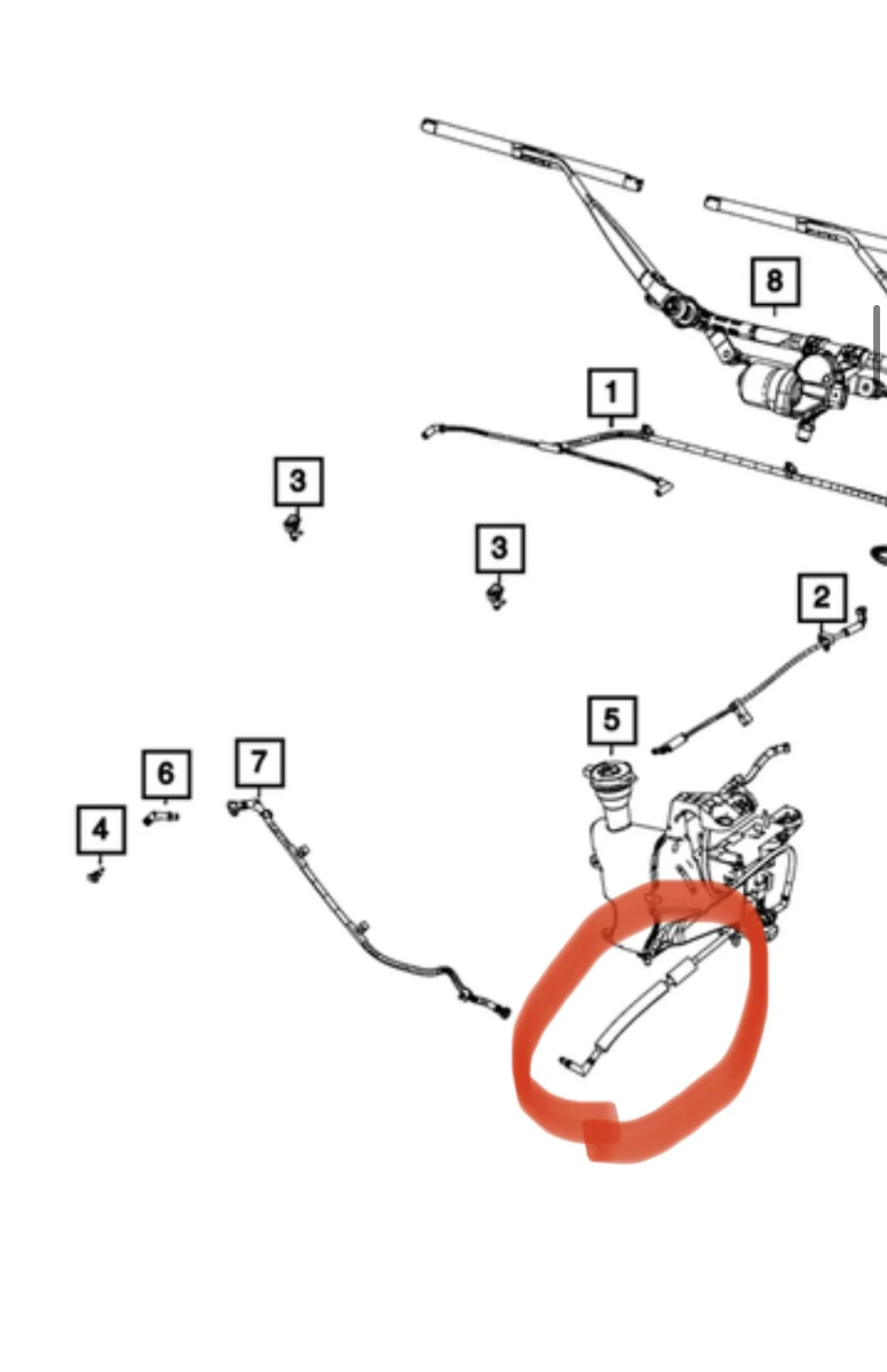

So I have all the parts ready to go. The one question I do have is about the washer hose section I have highlighted. I have hose 7 from the diagram, but is the section in red already there or another part that needs to be purchased. Hose 7 does not connect to the pump, so trying to figure out where/what it attaches to on the reservoir side.
It goes to part 7 it pushes in as you squeeze 7 connector.
