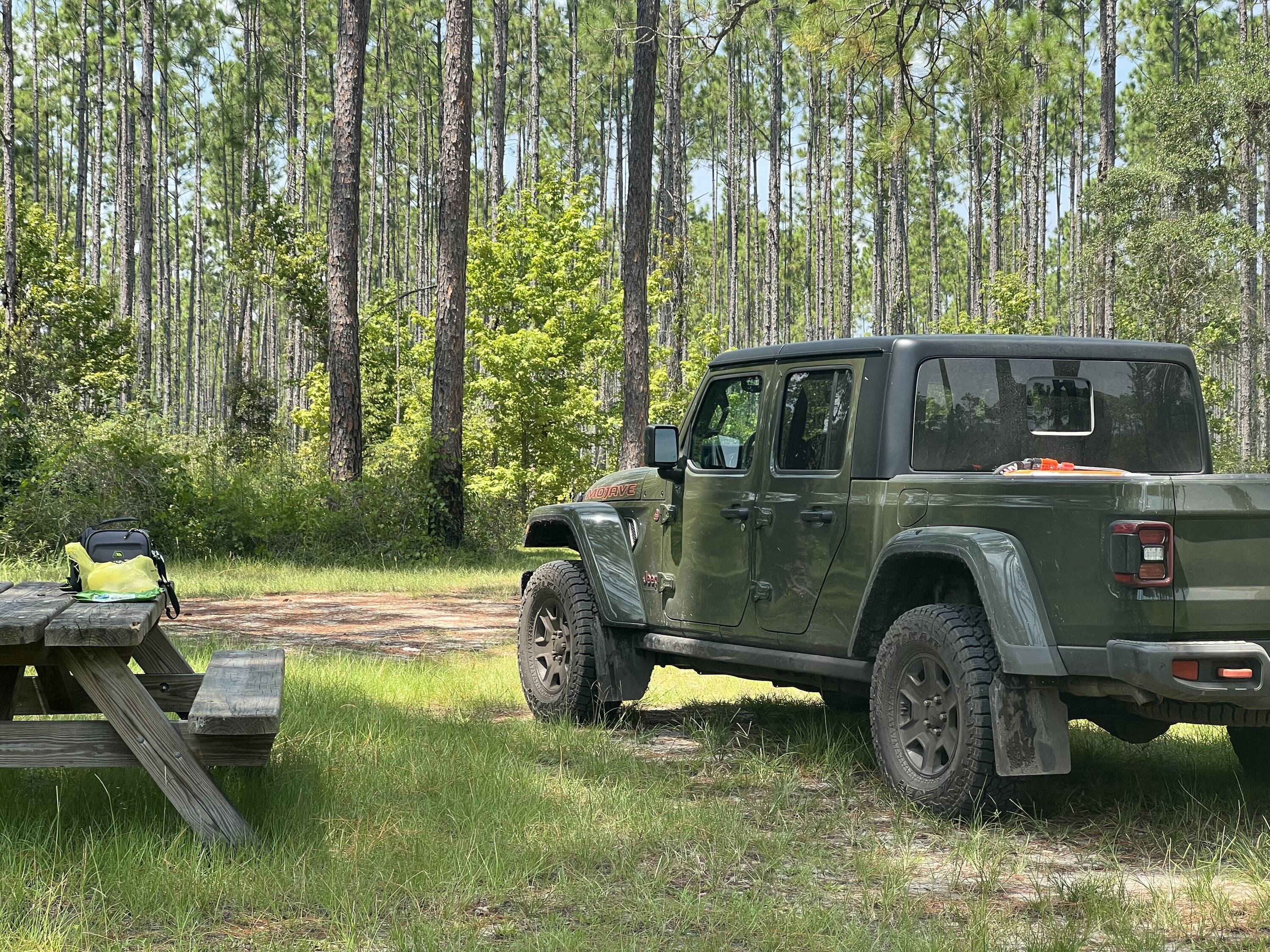

Noob here. Just took my stock Mojave through some bumpy roads on a trip to Apalachicola National Forest/Tate’s Hell State Forest and hit a few bumps quite hard. I think I even might have bottomed out the left jounce bump stop at one point at a higher speed than I should have been going, and the rear axle was definitely briefly submerged in a big muddy puddle as well. The truck easily tanked through everything I threw at it but…
I want to get more into servicing my own vehicle and making sure nothing is loose down there, even though I haven’t noticed any odd sounds or anything unusual in my (very inexperienced) post-wheeling inspection.
What spec torque wrench should I get to accomplish this? 10-150 ft-lb? And is there a definitive source/easily accessible service manual with pictures and torque specs? I don’t have a jack stand or trolley jack aside from the provided jack for tire changes - would I be okay doing this without jacking the vehicle up? Or am I just in over my head and should just take it to a shop to be inspected and torqued?
Thanks for the help and input. Really excited to be a part of and contribute more to this community.

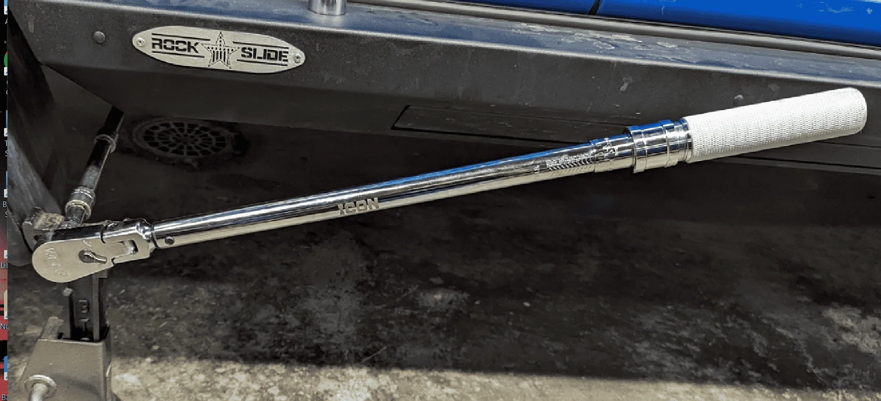

For the lower control arms - this is my go-to torque wrench - ICON, It's proven quite accurate.

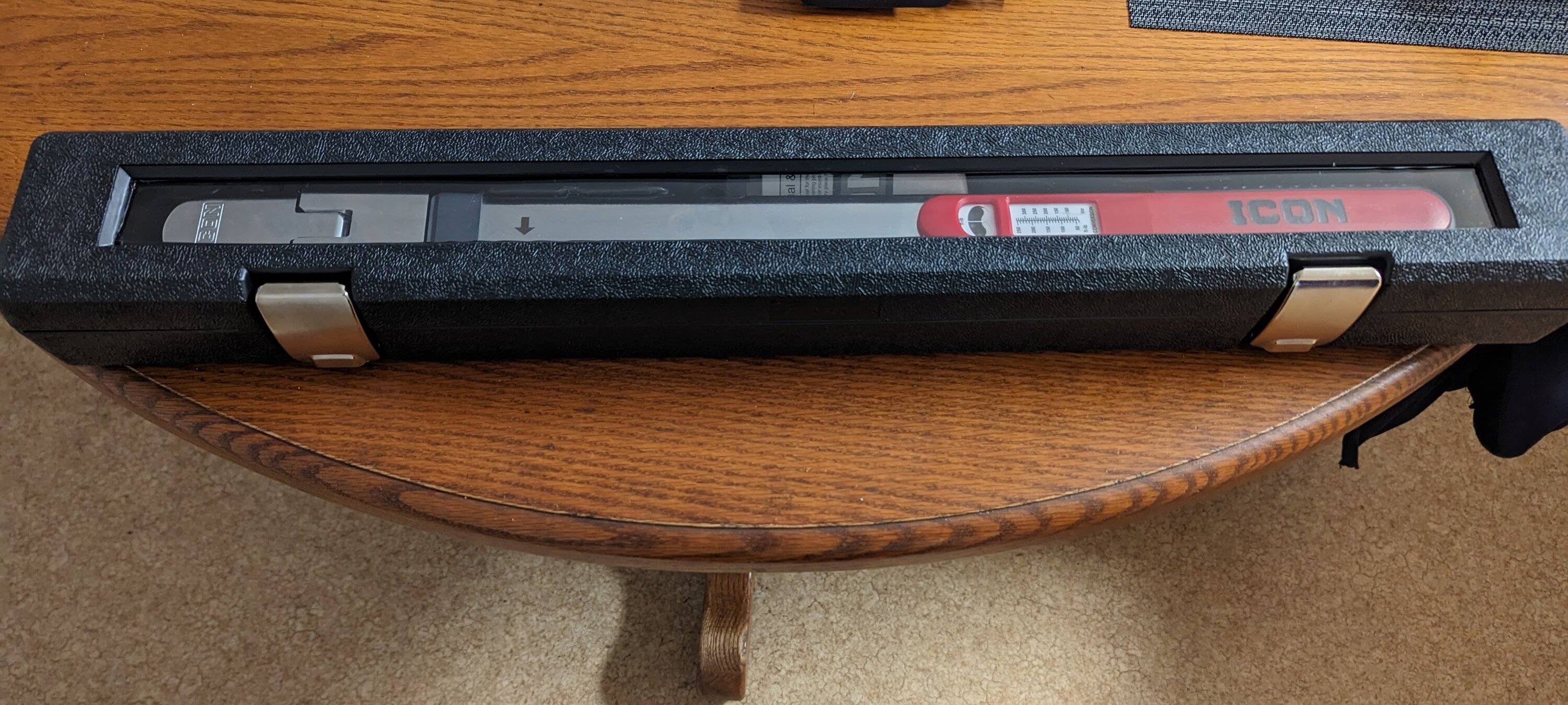

Great idea on the jack stand support for extension. May have to try that. I just snagged this icon to attempt to get my LCA's to torque spec. All I had was the Pittsburg wrench.
