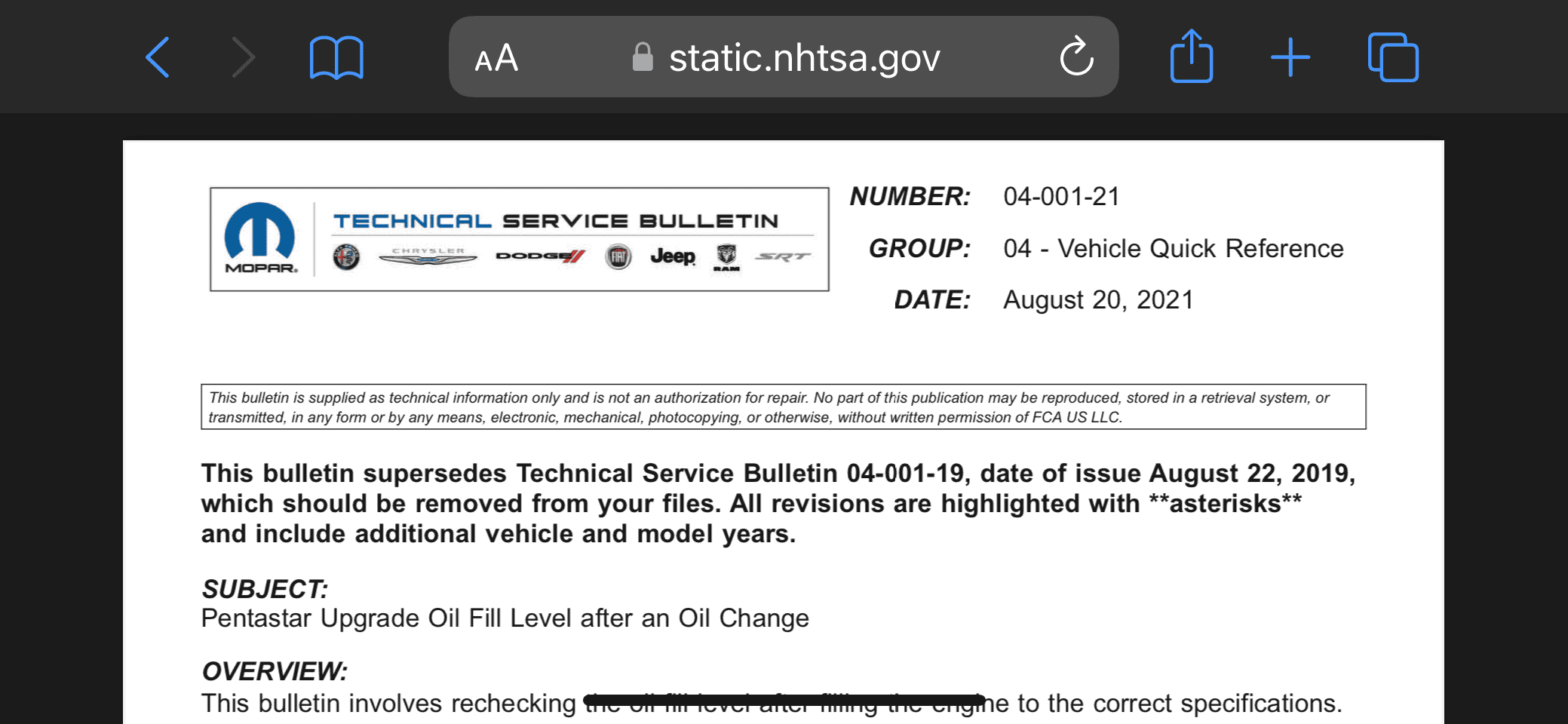

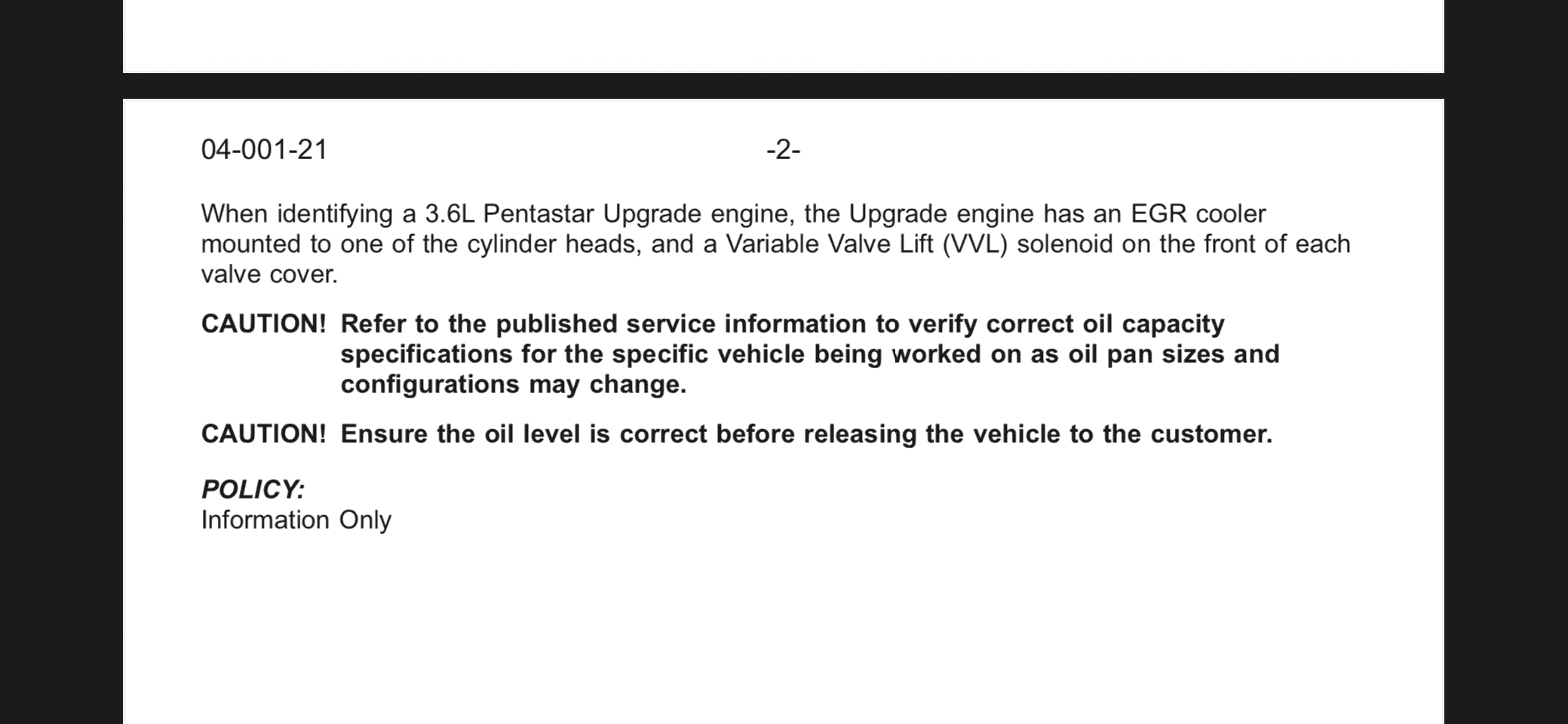

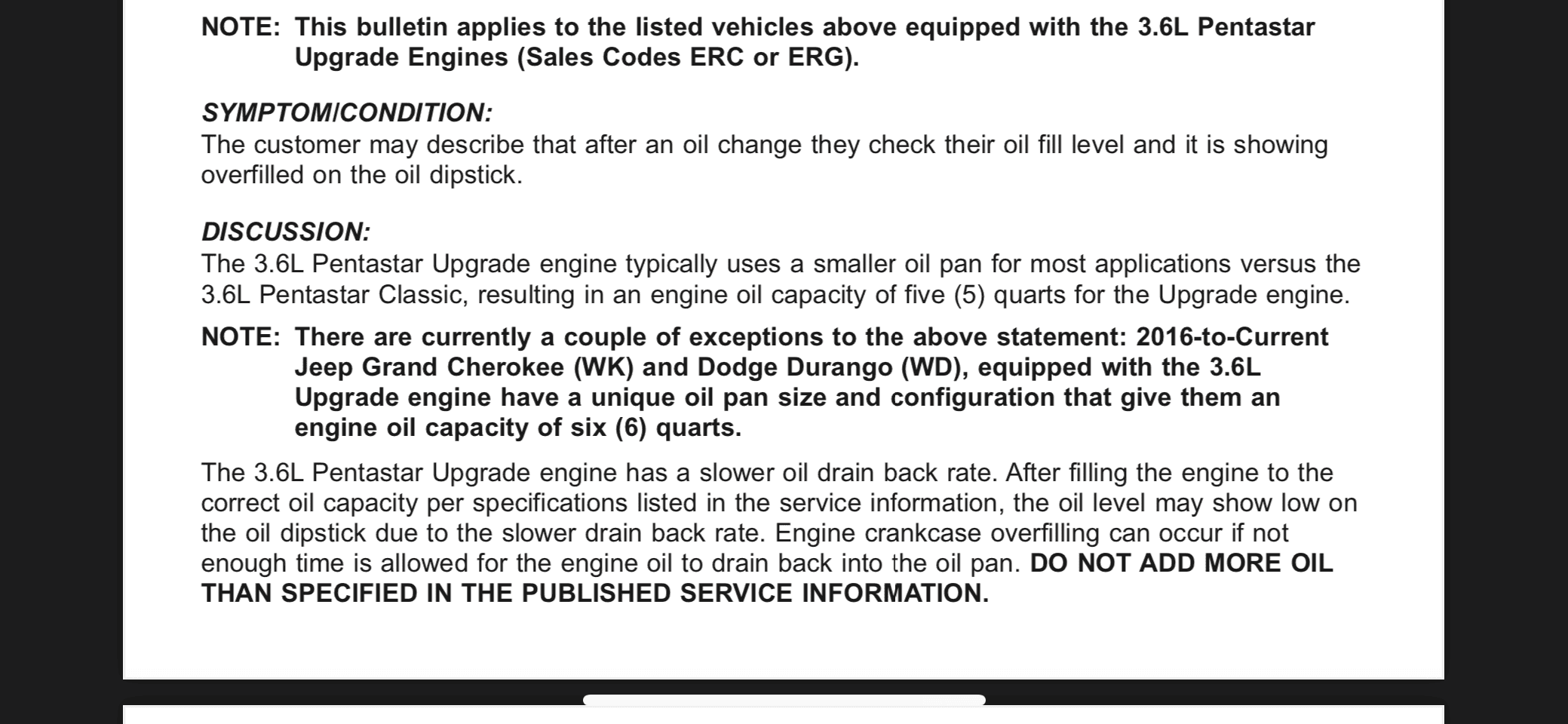

Several mistakes happened.
1. the crate engine came with 6 L in it. My understanding is that engines that are shipped do not have oil in them and this one already came overfilled by 1 L.
2. the tech assumed it came empty and didn’t look.
3. the tech put in 6 L when it should have been 5. There’s a TSB on engines that take 6 vs 5 (and yes, @ShadowsPapa, the FCA TSB list shows there is an “upgraded 3.6 engine” just read it the other day, I’ll find it again and post it here.)
4. I trusted everything was done right when I picked it up and I didn’t check. I was blinded by having a new engine and tranny and I had a trip to BC to make right away. 7.5 months down with my truck and I finally got it back….
