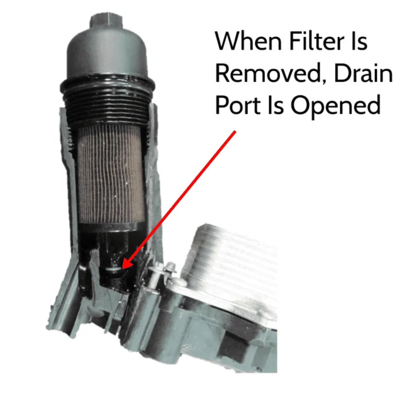

Out of curiosity, do you not crack the oil filler cap prior to draining? I’ve always been taught that will help oil drain quicker.

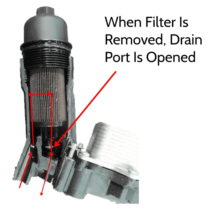

I’m sorry, but I’m struggling to follow.
Remove cap, lift filter, the filter housing drains back so you don't have a mess.
Me - remove cap, lift filter, drain pan, that way the filter housing drains into the pan.
If you drain the pan and put the plug back in, then remove the cap and change the filter, you can drop dirty oil back into the engine.
Right. Understood on that. So you’re saying pull off the filler cap, and then crack the filter to drain with the rest of the oil. That makes sense.

In the video I emptied the oil first, then replaced the filter while the drain plug was still open. This accomplishes the same. But yes, you don't want to seal the drain plug and then change the filter as that would retain dirty oil in the system.
It's a recommendation to do that, I do some of the time as a reminder too.
