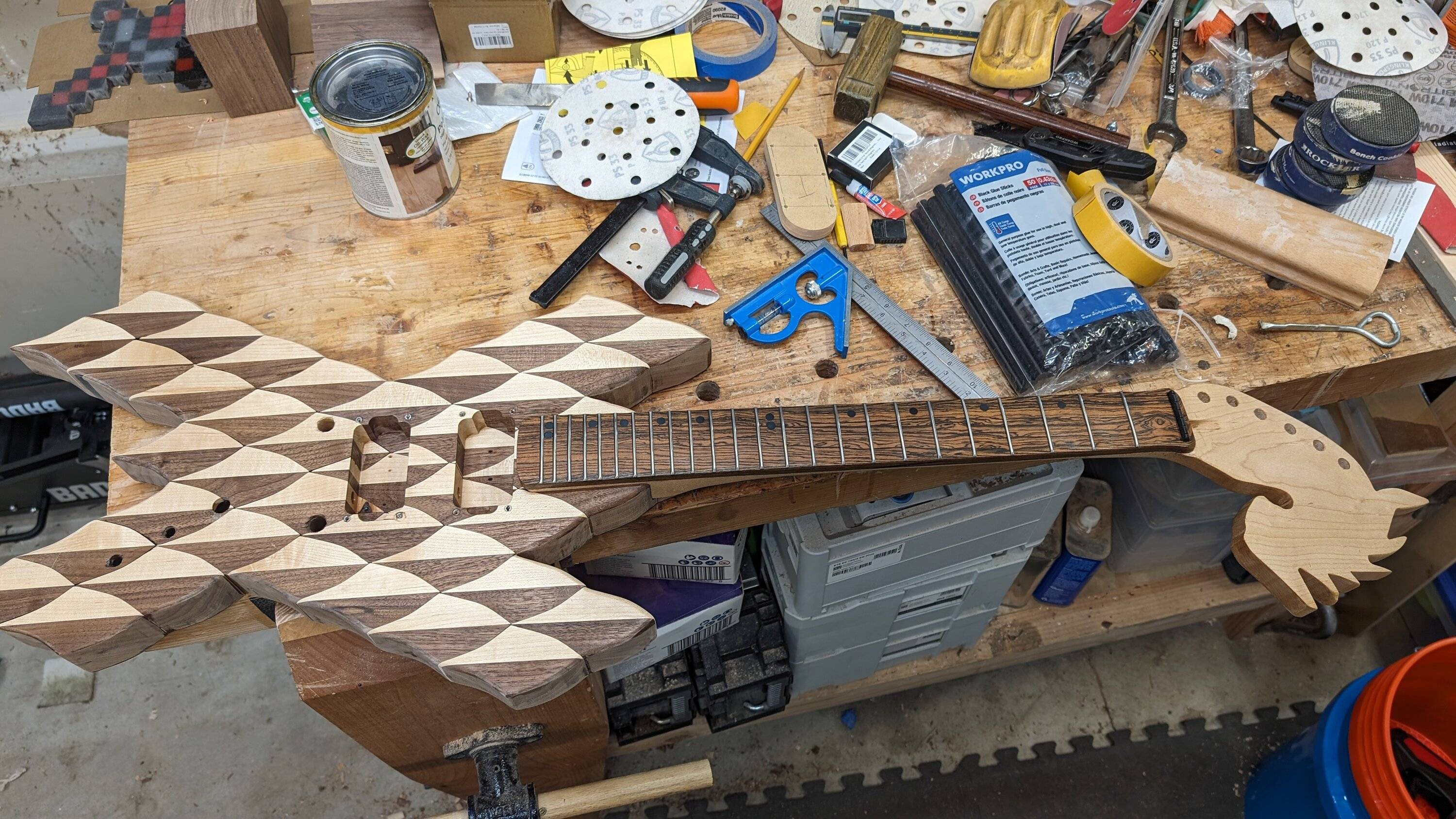

Current project I am finishing up as the garage warms up.
Nice work. I dig the body design. What kind of wood is the neck?
I now do not feel so bad about my bench getting to messy.
I now do not feel so bad about my wrench getting to messy.
Fretboard is bocote and maple is the body of it. Next step will be learning to play a guitar.
