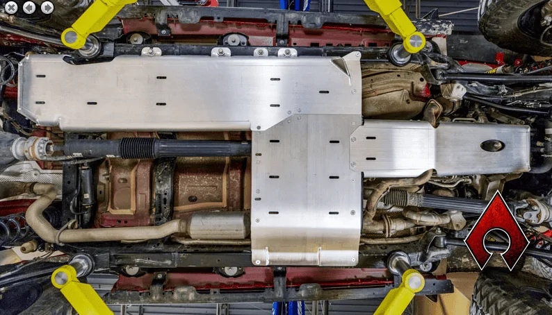

Artec is offering this JT Gladiator Full Bellypan
1/4" 6061 Aluminum for skid plates, 3/16" zinc plated steel brackets - 90 lbs.

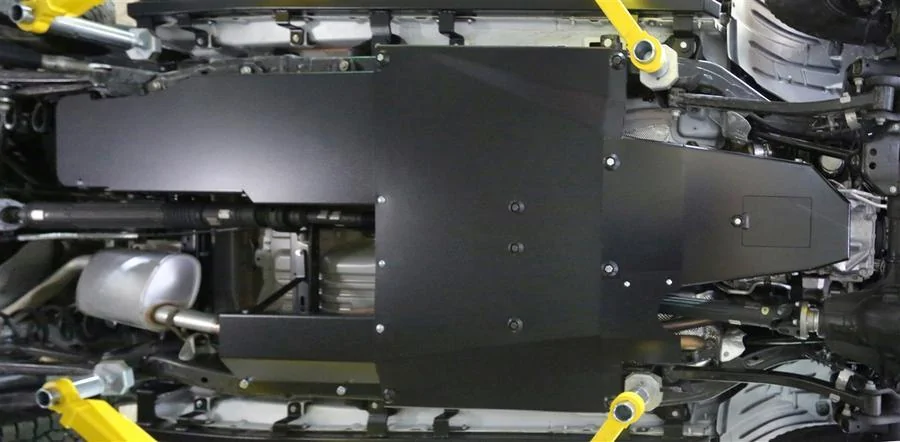

Rock Hard offers this ÂĽ" thick powder coated aluminum Skid Plate system with a separate piece over the Resonator:
https://www.rockhard4x4.com/product_p/rh-80548.htm
Their stated weight is 190 lbs. which doesn't compute even if it includes packaging and the steel cross members...

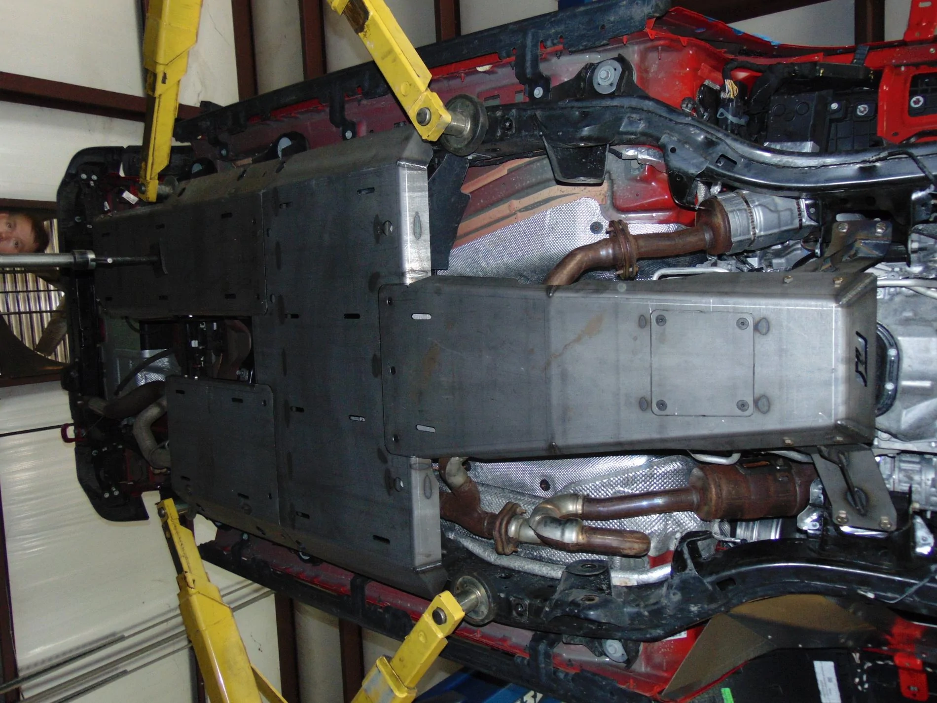

Motobilt Skid System
3/16" thick steel plate, 4-piece design - their page shows this ships in 2 boxes with total weight of 207 lbs.

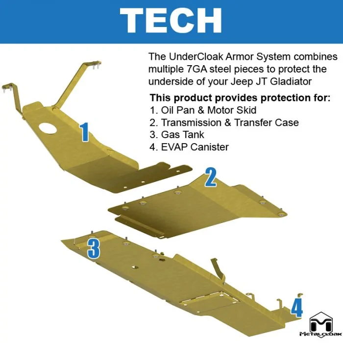

There is metal cloak’s;
Jeep Gladiator Aftermarket SKID PLATE options tech-jt-undercloak1
I don’t see any weight specs, 7 gauge steel though.
