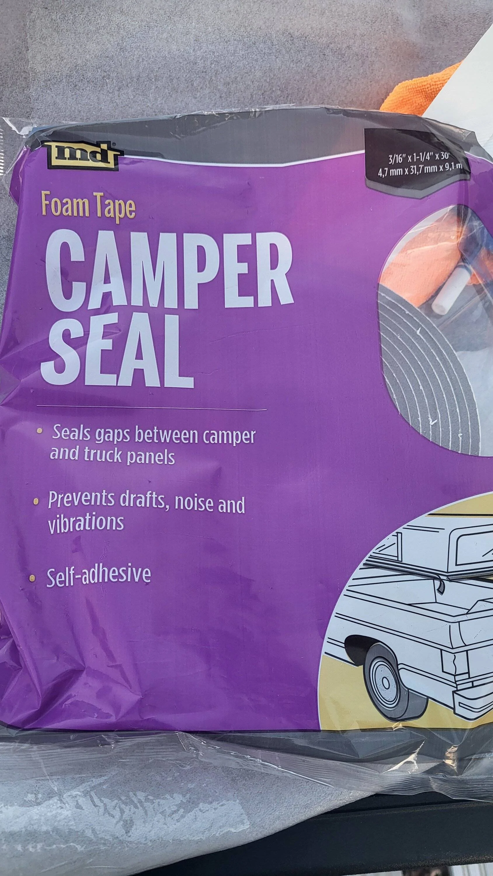

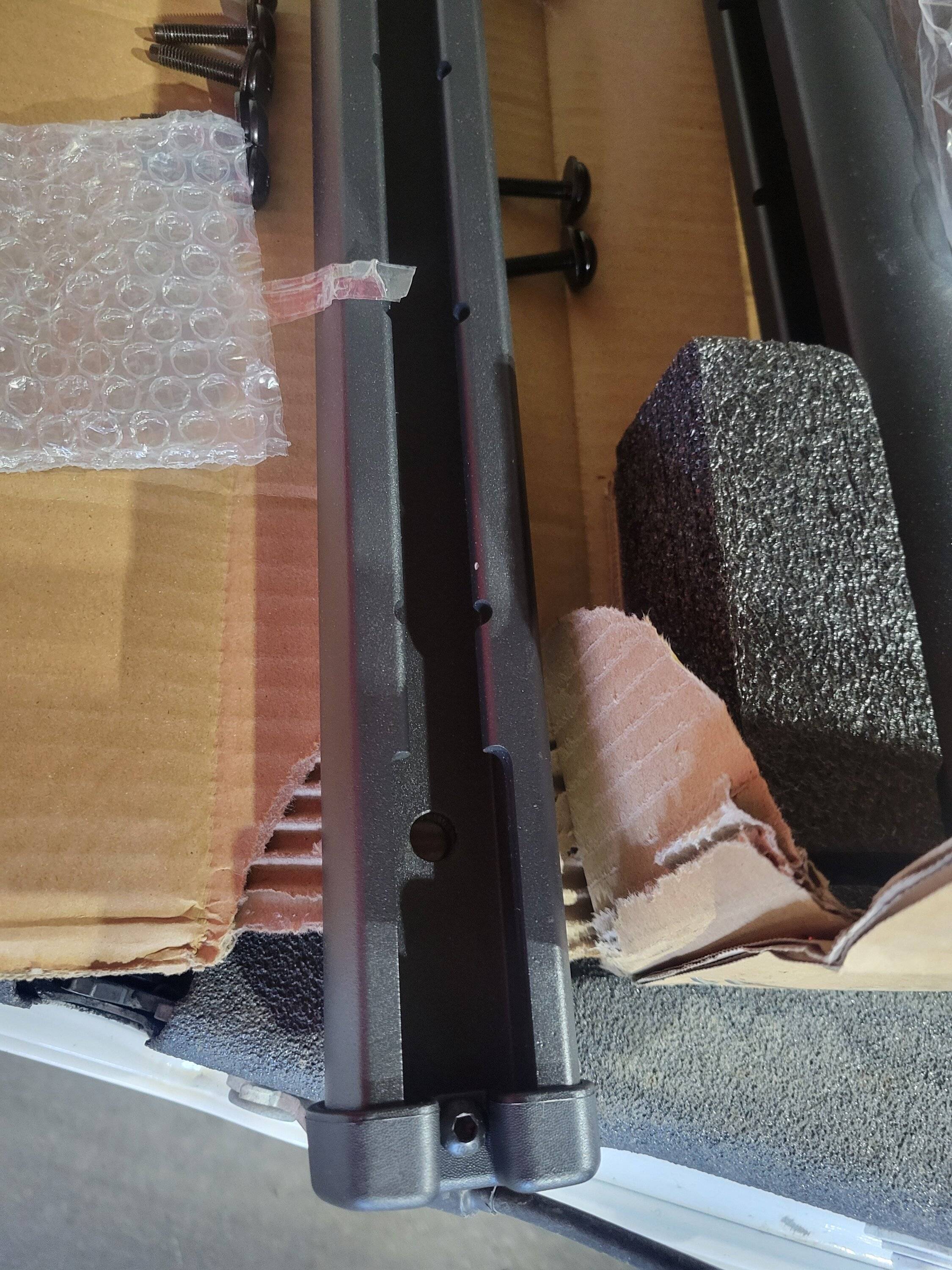

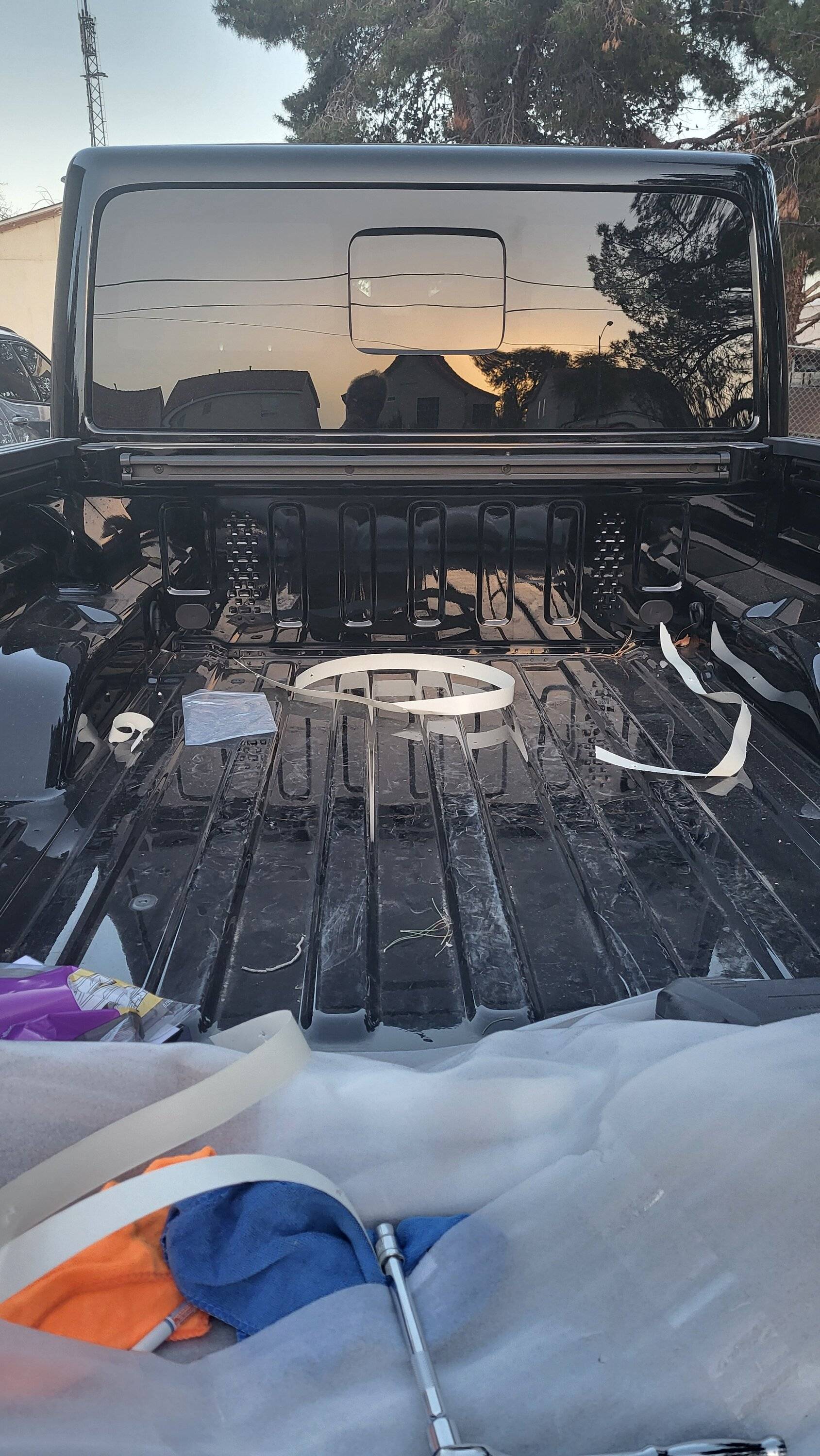

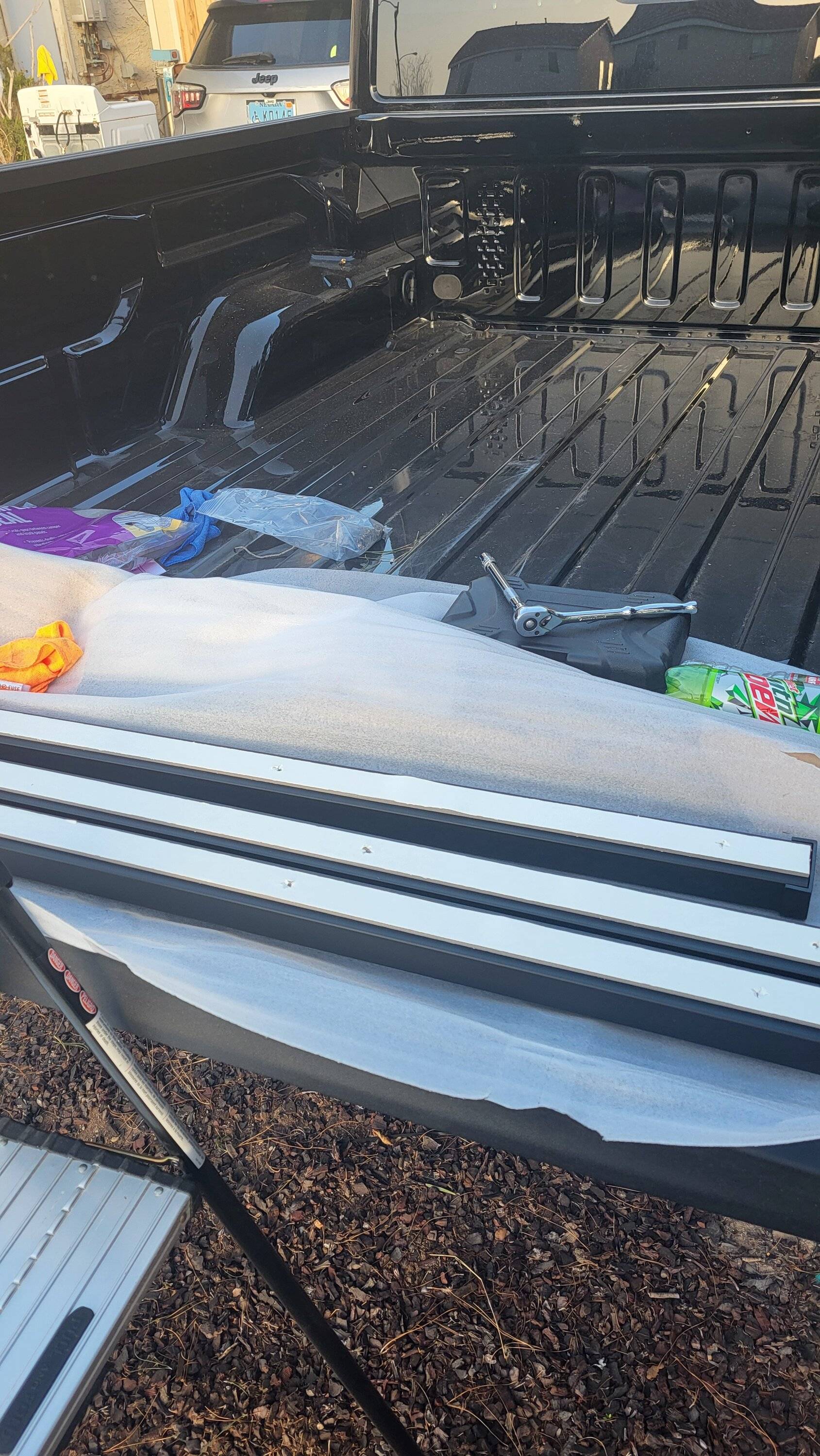

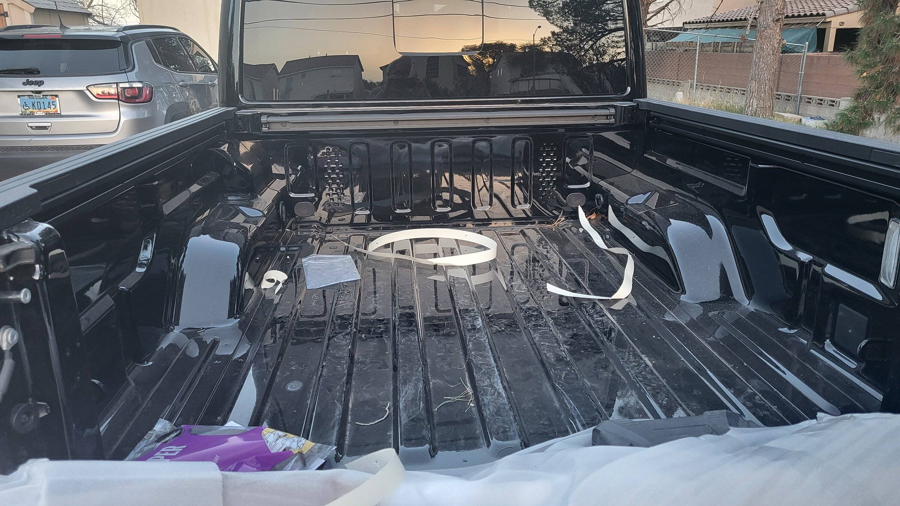

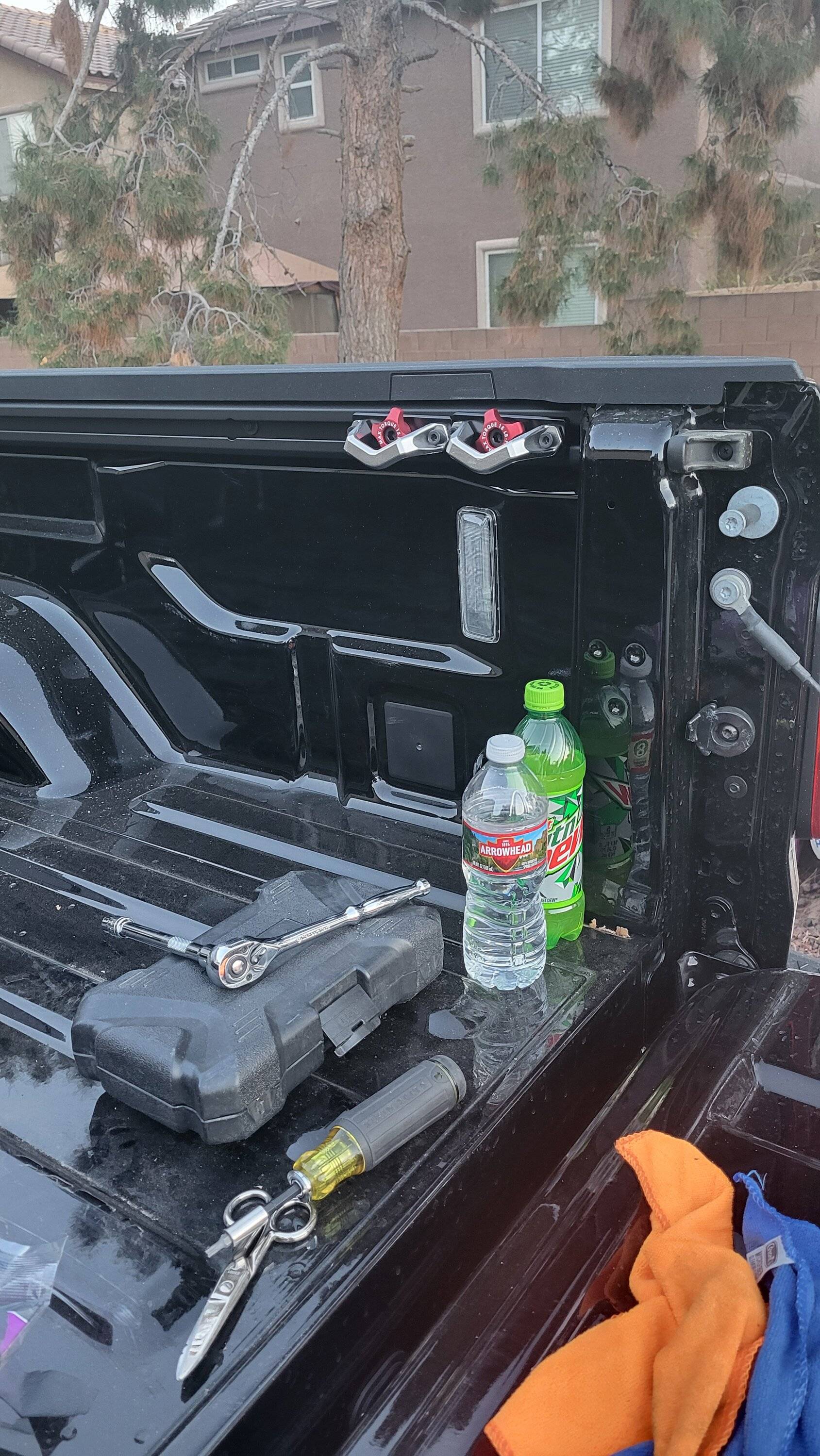

I installed them this afternoon. They went on real easy. I can't tell the difference between the Teraflex and Mopar Rails. I picked up a roll of camper seal foam tape at Lowes, since I'll need it when I put the cap back on. Since I don't have a bed liner, I put a strip down the back of each rail. I pushed the bolts through the holes and the tape held them in place and made the install very easy. I used a micro fiber cloth to remove the dust and pollen before putting them on. They send blue thread locker to use for the end caps on the rails. I didn't put any on the two front caps, since those have to come off to get the clamps in for the RSI Smartcap.

Looks great!
You said you used the foam tape because you don't have a bed liner. Why would that make a difference? Would you not use the foam tape if you had a bed liner?
Let me know how the SmartCap clamps work.
Thanks!

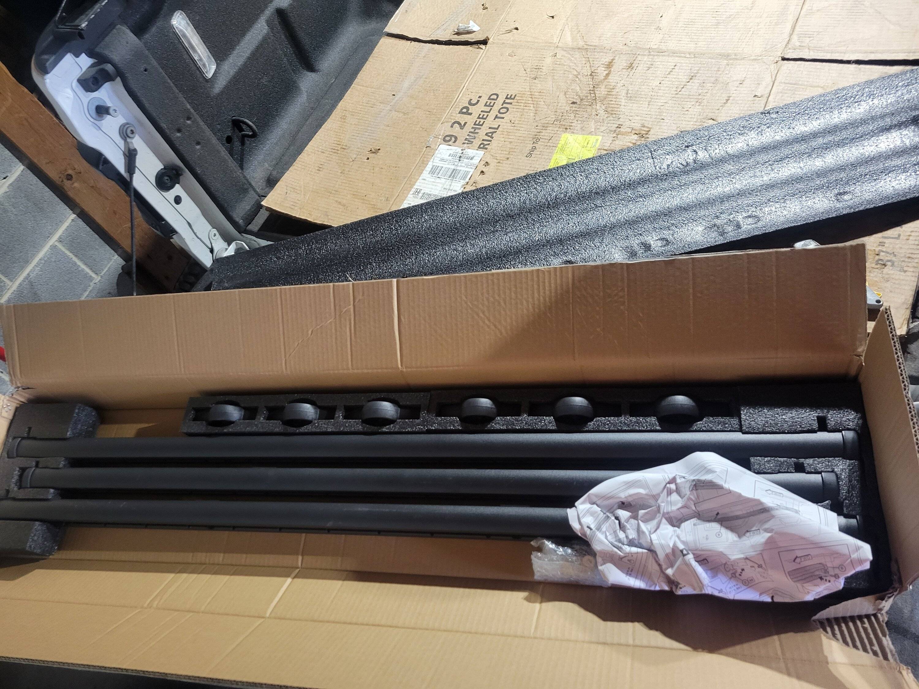

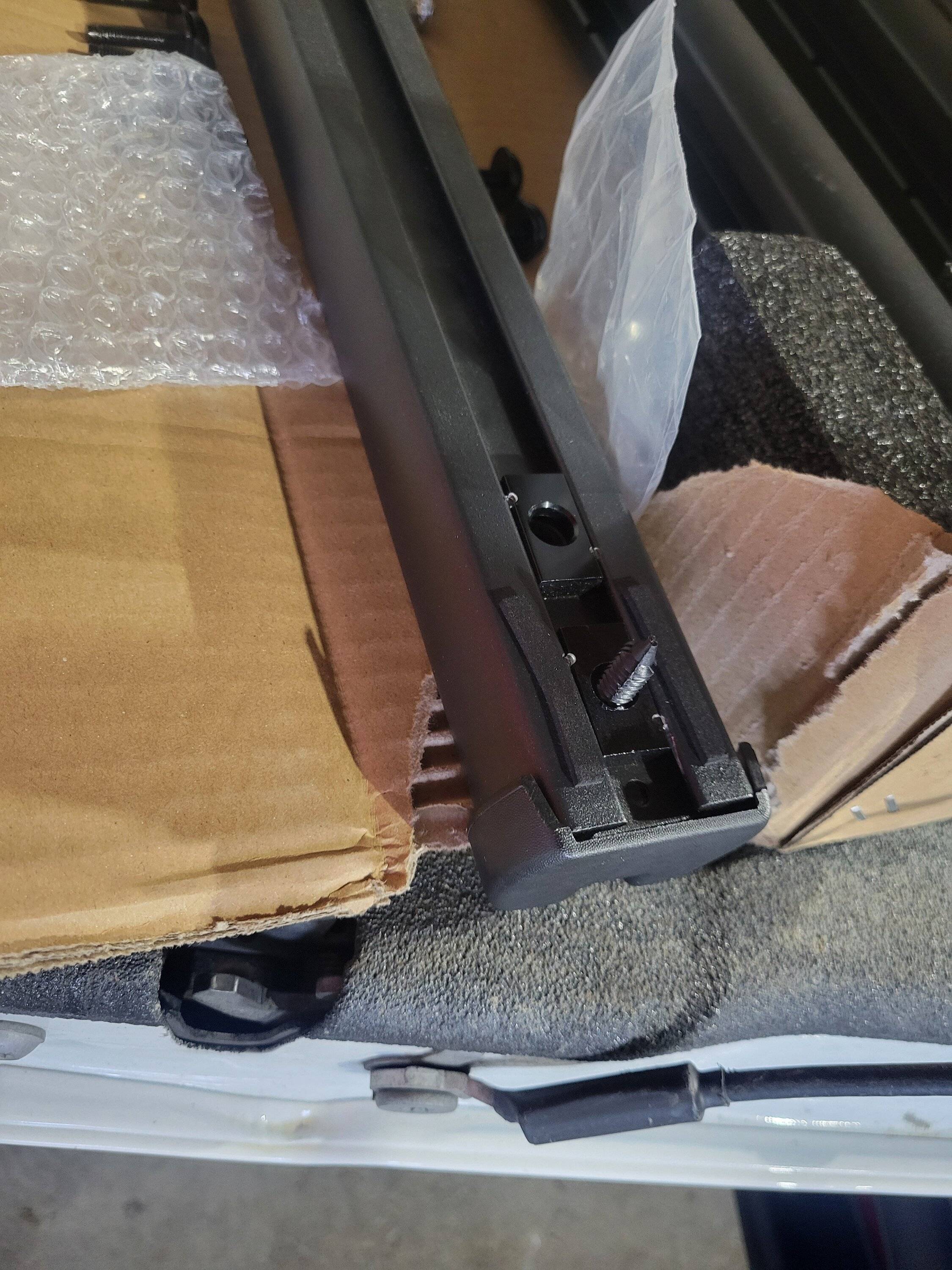

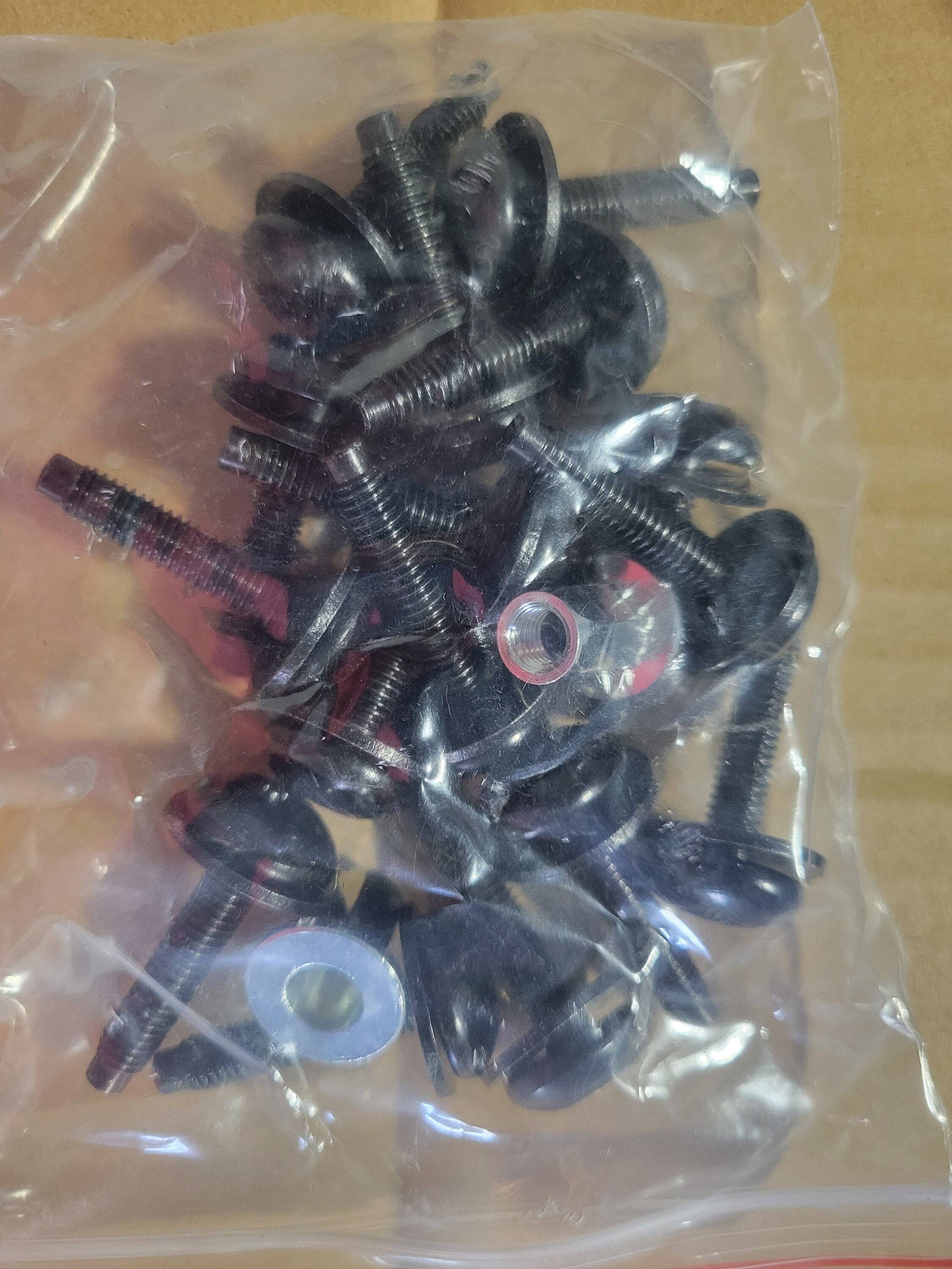

So....I got to open the box! The product looks great. All the pieces are there, finish seems decent, anchors are pretty nice. I was able to get the front rail on without issue. Torqued down and all. Ran a tap through the bed holes just to insure no bedliner in the way. They install a few pieces of foam on top and bottom of the rail centered over the bolt holes.......now, the fun part!

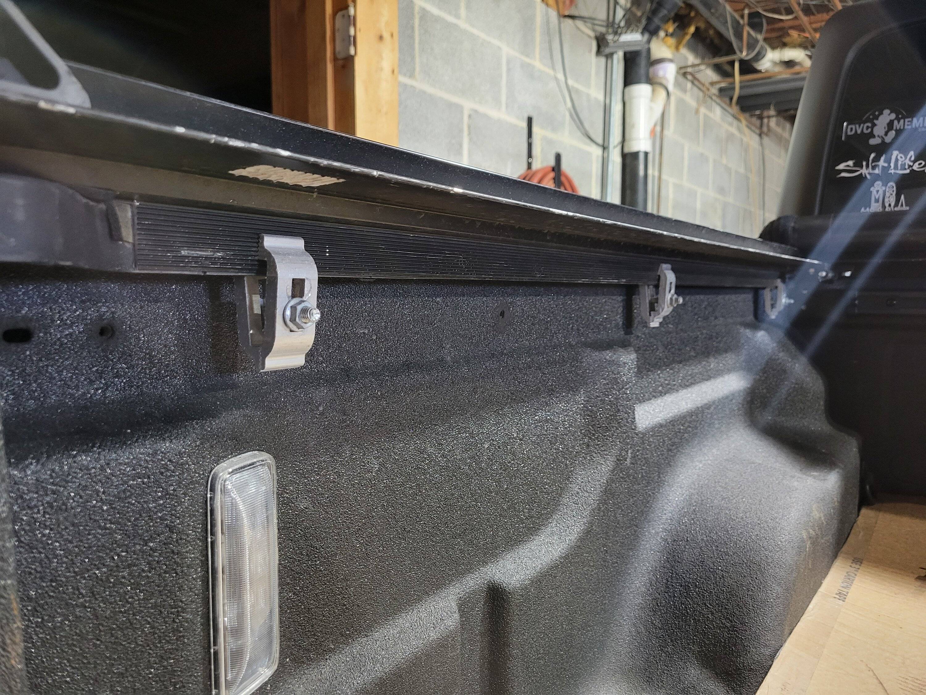

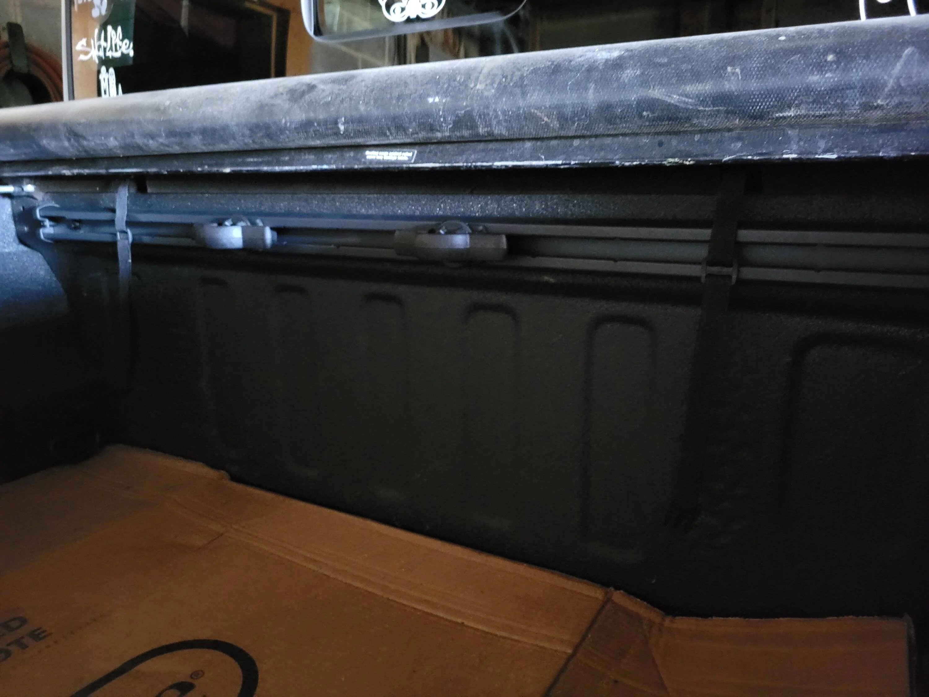

I have a "literider" or access, or agi not sure the name now tonneau cover on the truck. When I got it in '19 I didn't have these so I ordered it without rails kit. I need the proper brackets! Lol. The cover company wants $67 for 6 of those and $16 to ship plus $5 tax. $88 and shipping time then I can finish installing the side rails! Woohoo.

well now! Spoke to a fella that used to sell this brand of covers and he tells me this setup should work fine to hold the bits to the frame and all. So instead of paying the $88 I think I can grab some square nuts and split my clamps and run em that way. Hopefully tonight I will find 6 of those and tomorrow can get em up inside the bed.

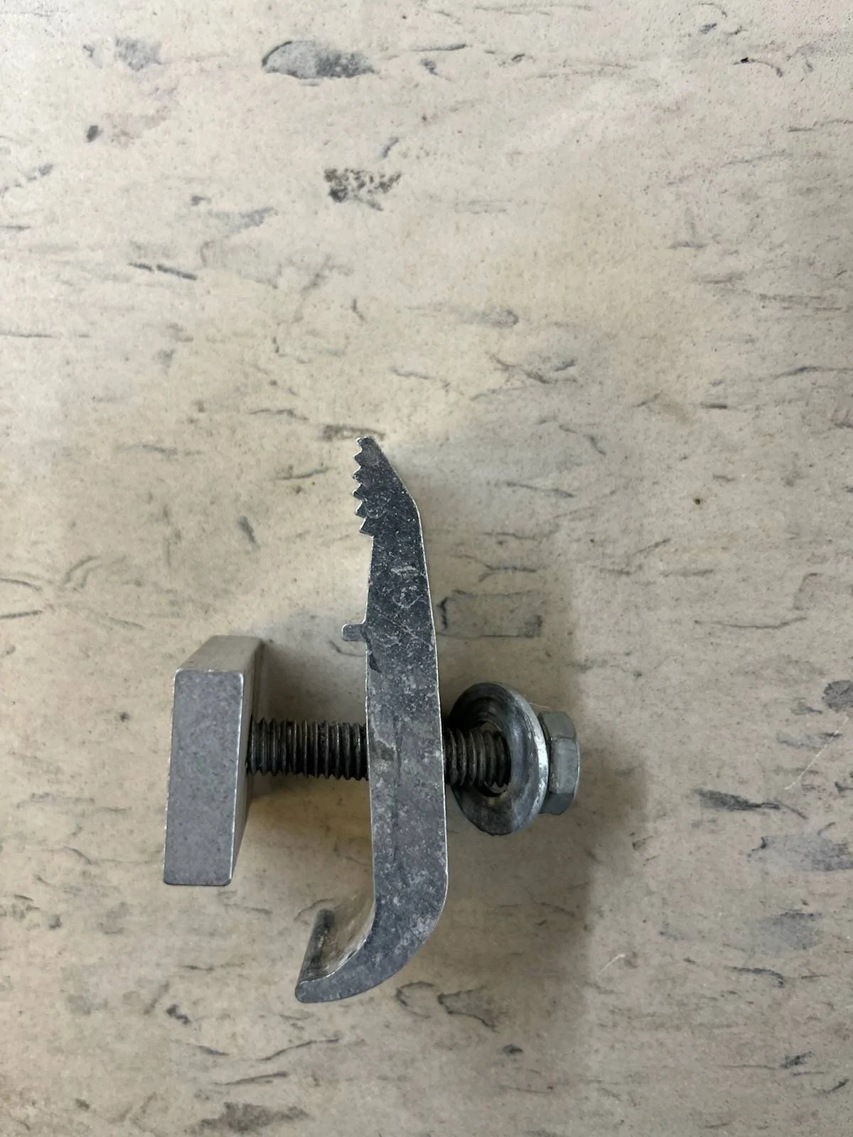

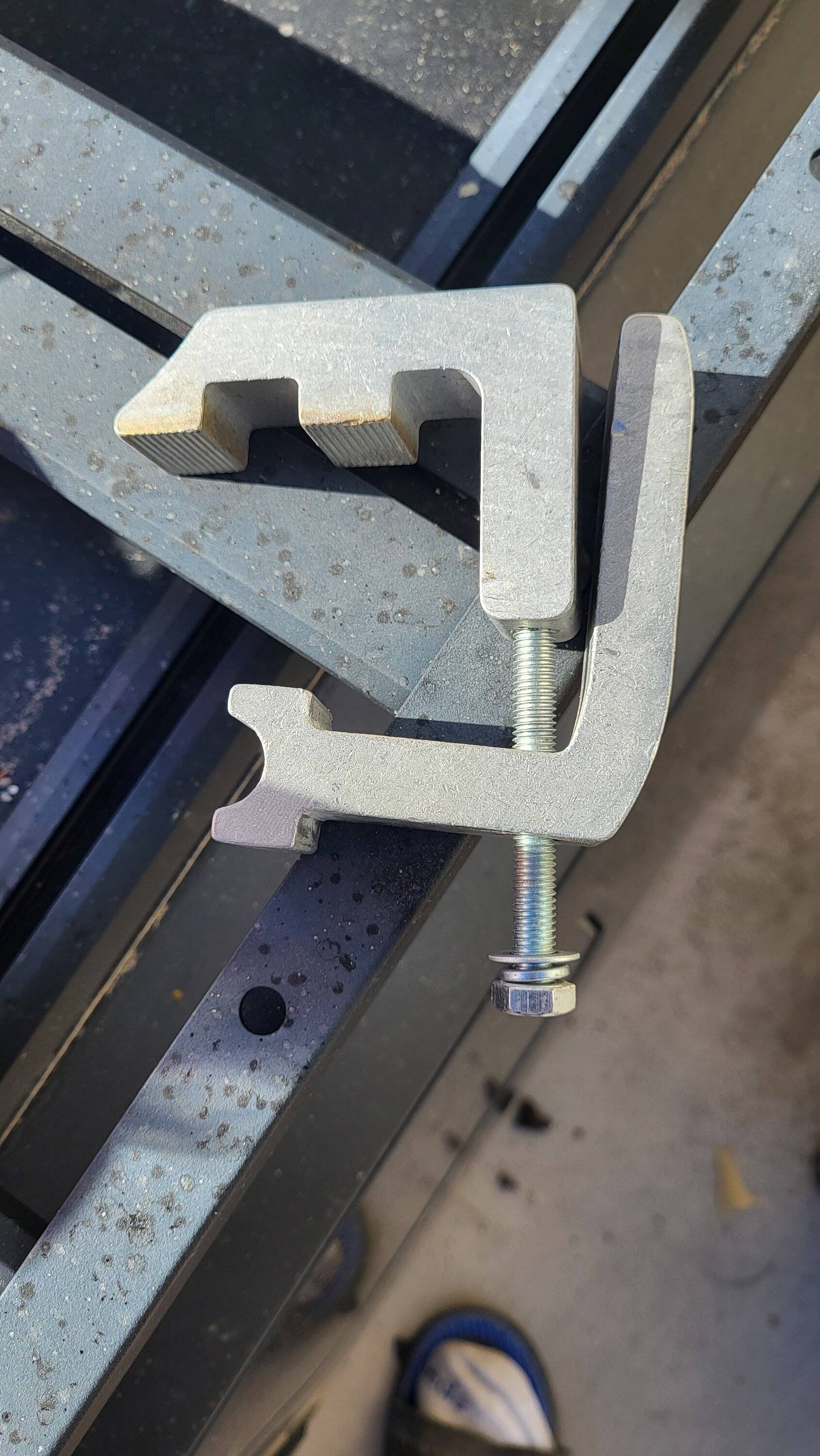

These are the Trail Rail clamps that came with my RSI Smartcap.

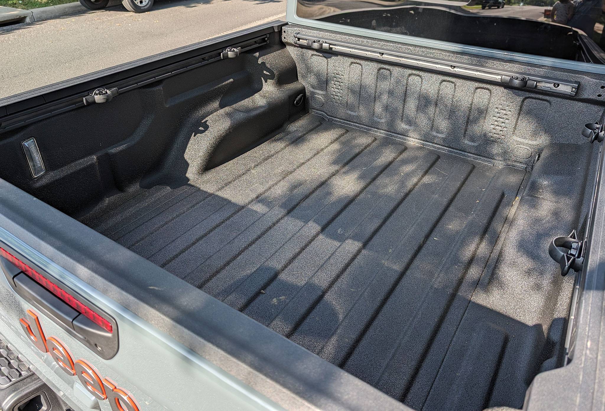

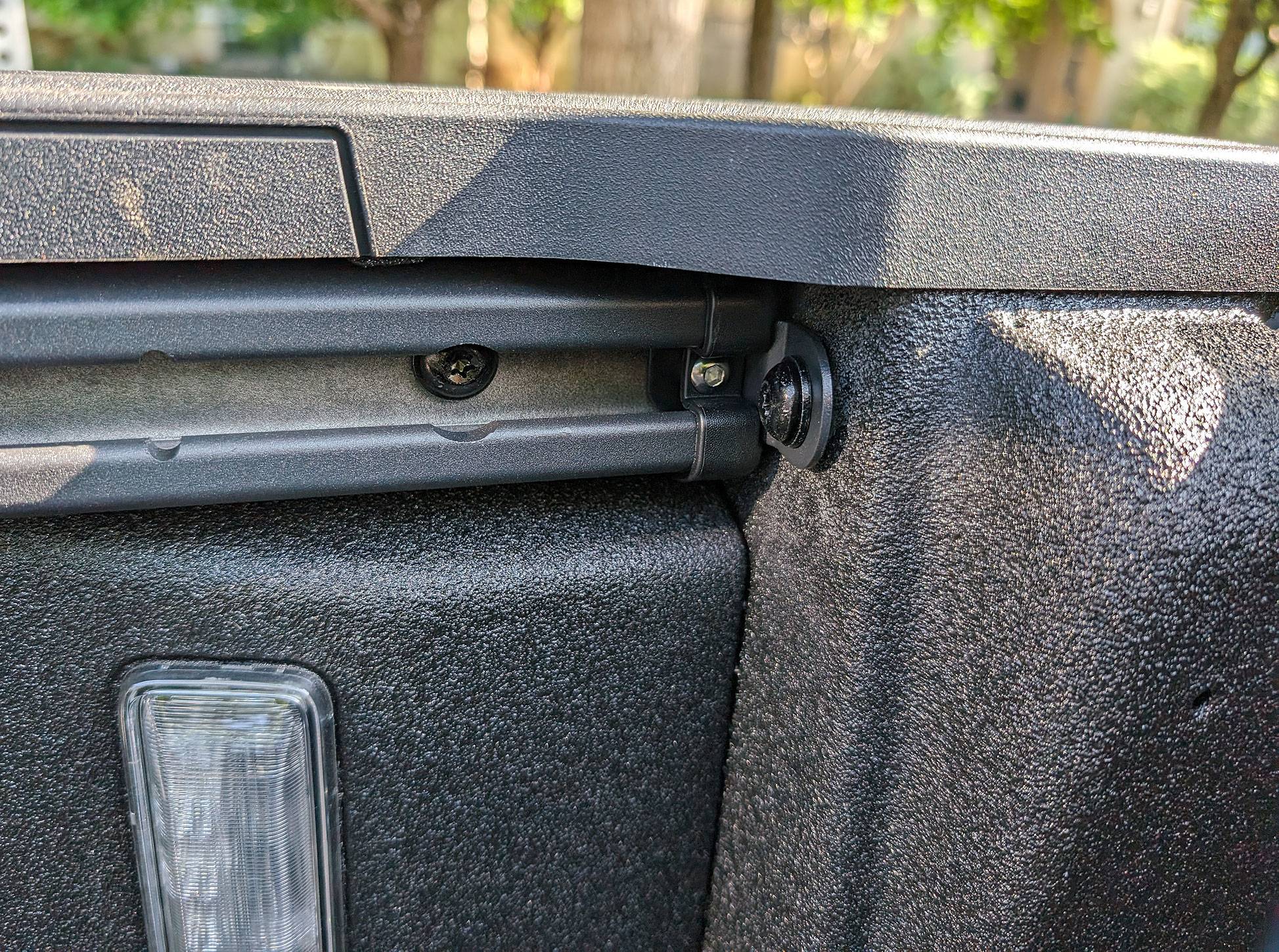

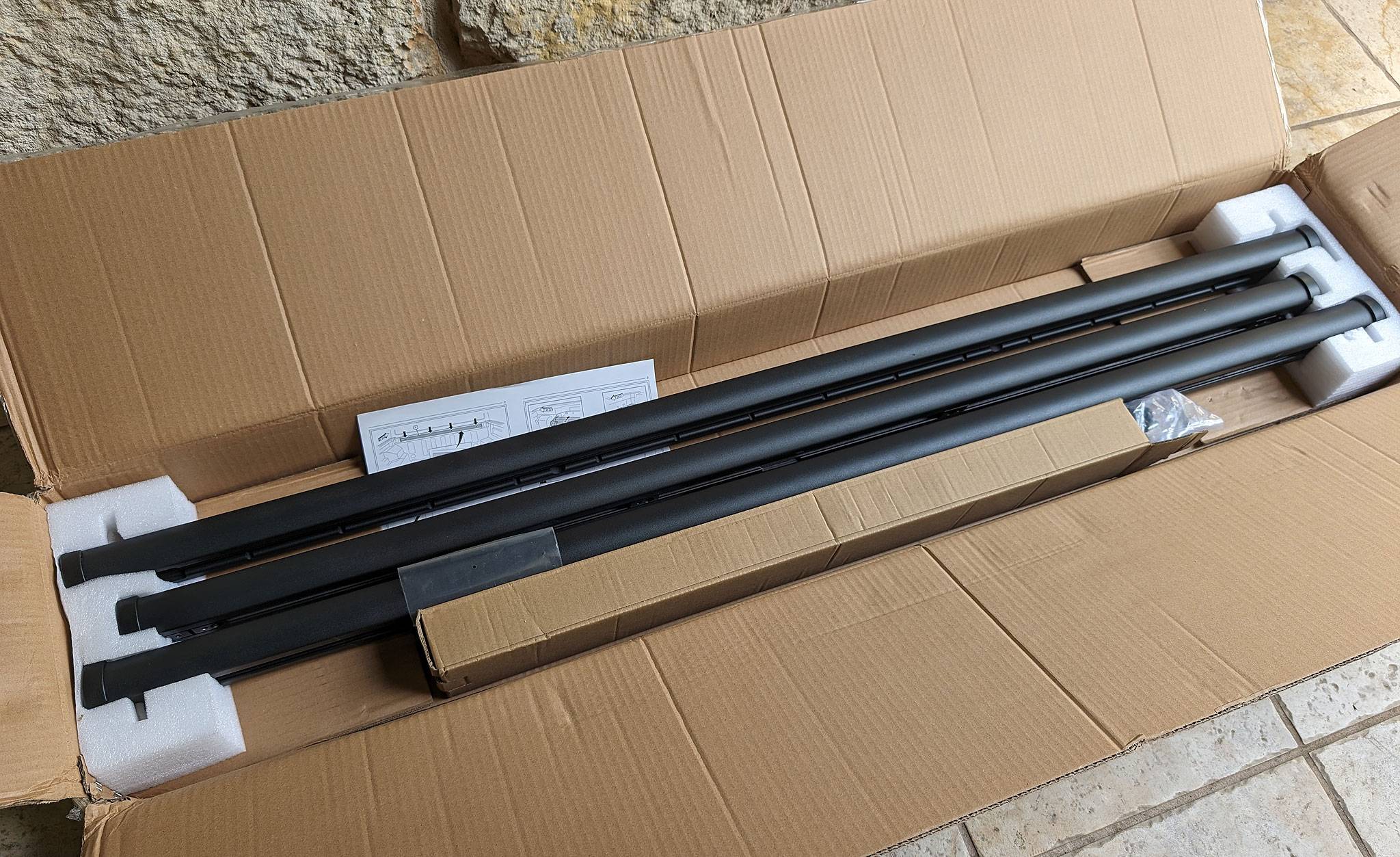

I bought this one last year. Bolted right on and is solid.
DICMIC Trail Rail System
I think these are sold under a bunch of different random brand names; I ended up with an eBay variant for $115:
https://www.ebay.com/itm/315343748382
The end caps on the side rails were a bit of a tight fit - I've read that the genuine Mopar rails don't include mounting hardware for the back of the side rails, and this is probably why?
Other than the tight fit on the side rails, they seem suspiciously OEM-quality, including the six tie down cleats.

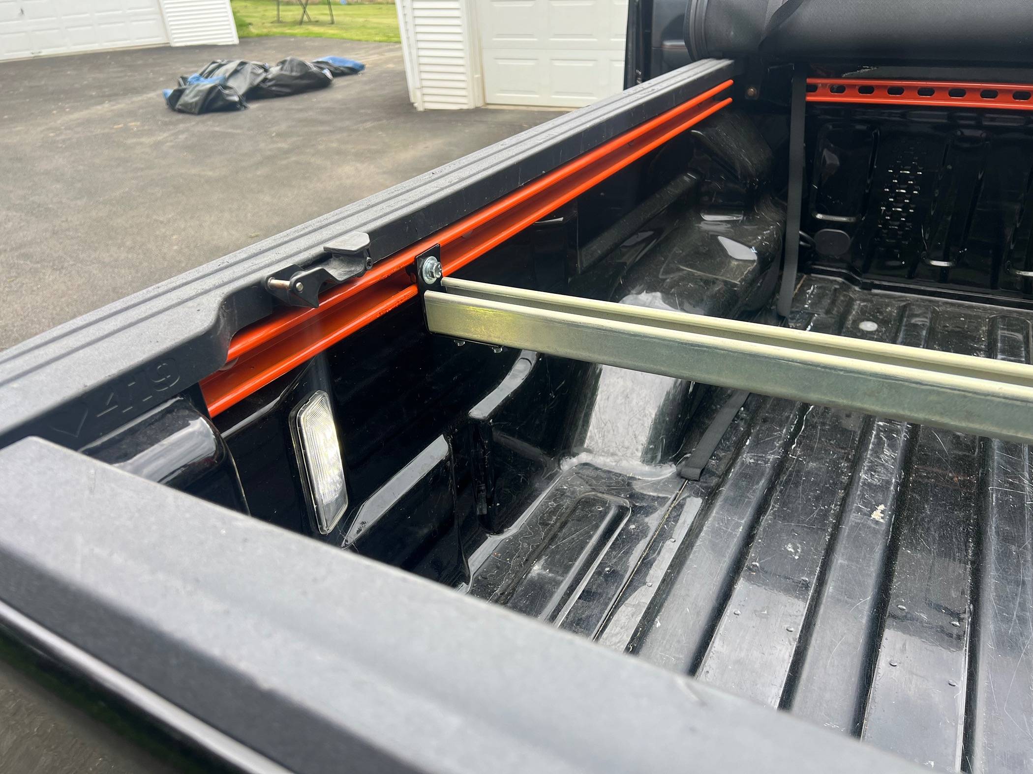

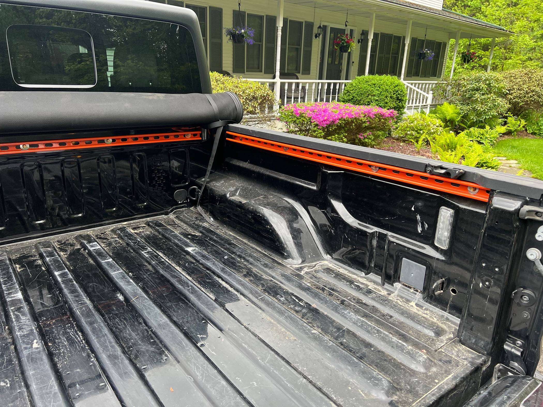

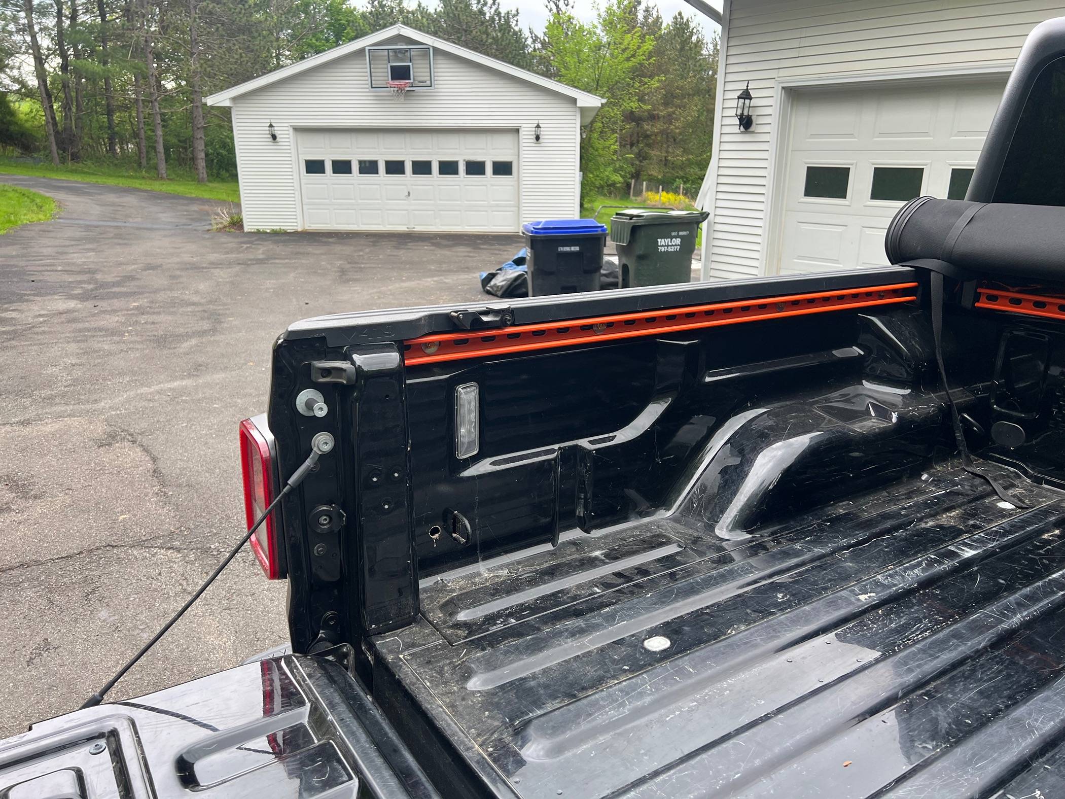

I went with uni strut from Home Depot. I had it power coated. It works great! No issues with hooking anything to it.

Those look good and the price is great. Other than the tight fit, any problems with them? Are the tie down cleats secure or do they have some give to them? It is hard to tell what I'll be hauling any given day and I'm getting tired of southern engineering straps off the corner hooks

I would have to fully recommend them! Mine fit perfectly and weren't tight at all. The tie downs work really well, seem very secure and have no play.
