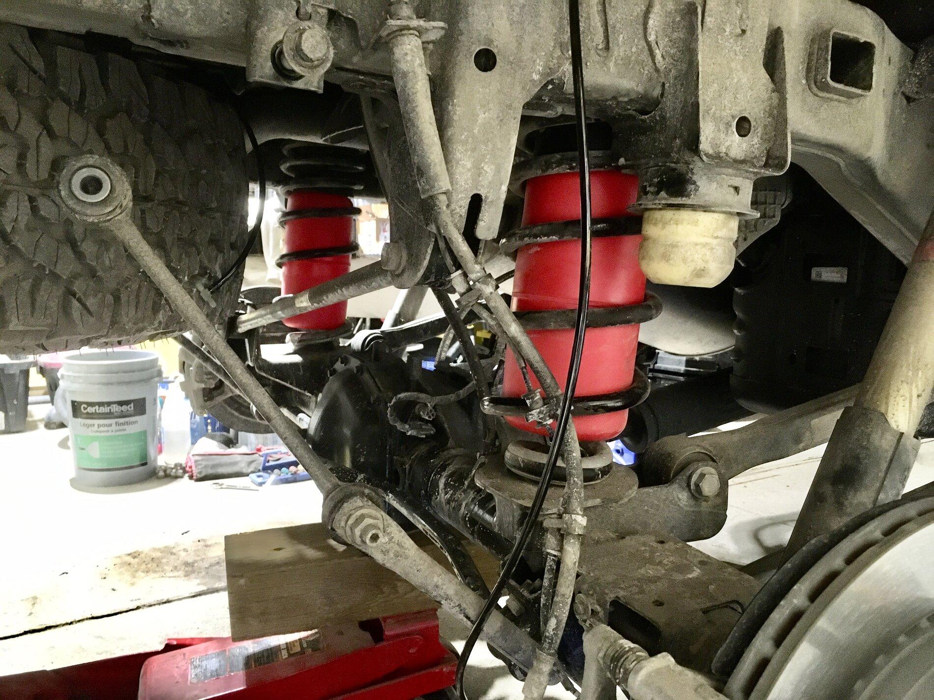

I installed the Air Ride 1000 coil bags last night. I have the 2021 Gladiator Rubi and only went one size larger than stock KO2’s which makes them 34 1/4” tires. First time driving on coil springs and 2.0 Fox shocks so right off the bat I never like the soft bouncy flowy ride. I needed that firmer planted feel on the highway. I ran air bags in my last two previous vehicles so I knew these were what I needed. After the test drive, the sweet spot for the air pressure is 8lbs and that gave me 3/4” lift. I don’t carry much weight in the back all the time but now the ride in the back feels like it does up front.
The install was just over two hours on the floor with floor jacks and I didn’t need to take out the coils, just fully flexed them is all. I did undo the bottom bolts to the shocks and pulled the top bolts to the sway bar.
One trick you must do is install the air line to the bags and insert puck BEFORE putting the bag in the coil by running the air line down through the top of the spring and out the bottom spring space. There’s lots of line so pull it through, run it through the puck and install on the bag.
Flatten out the bag and cap the air line on the other end. Fold the bag again, long wise and zip tie it tight so she don’t unfold then fit the puck and bag up through the bottom coil space. Snip the zip tie and you’re golden. The rest is self explanatory.

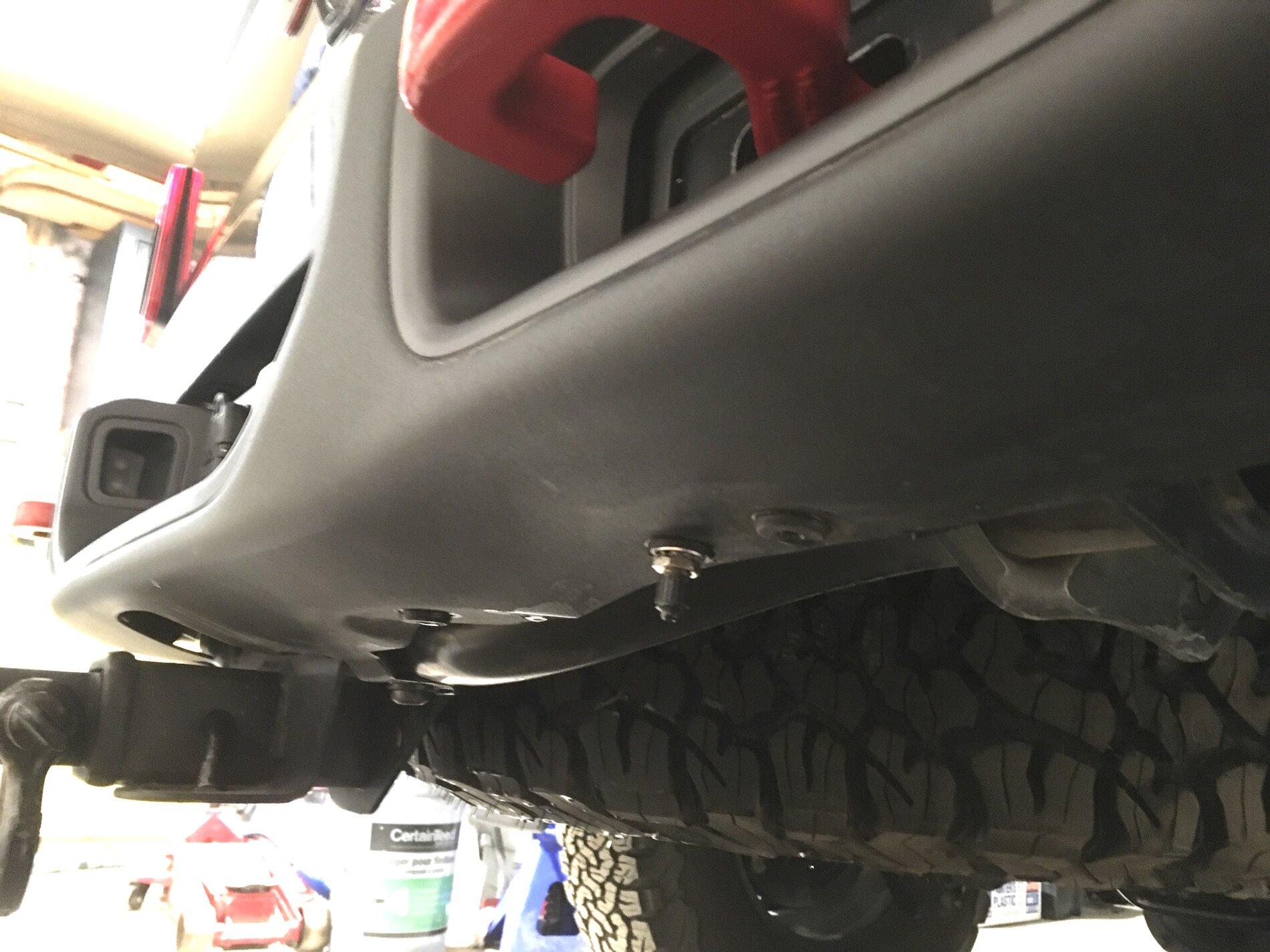

So with the air lines, I started with the driver side bag, ran the air line back along top of the frame about a foot and zip tied it off on some factory stuff there then took a 90* angle there and ran it straight across over the spare tire to the other side. I spliced in the T fitting there for the other bag and ran the fill valve to under the bumper. Drilled a hole there and painted it with POR 15 and inserted the valve.
