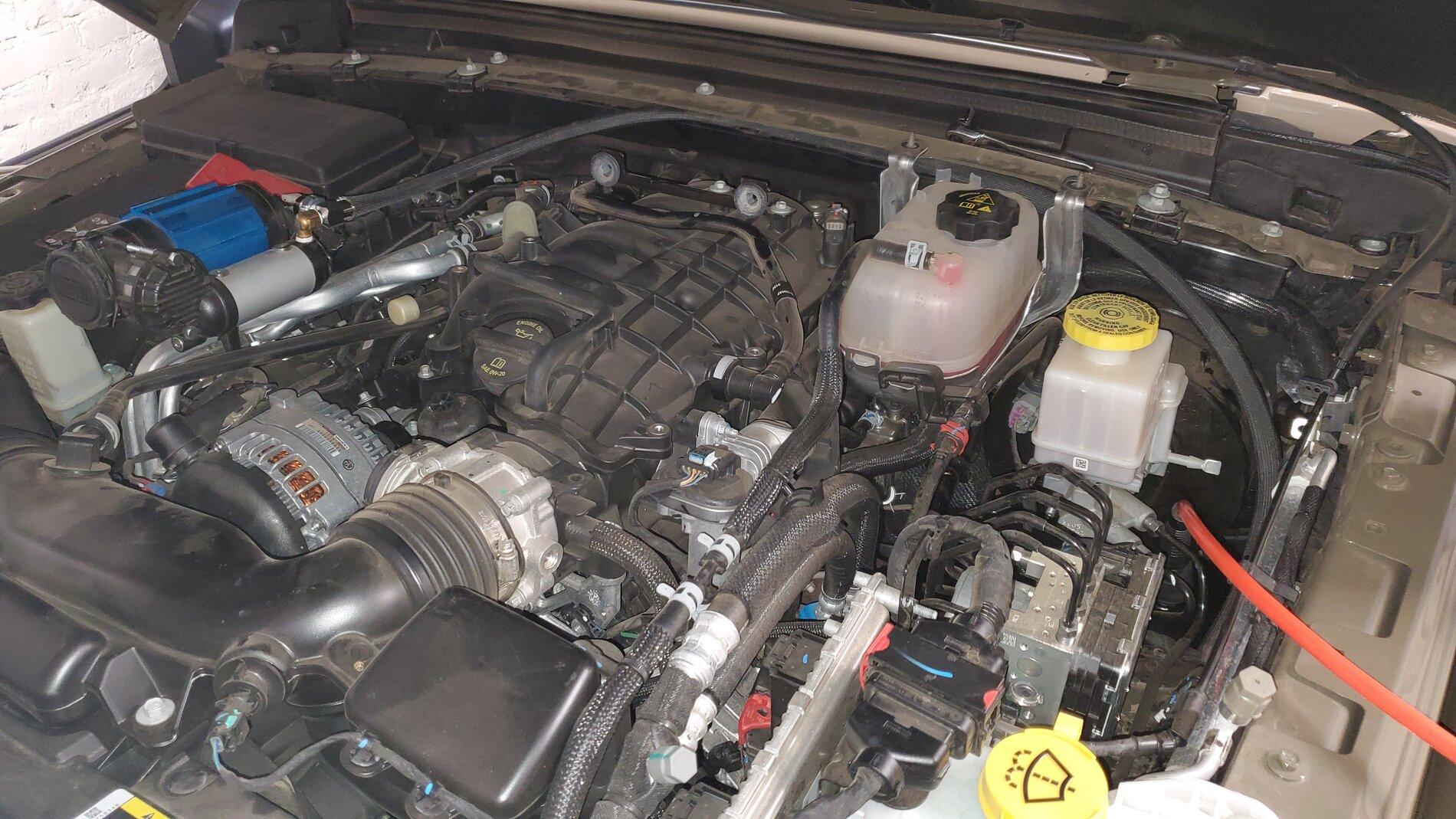

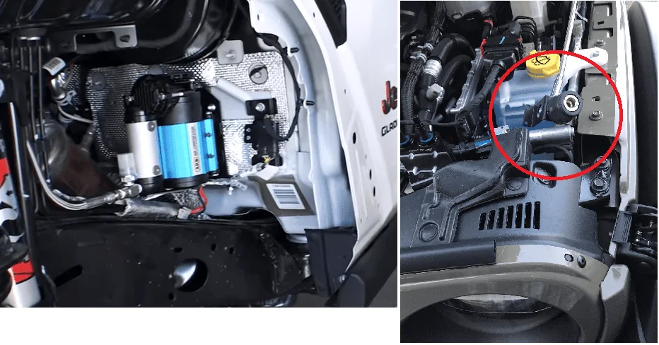

my current setup. I snipped the pic from a video as I forgot to take a pic myself of the air compressor mounted. I used a bolt already in the engine bay to mount the air connection. No air tank yet. I bought the ARB mount from Eddie, it works great.

Thanks for posting this - I hadn't seen it before. Looks really interesting!

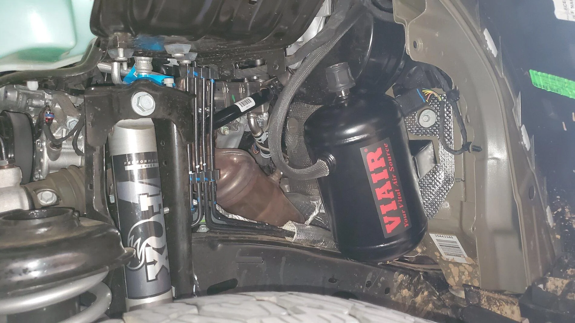

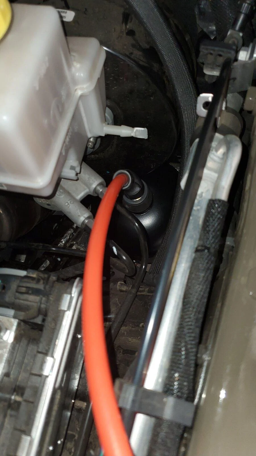

Bringing this back to life as I have the same question. I have the engine bay ARB air compressor mount and I'm thinking of where to mount a 1 gallon tank. I pick up my JT in 2 weeks, but until then, any ideas?
I put my 1 gallon tank under the brake booster.
Jeep Gladiator Air tank locations? 20200821_142049
I really like this idea. What mount and tank did you use? I can’t find either on the web.
