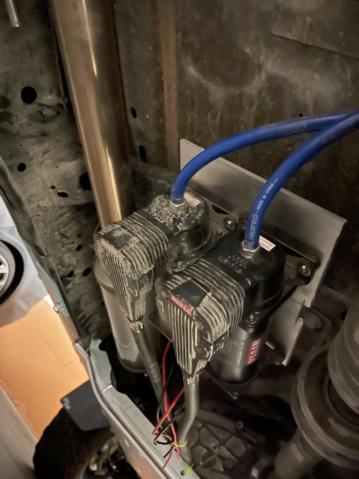

The Maximus mount:
It did ok, but got rusty fast and was a pain to service due to the amount of weight in that cradle.
Jeep Gladiator Air tank locations? IMG_1544

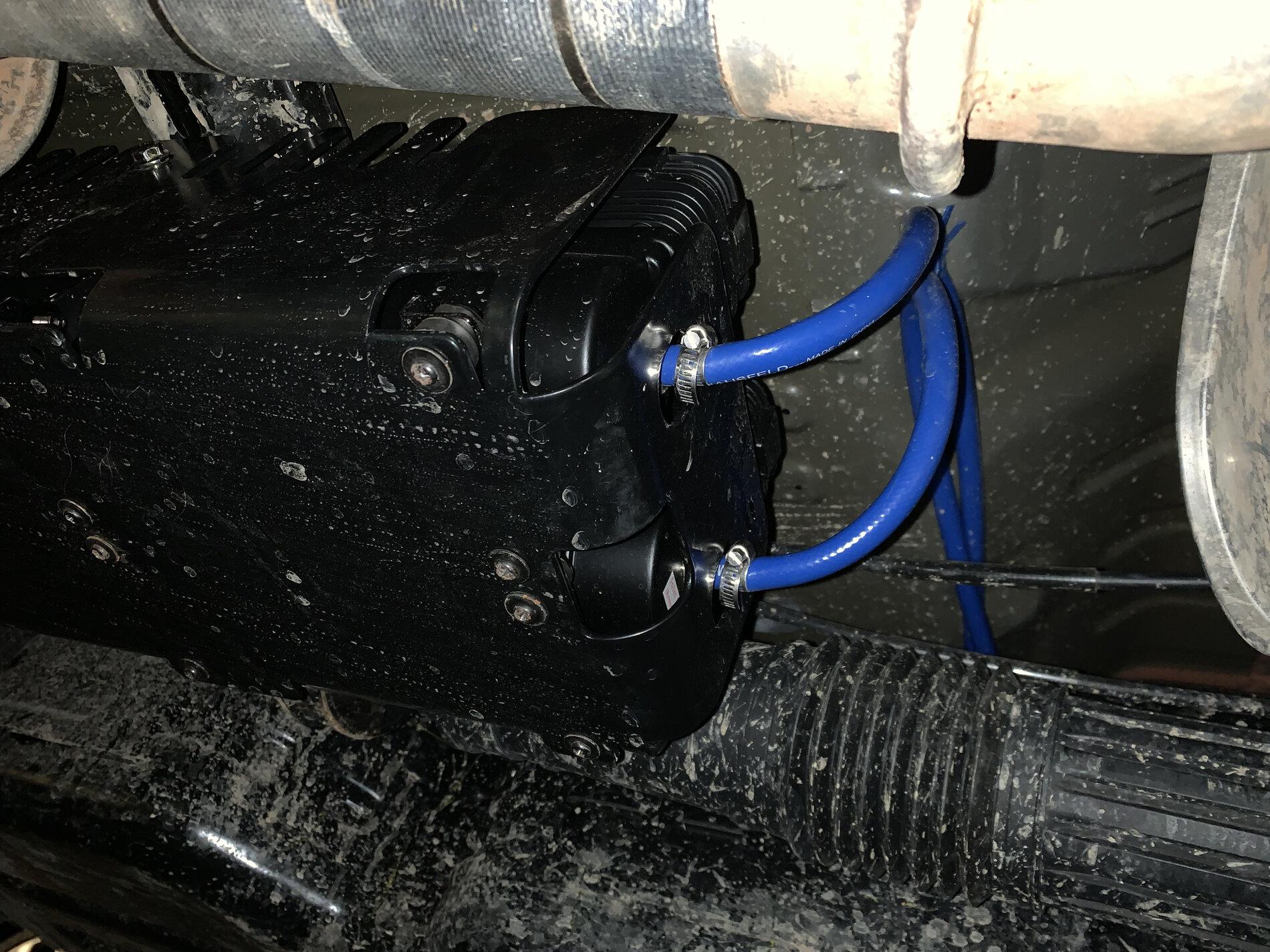

Custom Aluminum Mounts
Wanted to try this out, didn't like it so I didn't make them pretty.
Jeep Gladiator Air tank locations? IMG_0028

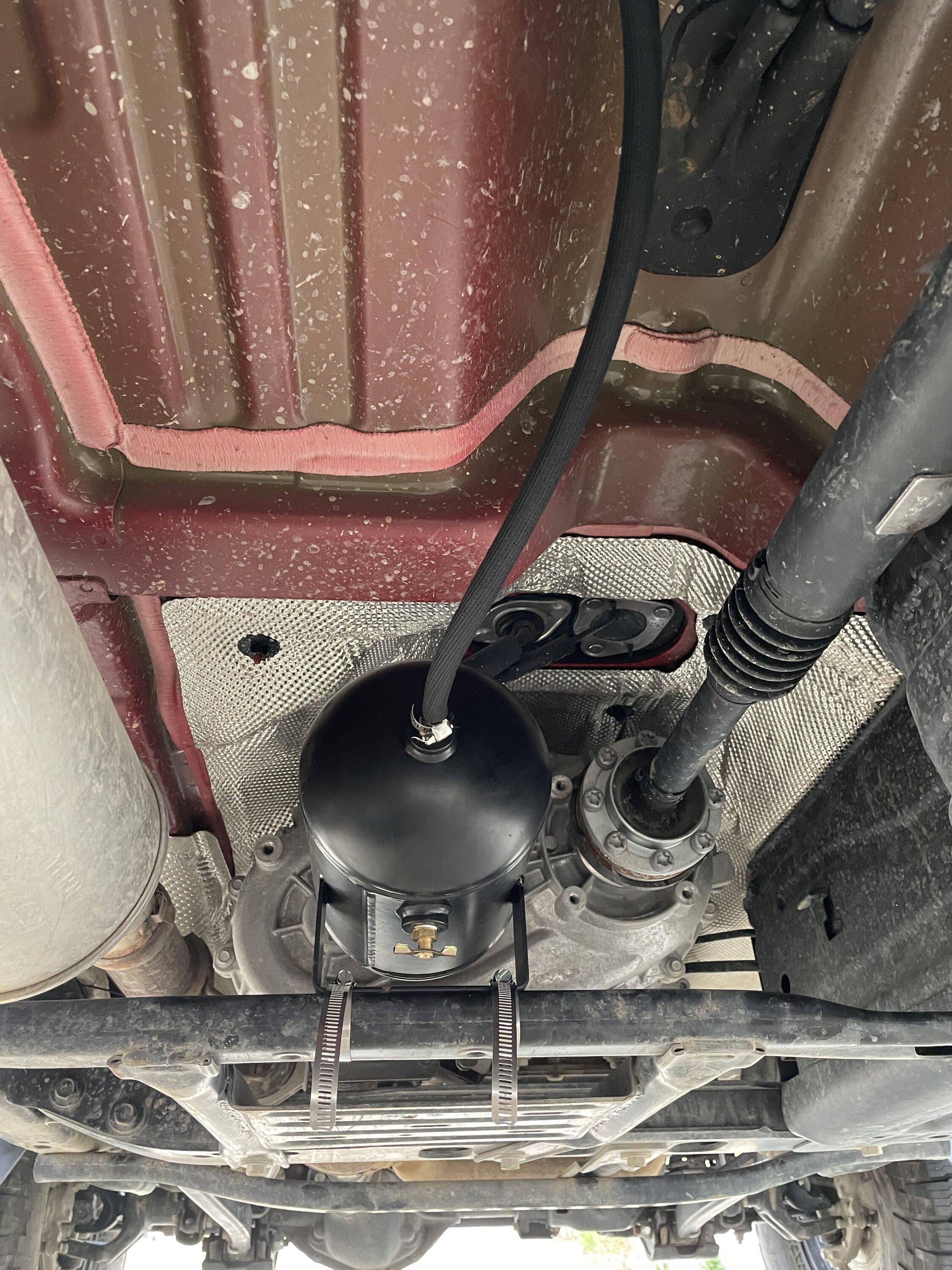

1 Gallon Tank under backseat:
This one fit really nicely, and I liked the setup a lot. Unfortunately 1 gallon just isn't enough :/
Jeep Gladiator Air tank locations? IMG_0656

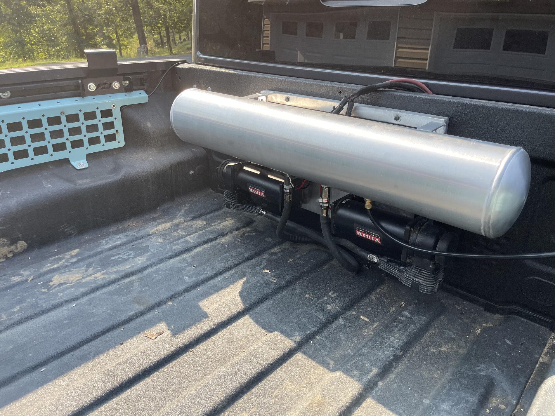

Quick Release 5 Gallon in Bed
This is what I'm trying right now. MUCH higher capacity and it comes out of the truck in about 5 minutes if I want the full bed.
Jeep Gladiator Air tank locations? IMG_0978

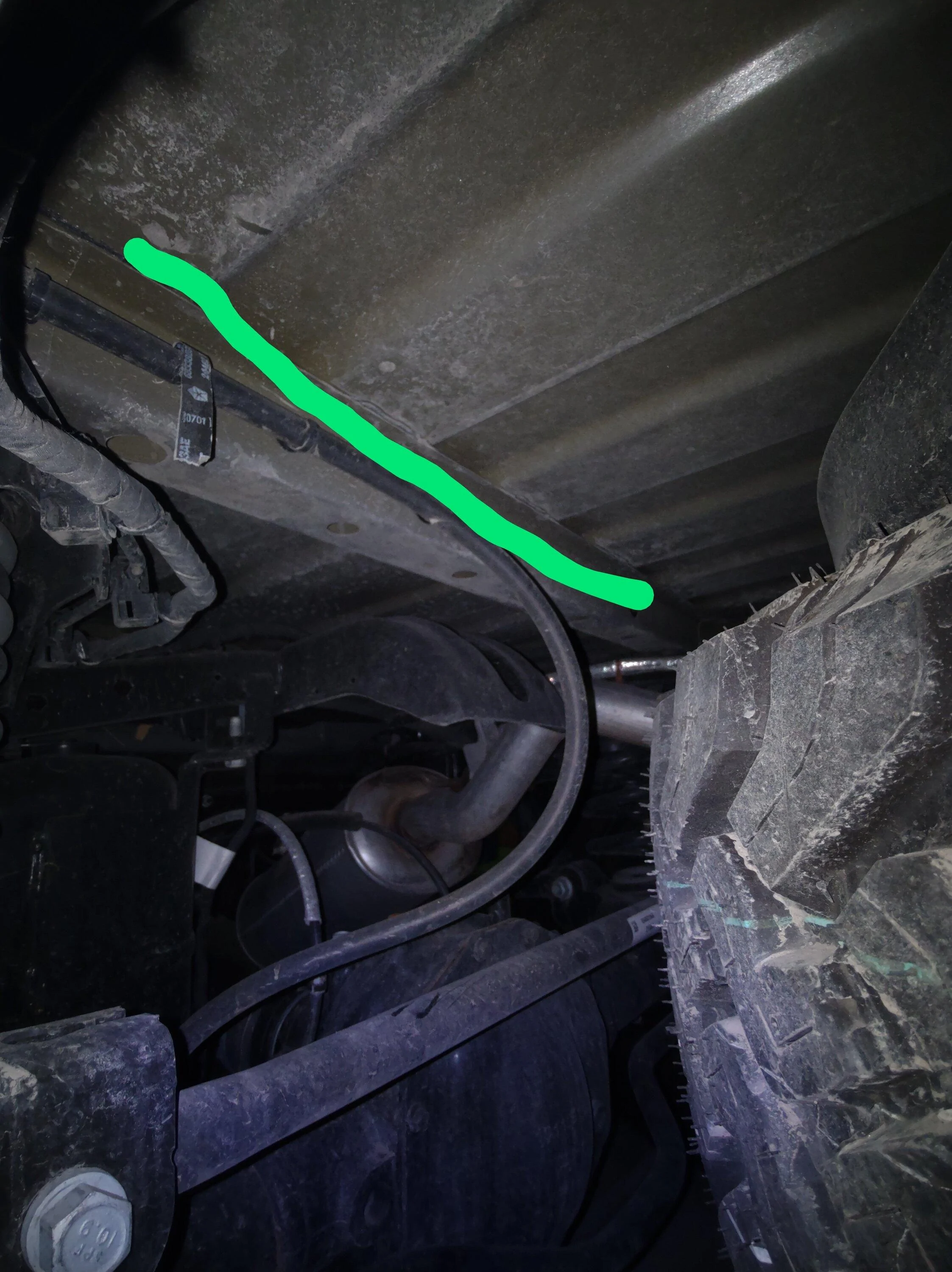

Was think about this spot right in front of the spare tire. Not sure if it would be in the way of any articulation. Any thoughts?
Jeep Gladiator Air tank locations? IMG_20220120_094037052~2
