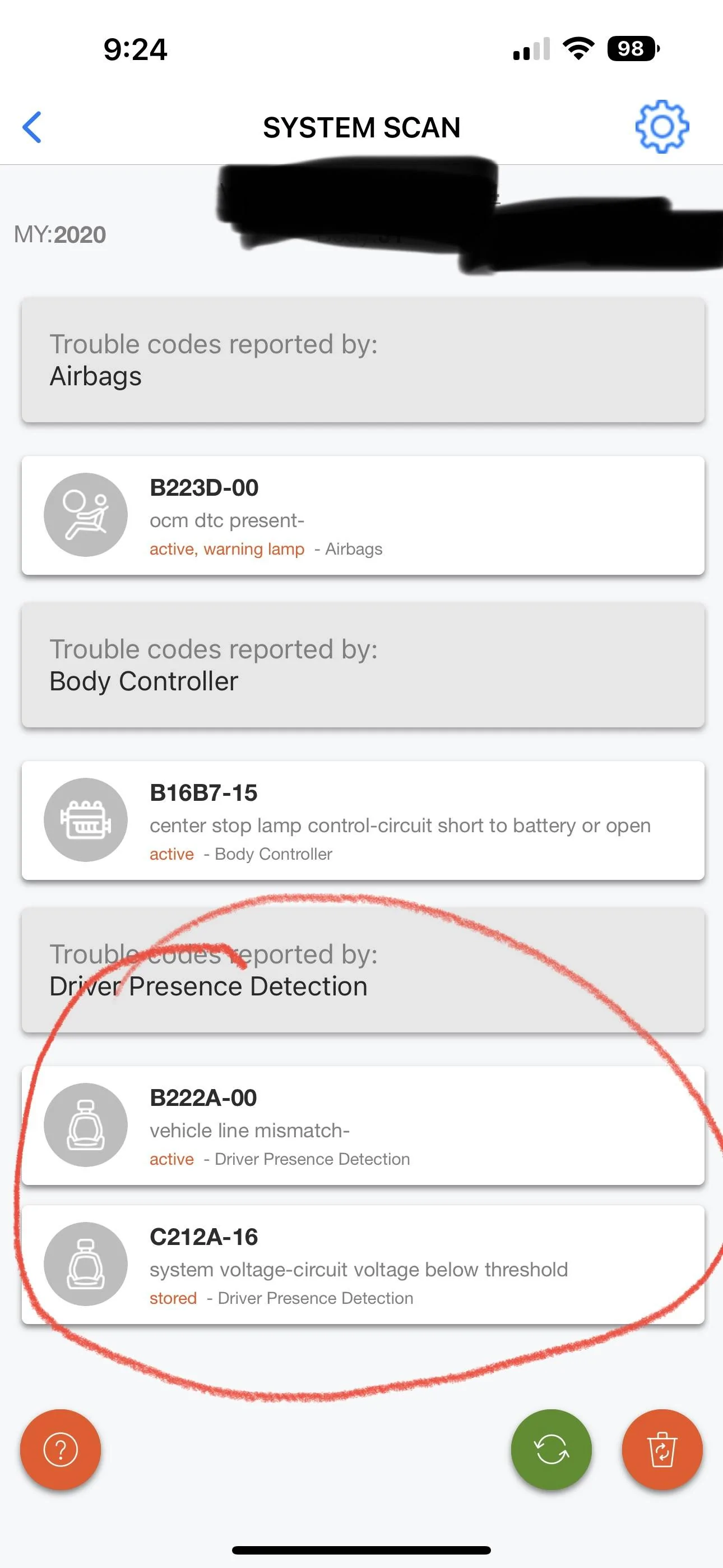

Thanks for all the replies. I swapped in my original seat and still have the service airbag light still on.
The codes I got were:
B223D-00 - ocm dtc present
U115F - lost communication with driver presence detection module
I forgot to disconnect the negative from the main battery before I swapped seats. Currently I unhooked the negative and letting everything reset after 15 min.

Update: I tightened the connectors and no longer getting a lost communication error. These are the 2 errors I get now on the bottom of the picture.
