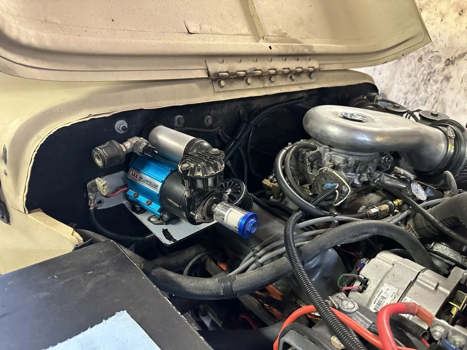

ARB Twin in the Gladiator mounted under the passenger seat on a DIY mount. I built a rear seat delete so I ran an air chuck to each side of the jeep under the platform. My motorhome has 41 inch MPT80 tires, so needed a big compressor to handle air downs.
This picture is on my 47 Jeep. It’s about 12 years old and has a ton of use, but still going strong. I replaced the stock air filter with something from Harbor Freight.
For air down/up, I use a couple of quick release air chucks. Going down I use a pencil gauge that will check the air on a standard quick disconnect. To air up, I use a watch and just let it run for the same number of minutes. Get me close enough in all four tires for the trip home.
