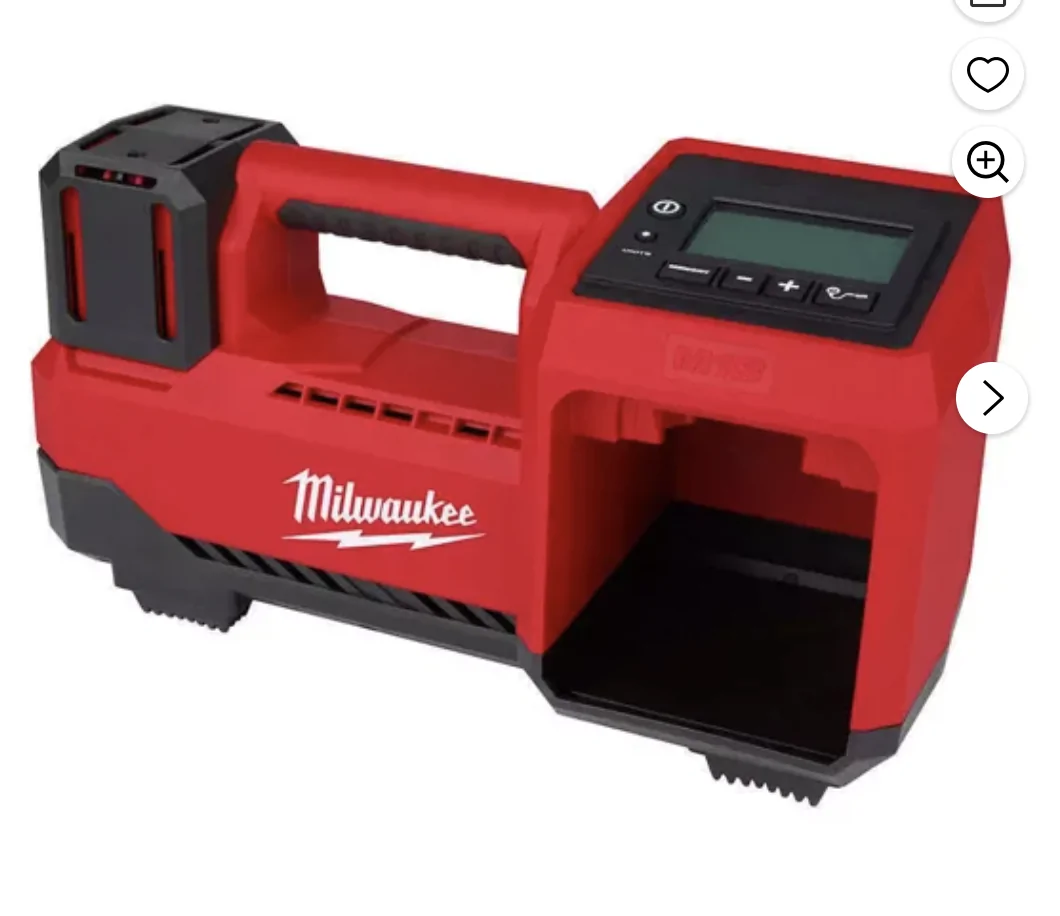

Milwaukee M18 portable; takes me about 3-3.5 min per tire going from 15psi to 30psi in my 40" Trail Grapplers. I can do it in one oversized batteries or 3 with standard M18 battery and the last tire with another batt.
Link to compressor
