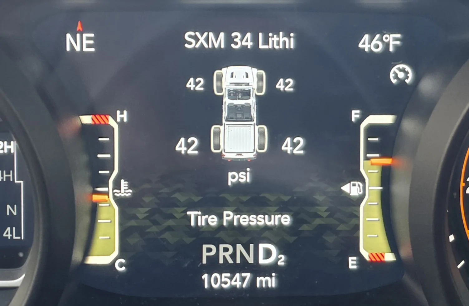

I've used Nitrogen for years and don't have to deal with the tempter swings.
Unless you've tried it don't knock it.
Nitrogen is great as long as you don't air down often.

Couple of things. First, the high Jeep recomended tire pressures are intended to make the tire slide rather than grip, to reduce roll-overs. Search out the tire manufacturers data sheets for the best tire pressures. I live in WV, so this time of year wild temperature swings are actually normal. Tire pressures may go from 37 to 30 in a 24 hour period. Interrestingly, as the temperature drops, you usually need more traction. Natures air down! When it warms up, the pressures go back up. Jeep needs to include this factor in their pressure warning system, so I don't have that light on when it is really not neccessary.
Tried it. Snake oil. Besides, the air we breath is 78% nitrogen. Which means the air coming out of my air compressor at home is 78% nitrogen.
Fine for a street Jeep but not really convenient when you air down frequently. Sure I could carry a small nitrogen tank and regulator, but I'll stick with the regular air pumped by my compressor that takes up little space and never runs out of air.

During this season, my tires are always down in the morning. Usually by 3-5 psi. 10 minutes rolling down the road and they’re where they need to be. I pay it no mind.

I have played around with the pressures to see what I like best. They are Toyo Open Country M/T 37x13.5x17 and are E rated, so I think they ride better around 38 psi. What I lose in a slightly rougher ride I make up for in handling. 33 is just a little too squishy for me. I can really tell a difference in turn-in.
My 35s are the same for me. My trip to work has a bunch of curves and much lower than 38 feels too soft.

Eh.....I feel like this Nitrogen vs Normal Ass Air debate gets overblown a bit. If pressure loss over time or fuel economy are the main concerns, there is plenty of evidence showing how marginal those differences are.
Per one of the linked articles.....
We filled one tire per model with air and another with nitrogen. Both were filled to 30 psi (pounds per square inch) at room temperature. We set both tires outdoors for one year, then checked the inflation pressure at room temperature again.
Both tires lost pressure over that time, but the difference in loss was minimal. The average loss of air-filled tires was just 3.5 psi from the initial 30 psi setting. Nitrogen-filled tires lost an average of 2.2 psi.
What about rolling resistance? Nope.
The lab report from NHTSA also found that “inflating with nitrogen in place of air had little or no direct effect on tire rolling resistance performance.”
Sources:
- https://www.consumerreports.org/car...ld-you-use-nitrogen-in-car-tires-a6260003694/
- https://cars.usnews.com/cars-trucks/advice/nitrogen-in-tires?onepage
And here is the actual NHTSA study that all of this information is derived from.
- https://www.branick.com/wp-content/uploads/2019/03/5-NHTSA-2008-Nitrogen-Inflation-Study.pdf
Not saying nitrogen isn't beneficial in some circumstances, just that folks seem to have hard-line opinions on it, and that seems a bit dramatic. I have a nitrogen tank on the Roxor for the tractor, or other things that sit for seasons at a time (mainly because I am lazy and the tank is easier to deploy, lol) but never bothered with them for the Jeeps or anything we drive regularly.

Whether nitrogen filled tires are snake oil or not, I have real world data. My wife's JLU came with nitrogen in the tires. In 3+ years of ownership, I have never had to add air to any of the five tires, ever.
OTOH, my JT has O2 and I have constantly have to add air when the temperature drops. Often.
Is nitrogen snake oil? Maybe. I would never pay to have someone fill my tires with it, only for me to let it out when I do air down. But so far it saved me from dragging out the compressor on one of my Jeeps.

I usually run a lot higher tire pressure than most here in my JT but heavier loaded and mostly road miles along with towing. My LJ might have 25 psi, I doubt that likely 12 psi.
