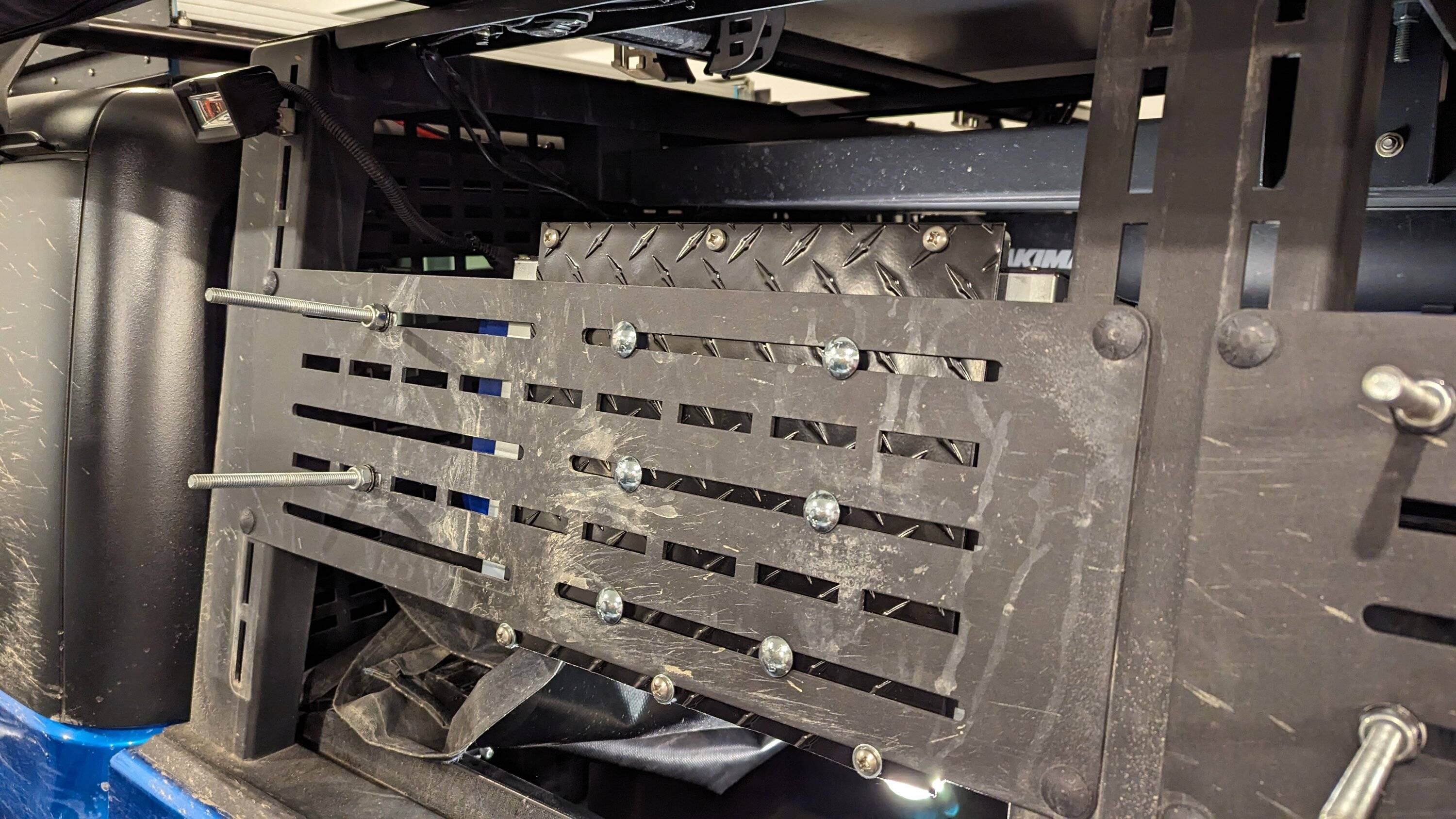

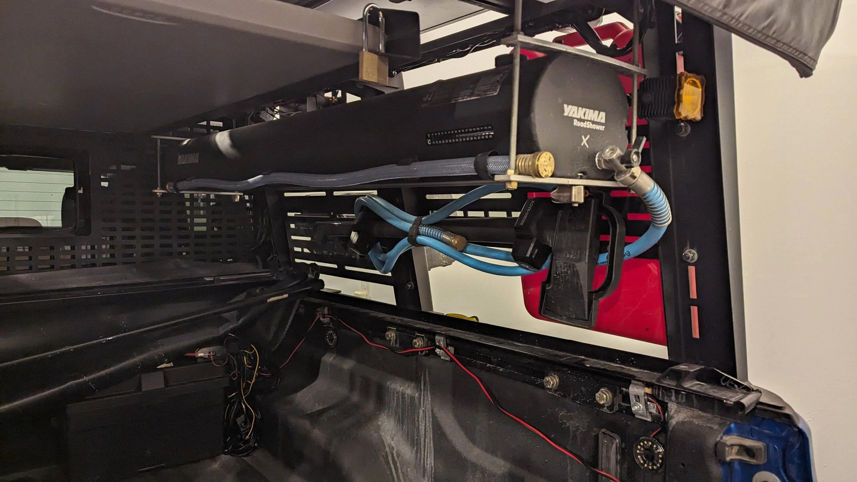

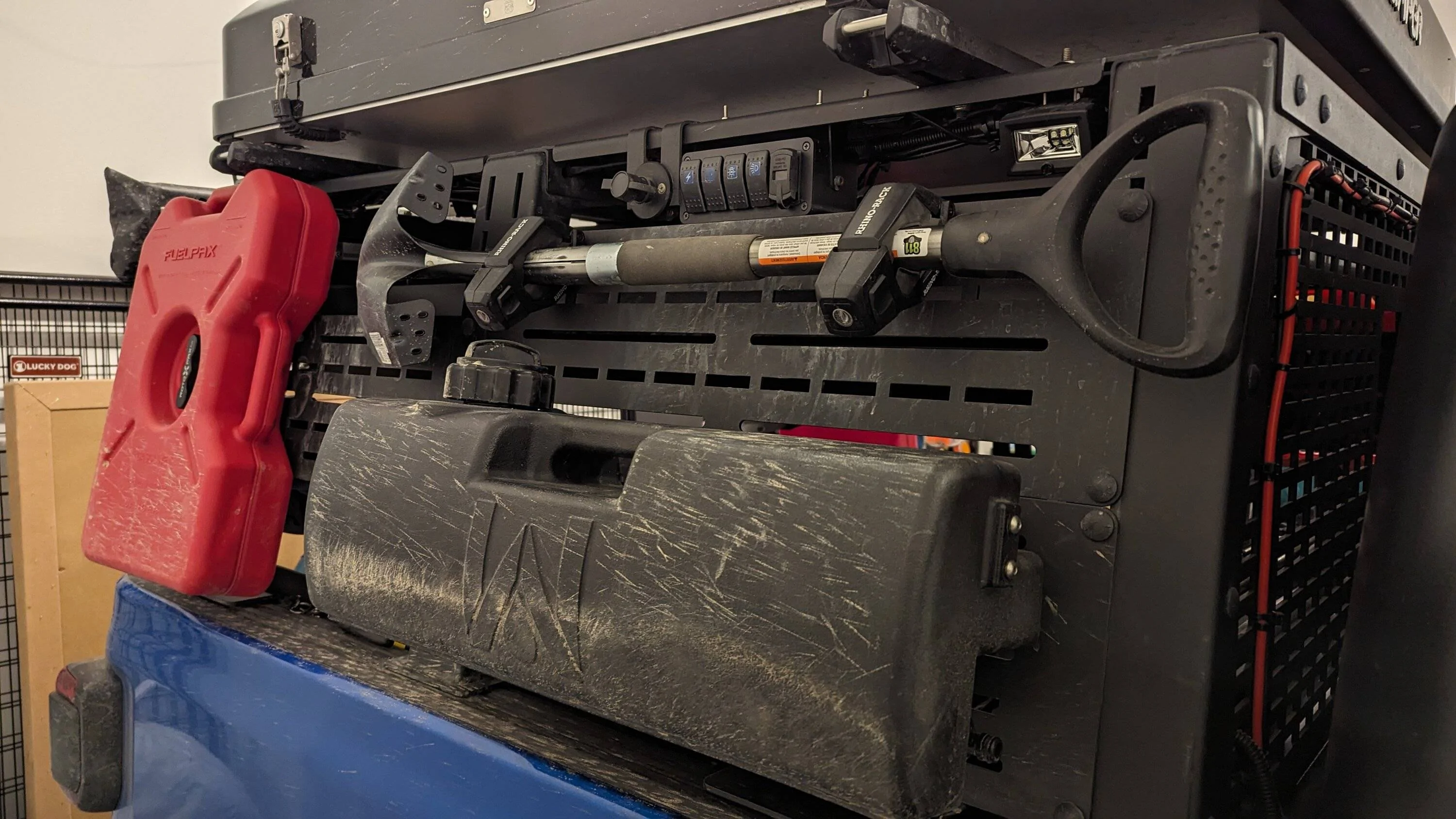

Here are some pics from tonight.

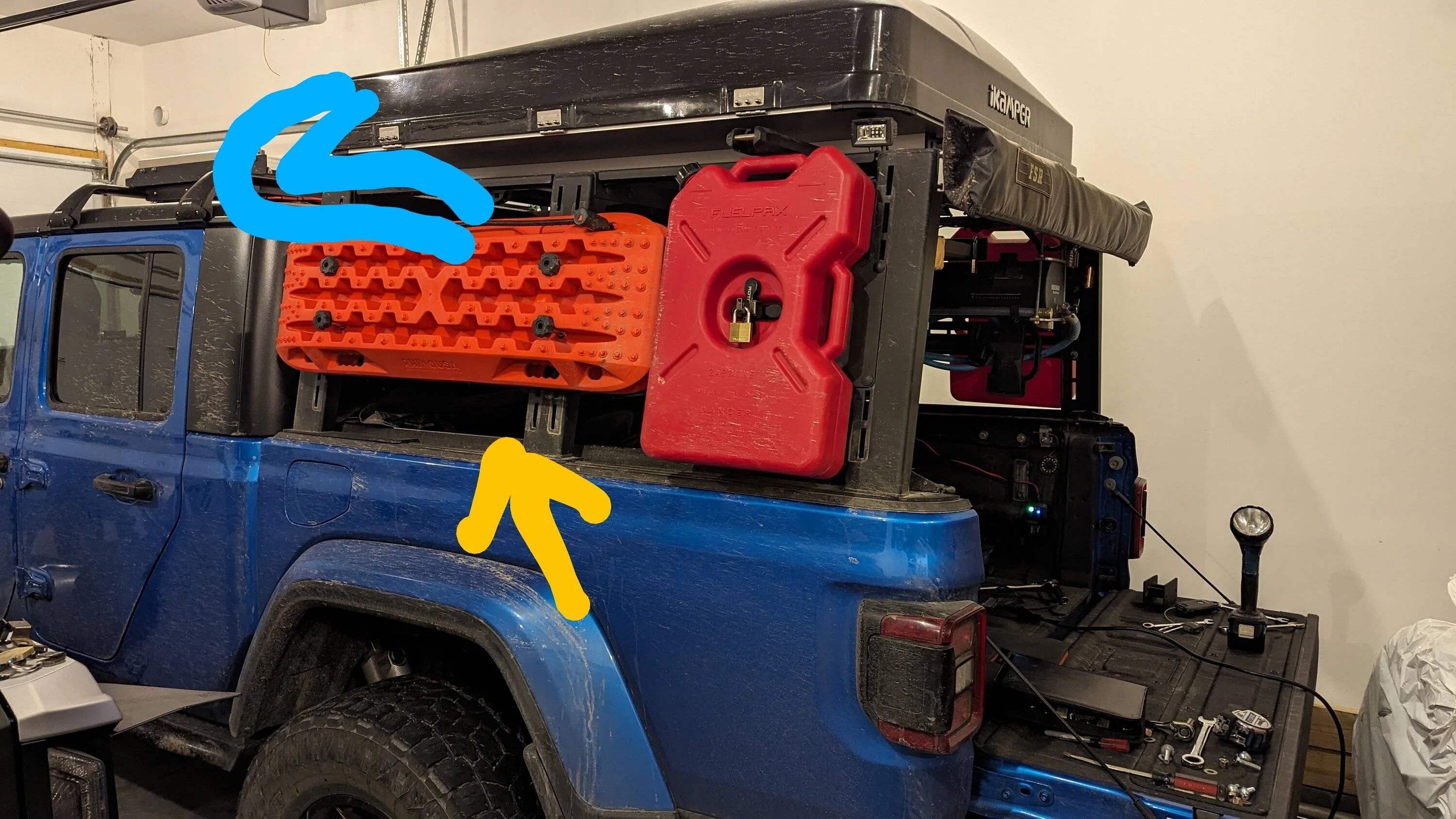

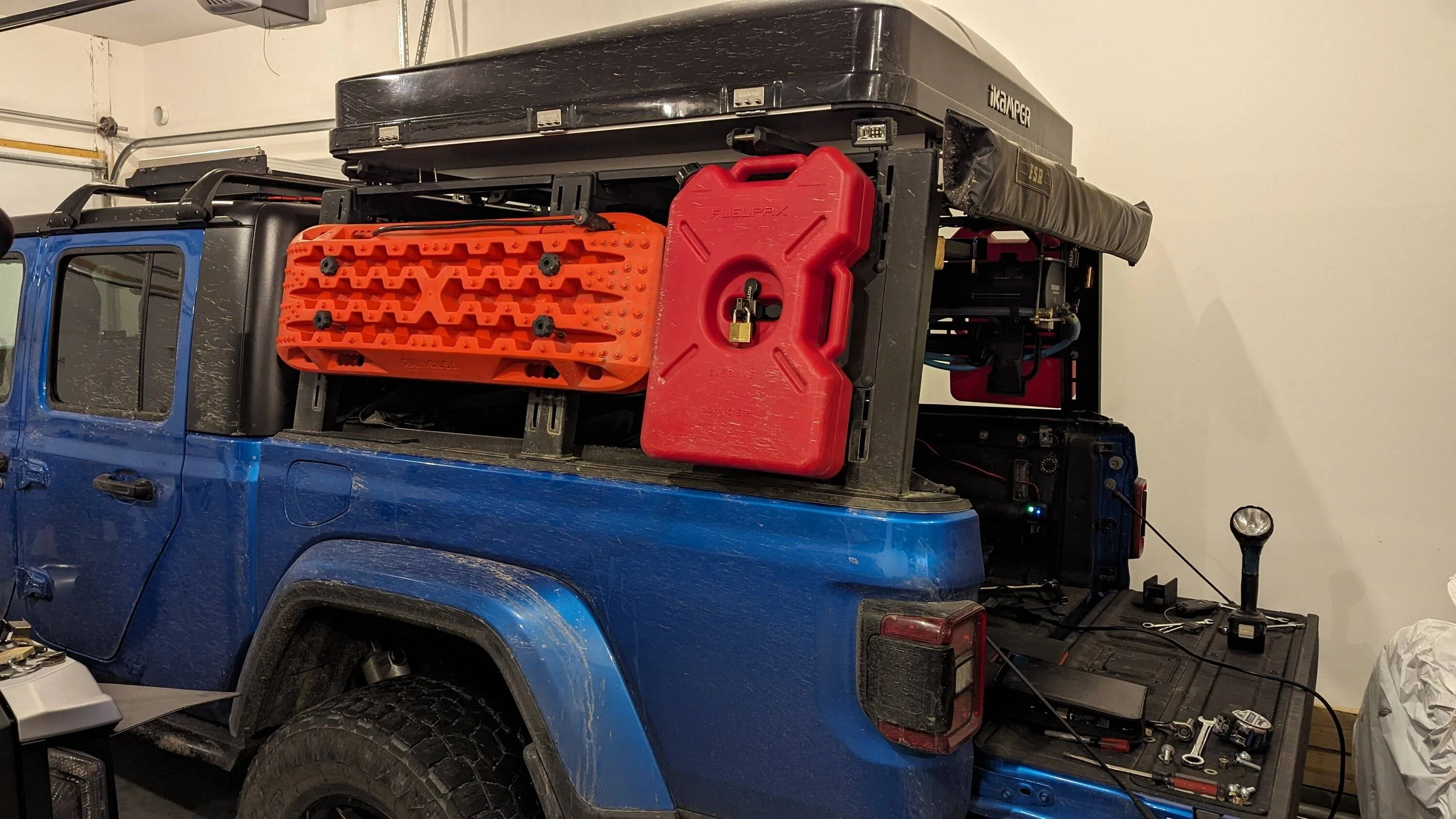

New driver side setup:
Jeep Gladiator Alaska Daily Drivers: Hydro Blue 80A and Bright White JTR PXL_20240111_043255256

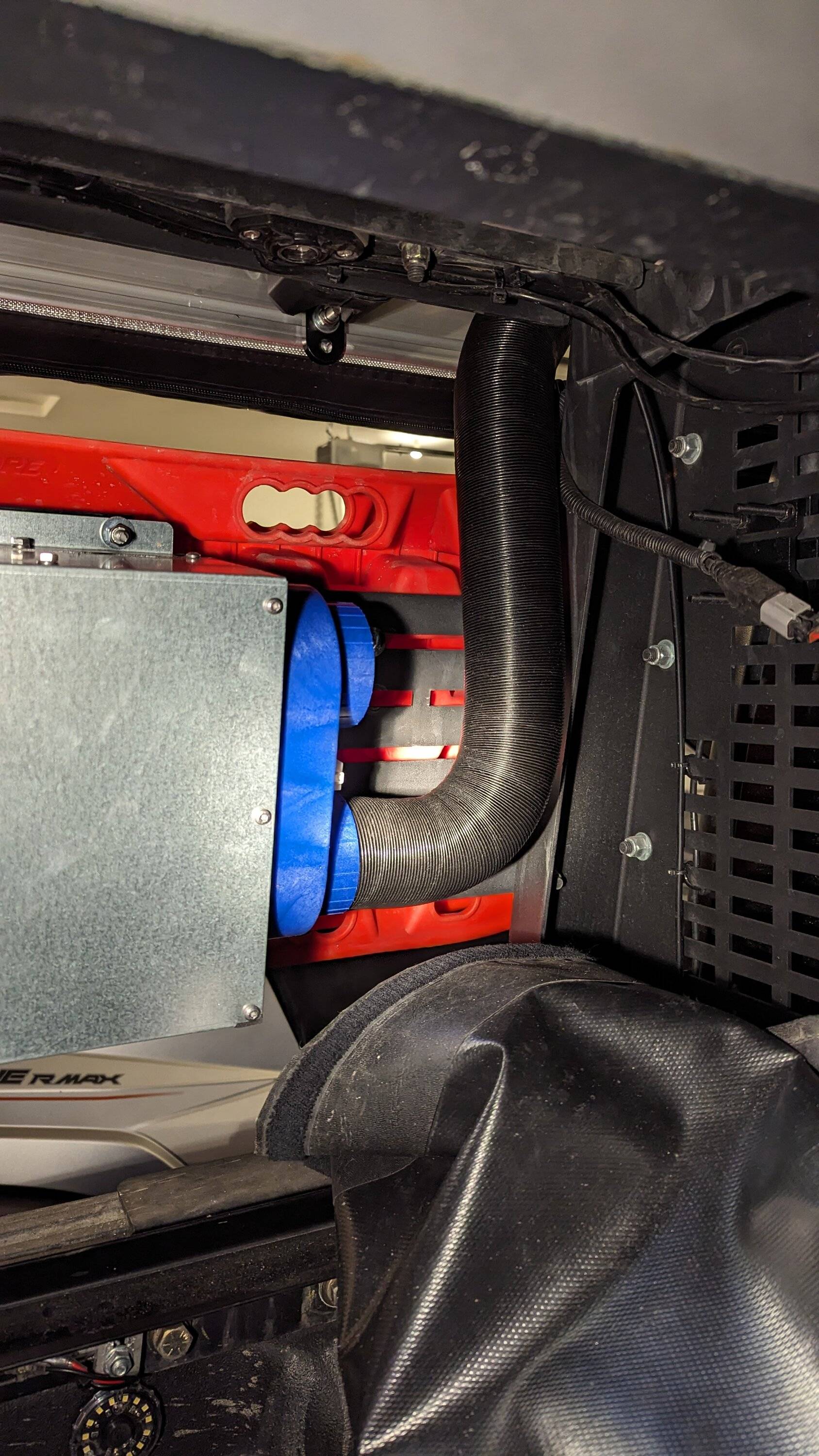

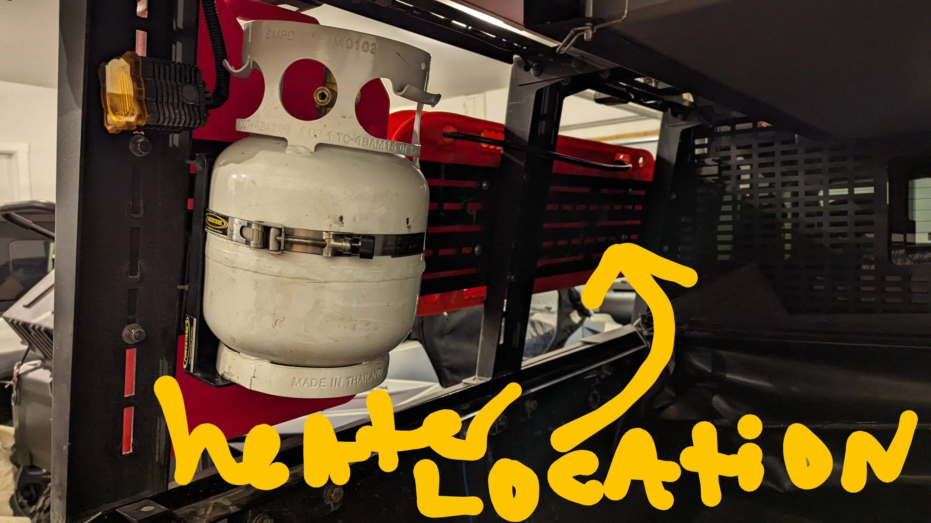

This allowed space to be created to vent the exhaust, bring in fresh air, and make room to send the tubes up to the tent. In this pic below, the yellow arrow shows where the combustion pipes will mount and be secured. The blue lines show roughly how the hot air and cold return tubes will run up to the tent window on the side.
Jeep Gladiator Alaska Daily Drivers: Hydro Blue 80A and Bright White JTR PXL_20240111_043255256~2

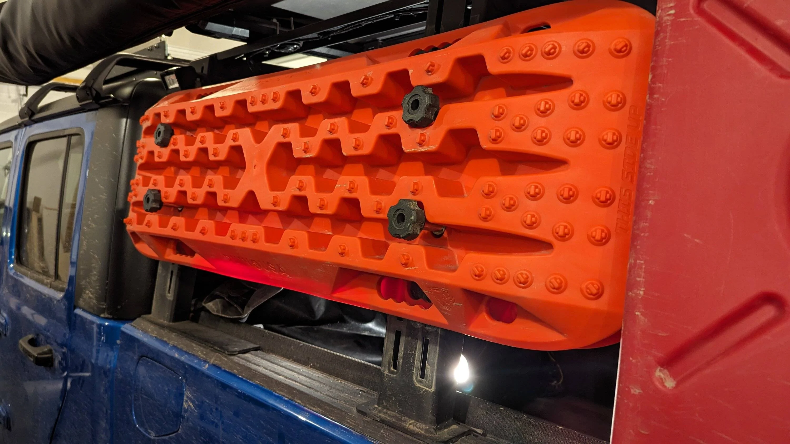

I removed the gear that was on the inside driver side of the rack to make room for the heater. The traction boards will help protect the heater while driving:
Jeep Gladiator Alaska Daily Drivers: Hydro Blue 80A and Bright White JTR PXL_20240111_043306775
Jeep Gladiator Alaska Daily Drivers: Hydro Blue 80A and Bright White JTR PXL_20240111_043306775~2

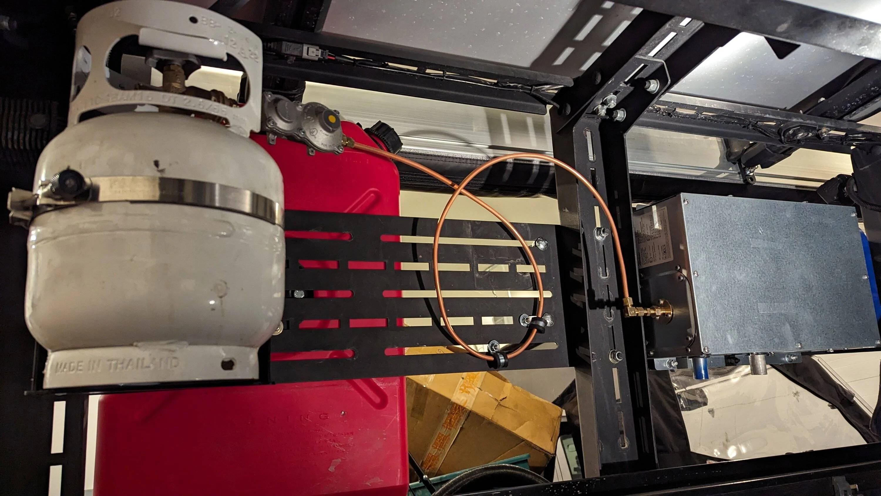

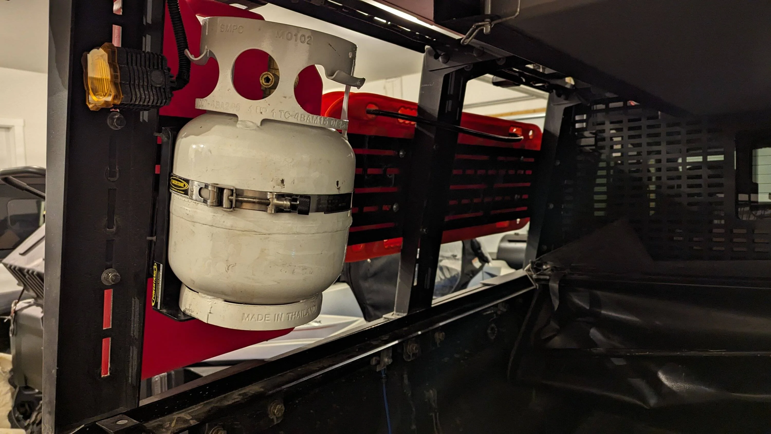

The new passenger side setup:
Jeep Gladiator Alaska Daily Drivers: Hydro Blue 80A and Bright White JTR PXL_20240111_043323127
Jeep Gladiator Alaska Daily Drivers: Hydro Blue 80A and Bright White JTR PXL_20240111_043340395

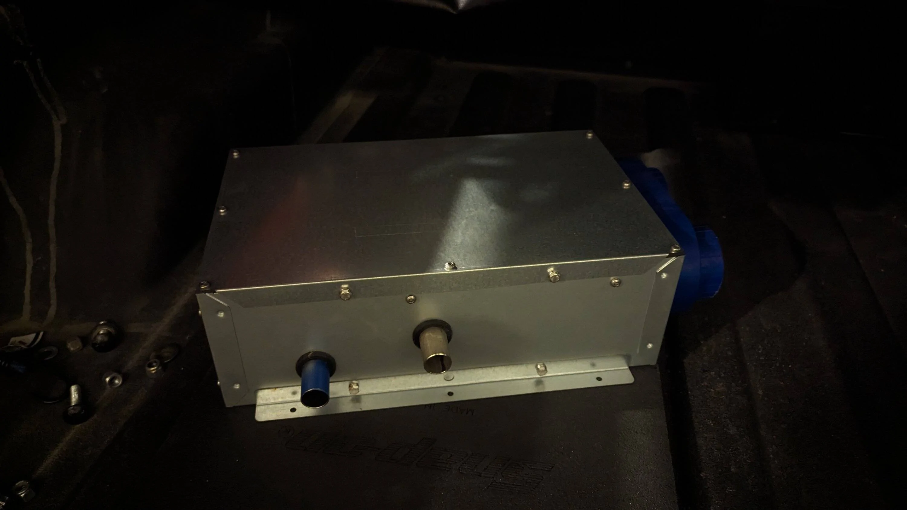

This is what the heater itself looks like ?

PROPEX HS2211 FURNACE TECHNICAL SPECIFICATIONS
HEIGHT 9.06″ (230mm)
WIDTH 6.18″ (157mm)
LENGTH 16.93″ (430mm)
WEIGHT 16.98 lbs (7.7kg)
HEAT INPUT 6824 BTU (2.0 kW)
VOLTAGE 12V DC
CURRENT CONSUMPTION 1.7 A
I do not believe you could swap it within the box, but I believe you could just change the mounting brackets to mount it mirror image to get the same result.

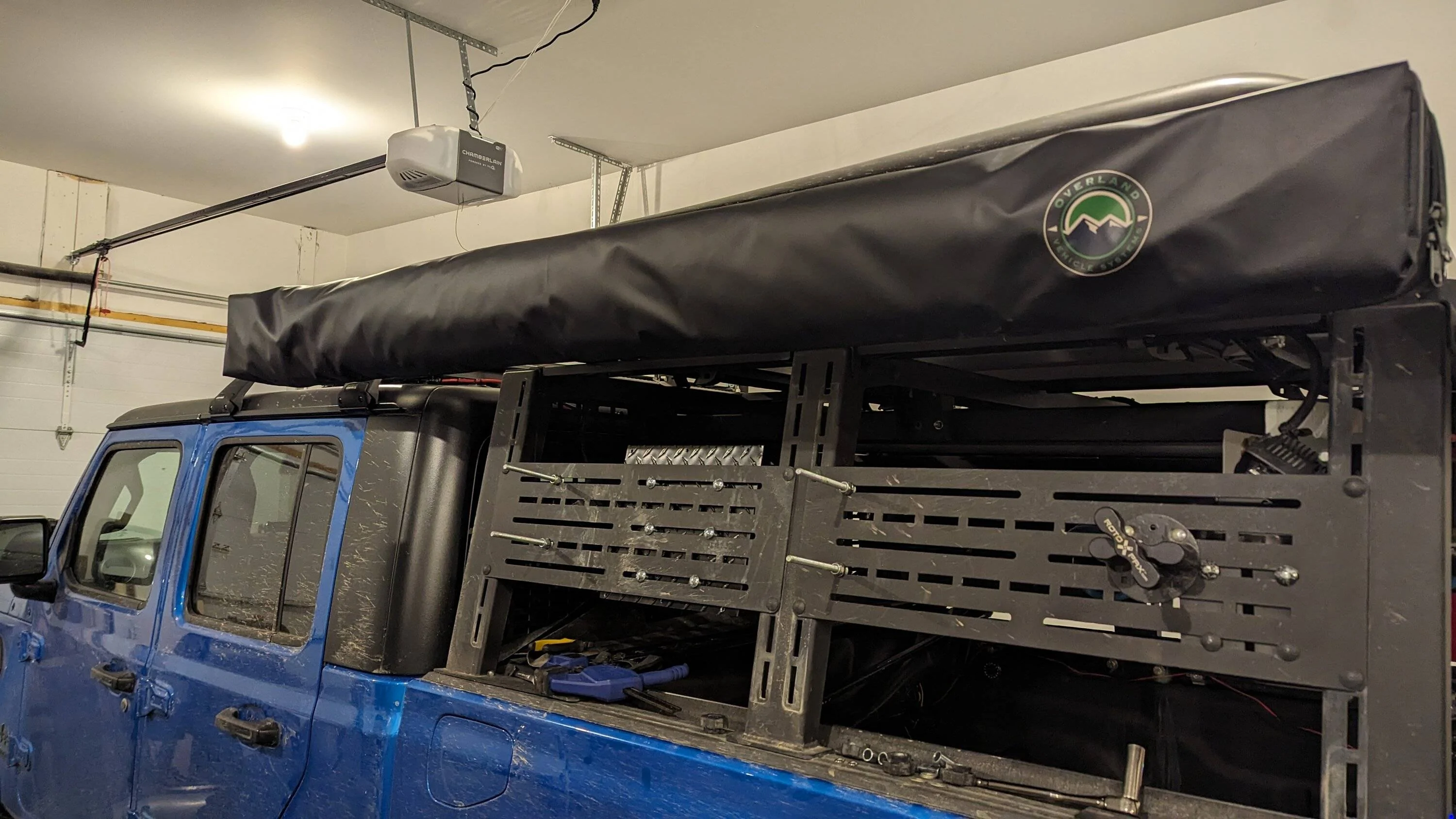

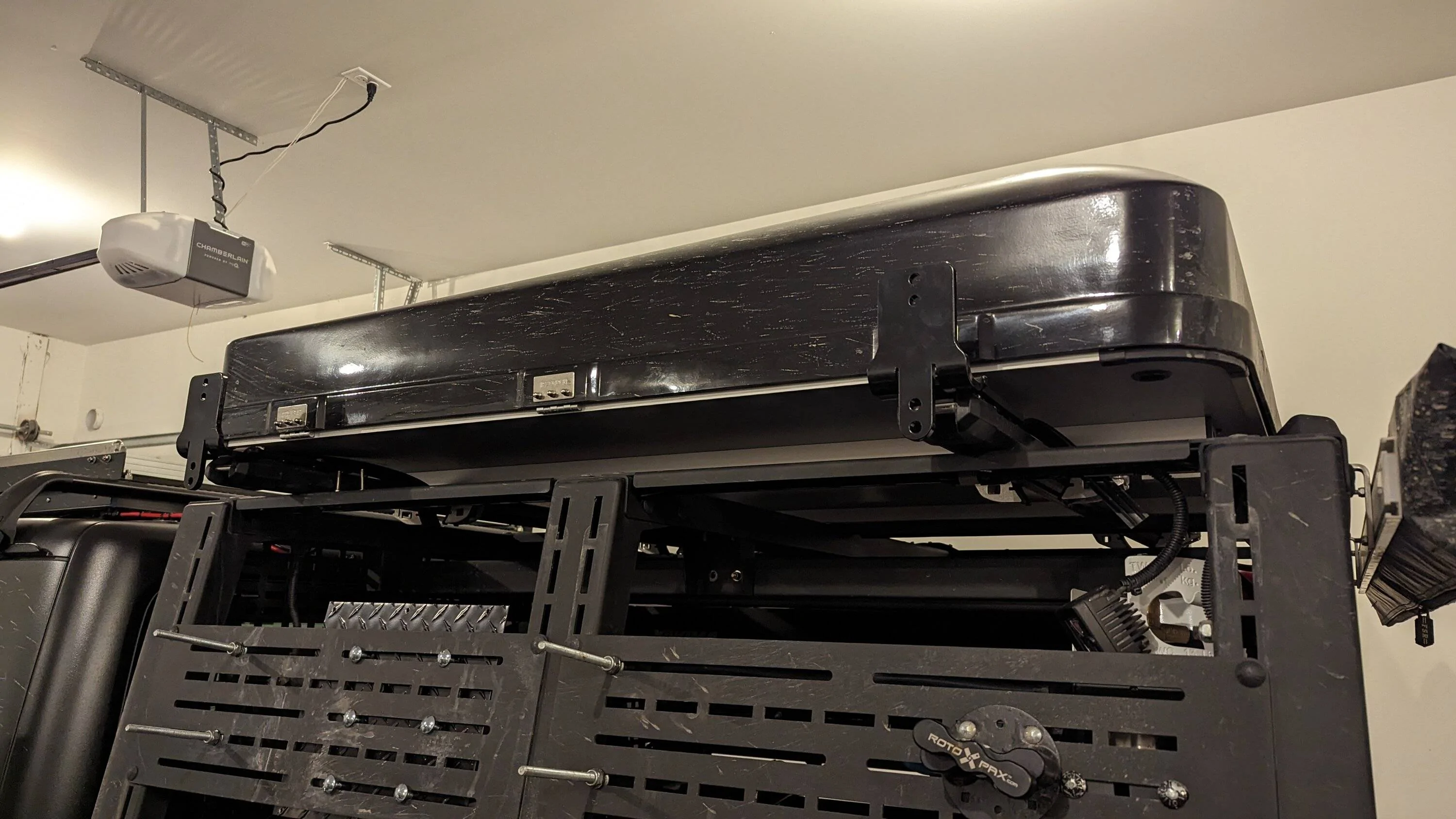

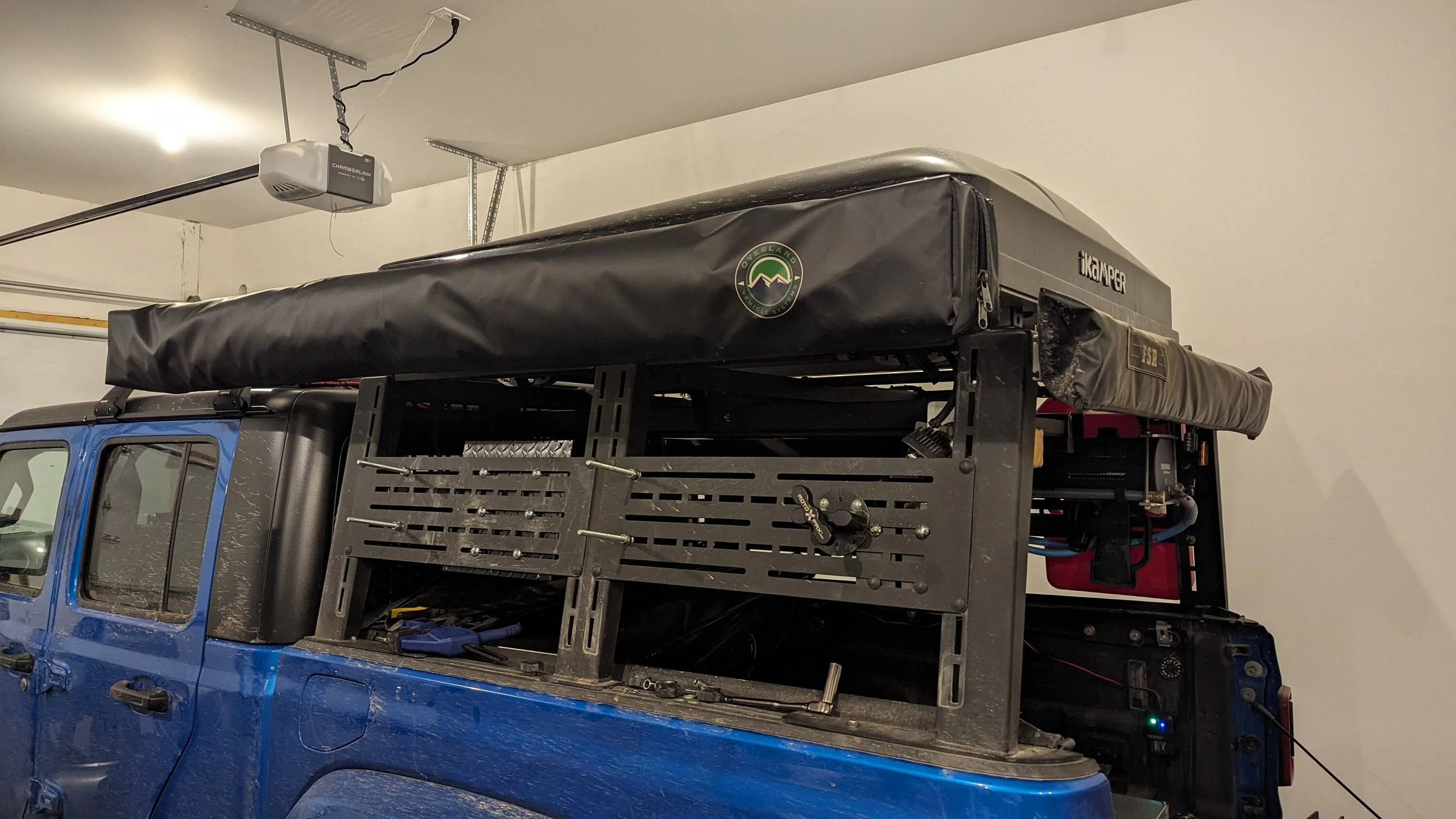

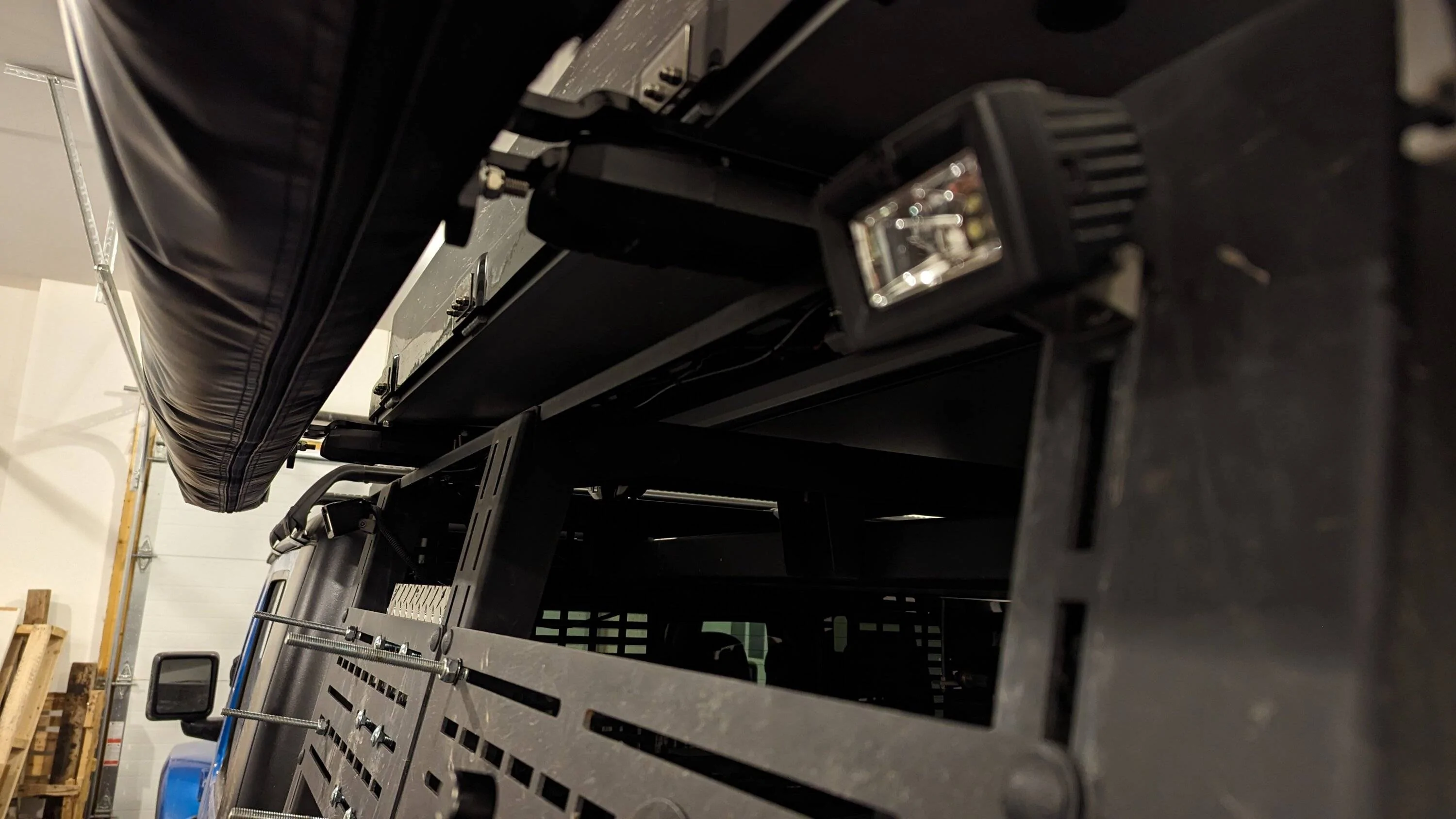

The Propex install continues! But not before getting the OVS 270 awning in place first to make sure everything will work together.
..and it does! We still need to open the awning and align everything, but we feel it's pretty close. The rear awning may or may not stay. They obviously won't work together but having both gives us flexibility based on space.
Got the brackets in place, had to move the scene lighting as well.
Jeep Gladiator Alaska Daily Drivers: Hydro Blue 80A and Bright White JTR PXL_20240113_024258819.MP
Jeep Gladiator Alaska Daily Drivers: Hydro Blue 80A and Bright White JTR PXL_20240113_030639654
Jeep Gladiator Alaska Daily Drivers: Hydro Blue 80A and Bright White JTR PXL_20240113_030647687
Jeep Gladiator Alaska Daily Drivers: Hydro Blue 80A and Bright White JTR PXL_20240113_032633248

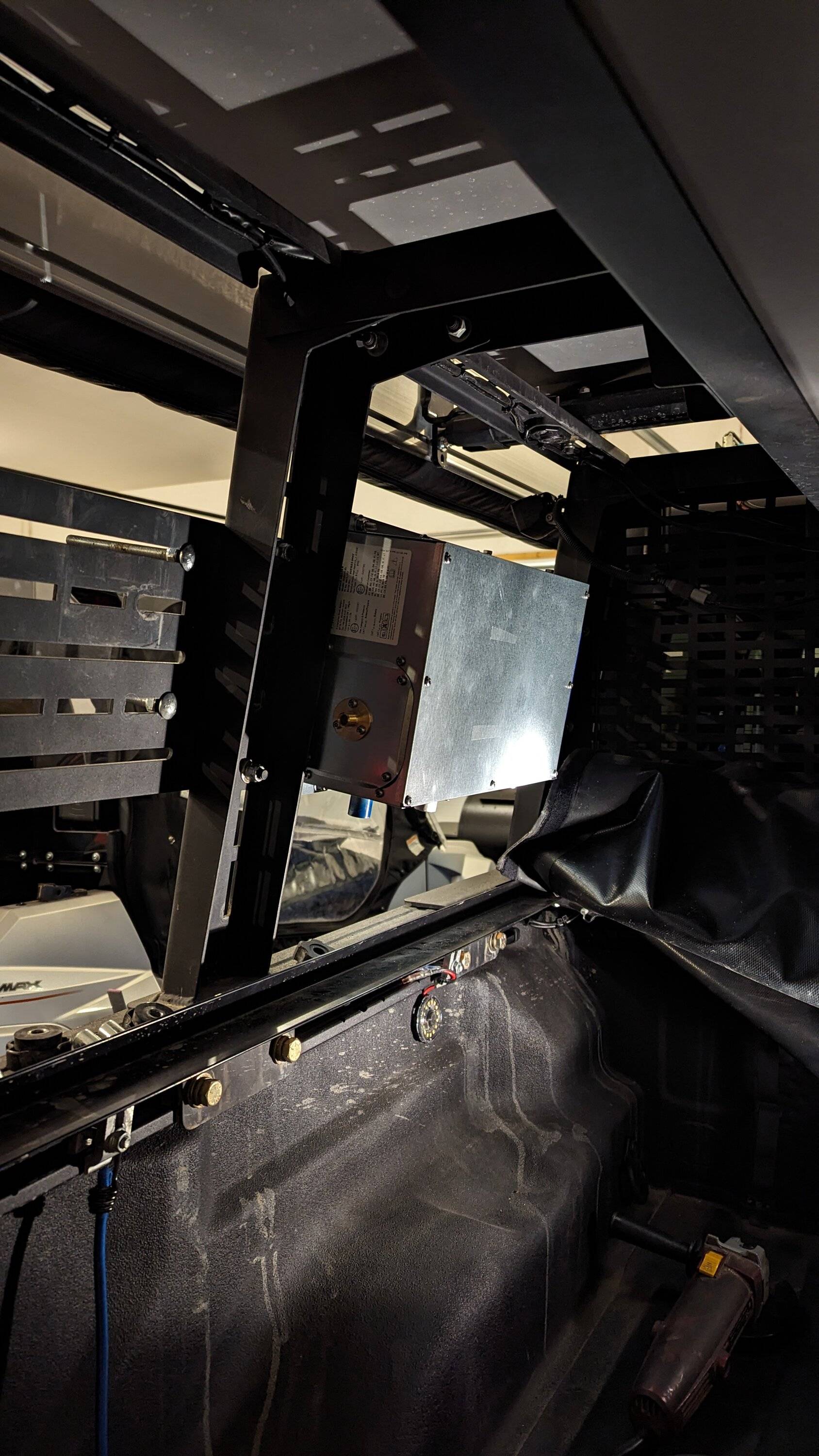

The heater is mounted!
Jeep Gladiator Alaska Daily Drivers: Hydro Blue 80A and Bright White JTR PXL_20240113_044644316
Using this piece of aluminum:
Jeep Gladiator Alaska Daily Drivers: Hydro Blue 80A and Bright White JTR PXL_20240113_044653429
Which gets completely concealed and protected by the traction boards:
Jeep Gladiator Alaska Daily Drivers: Hydro Blue 80A and Bright White JTR PXL_20240113_044932136

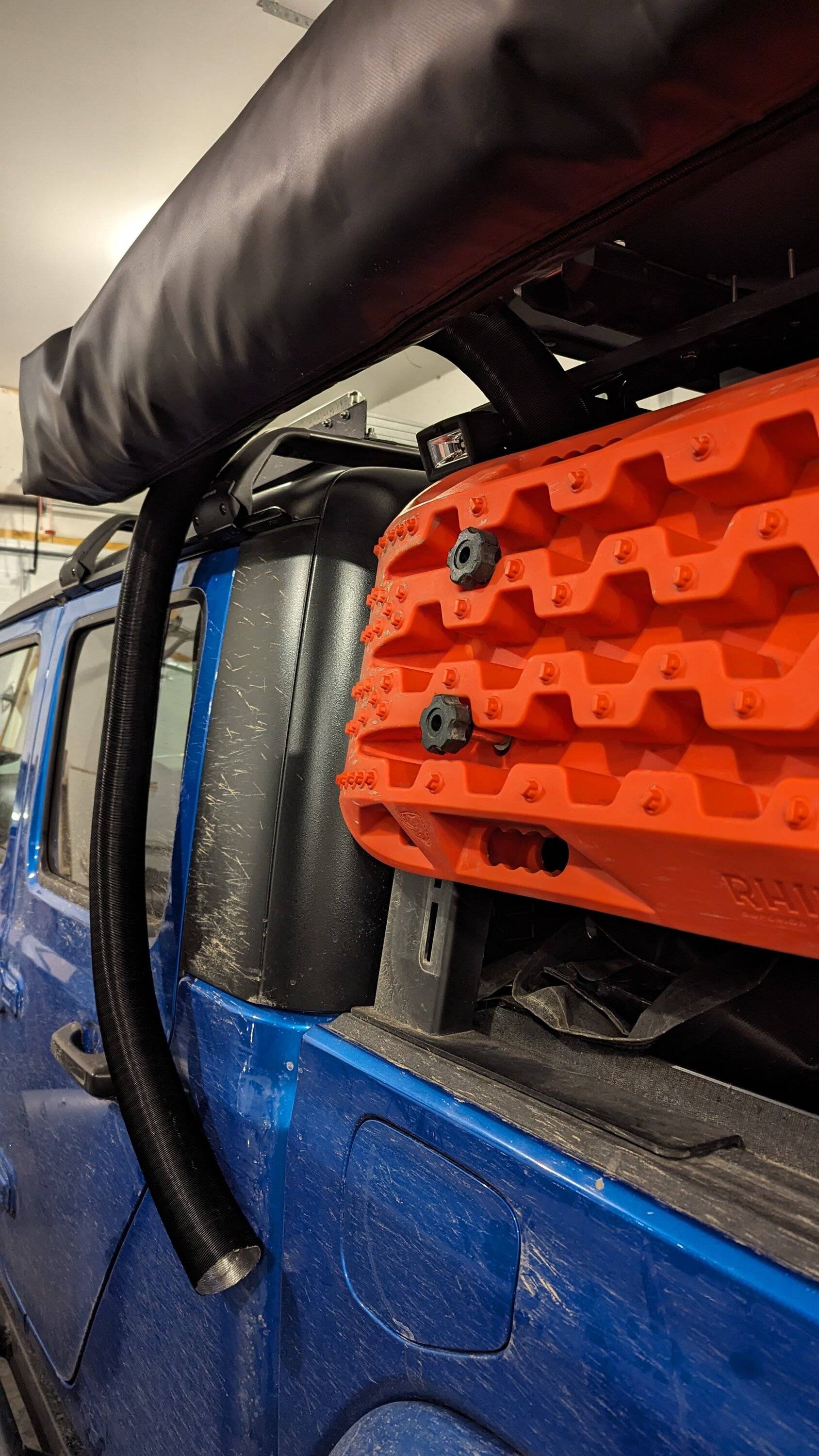

Test fit of one of the ducts that will run up to the tent:
Jeep Gladiator Alaska Daily Drivers: Hydro Blue 80A and Bright White JTR PXL_20240113_045834815
It fits with the awning with no issues:
Jeep Gladiator Alaska Daily Drivers: Hydro Blue 80A and Bright White JTR PXL_20240113_050137906

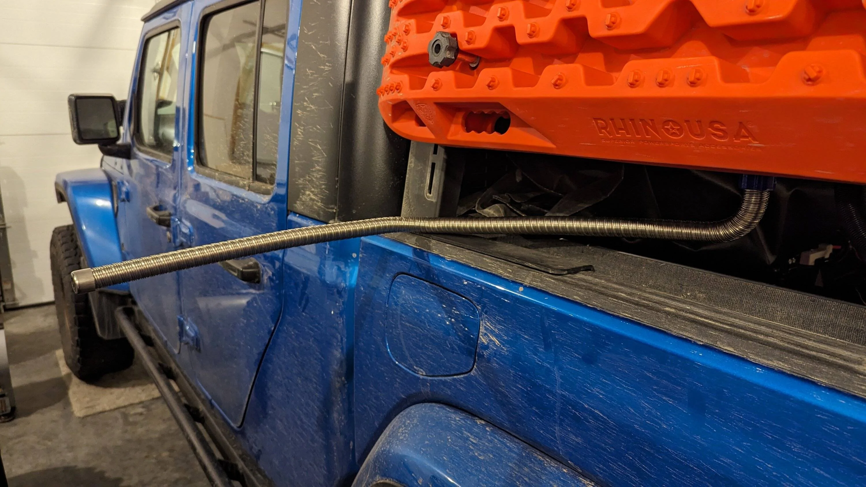

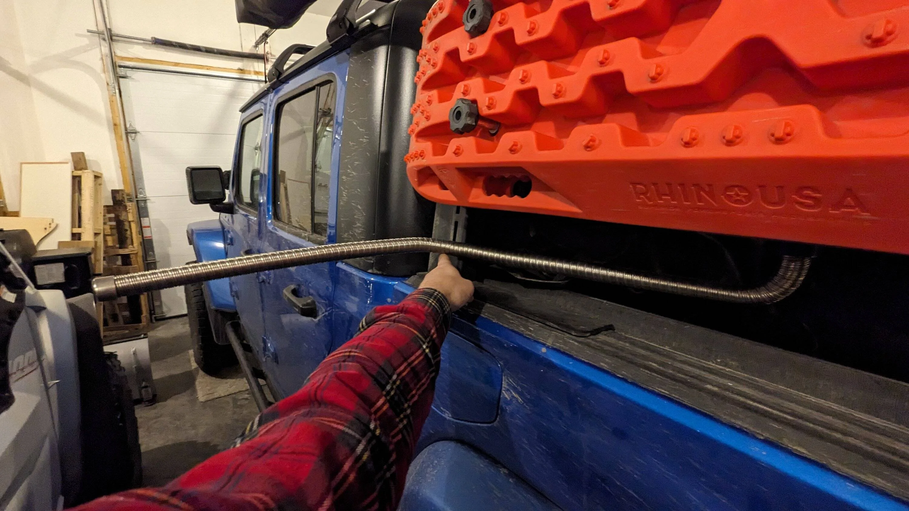

Test fit the combustion pipes:
Jeep Gladiator Alaska Daily Drivers: Hydro Blue 80A and Bright White JTR PXL_20240113_050501815

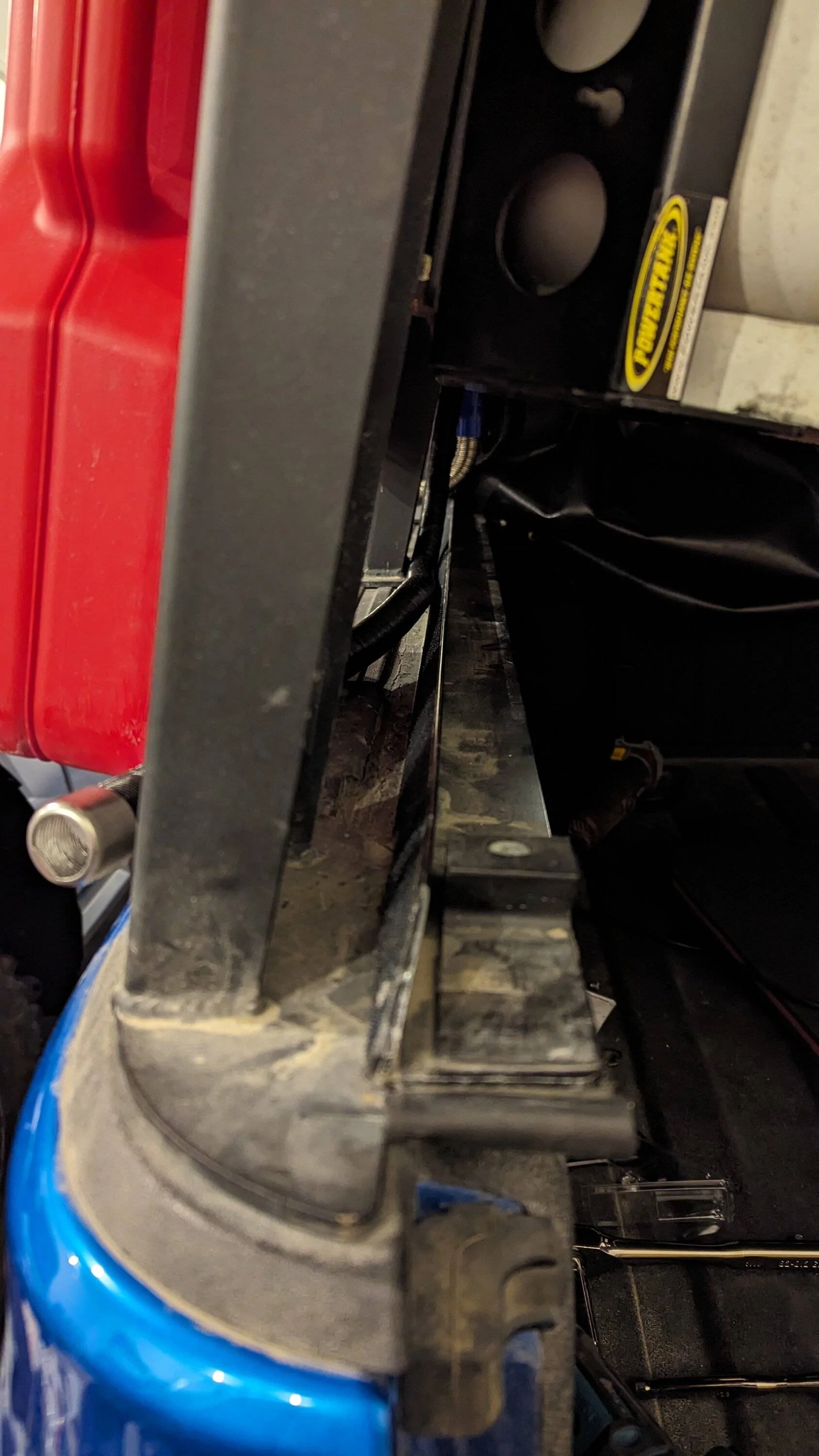

Not sure what to do with the exhaust just yet, thinking it thru:
Jeep Gladiator Alaska Daily Drivers: Hydro Blue 80A and Bright White JTR PXL_20240113_050708001
Jeep Gladiator Alaska Daily Drivers: Hydro Blue 80A and Bright White JTR PXL_20240113_050719229.MP

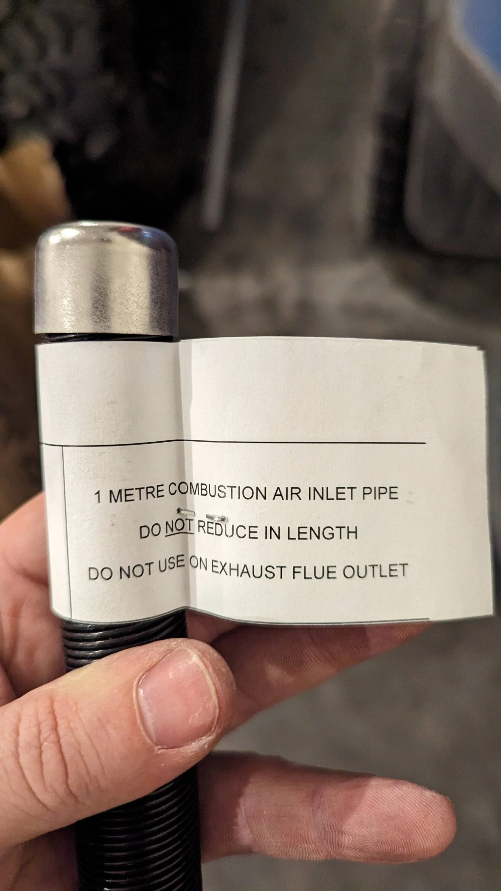

The thing to keep in mind are all of the rules they document for the pipes, one of which is this:
Jeep Gladiator Alaska Daily Drivers: Hydro Blue 80A and Bright White JTR PXL_20240113_050815980.MP
Plumbed in the propane. Tmrw I'll cobble the wiring together for a test after soaping the propane connections for leaks. I put in a nice large loop to allow great flexibility, serviceability, and ability to remove the propane tank easily.
Jeep Gladiator Alaska Daily Drivers: Hydro Blue 80A and Bright White JTR PXL_20240113_060245629
