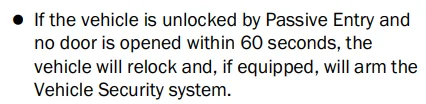

If you turn the truck off, open the door and get out with key, walk away, it should lock itself.
The PE auto relock setting is for instance, if the doors are locked, and you grab the handle to passively unlock the doors, but you don’t end up opening any doors, they will automatically relock after a minute.
I knew they did that - I think it's in the book. BUT - Didn't know that's what that setting was.
I thought that was the default setting, it's in the book.

So on my 2022 which came factory with passive entry, that should be set to yes from the factory.
Does AlfaOBD pick up on your 2022 BCM variant when you connect to it, or do you have to force it to connect after the missing ISO pop up?
If you go to change that setting, does it tell you then that it’s currently set to “no”?
Do your doors automatically relock if you perform the above example?

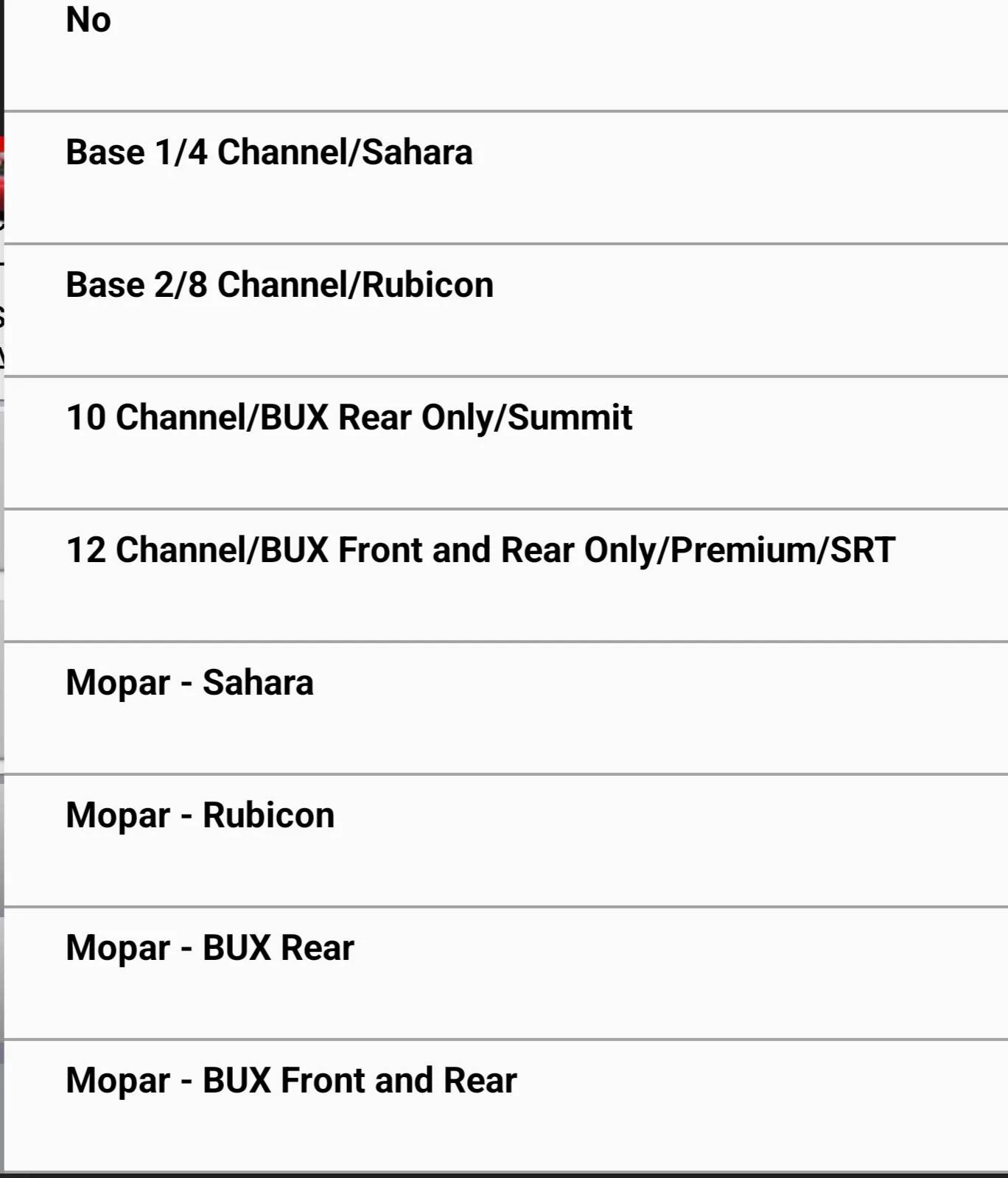

Some interesting BCM differences between my truck and a fully loaded Rubicon:
Park Assist Tuning Set:
Rubicon: Base 2/8 Channel/Rubicon
Mojave: Base 1/4 Channel/Sahara
The Mojave is more like the Rubicon height wise than the Sahara. I have Park Assist. I wonder if me adding the steel rubicon bumper means I should change this to "Base 2/8 Channel/Rubicon"? I used the same 4 sensors that came in my plastic bumper and transferred them to the Rubicon bumper.

Parksense options...
Jeep Gladiator AlfaOBD settings Screenshot_20230118-095017_AlfaOBD
Why would Rubicon be different? Gotta be the steel bumper.... anyone with a non Rubicon with the factory rear steel option have a comparison?
Perhaps the Rubicon has them angled differently? I can't imagine the harness or the sensors are any different between plastic and steel Parksense. My harness and sensors went right in to the steel bumper as clean as factory.

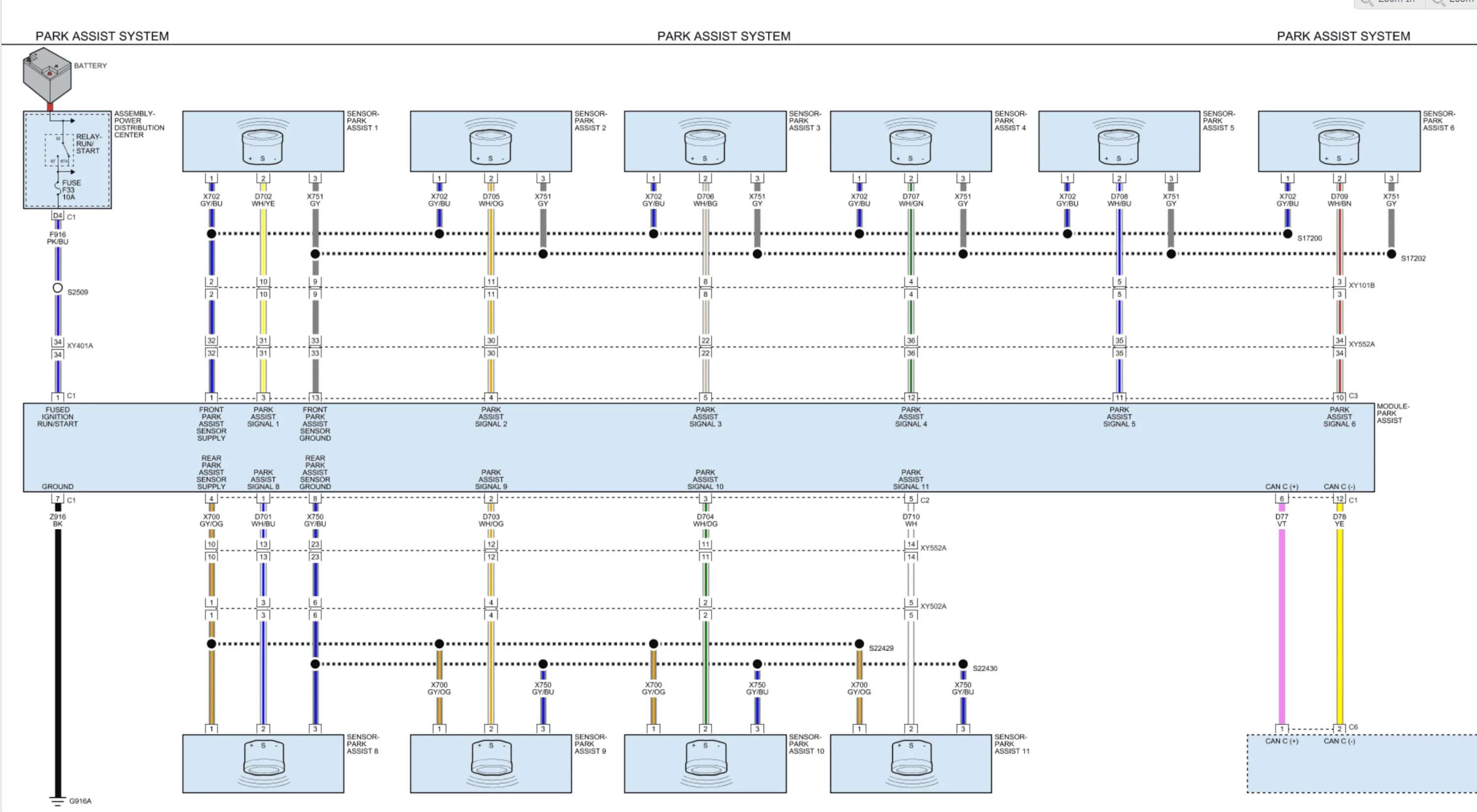

LOL - wiring manuals from FCA aren't all that:
Anyone have a JT with 9 Park Assist sensors and Front Park Assist? wtf...
Obviously that content is shared with European models or other Jeeps.
The steel eBay knock-off bumper does have sensor holes. There's gotta be a reason those bumpers from China have sensor holes - EU? Did any Wrangler come with front park sensors? So much of "what's out there" as far as documents related to wiring seem to come from the Wrangler world.

Attached the connector map diagram and sensor 1-6 are on the front bumper and 8-11 on the rear bumper. Funny thing, I find no reference to a number 7 sensor and seems to have been skipped over.

Yeah, got to be a European thing.
Sensors 7 & 12 are reserved for the rear bumper for stellantis vehicles that have parallel and perpendicular parking assist.

Perhaps like Grand Cherokee that can park itself?
