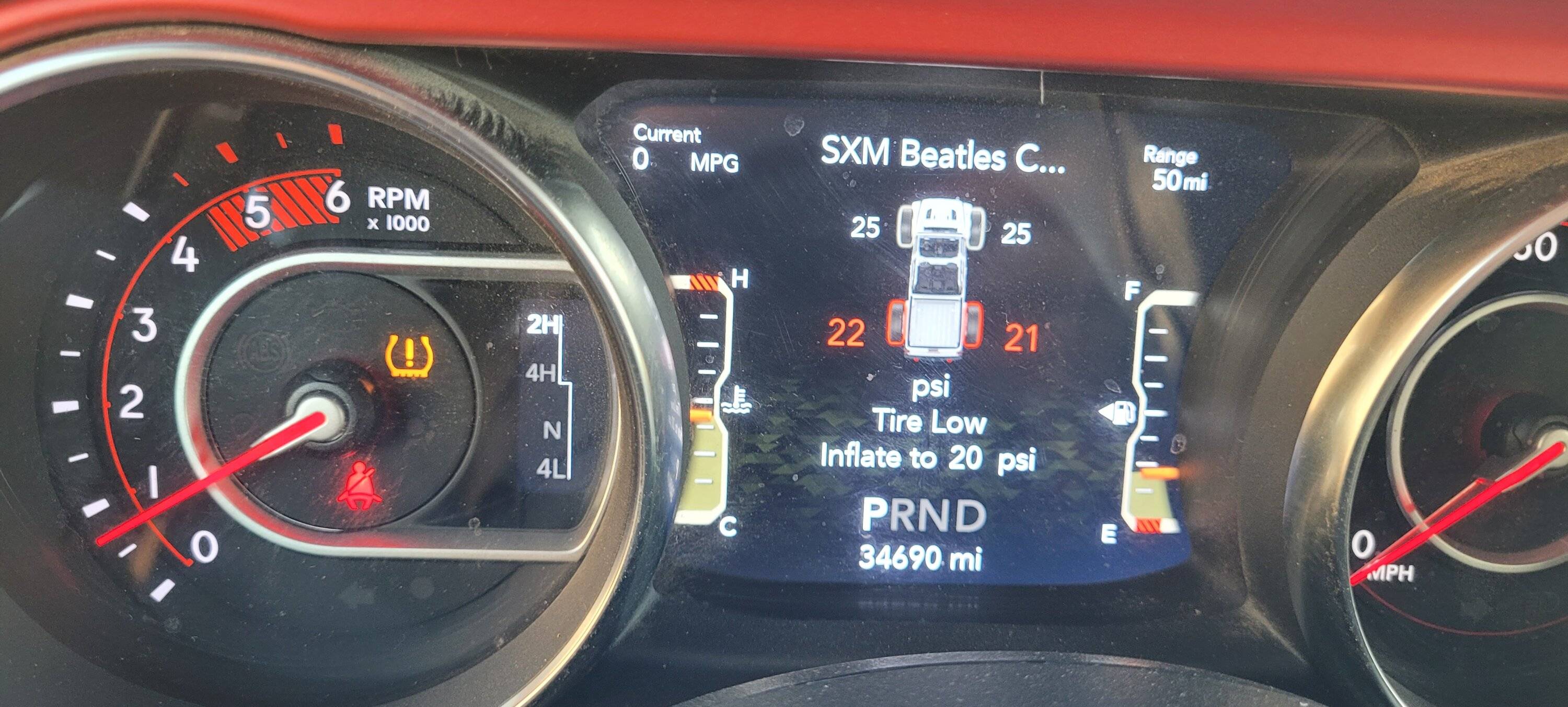

OK, changed "Max Load Inflation" today, but I still show needing to be inflated despite my actual pressure exceeding the minimum set point? I also dropped the rears to 18 and back up to 21 just to see if raising to the threshold would help.

Max load inflation is the normal tire inflation rate.
The thing triggers when the tire inflation drops something like 20%
I set mine to 35 and now they have to drop to below 28 before it triggers the warning.
(I normally run my tires at 36 or so - but it won't take 36 in JSCAN)
Leave the minimum at 0 - don't mess with that one.
Only change the one setting - Max Load Inflation Pressure Front / Rear Tire

I left everything else that way it was this time , but lowered the Max setting to 20psi. You can see the icon and the rear tires are in red indication I have low tires.

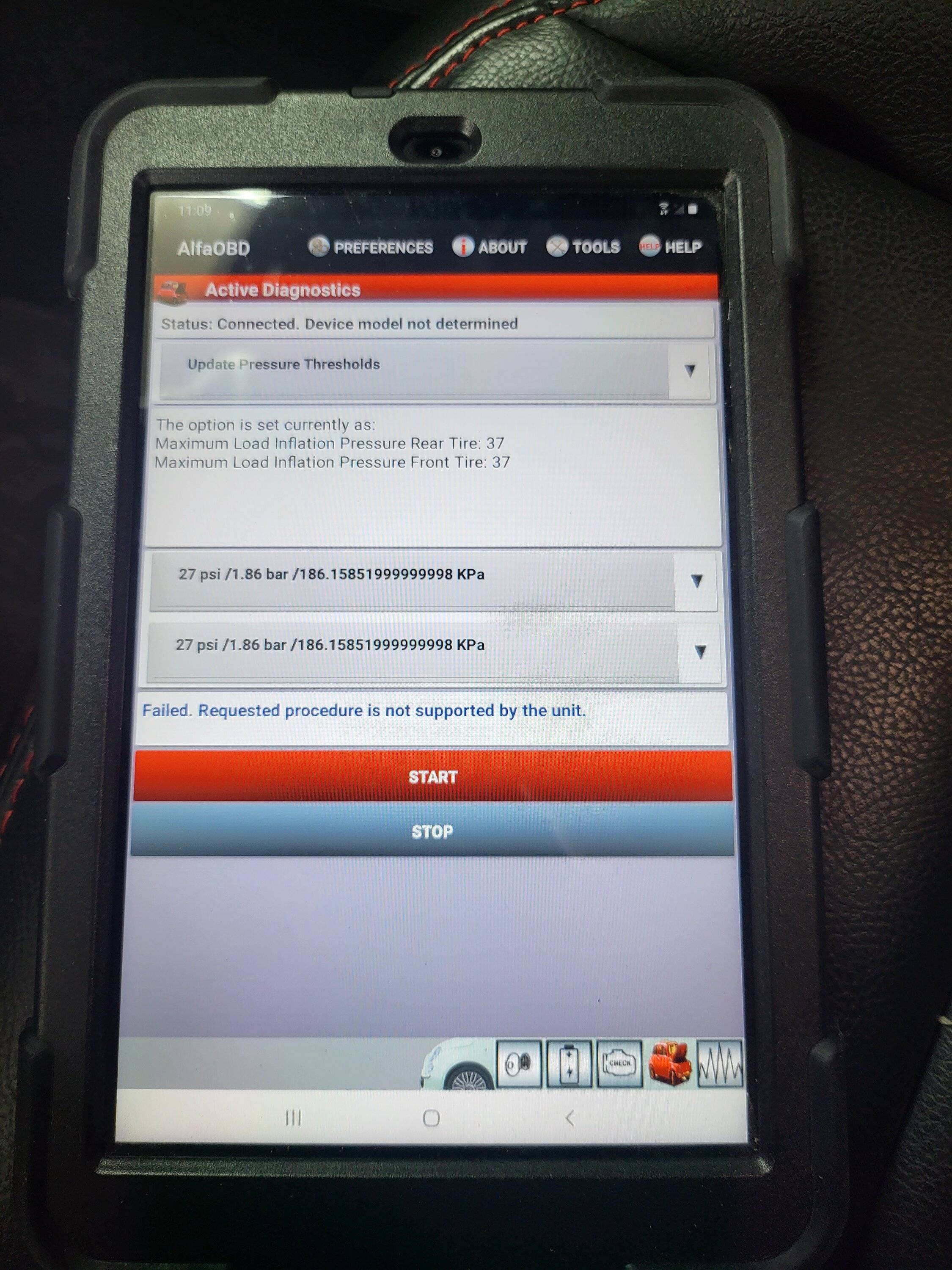

I tried adjusting my pressure thresholds and tire size, on a 2022 JT Rubi. I'm using ECRI to bypass thresholds SGW module,and OBDlink MX+ for connections. I got an error message when attempting to connect to the BCM; however, after reading posts on here about this issue, I tapped continue. When I attempt to change pressure thresholds or tire size, I get an error. "Failed. Requested procedure is not supported by this module." Any suggestions?

Deleted member 51947
Below is the message I received from AlfaOBD, if you get the error message in the picture I posted.
Hello,
The app can’t properly detect the body computer model, most probably because it is missing from the app database. Please record debug log of the connection to the BCM for me to detect the BCM model and to add it to the app database.
To record the debug lo9g, enable the “Debug data recording” option in the app settings and connect to the BCM. After the recording use the Tools screen to send the debug log to me.
Regards,
Alexey

Not yet - still things it can't/won't do on my 2022.
