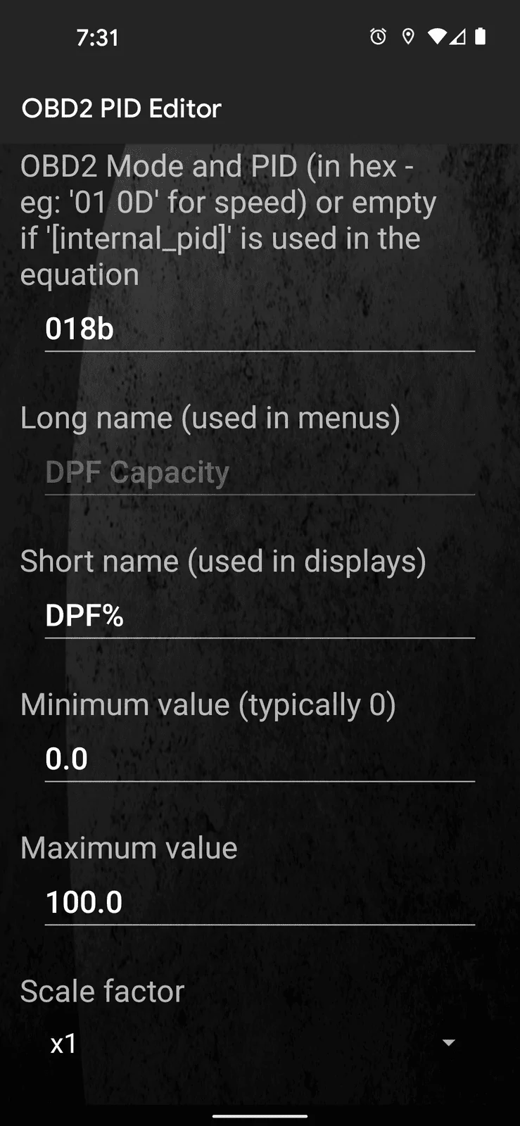

I'm in the same boat. This PID had worked for me in the past but now always shows 100%.
I got the same problem and settings look ok?

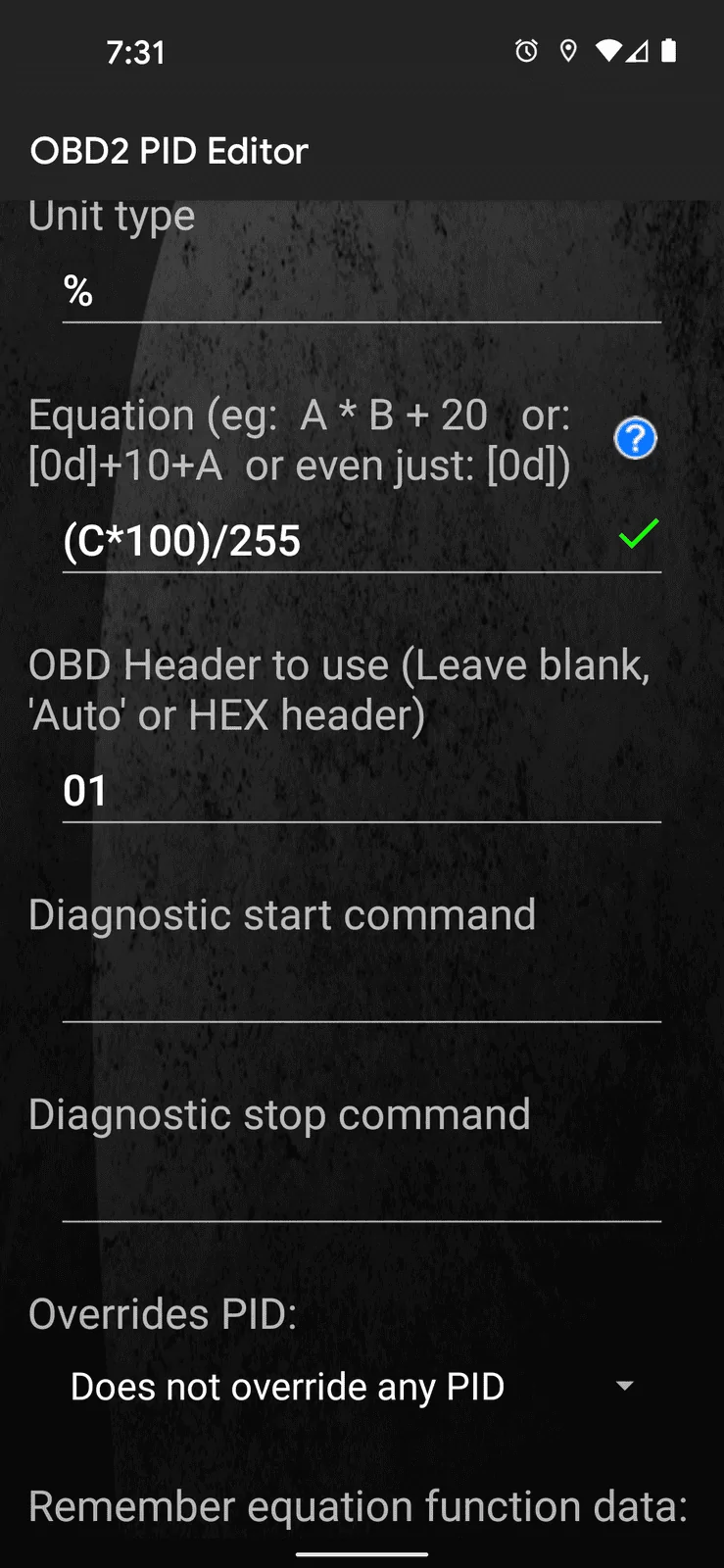

I actually got the PID to work again in the Torque app. Did a couple of things so not exactly sure which one "fixed it". I put 01 in the OBD Header field and clicked Reset on the Remember function data field. I haven't tried a custom PID in OBD fusion yet. I used the SAE built-in PID for Regen status and it worked once but then was stuck at ?.

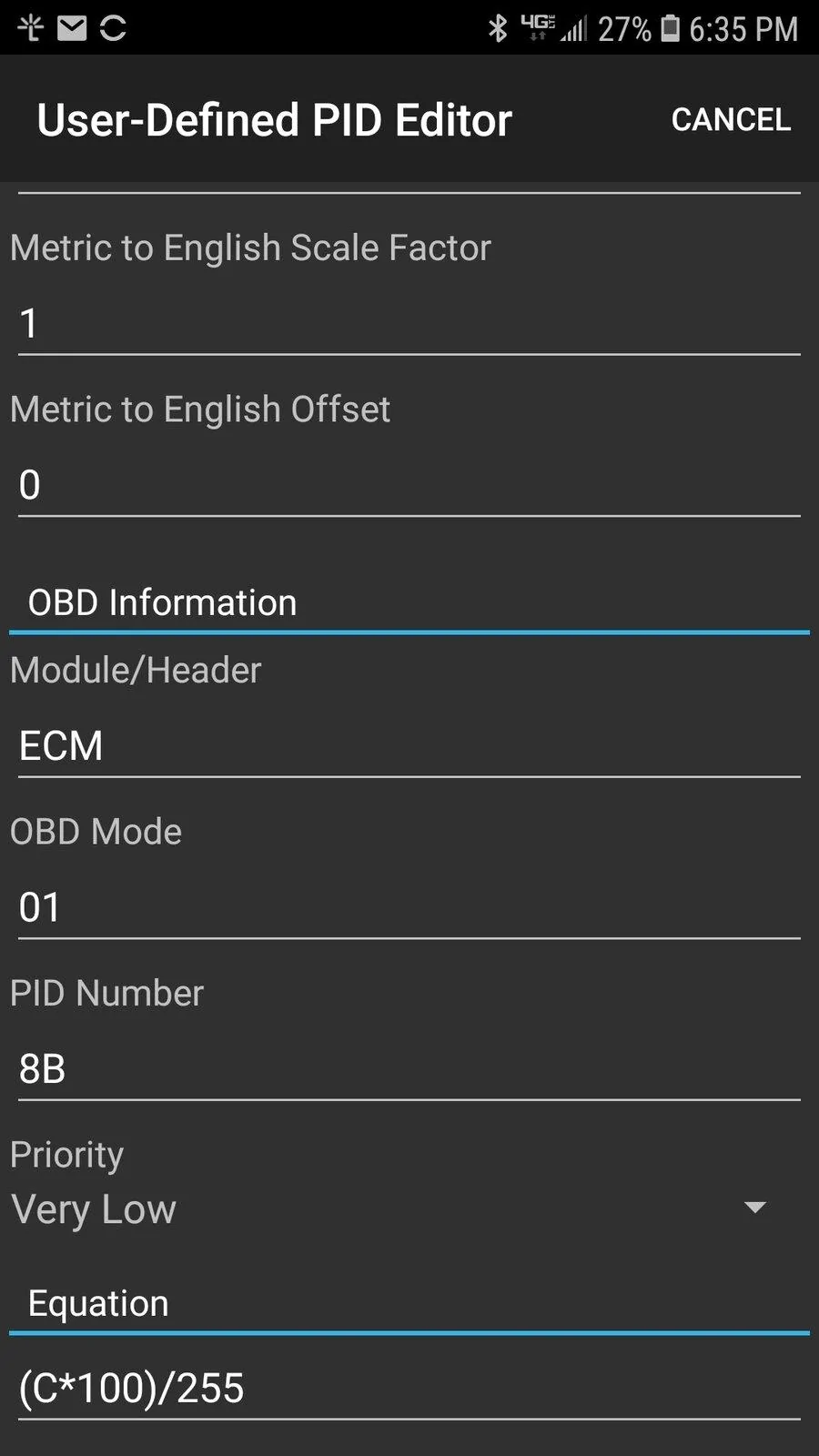

I tied my OBD Fusion to my Dropbox account which makes it easy to import/export. The 2 files you attached worked like a charm, thanks!
I would have never been able to figure out any of those User-Defined PIDs that are in there. I'm comparing some of them to the provided SAE PIDs and I am seeing some difference in readings so I have no clue how the formula's were created but at this point, who cares!

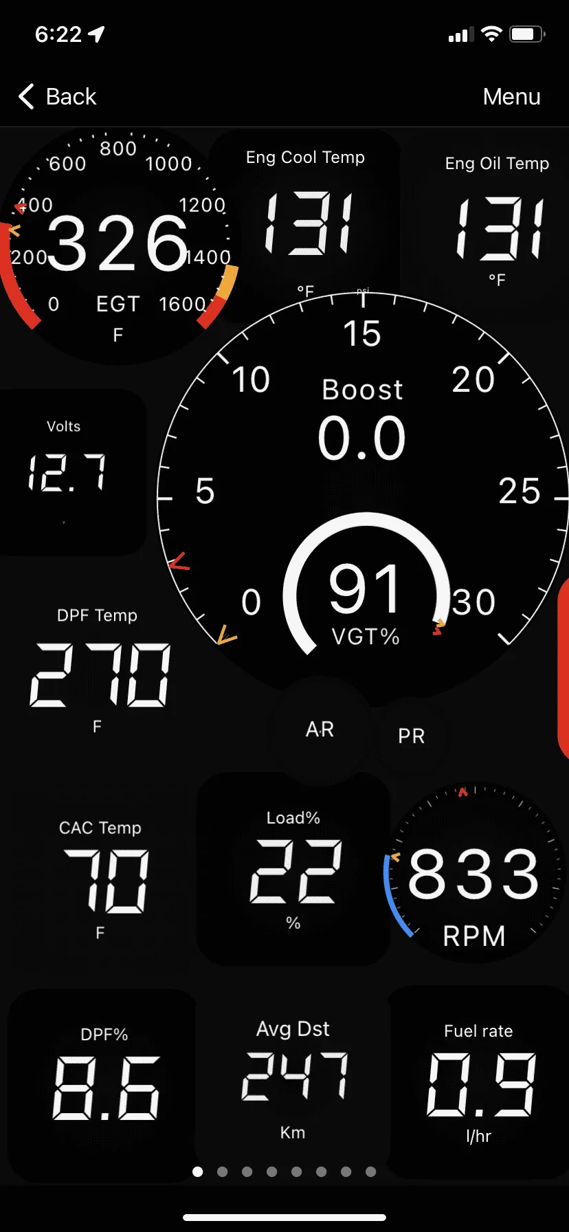

Ok so I got some good results I think:
Jeep Gladiator All Diesel Specific Talk/Topics 1644190828885
However what does Avg Dst mean? I cant seem to edit the unit type...AND if I'm reading this correctly my DPF is only 8% (I had an ARegen the night before)...

Looks like you got it up and running.
Avg Dst = average distance between regens, this dashboard was created by someone on the RAM forums that may not have been in the USA hence the metric readings.
Seeing that your DPF% is at 8.6 that tells me you just completed an Active regen, that's the exact value mine always shows after an A.R. completes.
I created a few different dashboards that show turbo inlet and outlet temp along with DPF inlet and outlet temps. During an Active Regen the screen you are using does not seem to show the DPF Temp accurately, on the dashboard I created with separate DPF temps I see the temps in the 1,100 - 1,200 degree F range.
Also regarding what @CrazyCooter mentioned, I can't say I completely agree ... the DPF % on my setup seems very accurate between 8.6-80%. Once you hit 80% and the engine is full warmed up it will typically go into Active regen immediately and show DPF% as 100% until the Active Regen completes.
If you turn the engine off before the AR completes it will remain at 100% until another AR is completed (I'm actually in that situation as of this writing). I was dropping my kid at practice and I'm a coach so I couldn't drive around for another 10 minutes once the AR started.
I haven't figured out the sequence of events that needs to occur before the next AR kicks off, whether it's a certain number of engine starts or what. Since this last one I have driven on the highway at ~78mph for 30 minutes a couple of times and yet the AR won't kick in again (although OBD Fusion shows it in Passive regen the whole time).

So interesting...I'm back at 100% DPF again. Went and drove an hour on the interstate and no AR occurred. Also haven't had the message popup about continuing to drive...
