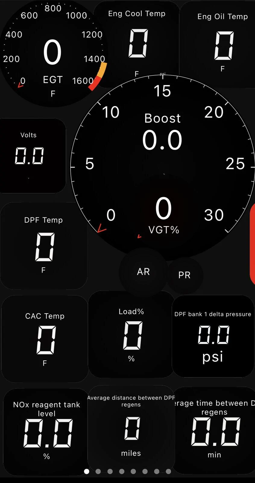

I tried to zip the .stg files I found on the Ram 1500 site. For some reason I could not export my current display and I had to zip the files because this site wouldn't let me upload the .stg file. I will try to post a current picture of my setup but here is the description.
With mine I played with different sensors and changed the bottom 3 to
PID NOx reagent tank level:
PID Averge distance between DPF regens
PID Average time between DPF regens
I changed the 3 above those to:
CAC Temp
Load %
DPF bank 1 delta pressure
The gauge above that to the left of the Boost is the DPF temp
Wow thanks jwalt! I'm still trying to understand the different PIDs and which ones are the correct ones to attention to, this will be a great setup. Will try it out and see how it works. Thanks again!
CAC Temp
Load %
I tied my OBD Fusion to my Dropbox account which makes it easy to import/export. The 2 files you attached worked like a charm, thanks!
I would have never been able to figure out any of those User-Defined PIDs that are in there. I'm comparing some of them to the provided SAE PIDs and I am seeing some difference in readings so I have no clue how the formula's were created but at this point, who cares!
I love being able to see the passive regen with the green circle and active in red (vs what I had that just turned a 0 to 1 🤪).

I tied my Dropbox account but I cannot seem to get the files transferred. Is there something i might be missing.
When you connect OBD Fusion to Dropbox it will create a folder Dropbox>Apps>OBD Fusion then inside the OBD Fusion folder will be an Import folder (and 2 other folders).
You will need to extract the zip file to the Import folder inside Dropbox. Then the next time you go to the Import Settings option under Settings inside OBD Fusion, then under OPTIONS you select Dropbox and tap < Back you should see the 2 .stg files "obd fusion settings 2018-05-29.stg"

I got the OBD Fusion app and was able to load the files. Everything seems to work great except the DPF%. It shows 100% all the time. I did some research and found this on the web.
PID: 018B
Long Name: DPF Capacity
Short Name: DPF %
Minimum value: 0
Maximum value: 100
Scale Factor: 1x
Unit Type: %
Equation: (C*100)/255
Mine has the PID as 8B instead of 018B. Everything else is the same. Can on of you guys confirm what the PID should be?
Mine is a User-Defined PID for DPF Capacity and I have the same:
PID Number 8B
EQUATION (C*100)/255
It appears to be the same as the one that I imported from JWalt
One thing I did notice is that the DPF Temp from the RAM settings is not even close to what it should be, I created a new Display and added the SAE PID "DPF bank 1 inlet temperature sensor" and another with the outlet temp. When going into Active Regen I see these 2 temps rise upwards of 1,250F where the RAM DPF Temp stays in the 600-700 range.
PID: 018B
Short Name: DPF %
Minimum value: 0
Maximum value: 100
Scale Factor: 1x
Unit Type: %
I'm in the same boat. This PID had worked for me in the past but now always shows 100%.
BEERviper
Jon
Nov 9, 2020
197
164
Longmont, CO
2021 Jeep Gladiator SS eco Diesel
Real Estate
Yep just change that PID to 8B and you should be all set.
