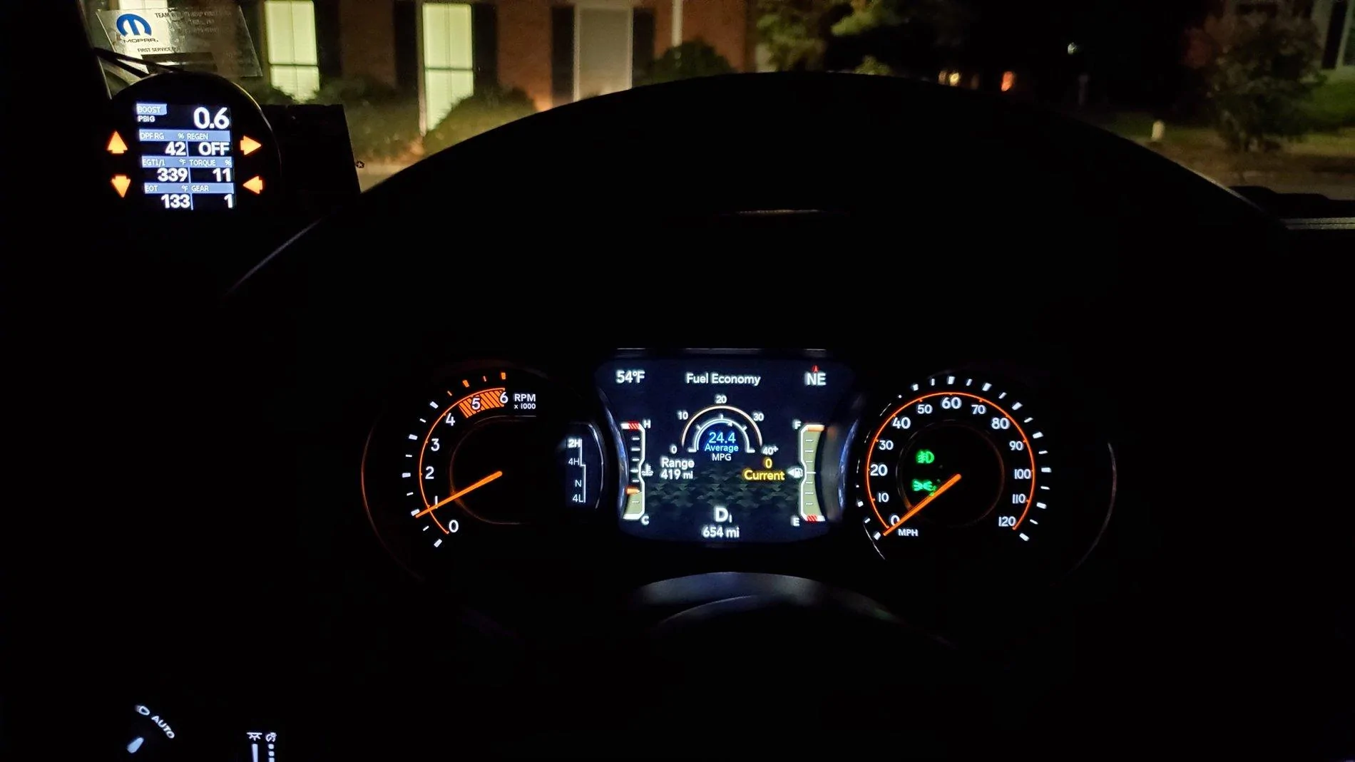

I purchased a Banks iDash for my Diesel Gladiator last week. I love it. I can monitor the boost pressure, Regen status (Off, Passive or Active), DPF soot load %, and a ton of other stuff. Really worth it, especially because I do a lot of city driving.

I purchase a Banks iDash for my Diesel Gladiator last week. I love it. I can monitor the boost pressure, Regen status (Off, Passive or Active), DPF soot load %, and a ton of other stuff. Really worth it, especially because I do a lot of city driving.
Would be interesting in which model? How easy was the install? Where did you mount it? Thanks!
Sure! It is the Banks iDash Super gauge (https://www.bankspower.com/i-2591-b...one-for-all-2008-obdii-can-bus-vehicles.html#!) # SKU: 66560 Super easy install: plugs right in OBD II port under the steering wheel. I routed the cable up behind the dash to the lower left corner of the windshield where I will be mounting it. (I have it ziptied to the A pillar right now while the mount comes in) I highly recommend this for anyone who wants to monitor their emissions and other useful specs like oil temp, etc. I know it is more expensive than the Scangauge but it looks much better on the dash. You can even program the colors to match the jeep gauges.
Thank you very nice!

Which mount did you end up ordering? I have the pedalmonster on my JT diesel but I held off on the gauge because I didn't find anything besides the window mount suction cup and they always fall off when I go offroad?
I bought a cheap metal one and was going to mount it but then decided not to drill into anything so I actually have the Banks mount with the suction cup. I couldn't find a JL or JT gauge pod anywhere online, otherwise I would have done that. We'll see how it holds up.

I have only had my truck for a week and have driven it about 650ish miles (city, backroad and highway) here is what I have learned about the regen.
- Nothing about regen status has ever been displayed on the Jeep gauge cluster, you need an aftermarket monitor to see all of the regen activity.
- From what I can tell on my Banks iDash, once the truck gets up to temp it is doing passive regens while you drive, even at lower speeds like 30 or 40mph. This seems to keep the soot load the same % or slowly drop the percent.
- Now, once you get the soot load in the filter up to 80% it will do an active regen while you drive. I had this happen to me on Thursday and it took only 8 minutes. I was driving on backroads at 45 - 50 mph and it brought the filter load down to 8%.
- As of tonight, I am currently up at 45%. If you are on the highway all the time or drive some decently fast backroads to work, the soot load will stay low because of the passive regens. However, if you are like me and do a lot of "city" driving at short distances, I would recommend an aftermarket gauge so you know when you need to allow the Jeep to do an active regen when you get close to 80%.
- Right now I think ill be doing an active regen every 2 weeks. I have a 1 mile commute to work so the truck could go days without getting up to temp. Hard to tell though, still trying to track patterns.
