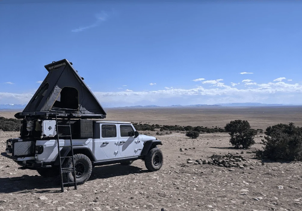

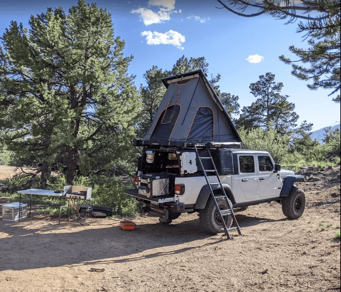

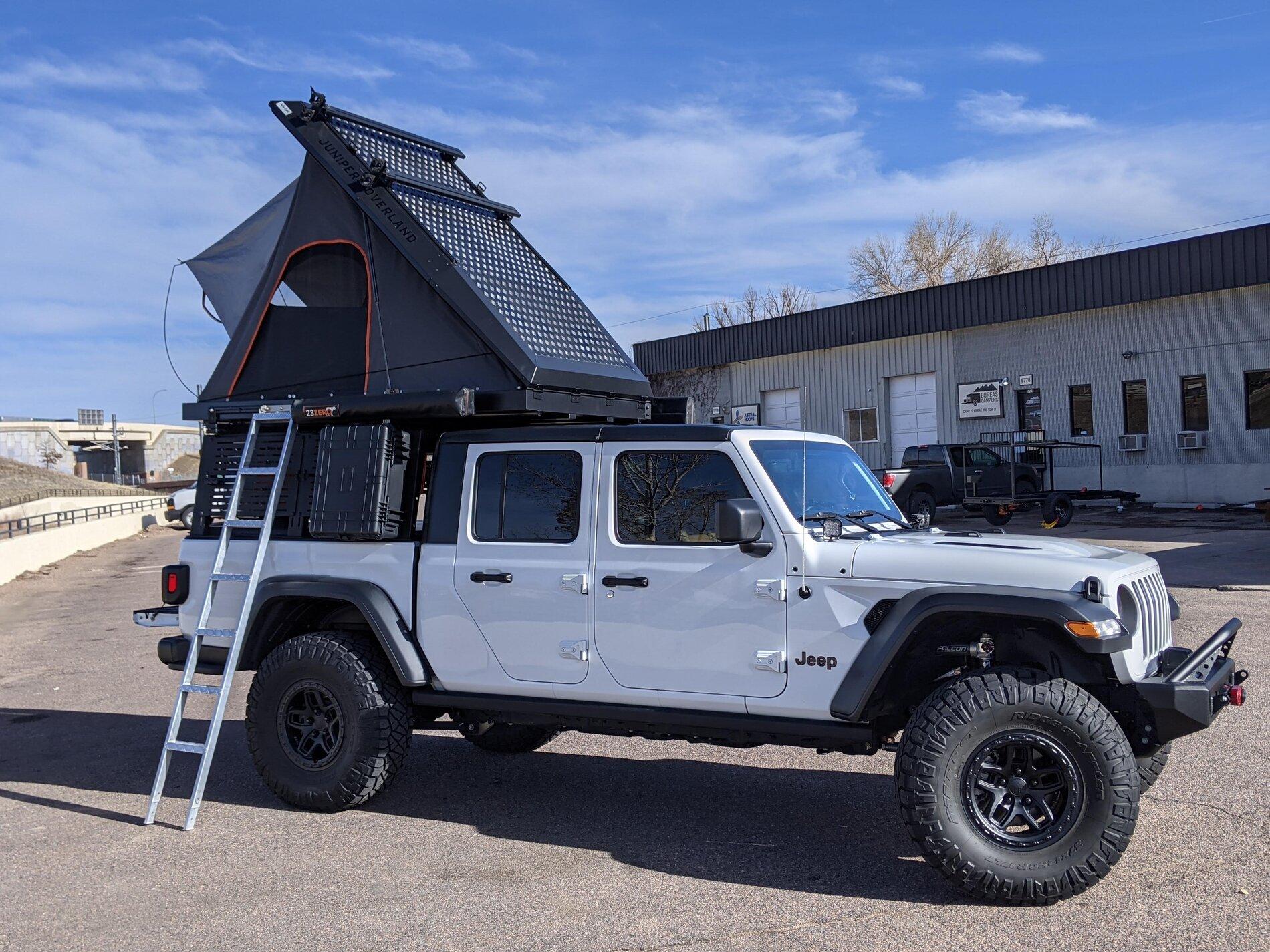

Yeah, that was just the easiest pic to grab on my PC at the moment. Here's a Gen 3.1 photo from this weekend. After 3 years I sold the Gen 3 tent for $3K... so yeah it held value really well given a new one is $3500 MSRP (if you can get one :) )... seems to be a seller's market for a lot of outdoor equipment these days.
It dropped my rear Clayton 3.5 in springs by 0.5" and probably cuts MPG's too. Not really something I sweat as I'm already heavy and under geared with stock 4.10's. It has not impeded with my ability to 4x4 though. At the end of the day I have to drive my truck home and I don't pretend it's a rock crawler.

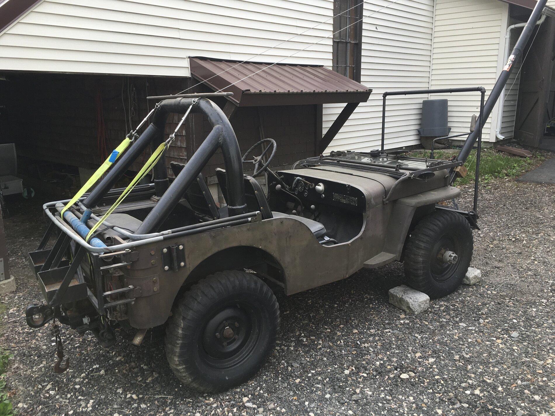

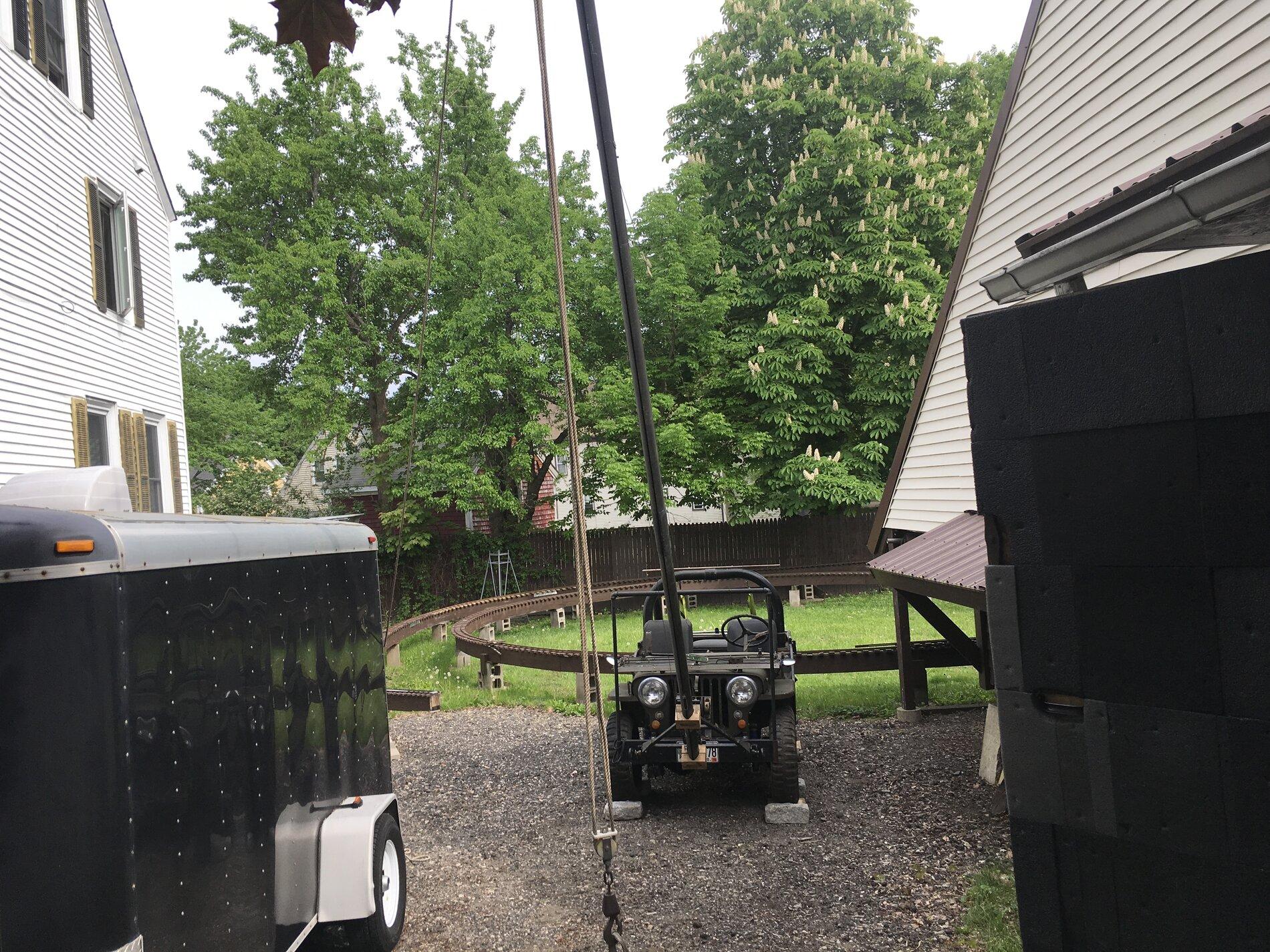

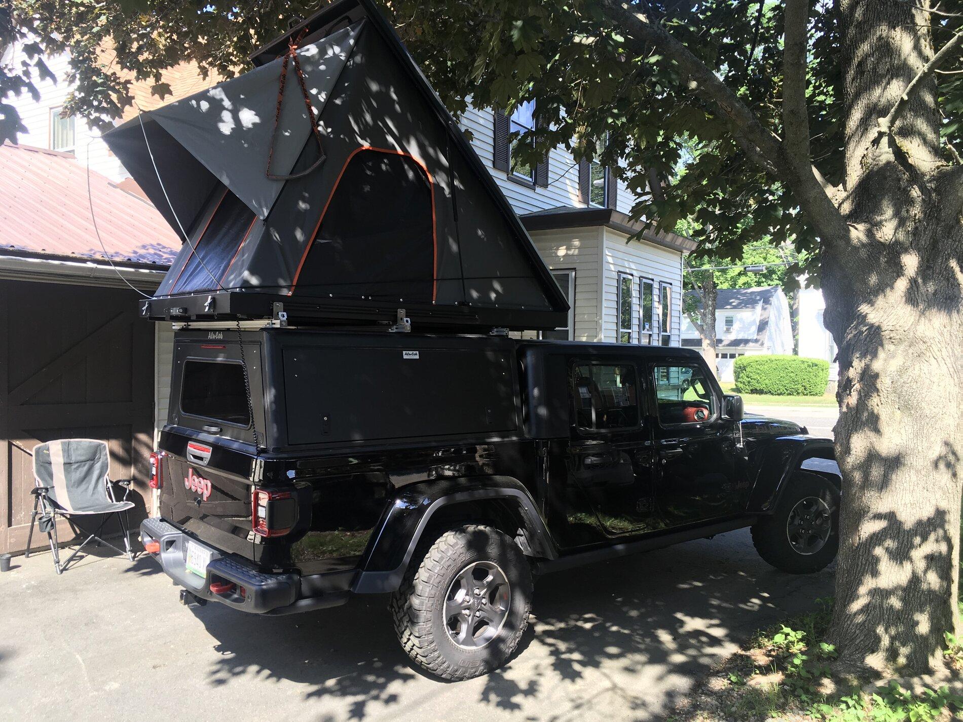

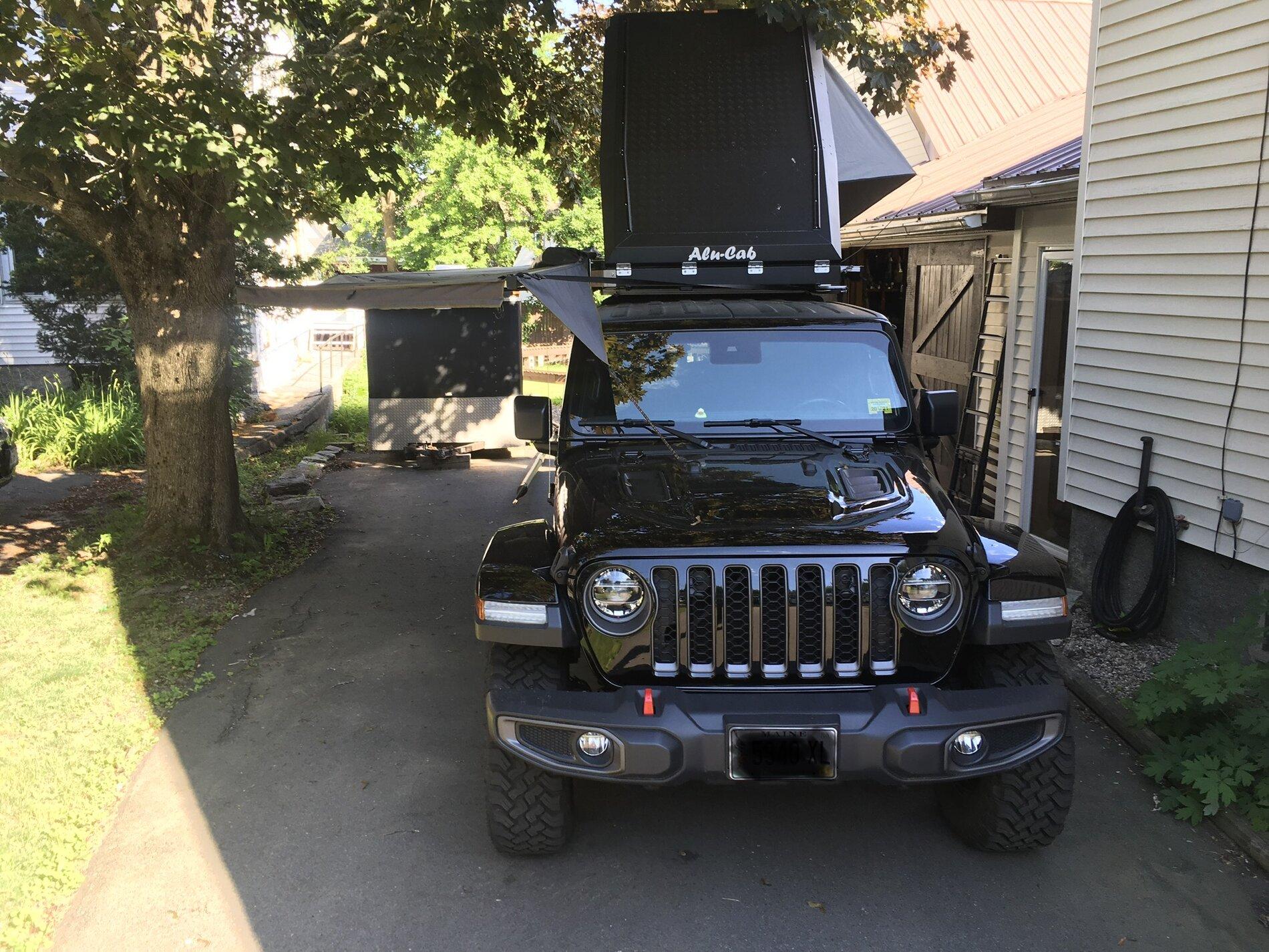

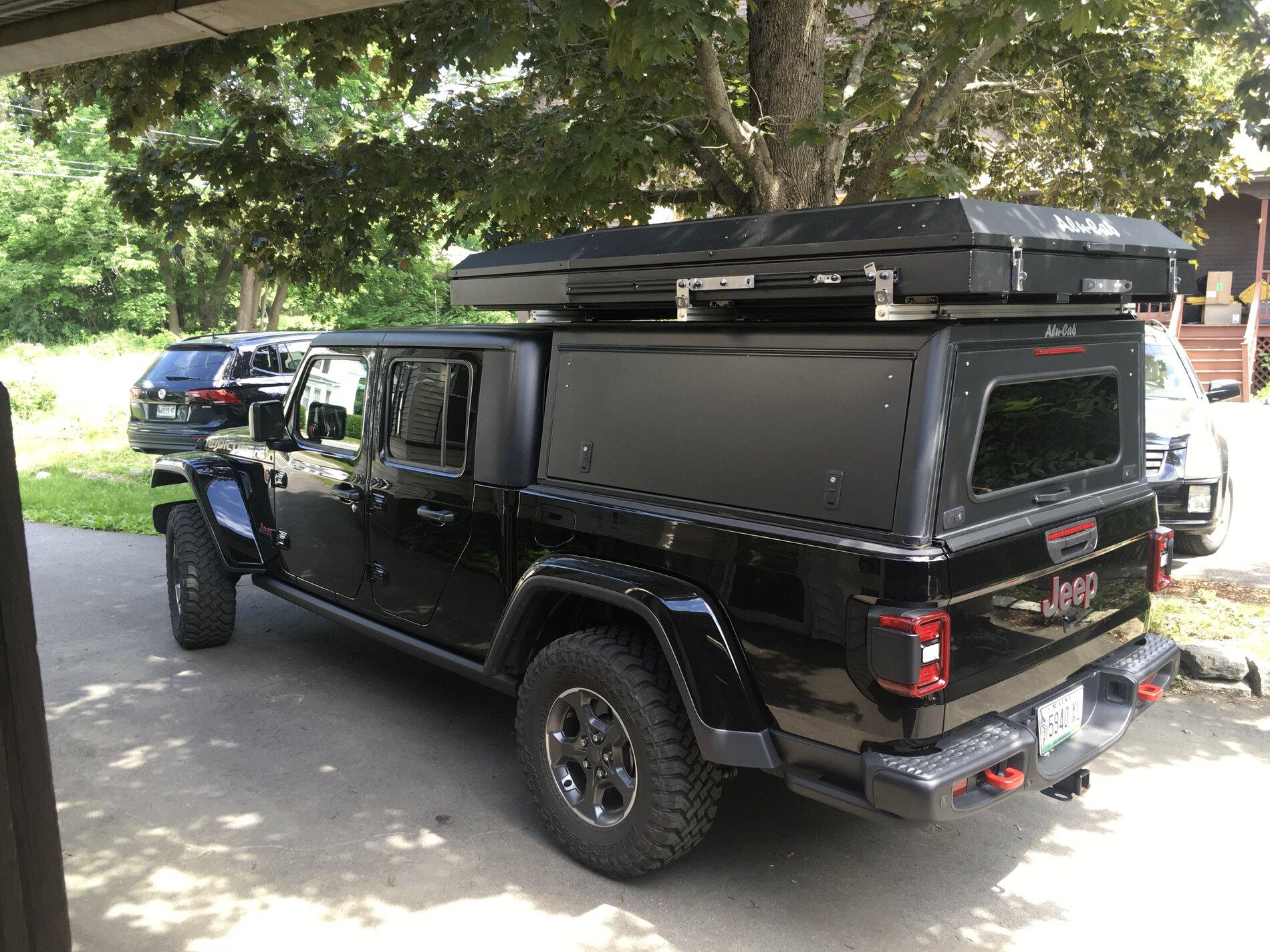

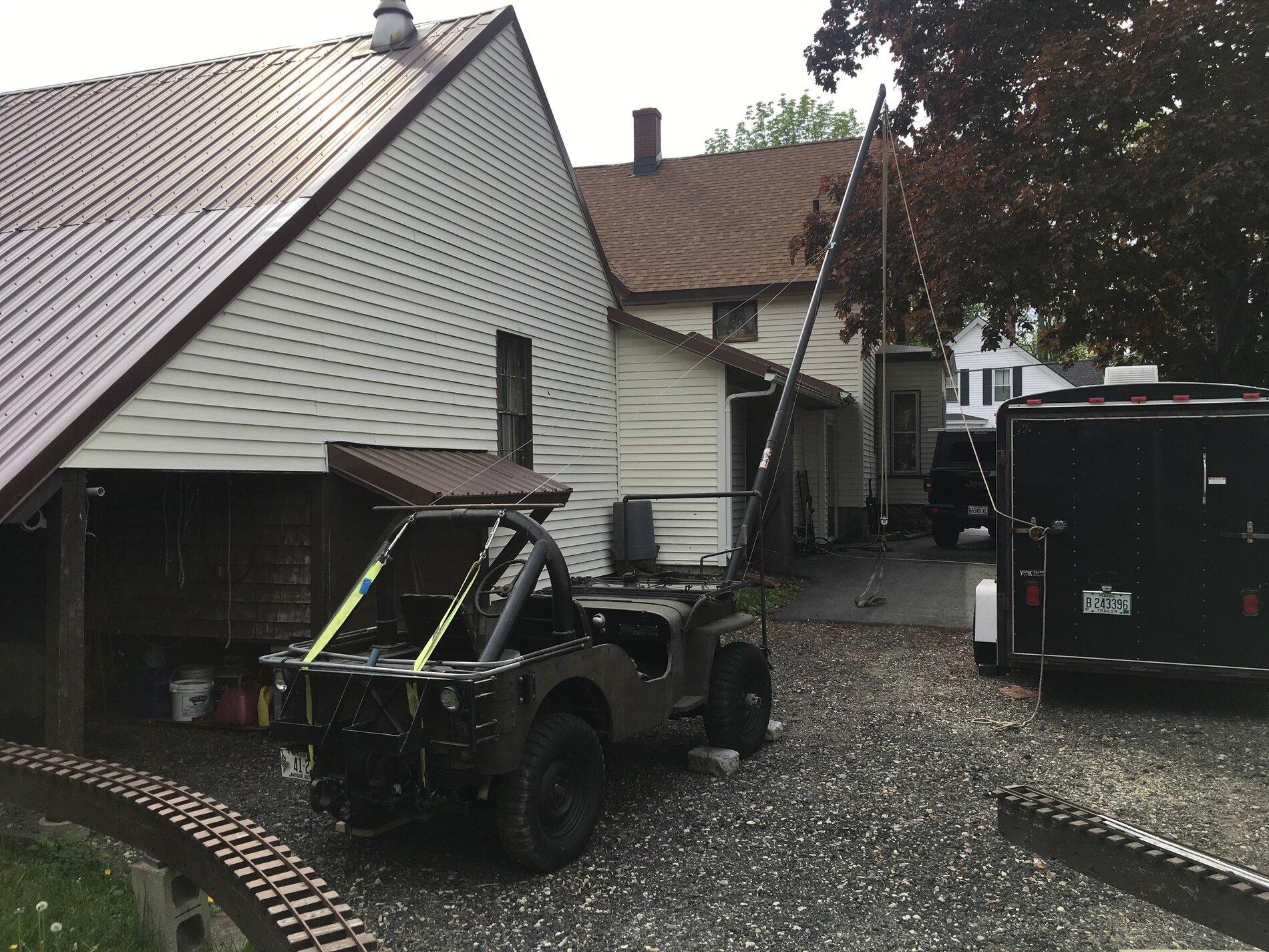

Getting prepped for the arrival of my AluCab RTT. Set up a 23 ft aluminum gin pole on my ‘48 CJ2a. This is the only other Jeep I've had until the JT arrived on the scene. I've owned it for 35 years. It took a few model years before another Jeep came along that I wanted to own....
I had made this set up to install solar panels many years ago. No problem lifting 300lbs so the RTT is a snap.
Neighbors are scratching their heads.

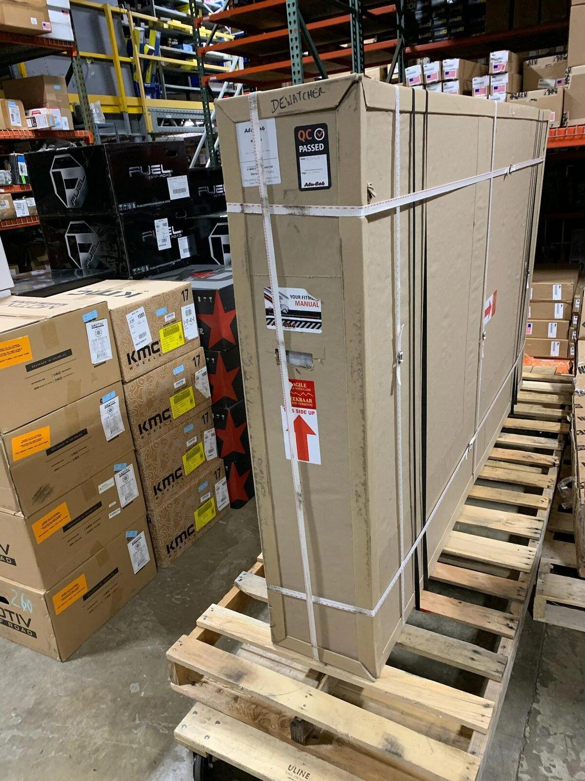

Big box and pallet....... Looks well crated. The cardboard is an inch thick.

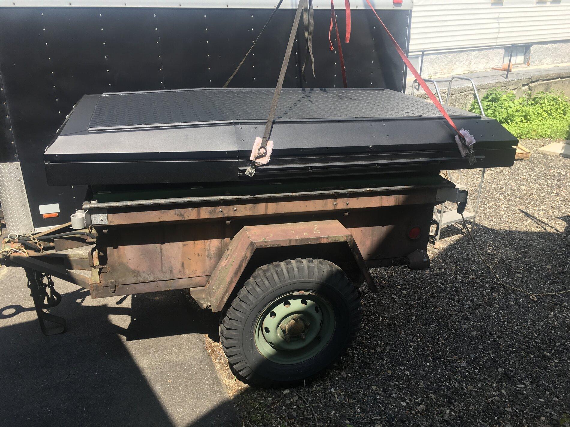

Anyhow, I got it unloaded and into my shop. Used a ceiling hoist to pick off the pallet and laid flat to unbox.
I then hoisted it onto my M416 trailer so I could wheel it about. Looked pretty good on the trailer!

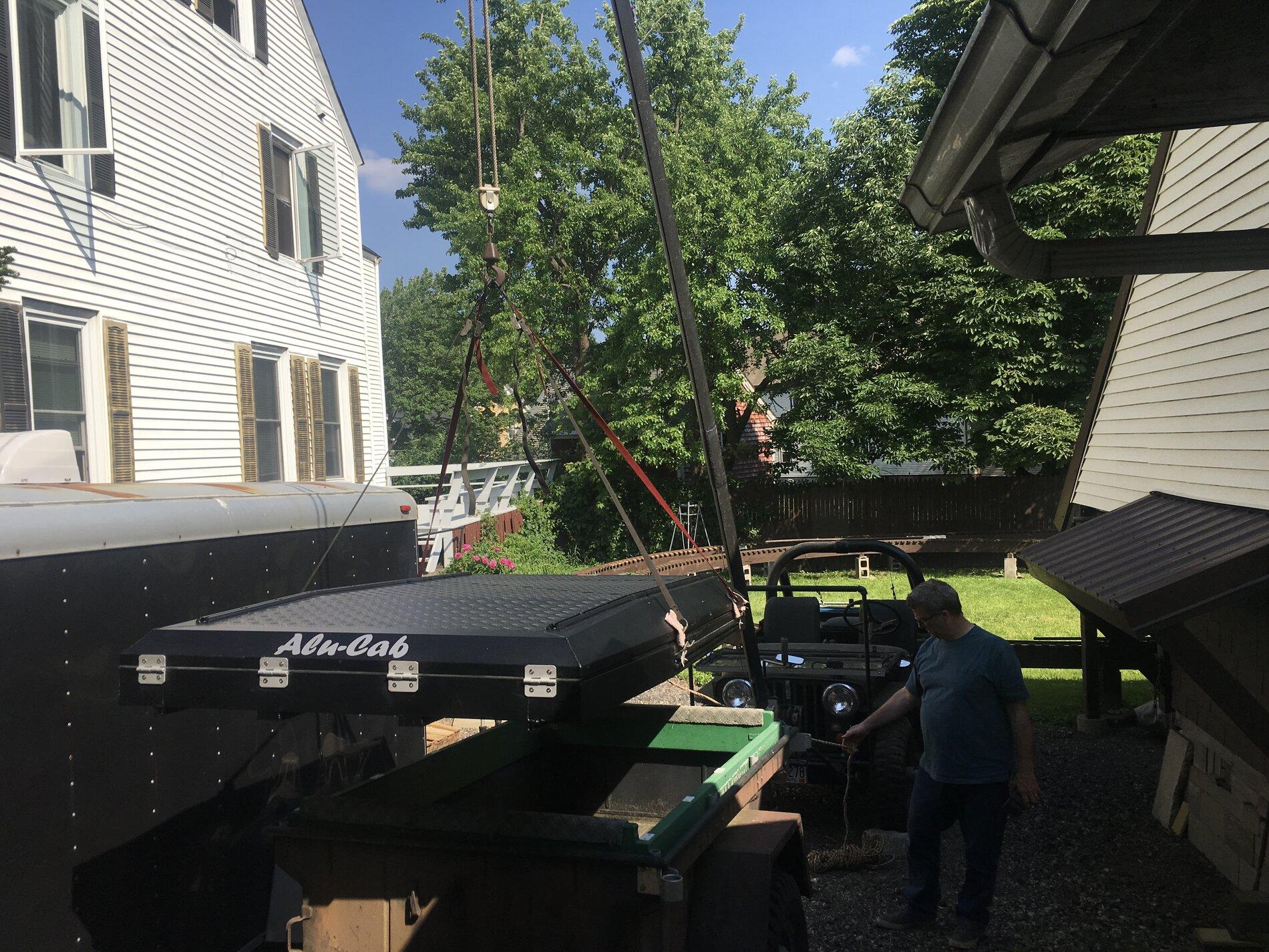

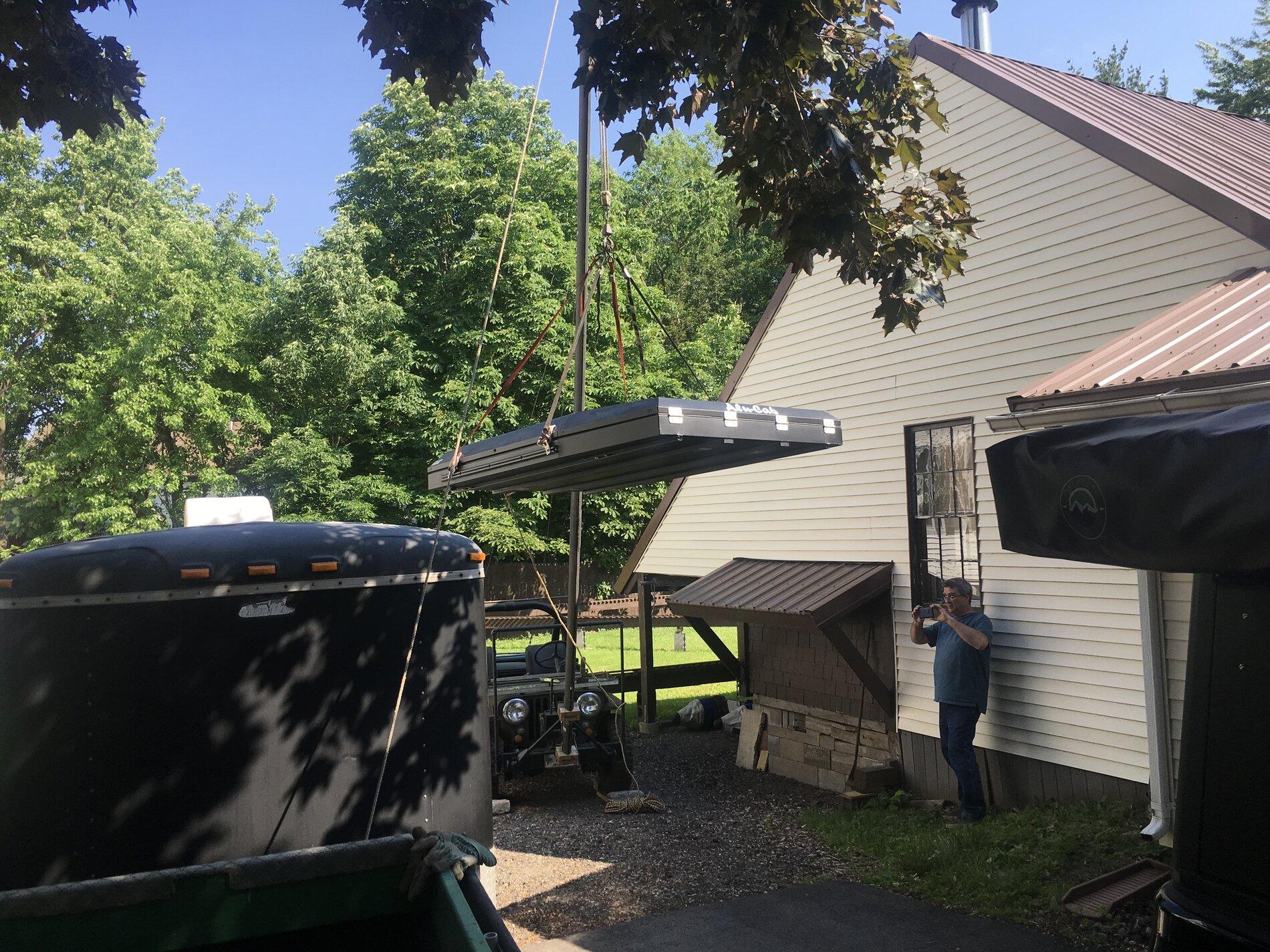

Used the gin pole on the '48 Willys and a block and tackle to hoist off the trailer outside. Pulled the trailer out, continued the lift until I could drive the JT underneath it.

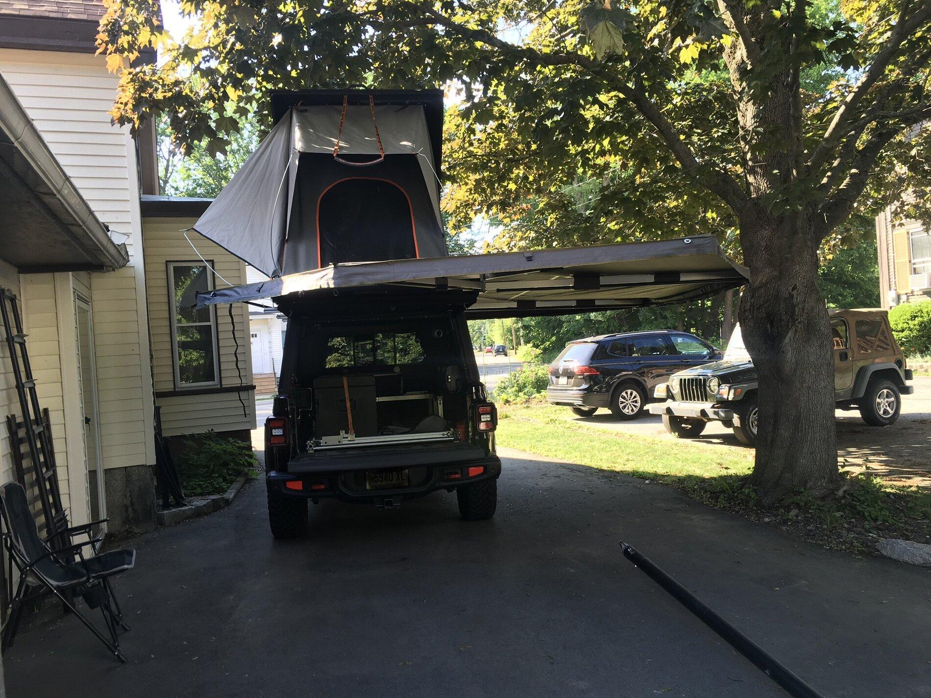

Set it on the three crossbars atop the AluCab canopy. Bolted up a few brackets so I could move up the driveway to level ground. The OVS 270 awning brackets were a problem. Took the awning off to mount the RTT where it needed to go using six brackets instead of four. New awning brackets are coming tomorrow that mount the awning to the RTT.
This tent is friggin awesome!!! Slept in it in my driveway that night just to try it out. Absolutely love it. Was it cheap? No. But your paying for exceptional build quality and it is worth it.

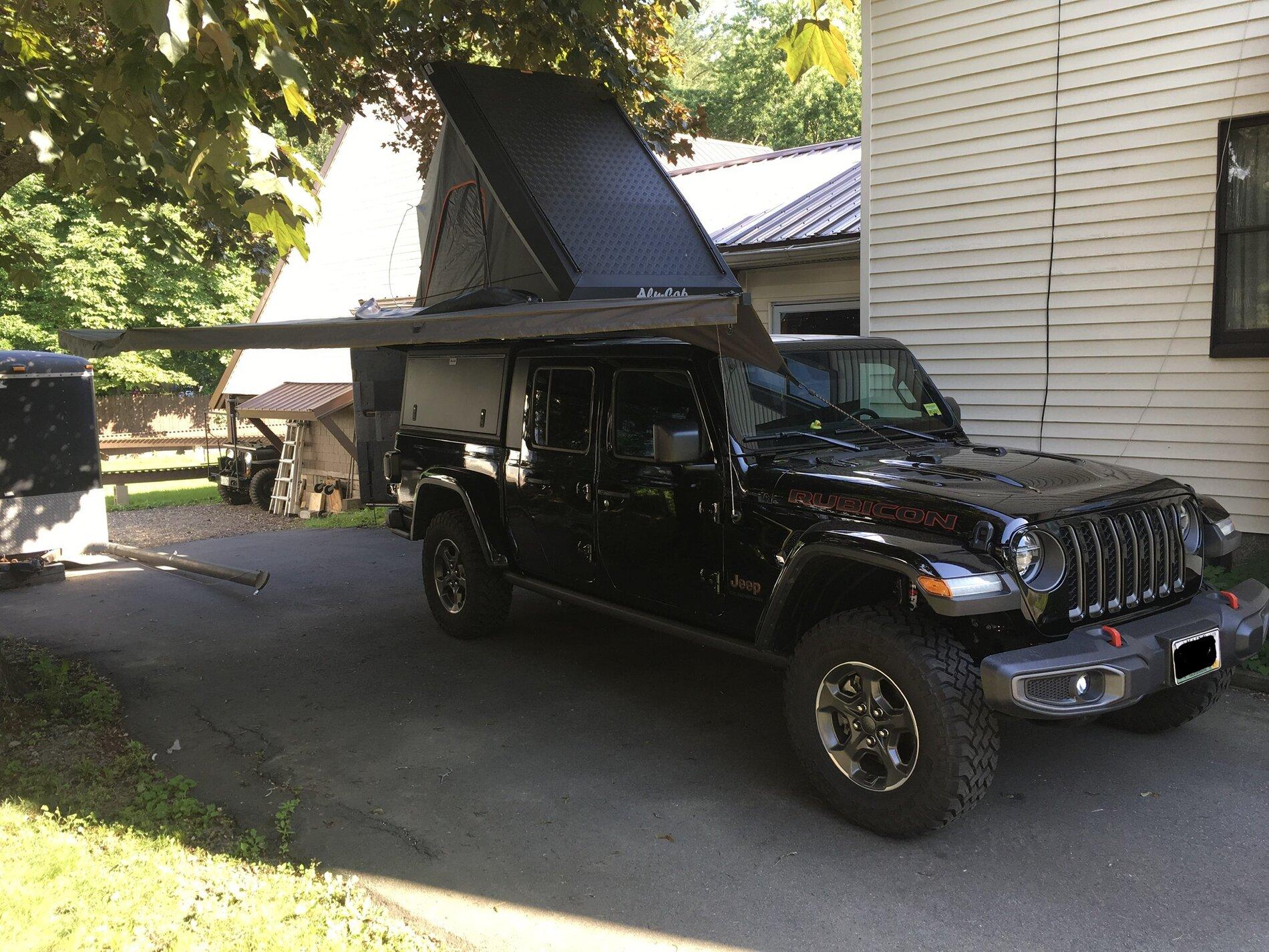

Had to shuffle the RTT position a bit and fabricated some plates to mount the OVS 270 awning to the AluCab awning mounts connected to the RTT. Everything fit up pretty well in the end. Really digging the setup.

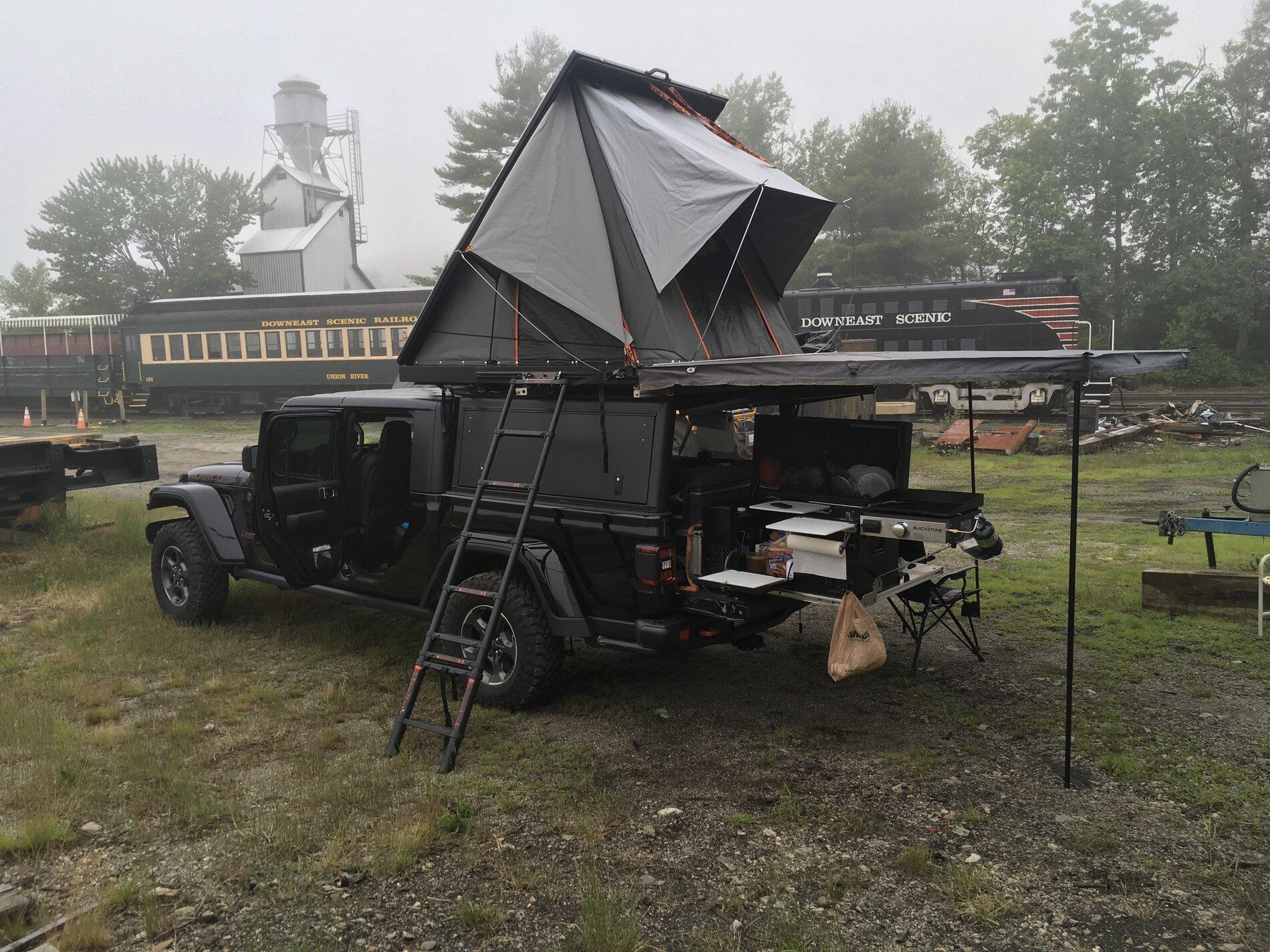

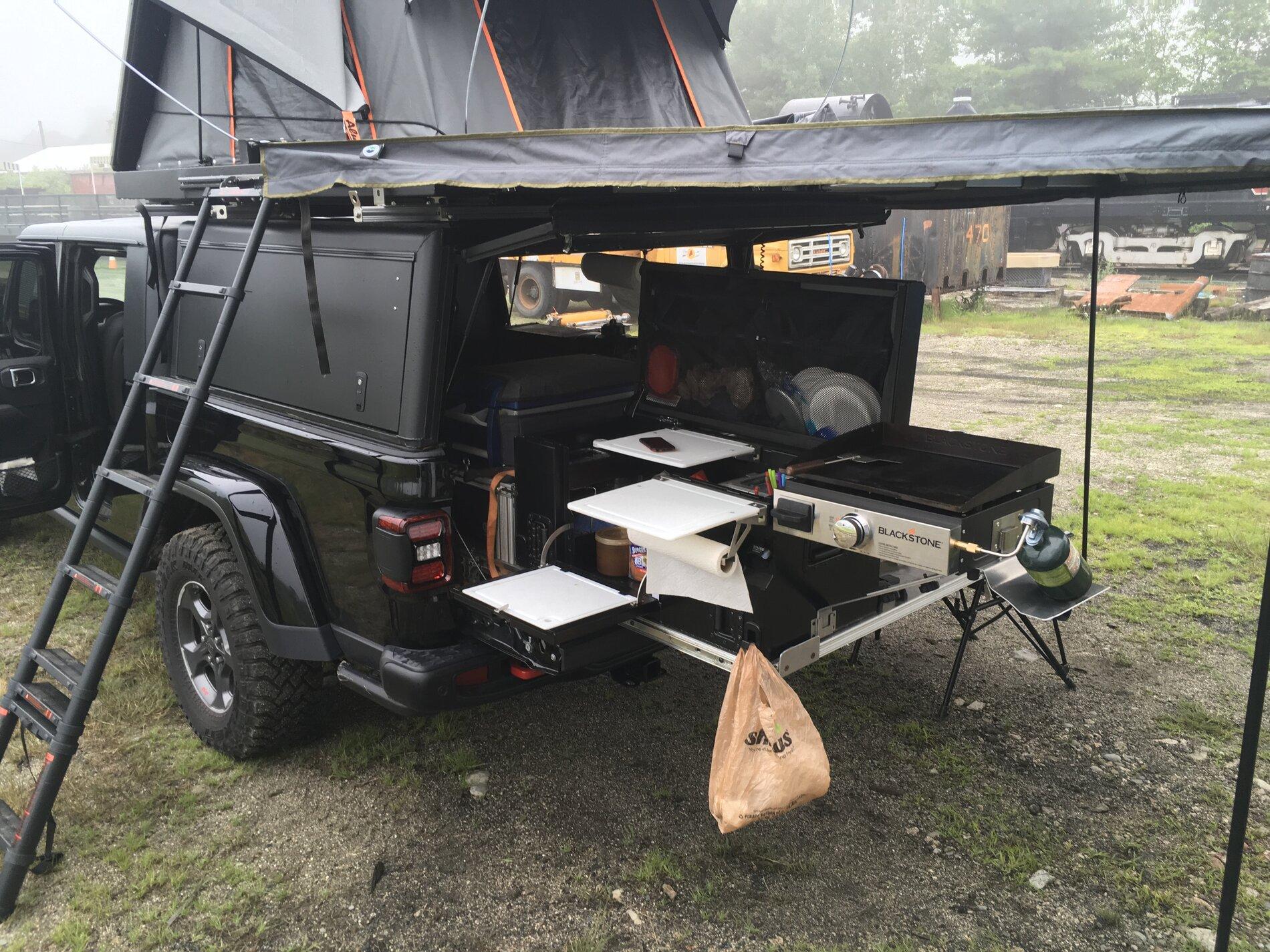

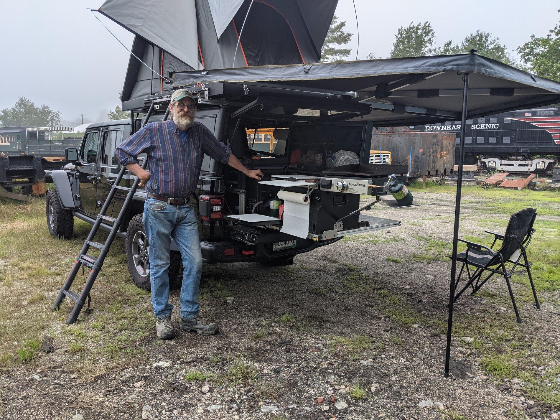

Well, it's not out in the wilderness but this campout is in a railroad yard where I spend time restoring a 1924 steam locomotive. Takes about ten minutes to have camp set up with no lifting other than camp chairs.
The bedslide I made, galley, fridge, lithium power, inverter, DC/DC charger, propane griddle, WaterPort.
