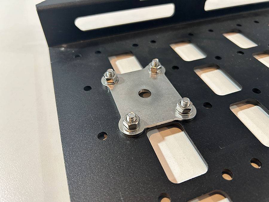

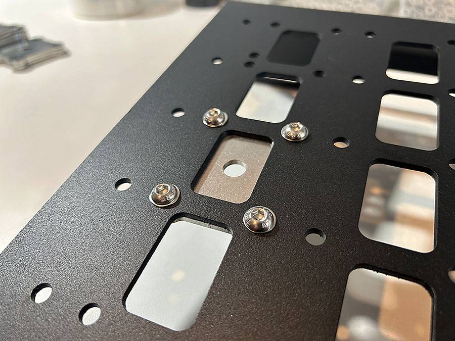

I don't know if it's just our molle panels (doubt it), but the hole pattern around the larger holes isn't the same in all rows. The second row from the bottom, the lower holes have a different distance.
Just mentioning this as I'm in the process of designing mounting brackets that are supposed to go on these panels as well as on my own loadbar brackets. Now I have to repeat this insanity on my own brackets if I want the ability to mount to both ... argl.

Yes, the MOLLE plate holes have an offset in the second from bottom row. I believe it has to do with some of their accessories, maybe the Jerry Can mount. I had to redesign my adapter plate after the first test once I noticed the difference.

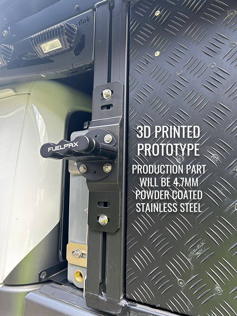

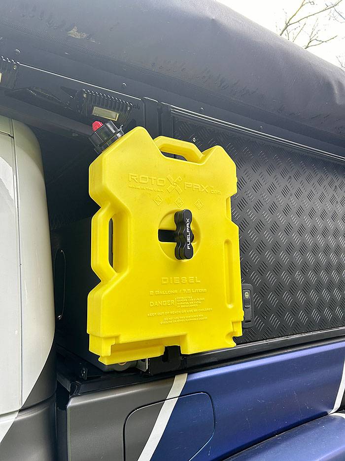

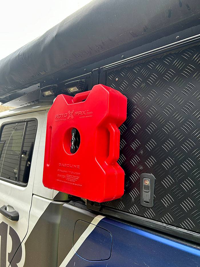

Thoughts? Something new I have been working on this week. A simple solution to help carry extra fuel or water. The containers can be removed quickly to open the side doors. The mount does not cause any interference with the doors. I also have tracks on my back door so the mount can also be oriented horizontally. It can be mounted to any flush surface. The mount will be beefy, 4.7mm powder coated stainless steel. Available for Presale now if you are interested.
https://www.813fabrication.com/product-page/universal-container-mount

Looks like an interesting option! It'll probably stay within the overall width (awning / shower tent, fenders) and it's forward of the rear axle which is always a benefit. A good option for those needing that additional kick. I might use that down the road if/when we plan trips with less frequent fuel options.
Probably be better than stacking containers on the rear door.

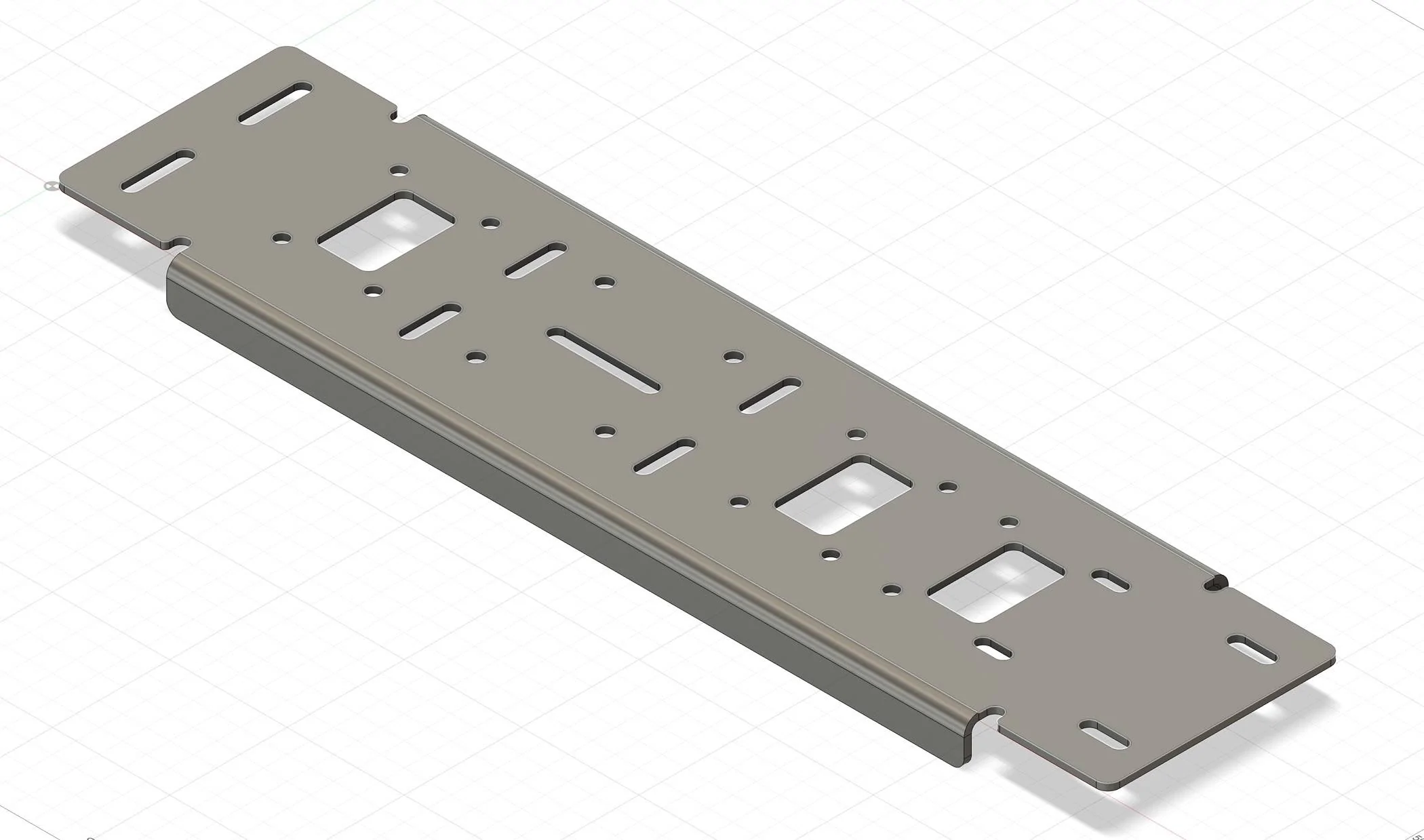

Question regarding the material thickness: do you think you need this thick/strong material? Is it because it has only one bolt per side? Or because it's basically flat material?
I'm planning on using 3.2mm aluminum for the rear door brackets to hold Rotopax (with two side bends to avoid flex). Am I underestimating forces here? I don't have much practical experience with the materials, I'm basically copying the Alu-Cab molle panels. So, just wondering.

Yes, even with the 3 gallon container is stays within the awning and fenders. For thickness, it has bends in it to raise up for the bolts. I typically make 95% of everything in 1/8" aluminum. But, with liquid weight and off-roading I am over-building it to be stupid strong just in case. The cost of material is much more to go a little thicker. For this mount I personally don't want aluminum due to the possibility of fatigue.

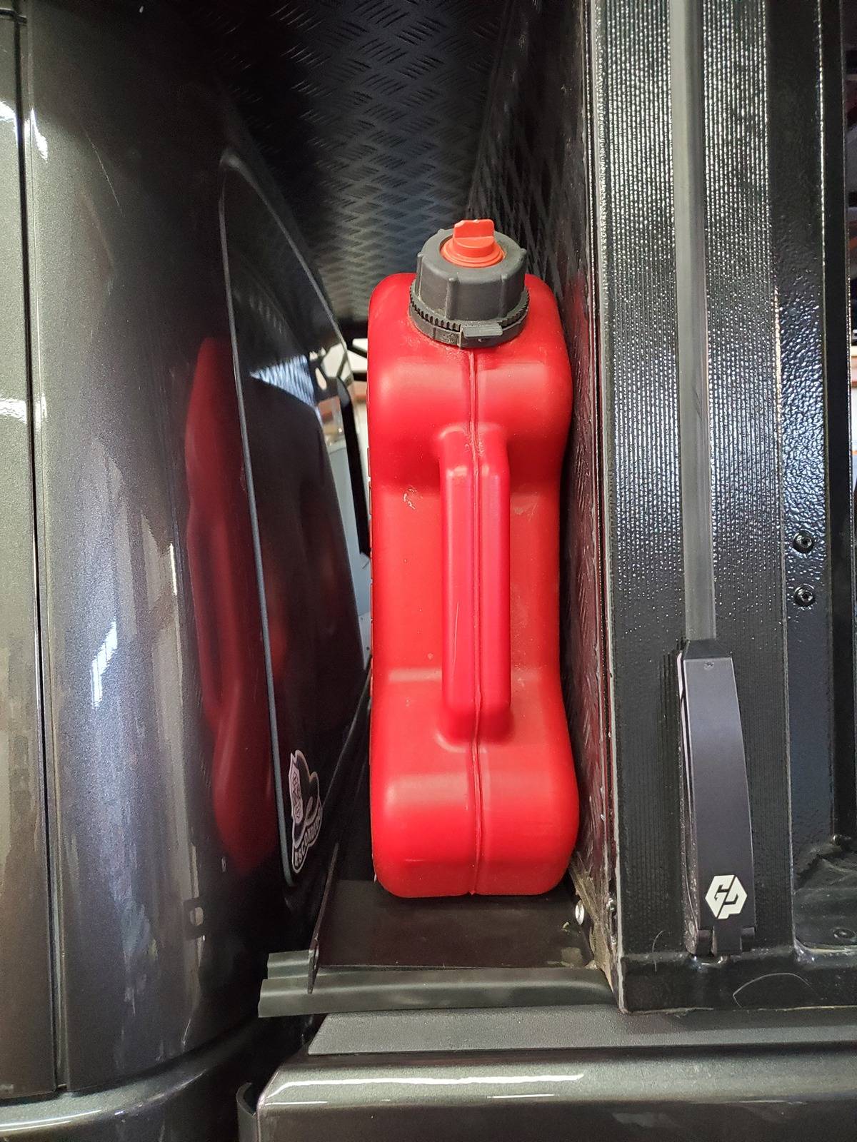

I am working on a custom aluminum idea. Since there is not a lower track to attach to it is very hard to anchor something well. I'm not sure there is enough clearance for two 4 gallon tanks .
caryt
Cary
May 29, 2023
544
418
Wellington NV
'84 stretched CJ7/LS/tons/40's, 2021 Rubicon JT 39
Retired/ Build jeeps
Here is 1 of the tanks I have its 27" long and setting it inside there is still 33" left to put one in from the passenger side.
I can see the point. Based on that thought, I've modified my rear door bracket to have "more meat" around the various mounting holes, although I'll stay with 1/8" aluminium.
When I look at the chain of things bolted together:
  1. Rotopax mount: 1.5mm steel
  2. My mounting bracket: 3.2mm aluminium sheet metal
  3. The Rhino-Rack load bars: 1.5 to 2mm thick aluminium extrusion (it differs depending on where in the bar)
  4. The aluminium door panel sandwiched on top of aluminium extrusion (both not measured).
It somehow feels like I should make my mount weaker and have it break before it rips something out of the door ... ;-)
The problem with the larger 4Gal tank is the width. It is very close to the glass with a mount. Add a mount to hold it and it would push even further toward the glass.
Current plan:
I think you will be fine. You drawing looks very similar to the panels I have on the door. With the two side flanges, it is a pretty strong panel.
That's what I figured. I'll be using M6 hardware as well, since the Rotopax will sit flat on top. Most of the time, the Rotopax will be empty, but there might be a time when I'll have two 2G Rotopax mounted. Not that this is anytime soon ... [dreaming of shipping the truck to Australia one day]
