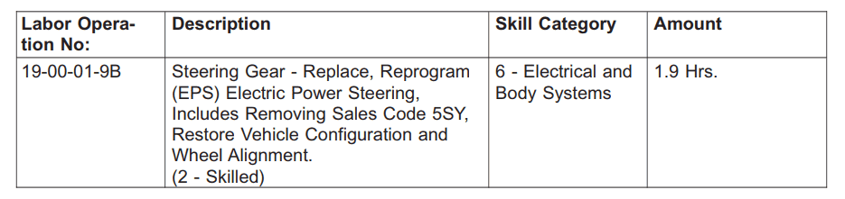

If my warranty pass I'm at 77k I need to pay out of pocket will it be expensive?
249
40,591
54,256
You can find the parts costs online - but keep in mind this is a dealer thing because it REQUIRES the software be updated.
The aluminum steering gear used one version, the steel steering gear uses another version of the software.
I'd not even try to run the steel gear without the update - this is EHPS - Electro-hydraulic Power Steering - it's not engine driven - it's an electric controlled by the "computer" which regulates pressures and so on.
People keep talking about the brace and so on - this isn't about stiffness or needing a brace or not. This is about looseness and pressures and so on.
You can't possibly fix the issues with the aluminum-housed with a brace because the issue isn't flexing of the housing. It's just plain loose - or pulls even, and a brace can't fix a pull.
Again - a bit of missing the points of the change and what's wrong with the original steering gear.
For parts you need new frame-to-gear bolts (different lengths/sizes), new pitman nut (they are supposedly a one-time use only nut), EHPS fluid, and the flash of the system after it's replaced.
MAY need the steering wheel recentered.

I'm not even thinking doing it myself.
As long the thay will not kill me at the dealer I have no problem the big question is how much it should cost me
As far as labor - they are allowed 1.9 hours under the TSB so you should not have to pay more than that for labor.
Jeep Gladiator Aluminum steering box. Leave or replace? 1670819938679
And - it appears the part in the TSB has been replaced by yet another version. Maybe that's why my 2022 feels so much "tighter" and steers even better than my 2020 did.
Jeep Gladiator Aluminum steering box. Leave or replace? 1670820118790
Now that's an online discount price - and there will be bolts and the pitman nut and the fluid.......
