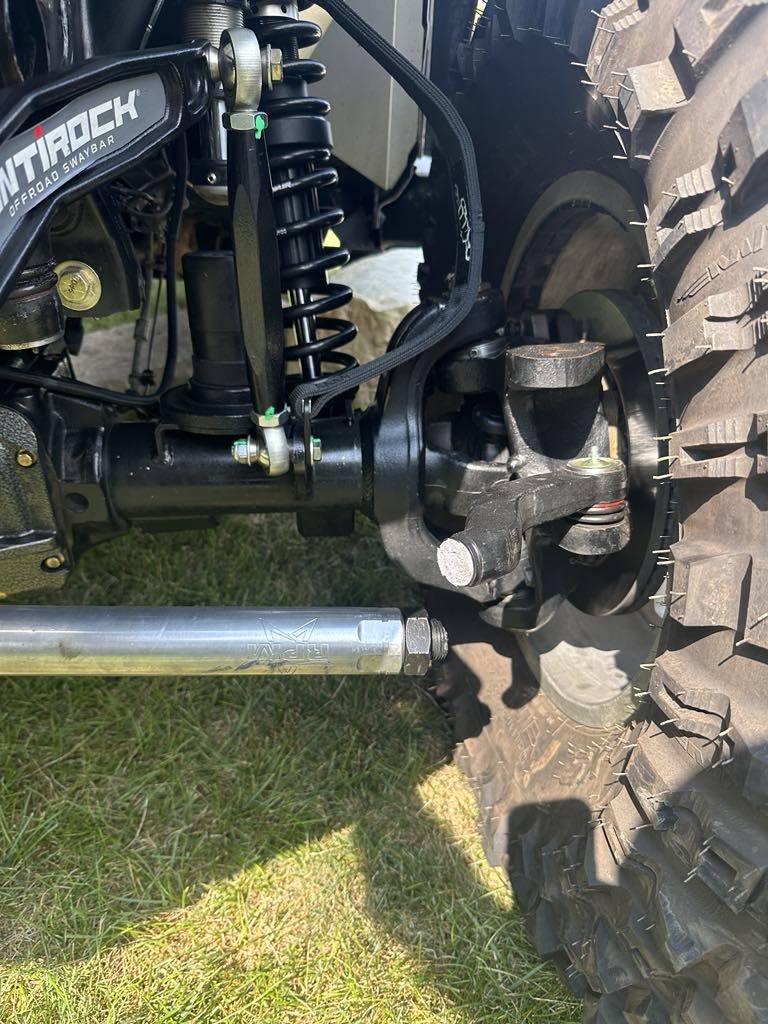

Fusion is outstanding and only bested by rockkrawler
Here’s one of the other ones I was referring to
Jeep Gladiator Aluminum Steering Options IMG_7945

O
Ohh damn! Fusion also said they manufacture all their own parts. Or have someone do it to their specs.
