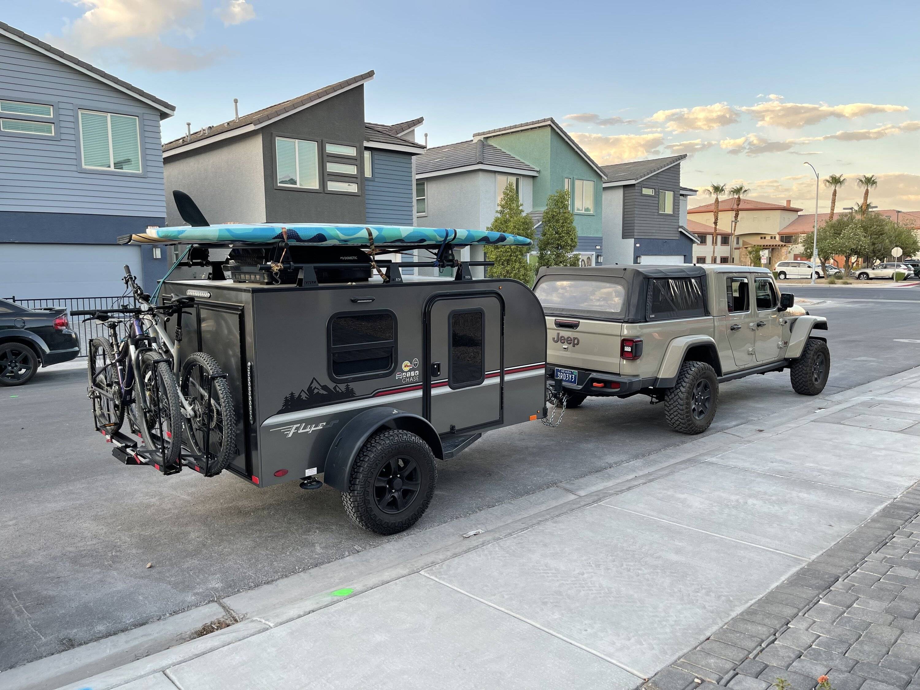

I tow an Intech camper occasionally at 80mph no problem, Jeep and camper loaded. Never had a dangerous wobble or anything. At most a 1-2 second bump steer when hitting a bump on a turn occasionally. Im on the fence about going in for the TSB since it seems fine and I’ve never had a bad wobble. I’d hate to be denied the steel box once I pass the 3yr/30k mark. I did purchase the 7yr/100k extended tho if that will help me if it happens in the future. I do plan on going 37s next year. Wish I could drive one that has a steel box to compare.
Even loaded like this I feel it drives the same. Steel box might give me peace of mind for the 37s later tho.

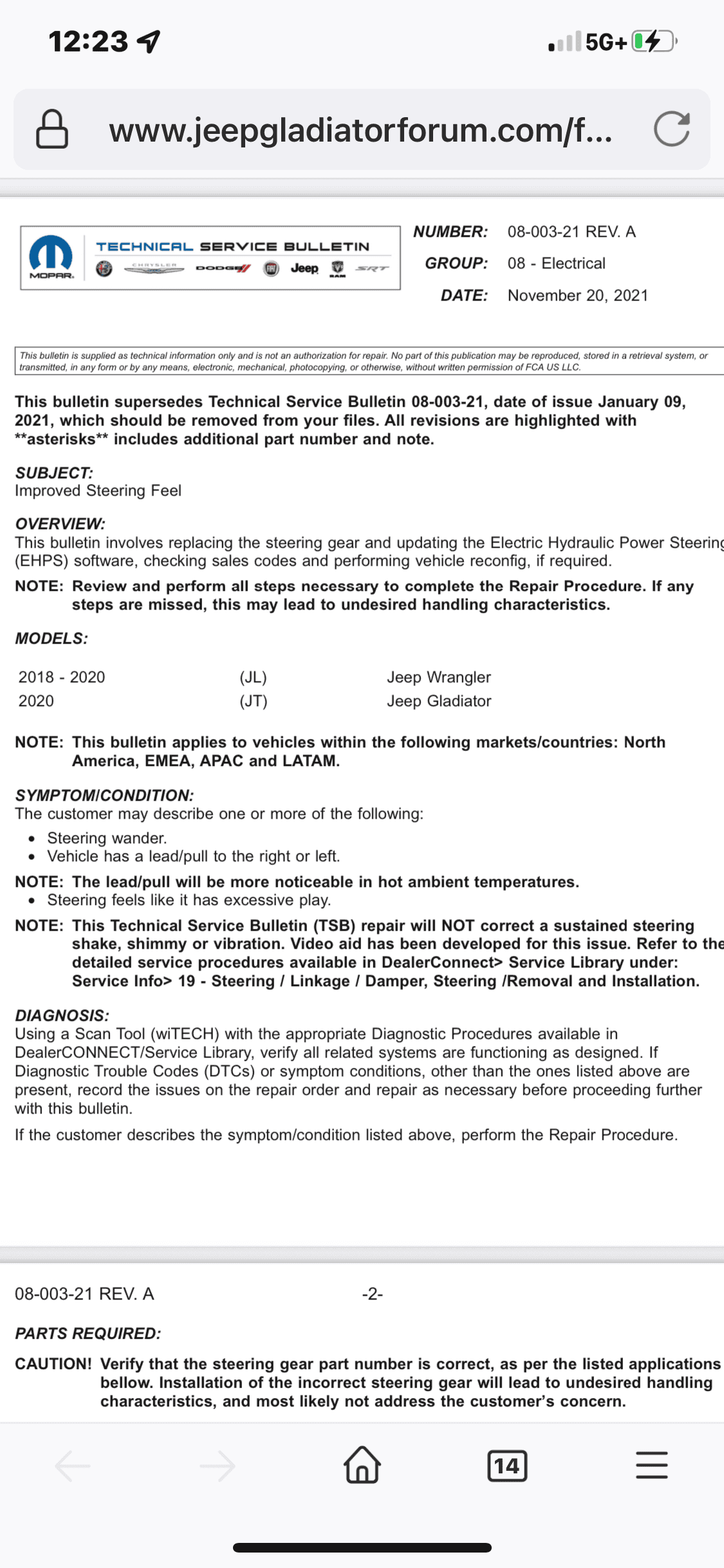

I’ve seen you post the November 20, 2021 TSB for the gearbox, do you happen to know if this is the latest? Going to print it out before I go to the dealer.Solid axle won't wander, won't matter on decent roads, streets, highways.

My dealer said due to my lift (level kit, nothing big) they would not even evaluate it. Hopefully you have a better dealer.Anyone had success getting this done with a aftermarket lift? My 2020 has the aluminum box and they didn’t seem to interested in the TSB when I brought it up. They asked if it was lifted and bigger tires.
my truck seems fine for the most part but I’m almost out of warranty so I thought I might push it a bit more to get swapped.
Anything below 3 inches is still covered under warranty according to my dealer when I first bought the truck.My dealer said due to my lift (level kit, nothing big) they would not even evaluate it. Hopefully you have a better dealer.
