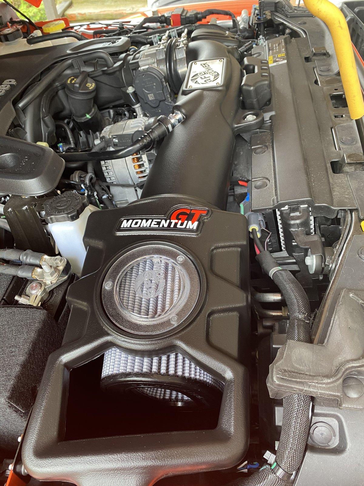

Are you noticing any performance changes? I'm currently between the snorkel (probably just low mount, but not sure) and the AFE Power Momentum GT 5R. Technically there's no change to the amount air flow with the snorkel, just the temperature. With the AFE, the temp will stay the same but with increase flow (I think). Obviously the snorkel has the "cool" factor aesthetically.
Thoughts?

Would they be compatible together?
im not good enough to rig the afe box to the snorkel but I’m sure you can someway/somehow do it. The end of the box is enclosed so you’d need to route the air through the top or cut out the side and route it that way. Would probably be more restrictive than good IMO

Thanks for input. Probably leave oe box and just slap hi flow dry filter
