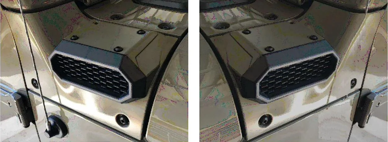

Looks great! Now if Rugged Ridge would make a mirror image for the driver side that would hinge open so you could add exterior controls for a winch or air compressor.
Came across this post while searching for the effectiveness of the RR Snorkel... This is a great idea!
Mopar sells a repladement cowl mount for the drivers side. Grab dimensions of the RR product or 3d scan, and have someone 3d print in ABS. Voila!

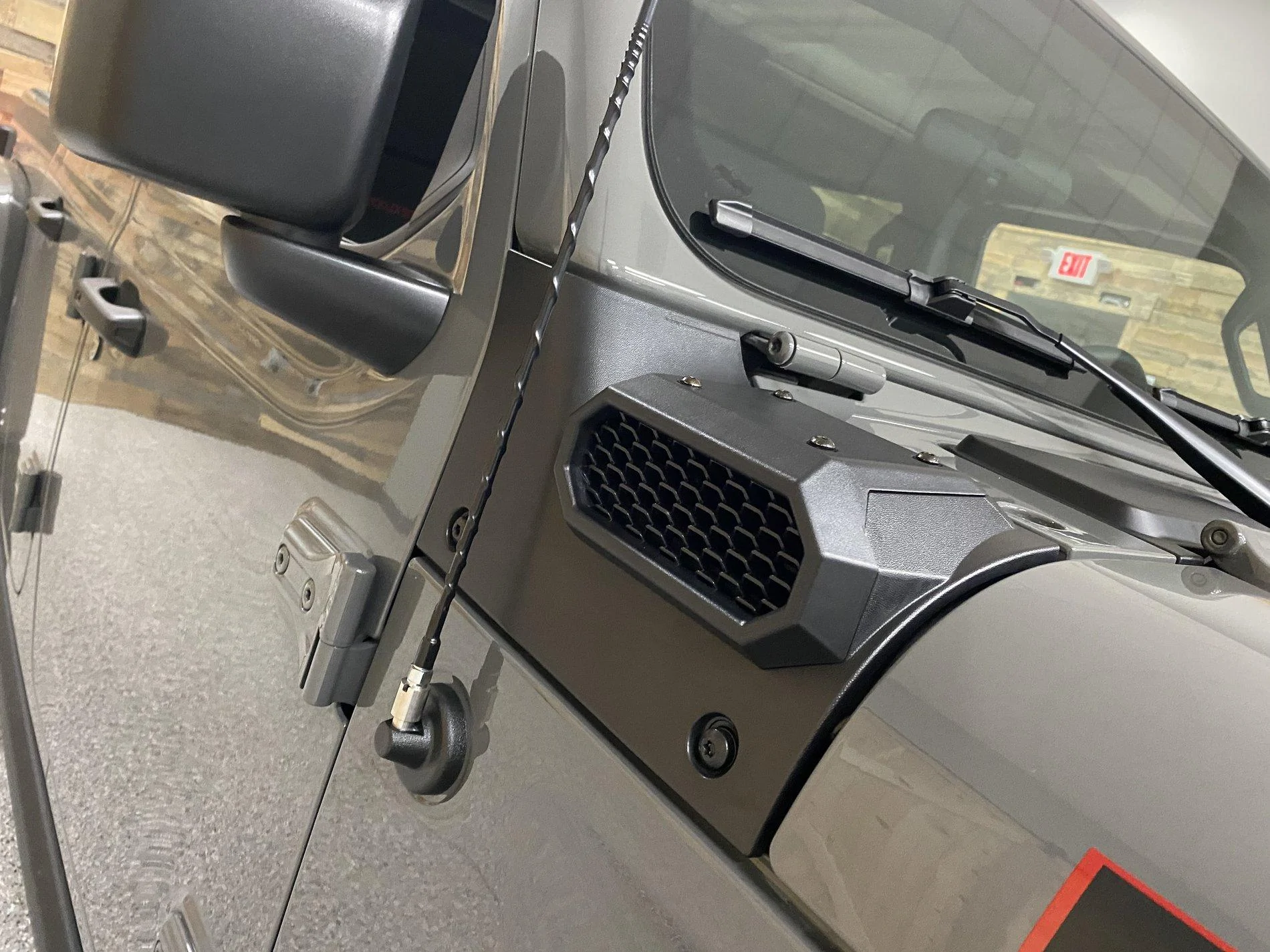

I got my snorkel back from paint, finally getting around to installing it now!
I also painted the cowl like Daniel, but then kind of went with the opposite idea and left the inlet grille and surrounds black, and painted the body of the high mount snorkel and ram.

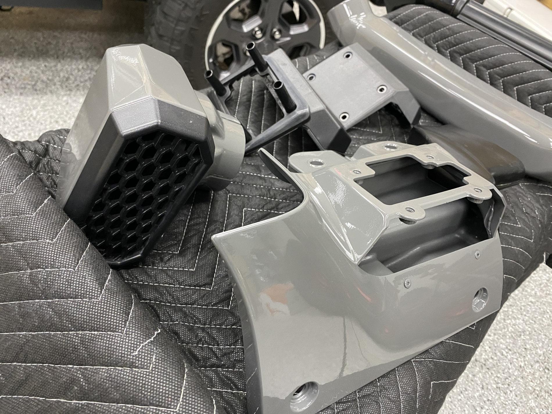

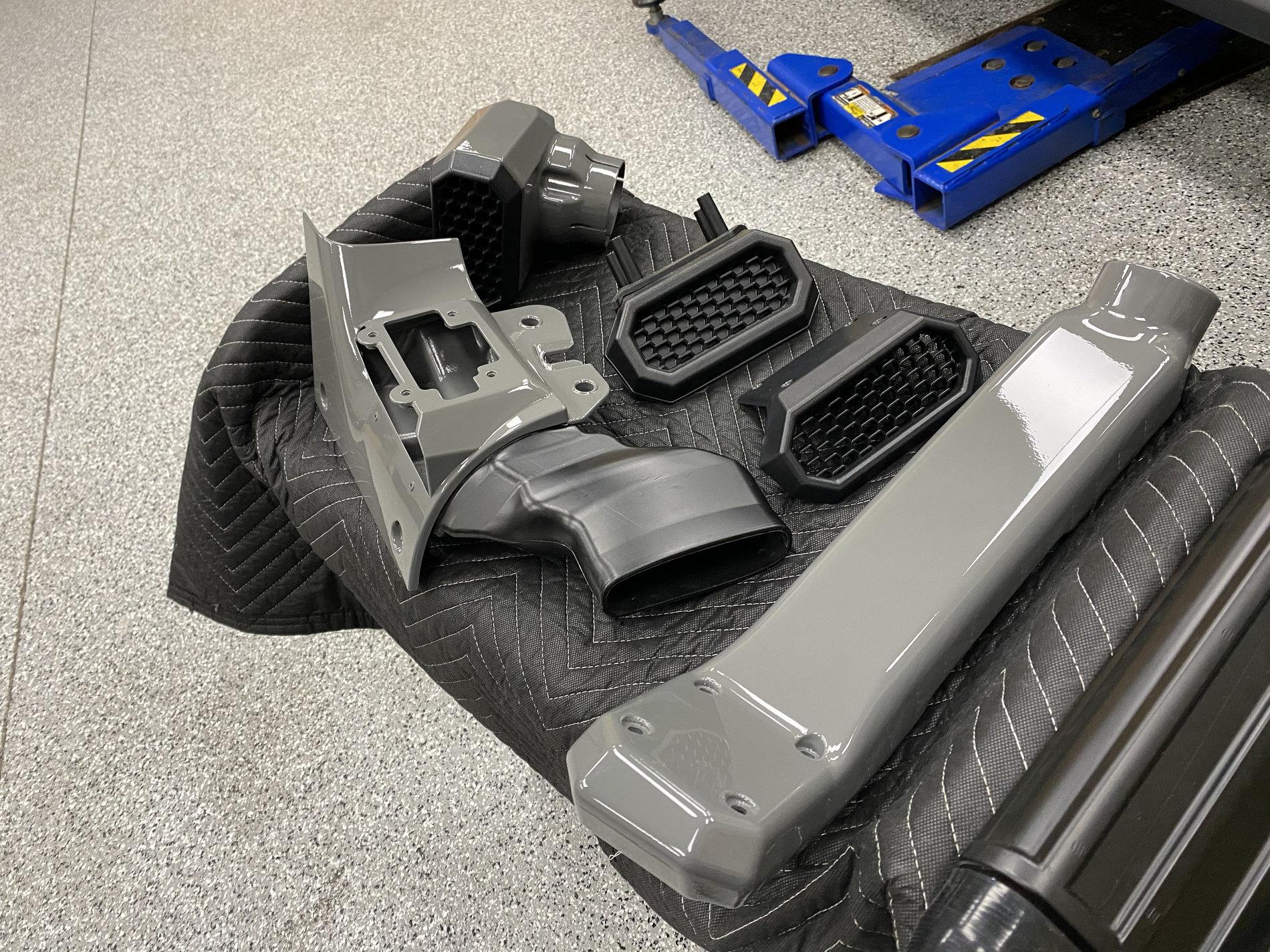

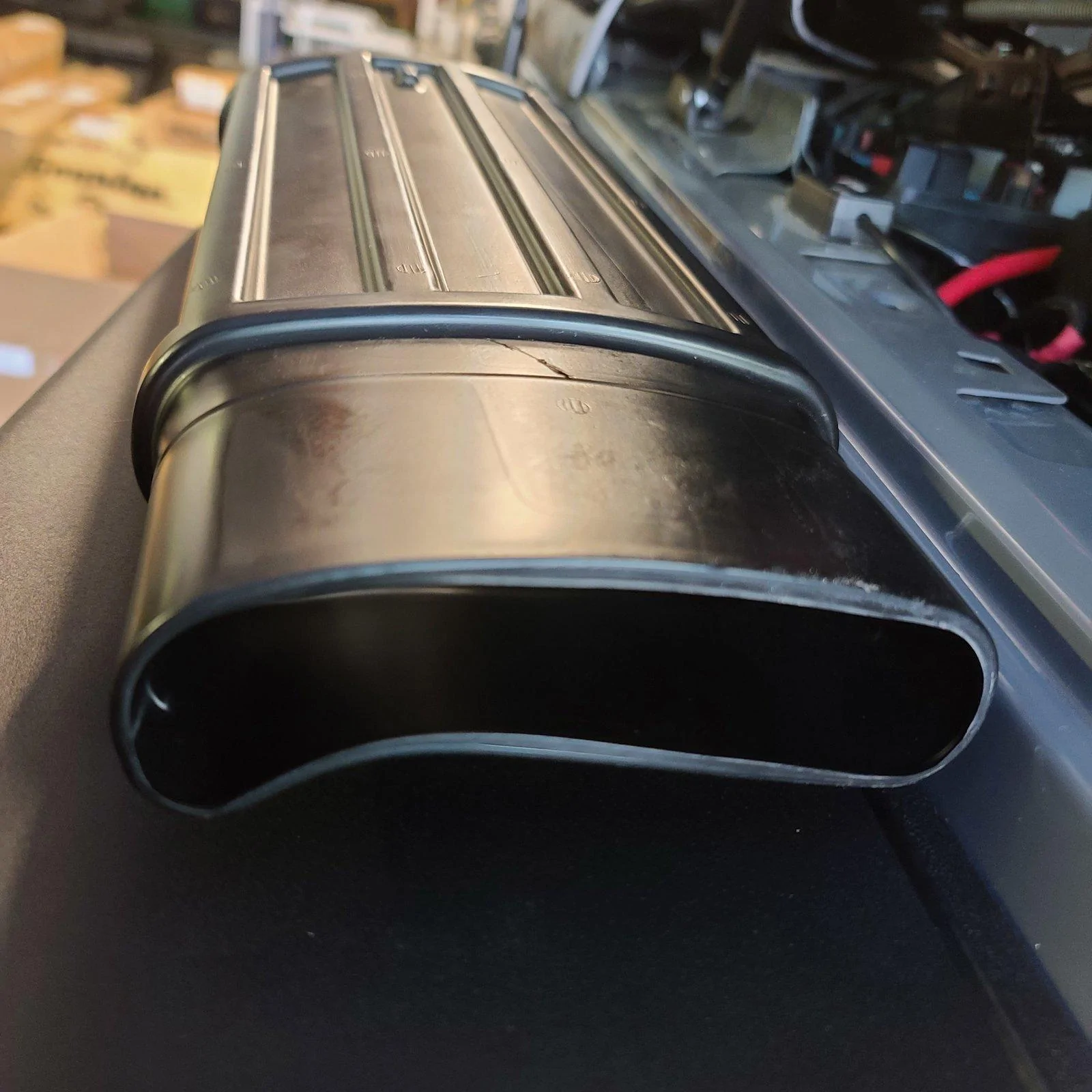

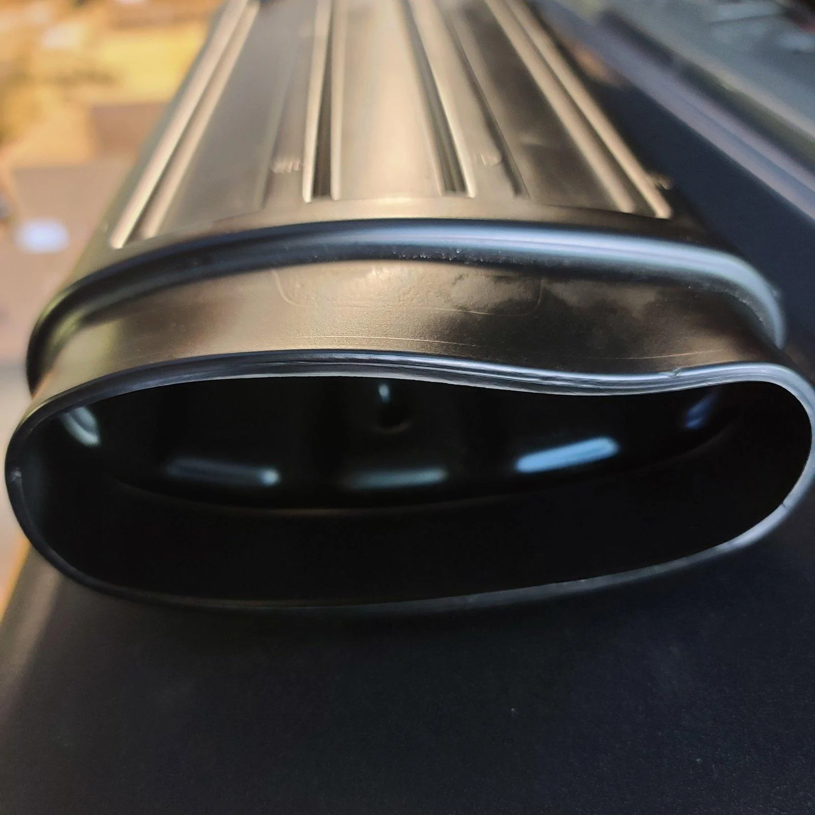

Has anyone else taken apart their snorkel after installation to find all the connecting pieces warped? I called rugged ridge about this but they said that right now there is nothing they can do about it due to Covid and people working from home (understandable.)
Hoping they come up with a fix as I miss my snorkel.
Here is a picture of the center piece.

That distortion is likely a combination of the shape of the clamp, flexibility of the clamp, the ability of the clamp to slide on the tubing, and maybe a little over tightening with a technical assist by too soft a material used in construction of the duct.
I don't have this set up because i didn't like the outward appearance of it, and this issue doesn't make me want it any more.
I guarantee that distorted flange was sucking air, which is not an issue pre-filter, but if that was submerged it would be a plenty issue.

It wasn't over tightened. I barely snugged them down with a small flat blade. Rugged Ridge seems aware of the issue. They asked if I was running bigger tires and where I was located making it seem like the extra load combined with the TX heat caused the plastic to deform.
I was able to reshape the material with a heat gun and some manipulation but after a few days installed(this time with just enough force on the clamp for it to take the oval shape) it was deformed again.
On a side note, I noticed a fairly dramatic improvement in performance when going back to an S&B intake with the Magnuson.

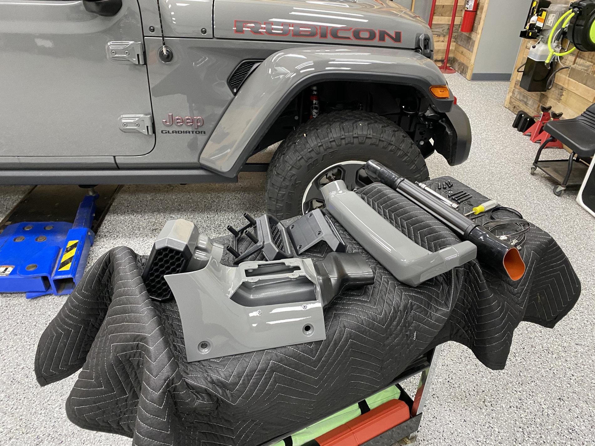

We'll have a full review video coming soon! I'm very impressed with the install. The parts all seem to be very high quality and the under hood components match the look of the factory plastic intake pieces well. Once installed, the switch from low intake to the full height intake is only a matter of 4 screws.
Painting any portion or all of the snorkel pieces shouldn't be a problem at all, in fact I will be painting some of the components in the next few weeks.
