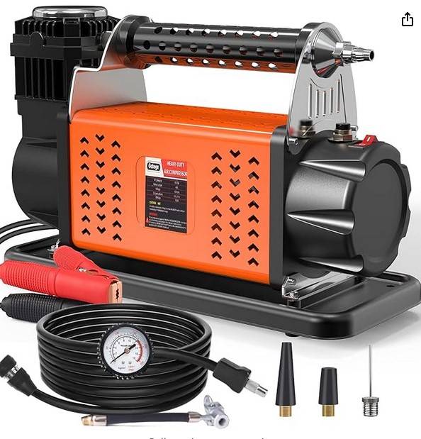

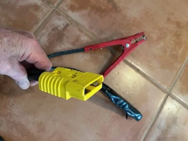

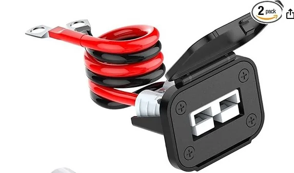

True, I figured the 45a figure was at high pressures on that compressor and I’m only using it up to 35psi. I also figured a 50A rating is likely conservative, with some additional buffer built in. I’ve started to order the different Anderson connectors just to get an idea of physical size. Leaning toward using the 4xe cowl door at this point, so will likely have quite a bit of room in there.
I don’t jump start too often, figure on those rare occasions I can pop the hood and use the clamp cables. I hear what you’re saying regarding short safely with the connector vs clamps, but might not be worth the extra size/work for my use scenario.

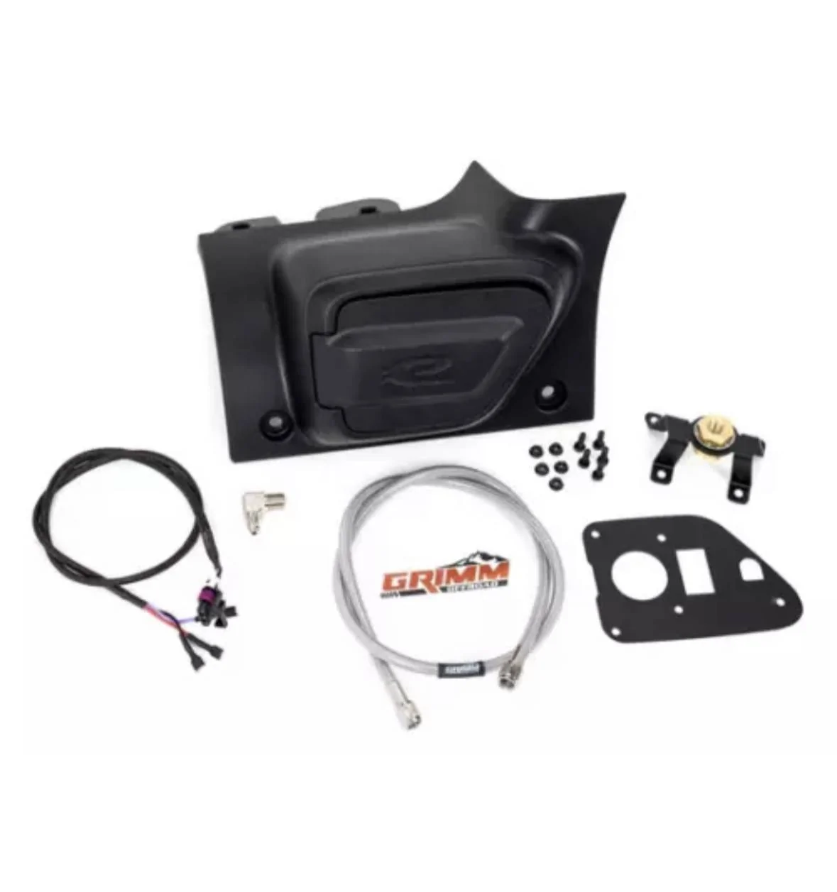

Doing a little research and Grimm has something to get you started. A little pricey but at least you have a template.

Thank you, yea I saw that too. Perfect for someone looking to do an air hook up. I was seeing the 4xe cowl for $80 and the charge door assembly for $170, so $250ish before shipping. I think that Grimm kit is $390. I’d prob have to gut either one to fit the Anderson plug, so will prob just get the bare bones setup. Although I hadn’t noticed that square cut out on the Grimm plate, going to look into it more now
