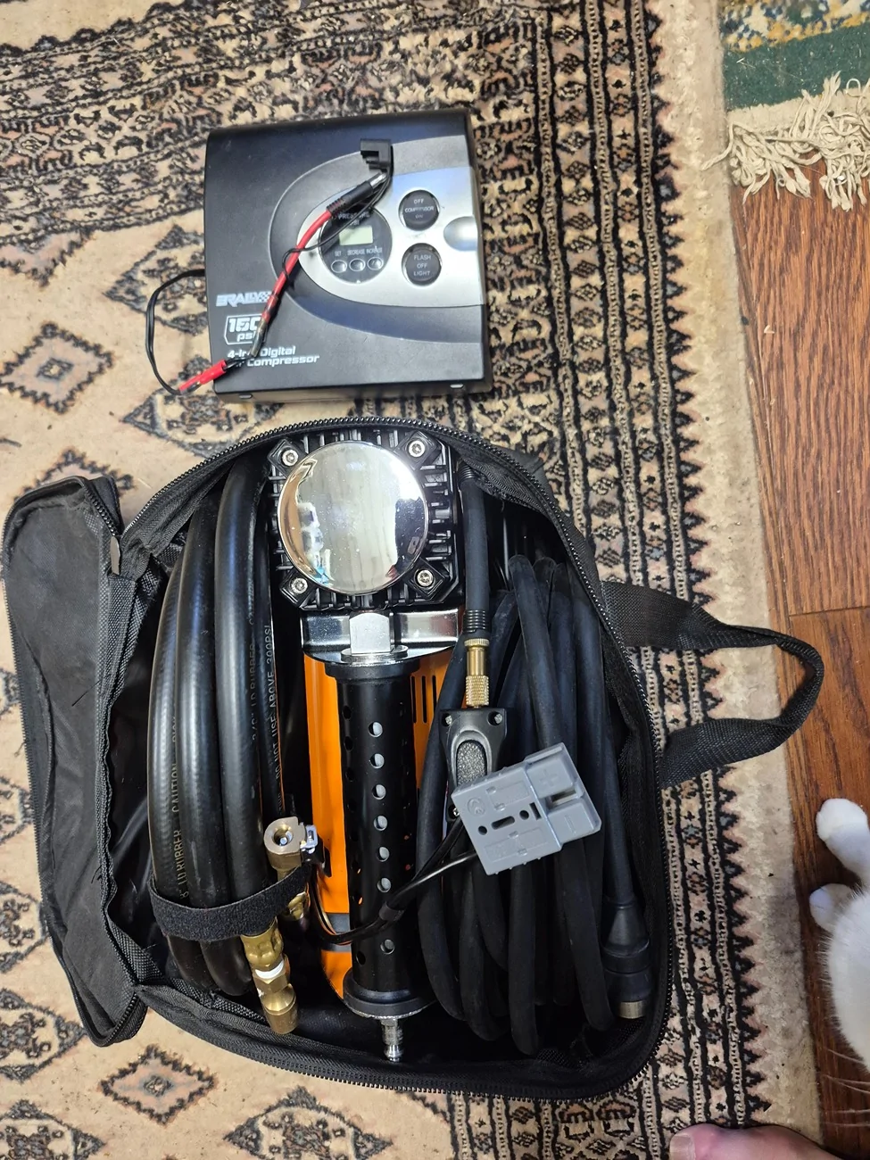

On most of the 12v portable air compressors that has a 12v plug I replace them with SAE or Anderson connectors. I've had several of them melt down.
If talking those portable emergency air comps SAE might be fine (still iffy), but they are too small for anything like an ARB or MOORFlate. SAE connectors are usually around 20amps max, my MOORFlate has an initial draw of 90amps, and settles down to 45-60 while running. Even an SB50 is on the small side for a lot of them, especially if they are dual cylinder.
On the larger air compressors I use Anderson connectors too.
Jeep Gladiator Anderson Plug / Connector in bed. 17695568735698315035768849617236
On that one it's a direct to the battery with it running one.
