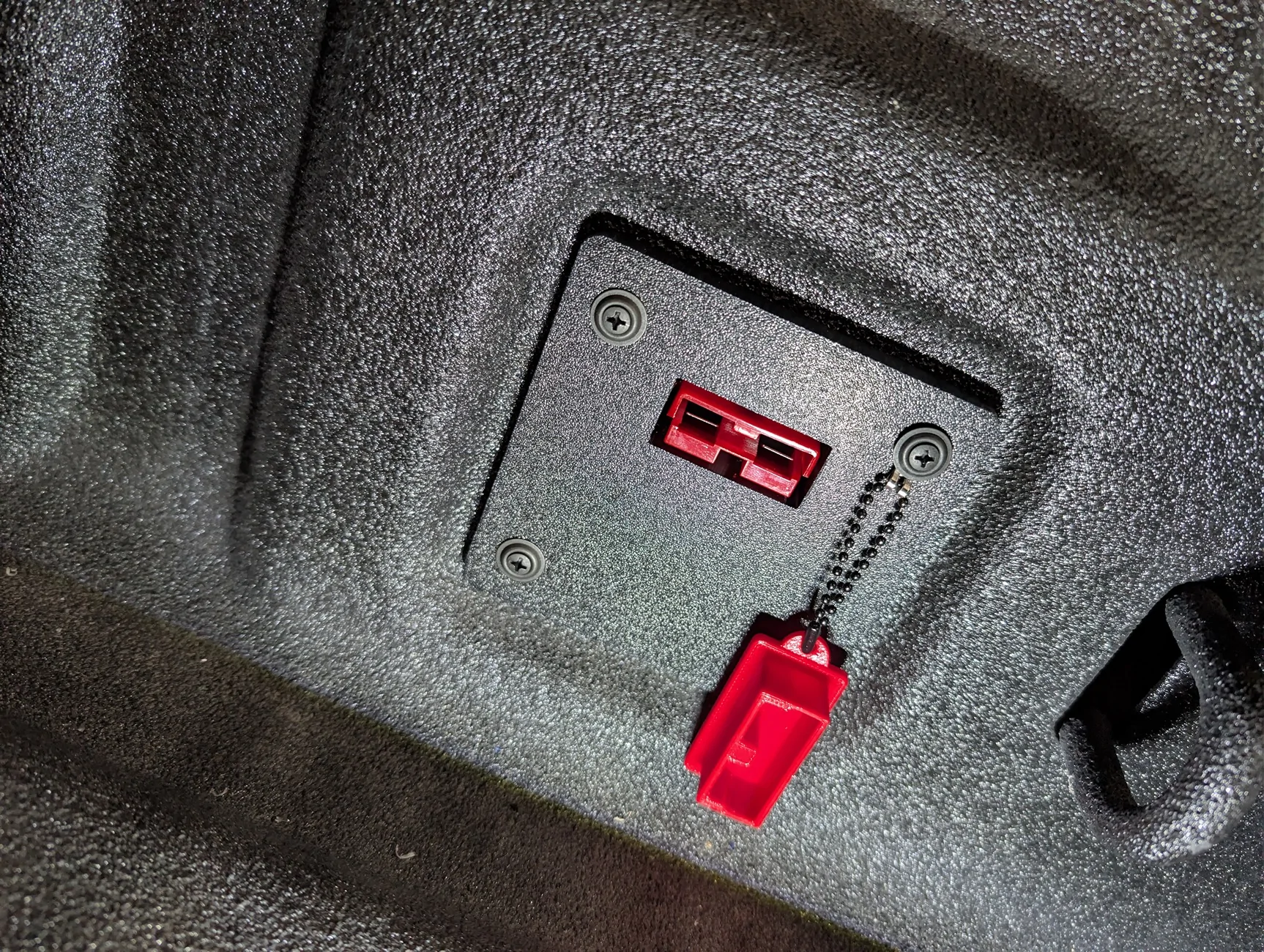

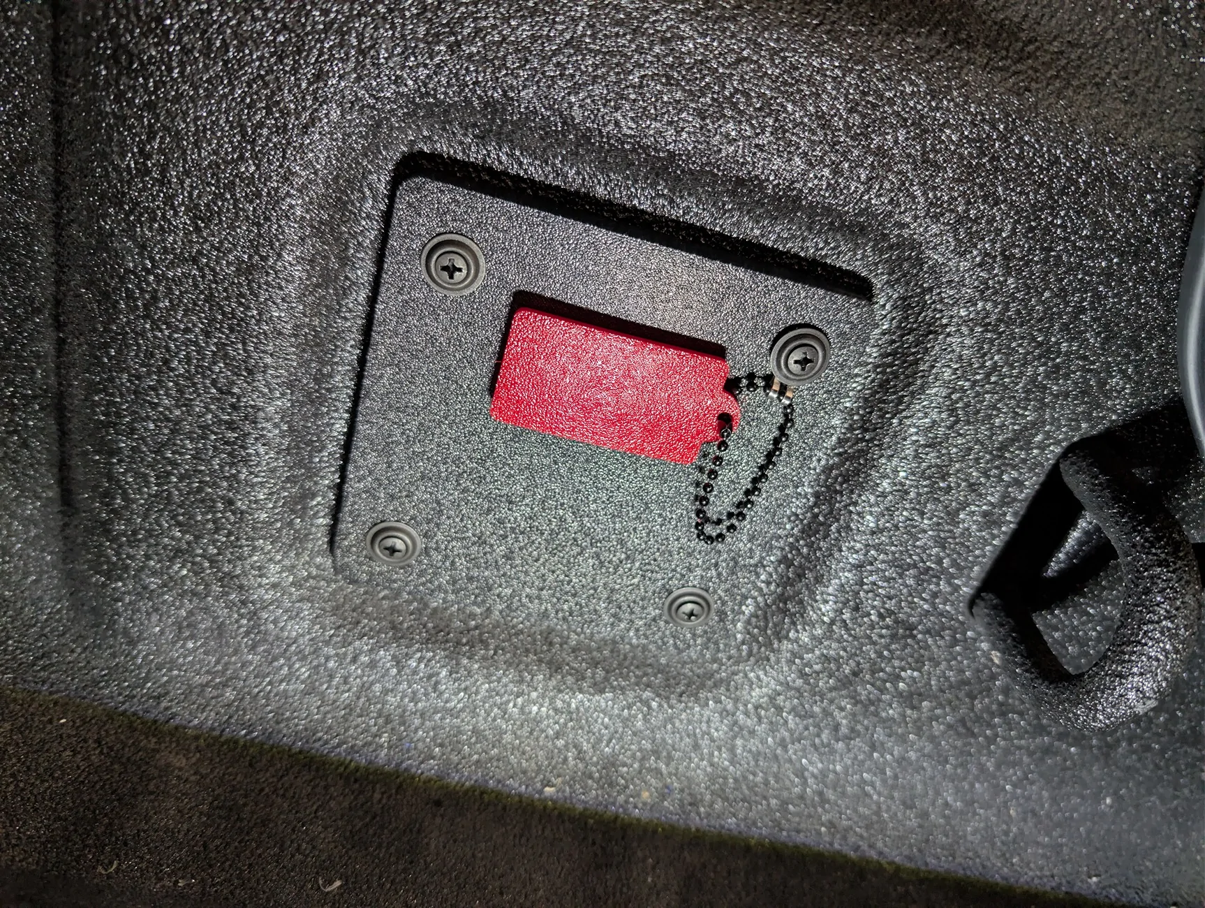

Figured I'd show what I came up with for that spot. I 3D printed the housing for an Anderson plug the. Printed up a cover for it when not in use. Still have room to put another 12V something if I need to

Well that's nice and sanitary. Bust out the label maker and put something cute on there. 'Left Index Finger' and 'Right Index Finger.' :CWL:
Or like claymores what is it, "Front to Enemy"
If you are willing, and if that will fit the connectors I need to use to run a 2,500 pound ATV winch - I'll buy one of those setups from you. Not kidding.
I agree. This could be a nice little side hustle…for some Christmas money.
Sure, I don't mind. What rating are you looking for? This is the 50A, but I have a 175A that I could probably model up and print as well. Probably wouldn't be a bad idea to work up a couple of different configurations anyway.
