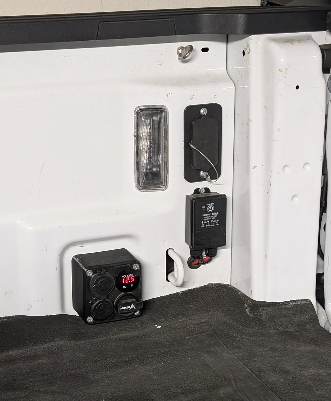

I cut a hole and installed a 175a Anderson connector in my bed with a 3D-printed mount and weather cover I bought from Etsy. Power is routed direct from the battery with 00 welding wire and a 150a circuit breaker. I use it to power my 2000w inverter, charge my aux battery boxes, run my MORRFlate compressor, and plug in with jumper cables. Anderson connectors are terrific.

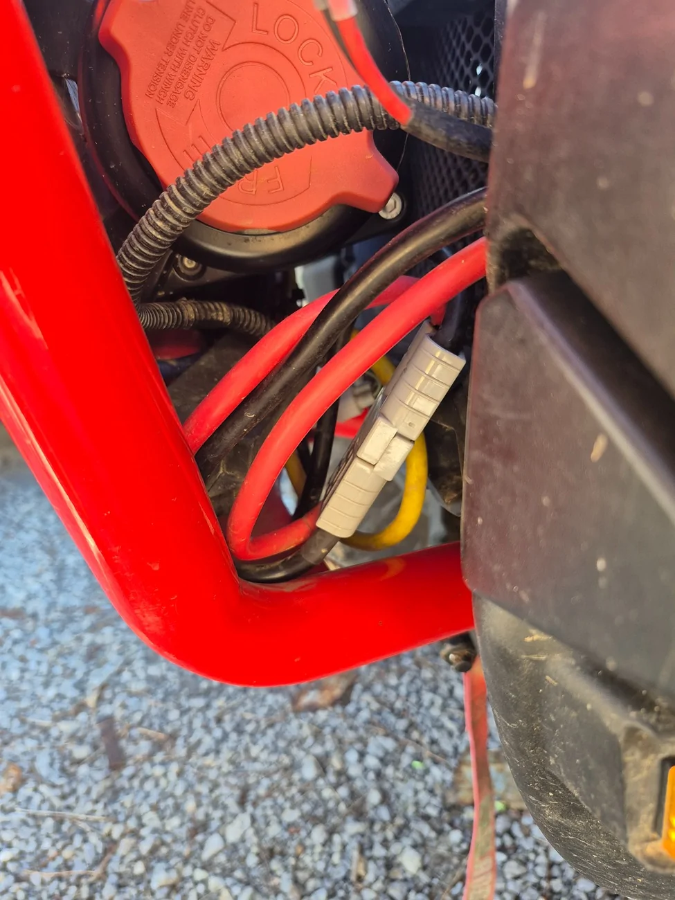

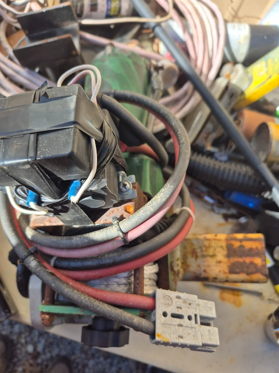

I've tried to nail down the load of that HF 2500 pound little winch for over a year - it has a break that is either 35 or 50 amp and I can't recall right now without digging and my head is swirling from the oxy pain killers and other reasons. Some say it can pull well over 100 amps, but the wire on the think would be lucky to handle 40 amps so it's really confusing. Nothing about the wiring or breaker that it comes with, or even the remote control box wiring suggests it will draw very many amps.
I'm only concerned with pulling non-running cars up the incline of my tilt-bed trailer, which would be a much less incline than using RAMPS.
Aluma says my trailer bed at full tilt is about 8.5 to 9 degrees.
So any winch would not be pulling very hard.
Man, I have to stop thinking, my head is spinning and throbbing.
Bill sorry I missed your post on this, I'm using a 50 amp Anderson connectors for one on my 4 wheeler and another one, I've not had any problems.

Top one is 2k the bottom one on 4wheeler is 3.5k.
