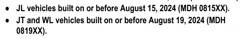

Since this one was built in September 2024, I guess we can toss FCA's TSB out the window!
Jeep Gladiator Another Cam bites the dust... 1754260330393-zh
Supposedly, those are the break-points in the TSB. The kit is for vehicles exhibiting the issues and built before those dates.
Hey, Jeep - I guess you were wrong!

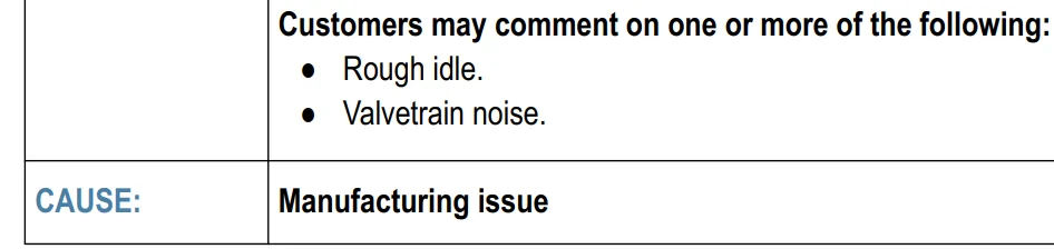

All great questions - however, nothing anyone, even employees of Stellantis, are likely to know unless they are in that specific role working on the issue.
We don't even know who makes the cams for them, where they are sourced as far as suppliers, if there's more than one, whatever.
Since many are sold post-warranty, you'd have to know raw replacement market sales numbers.
Jeep Gladiator Another Cam bites the dust... 1754267150491-hh
Manufacturing issue - wow, that really narrows it down! What step in the making of a cam? Materials of the blank? Machining the surface? Post machining treatments?
We don't know who makes them - how many suppliers they are, or who performs which processes on them.
