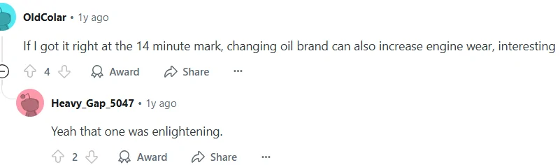

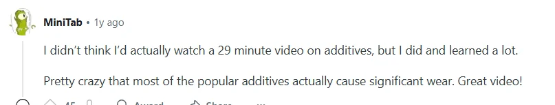

This is a comment on a video by the Motor Oil Geek -
Thats why I would never switch.. whats the old adage... 🤔 if it works why fix it . Something like that. Only way I would is if they quit making what I use.
My salesperson for Amsoil told me that the signature series years ago was recommended by Amsoil for heavy use and high mileage engines and BEFORE they had there own high mileage oil that is what they used. So I went with it and stayed with it. I do however believe in Fuel additives though.
