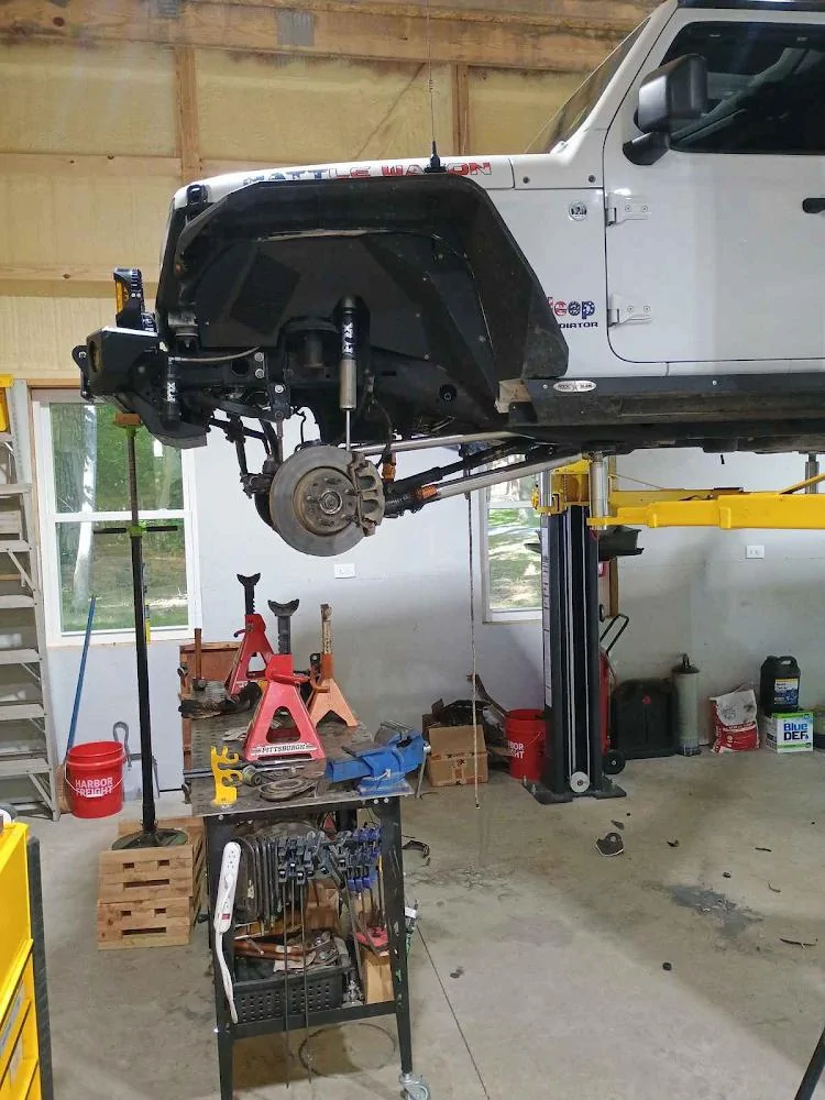

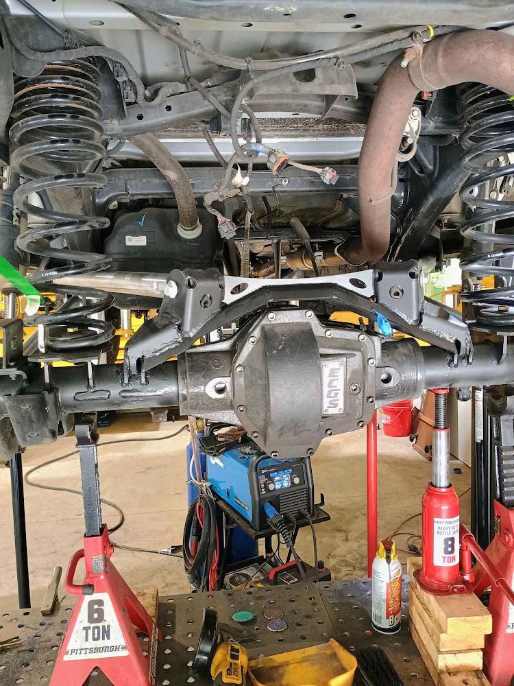

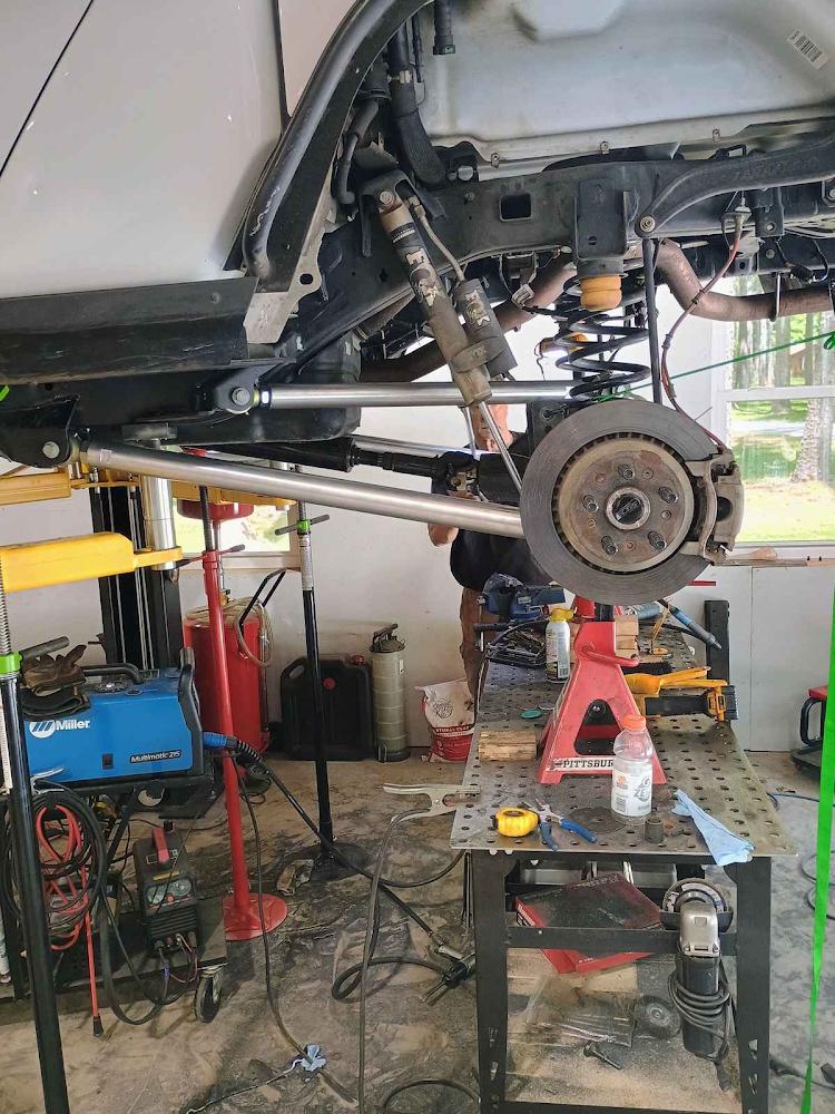

Installed Artec 4 link front and rear suspension. Cutting OEM mounts off was a bear. 3 1/2 days with two old guys and a lift. End result is an amazing ride. Gone is the tendancy to wander and dart all over the road. The lack of cross talk between the front and rear is very noticable. Bumps seem softer and cornering is also improved. Was going to upgrade to Coilover, but after thsi I think just a good set of King Smoothies will eb perfect.

Long really do make a big difference, especially when the lift and tires get taller. Is the rear truss all from artec or did you have to adapt it to work with that specific diff?
The ride quality is night and day different on long arms. Rattle Wagon has a Semi Float D60 rear. ARTEC does make a axle side mount for Dana 60 and now Dana 80s to work with their triangulated kit. Only down side is it takes forever to get them to deliver their kits/parts. ( promised 30 day, actual 3 months)
A side note, they say their front crossmember ( transmission X member) will not work on the JT.... Total rubbish. The supplied cross member works 100%. . Their kit supplies a triangulated mount that bolts to the frame ( Assuming it is gas powered) that is not required. There are no instructions supplied in their kit either. You have to ask for them, in my cae several times. Their website doen't carry the info specific to the kit. If you buy one, I can forward the kit instructions (3parts) to you.
