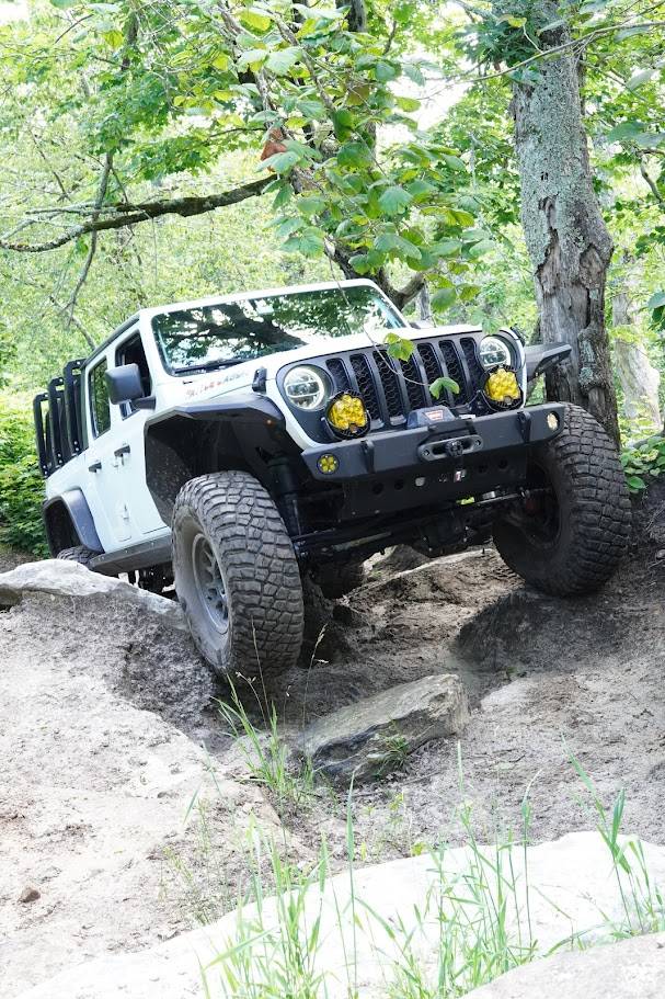

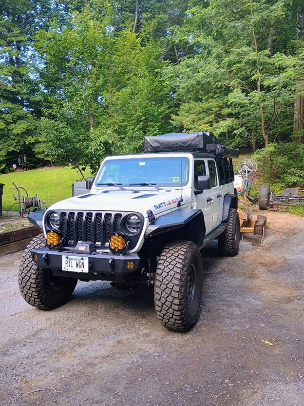

It has been a minute since I updated this post.
EOC delete is running great lots of power and still getting decent fuel mileage.
BFG 39s are working great in a mix of on road and off.
Added Accuair's Air spring suspension. This is going to be an overland rig that will see some harder trails so I wanted the ability to be able to carry a bit more without dragging the rear around. The addition of being able to level the truck in a camp site is a great feature as well. The install eats up the spare storage space so the spare is on an AEV mount in the bed behind the drivers side.
Yeseau FTM 500 dual band for comms. mounted the head on the dash and the body under the rear seat. Clean install with minimal mess.
Genesis dual battery take up the under rear seat storage with a Group 31 "aux" battery and buss bar
Star Link Mini is being mounted on the roof to keep connected and provide cell comms in remote areas.
ICECO 65 qt fridge/freezer is mounted on a platform in the bed with a slide of easy use. To power the fridge installed a Genesis remote power station with gauge and on/off switch.
Teraflex trackbar and track bar brace are installed to keep this thing pointed straight down the road.
To shed some light on the trail I have a pair of Baja Designs LP9 mounted up front. 12.500 Lumens should do the trick.
OVS 3 man tent is installed atop a exo-rack with a soft topper hiding under to keep the bed dry.
Also found a deal on an 8 gallon solar water heater which is installed atop the rack just behind a OVS 270 awning. Almost ready for the west coast trip. Rubicon here we come.
