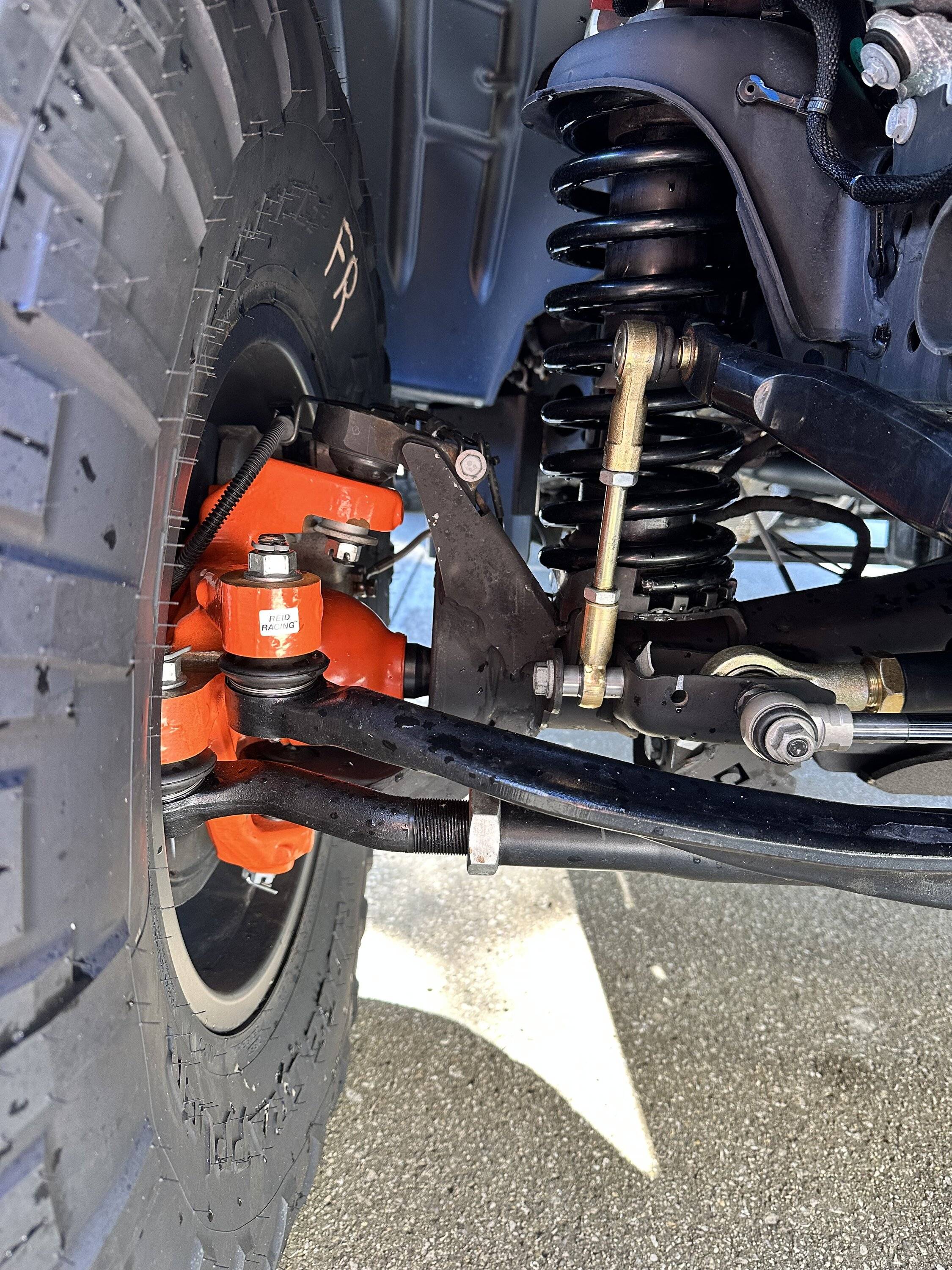

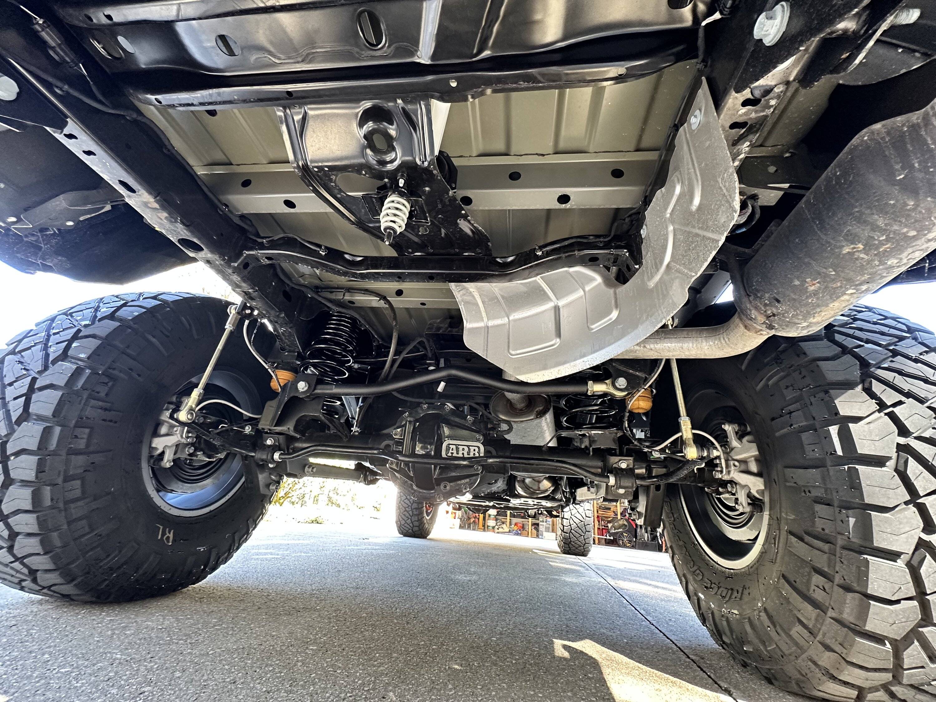

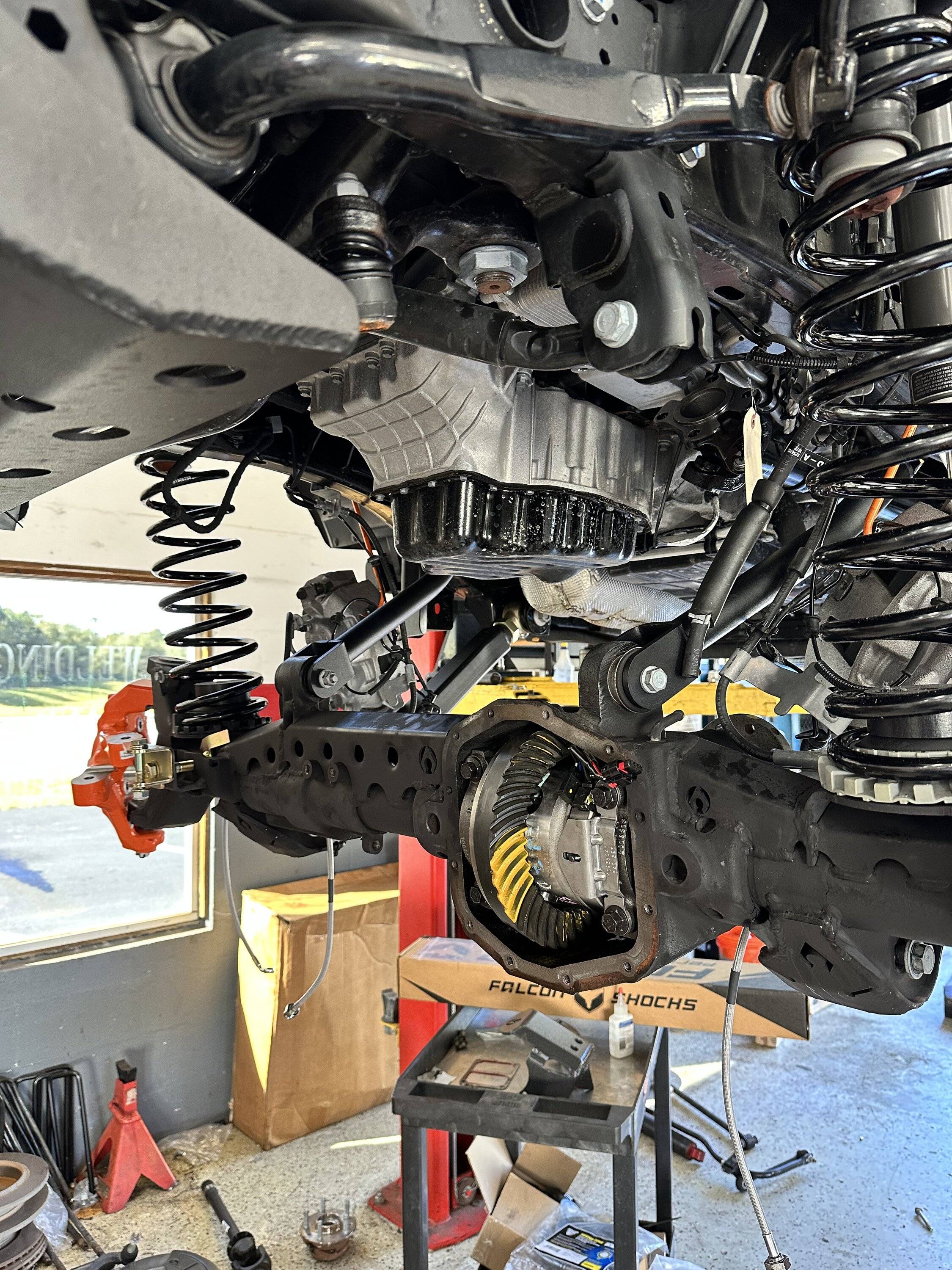

Initial Build:

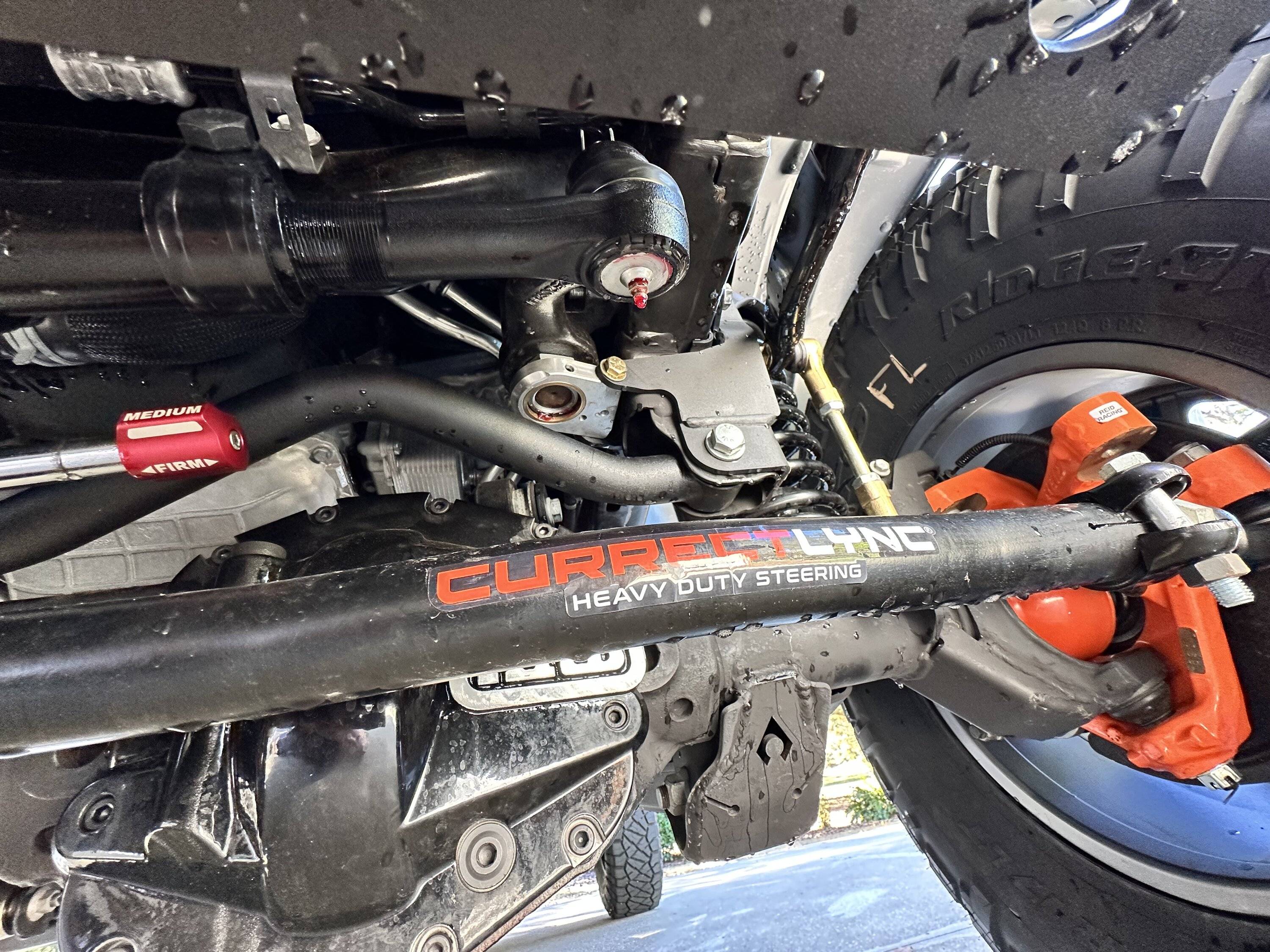

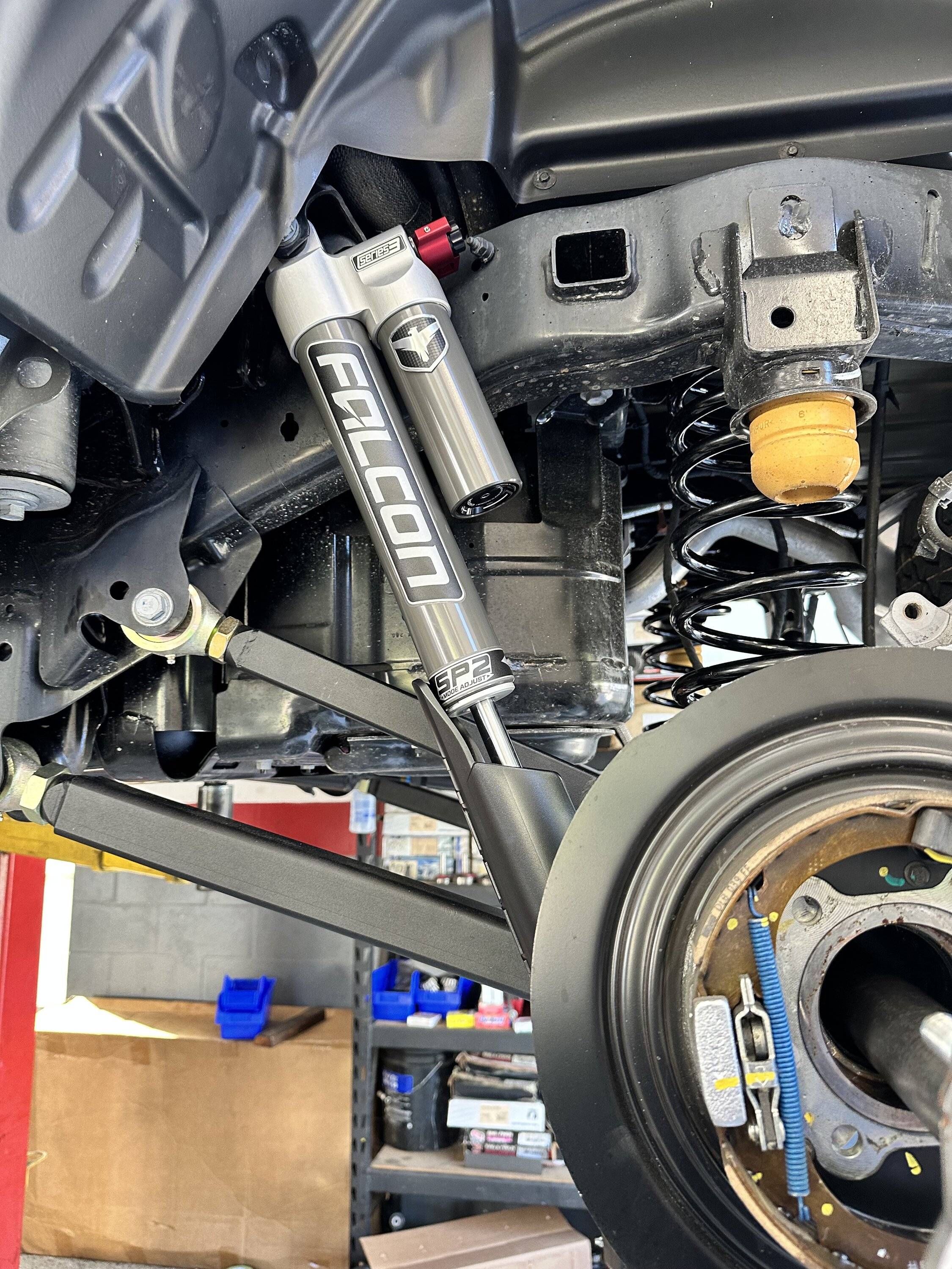

Clayton Offroad Diesel 1.5" Overland Plus with Currie Currect-Lync Steering and Falcon SP2 3.3 2-3" JT Diesel Shocks. (This has netted approx. 3.5" in the front and 2" in the rear)
Dana 4:56 gears (Just on 2000 RPM at 70-75mph)
RCV Performance Ultimate CV Axles

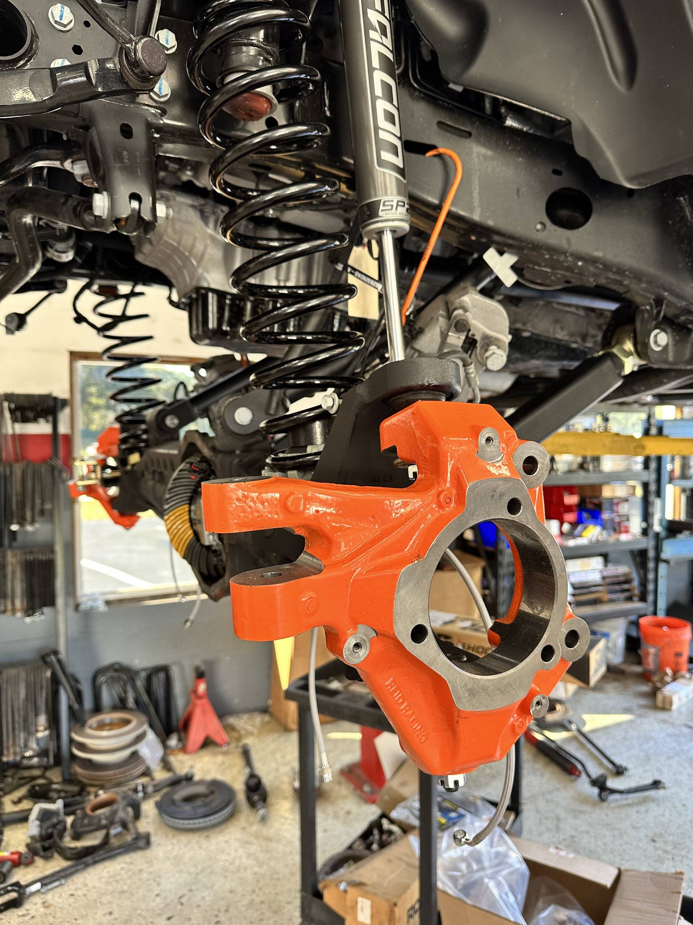

Reid Racing Knuckles (I know the JT comes with steel but this future proofs for flipped drag link options when I go to a taller lift)
Dynatrac Ball Joints
Artec APEX front axle armor kit/truss
Adams front and rear drive shafts with 1350's
Synergy front and rear extended steel brake lines
Synergy sector shaft brace
ARB Diff covers
Tazer
Dirty Life Wheels and Nitto Ridge Grapplers 37x12.5X17
To complete the initial look I also added a winch and Next Venture front bumper/guard plus the mandatory mats, covers and additional locks. A big improvement to "turbo lag" was the addition of a pedal commander.

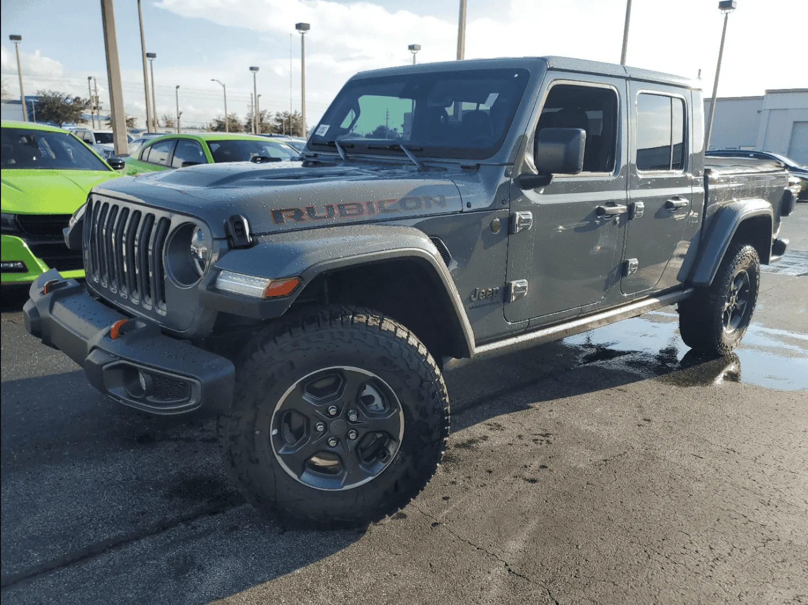

Here's where I started.

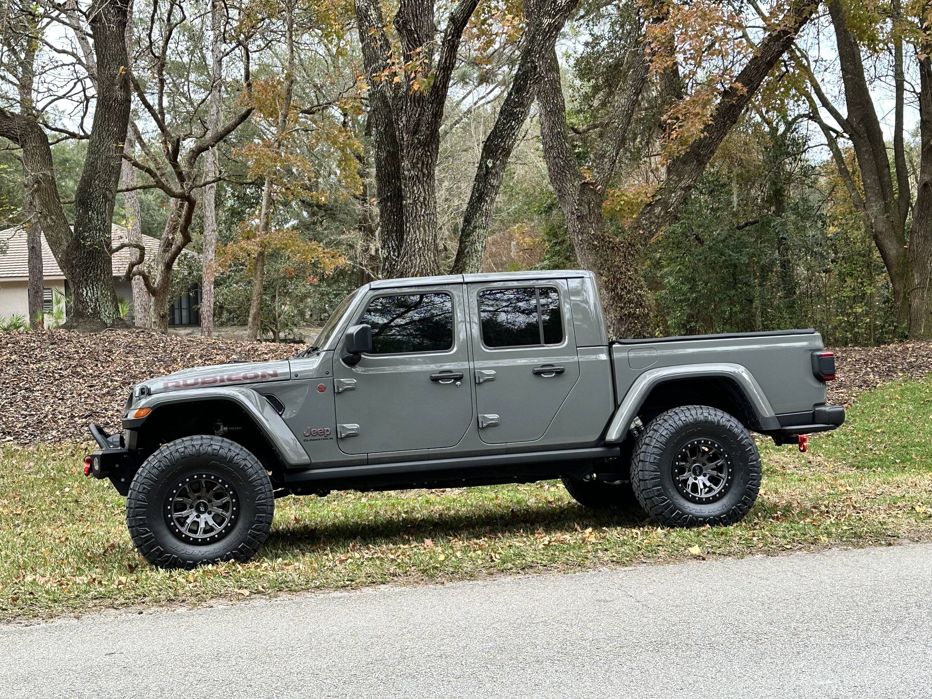

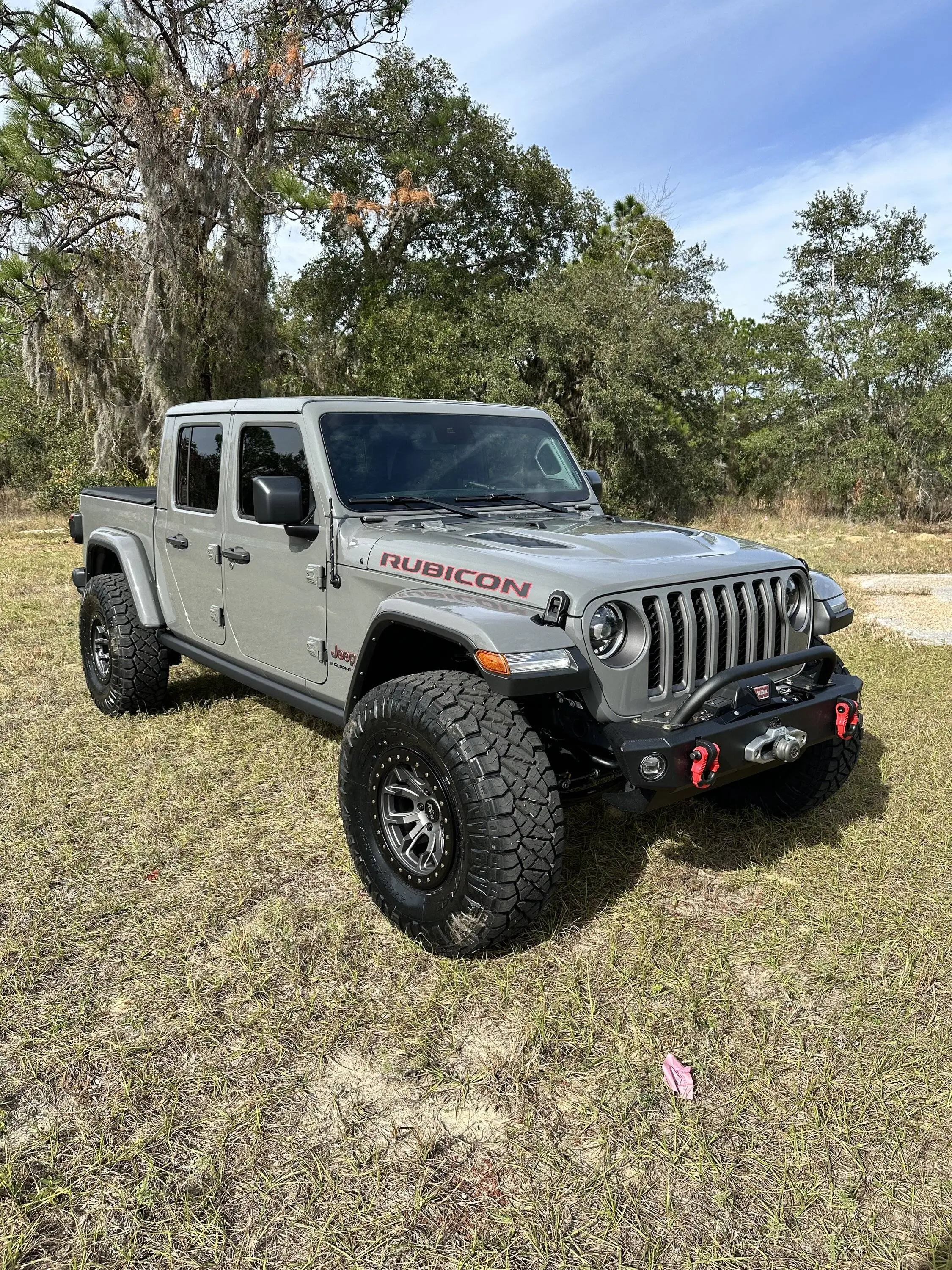

And where I am now.

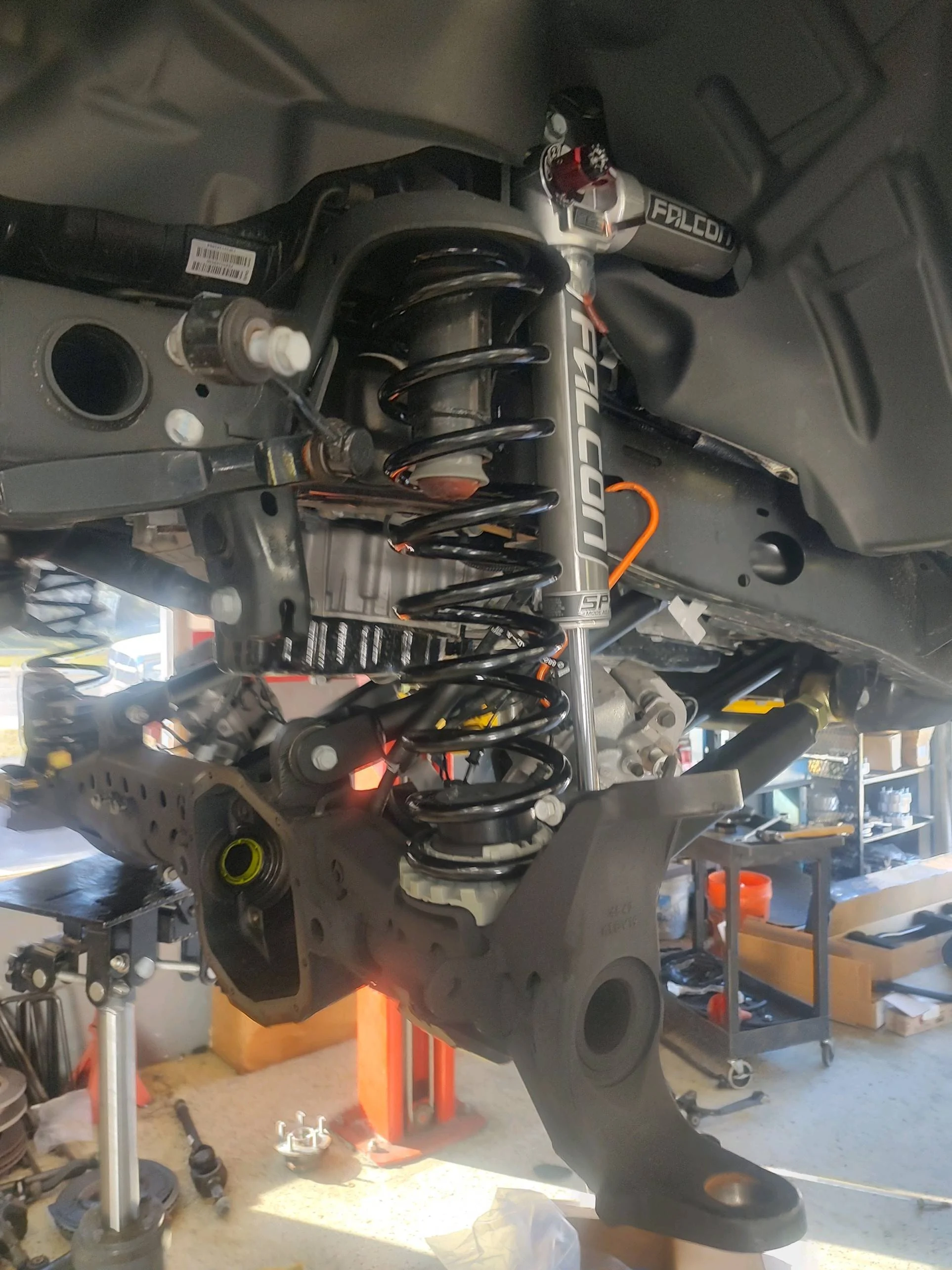

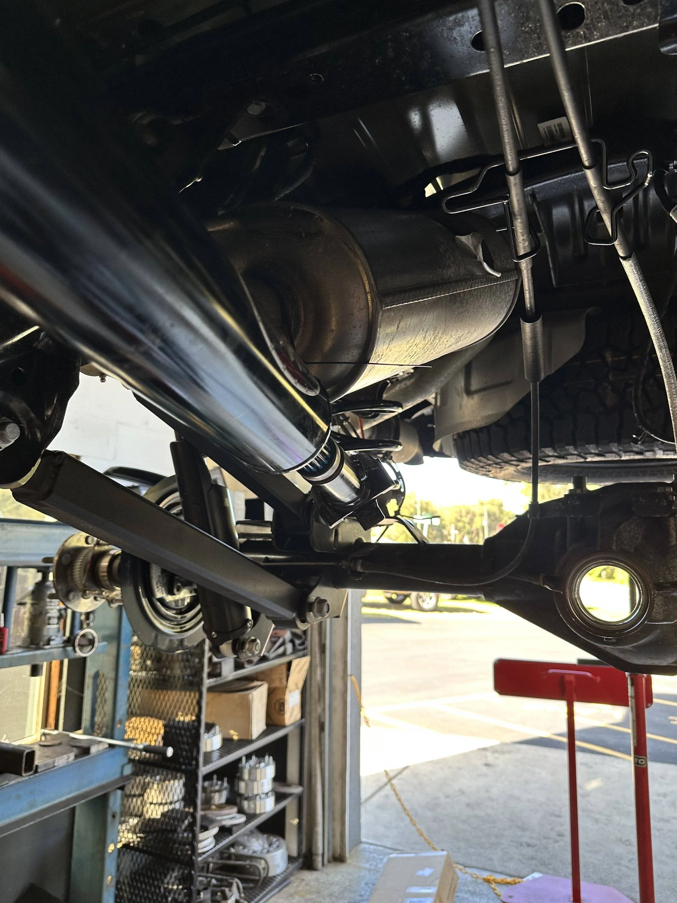

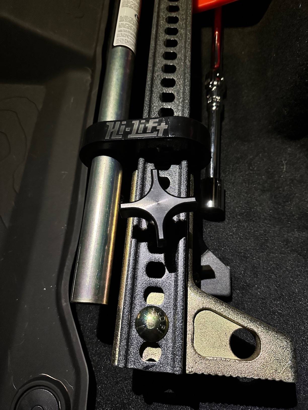

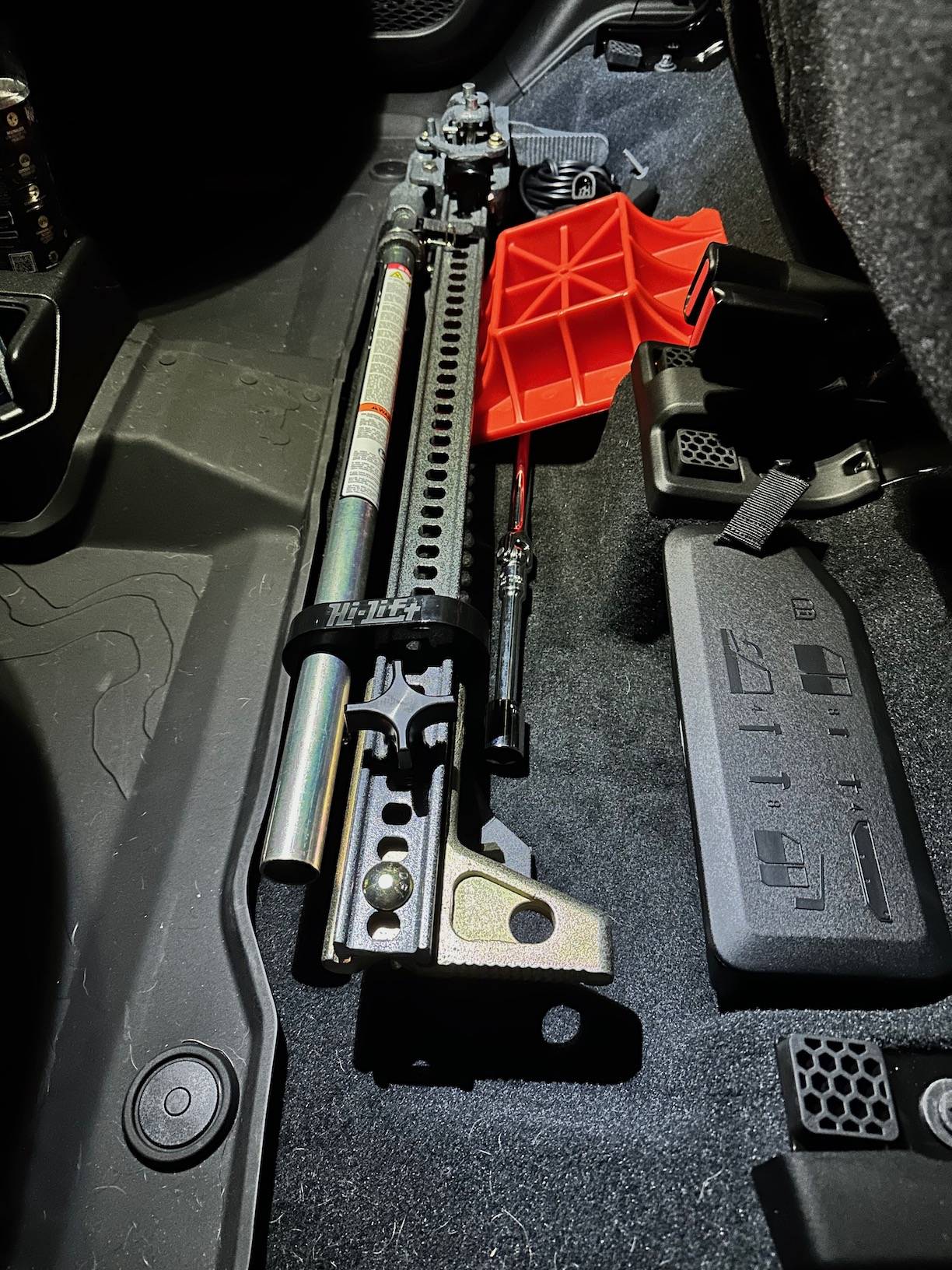

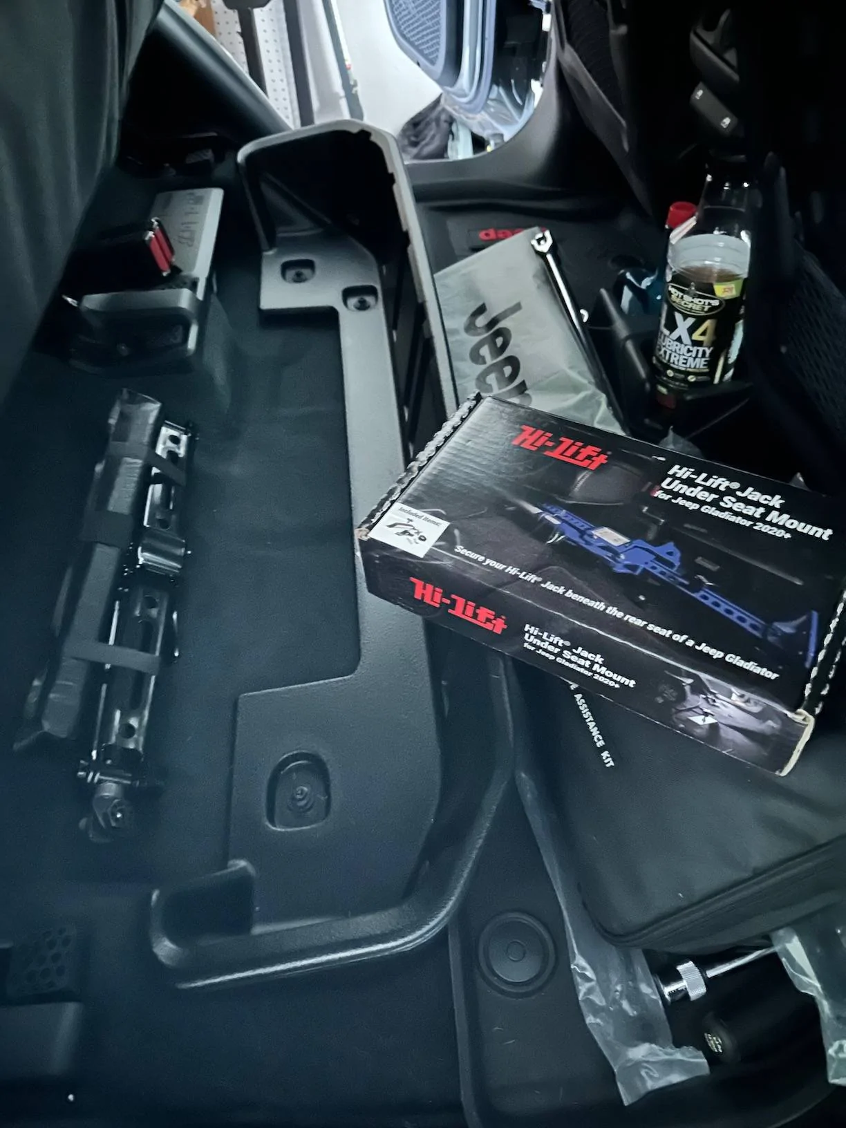

So the build continues, I'm still looking at spare wheel mounts and associated racks. I'm also down to a couple of choices for Molle Bed Panels, but in the interim I removed the plastic box under the rear seat so that I could carry my hi-lift jack.
Jeep Gladiator "GrayBell" JTRD Build Hi-Lift 1
Jeep Gladiator "GrayBell" JTRD Build Hi Lift 2
Jeep Gladiator "GrayBell" JTRD Build Hi Lift 3
