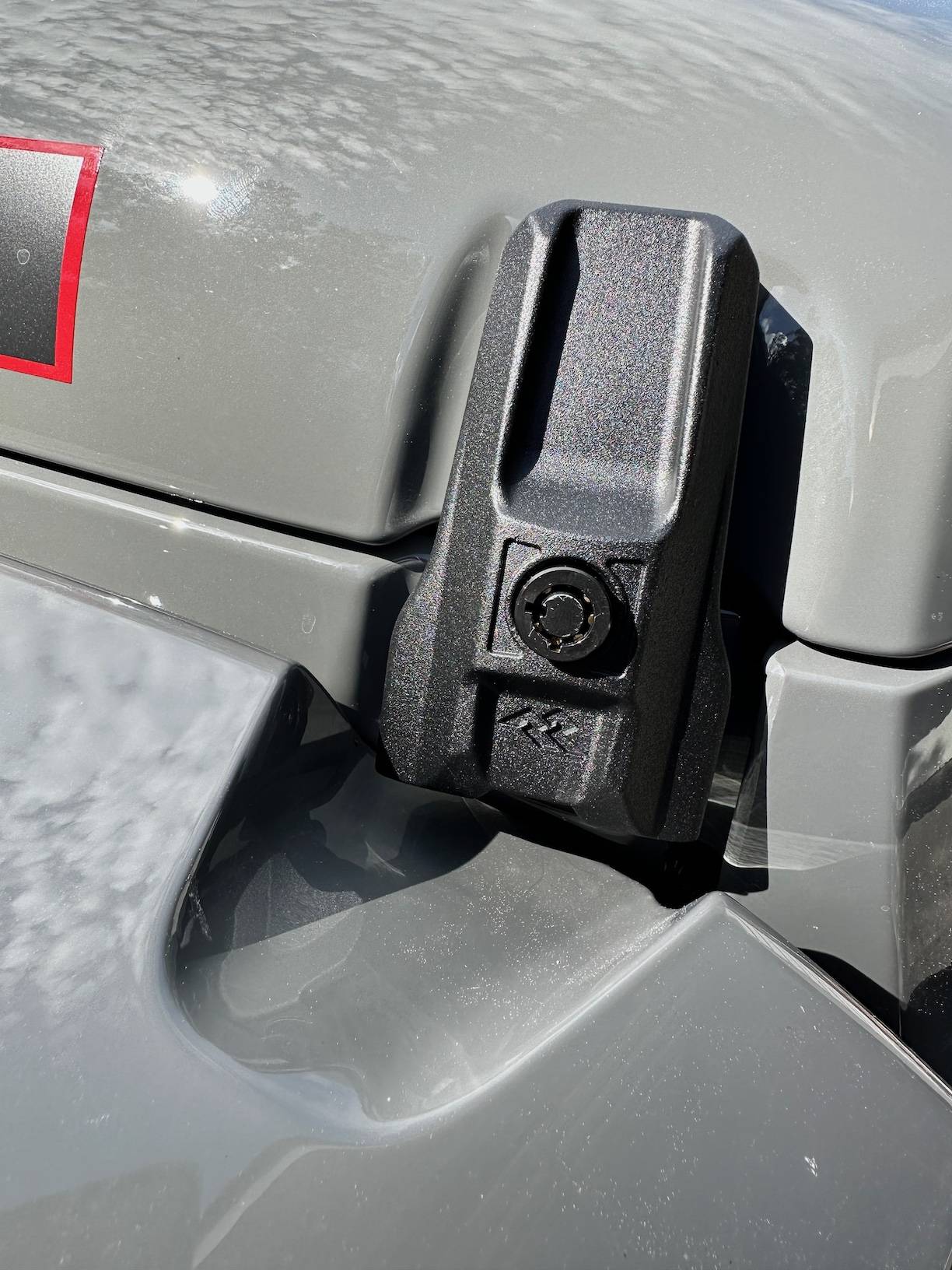

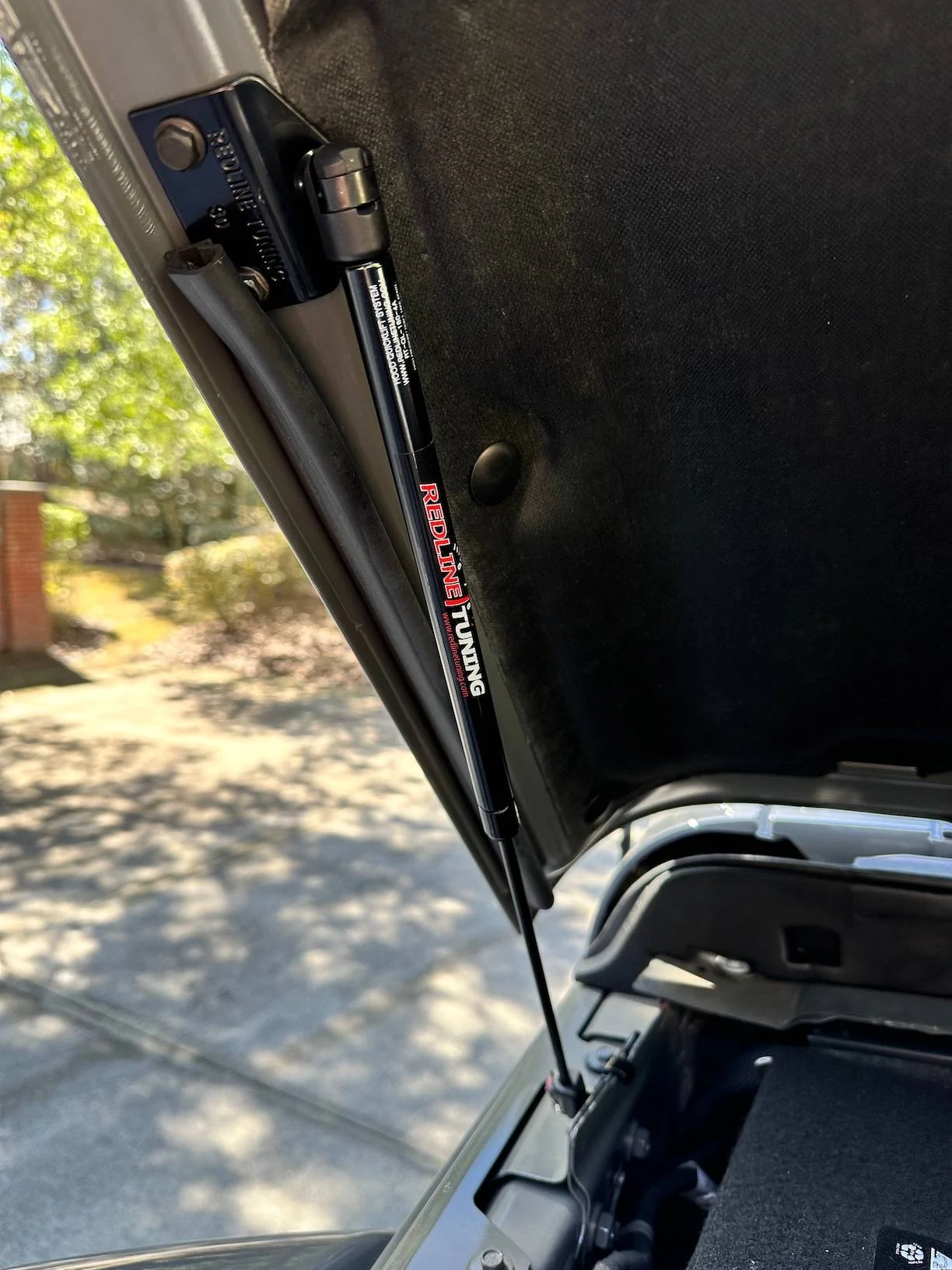

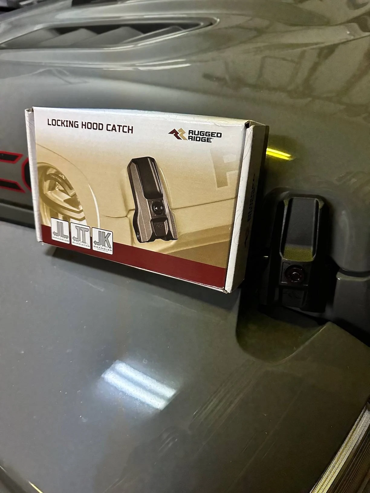

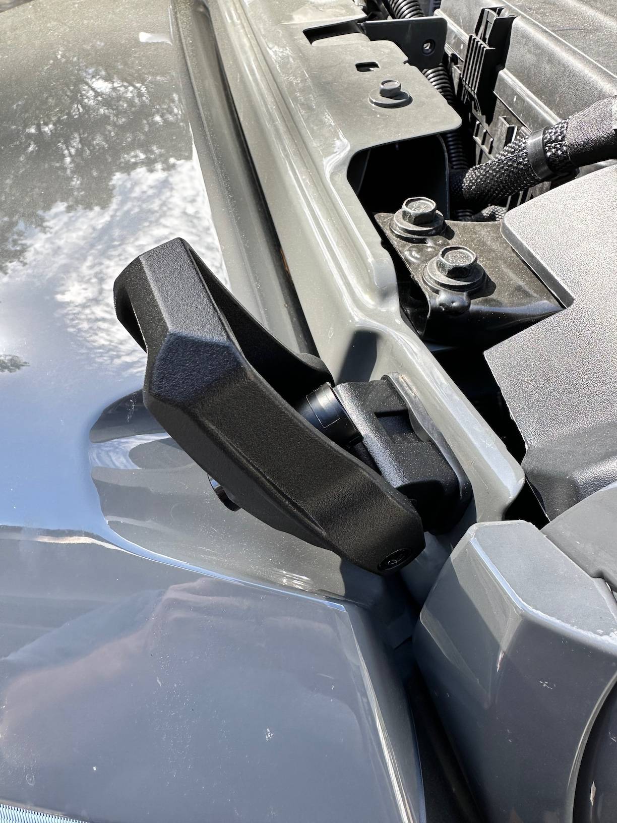

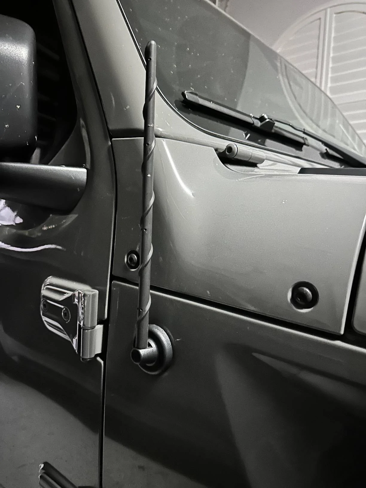

Thanks to everyone providing information in other posts, been reading lots on bed racks, but did a couple of quick cost effective changes (busy weekend). Redline and Rugged Ridge latches on the hood. Can't stop someone from taking a ride but maybe slow them down? Also reduced the aerial height down to 13" and improved reception.

So many cheap cars as a kid... I will not waste my offroad budget on struts. But to each their own. Just installed a couple interior mods that will be on my thread.
The struts are nice for the Mojave’s super heavy steel hood. Especially for the price.
