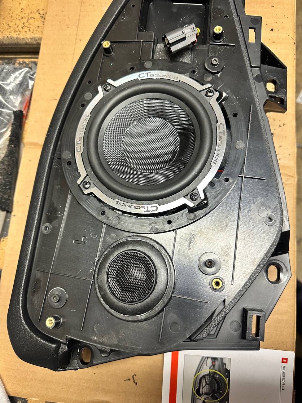

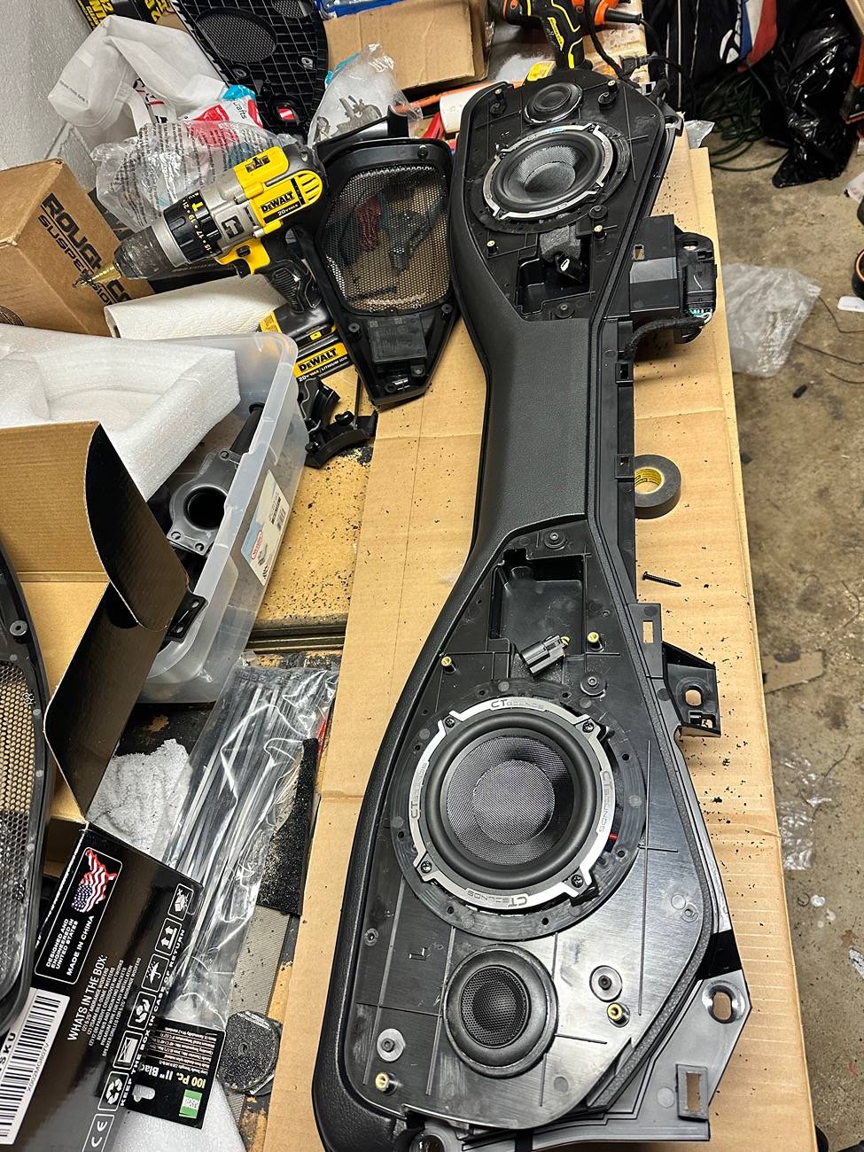

I just did a complete install on my 24’ Willy’s w base stereo. I bought the pods and installed a 5 1/4” component set w / 1” tweeters in soundbar. Removed all soundbar baffling and packed with poly fill and foam to tighten up the channels inside. Also put some sound dampening mat inside. Pretty easy just beware of the airbag equipment right along the cross brace above the soundbar. They are paired with a 3 way component set in the front with 6.5” in knee pod, 3.5” in dash and 1” tweets surface mounted to dash grill.
