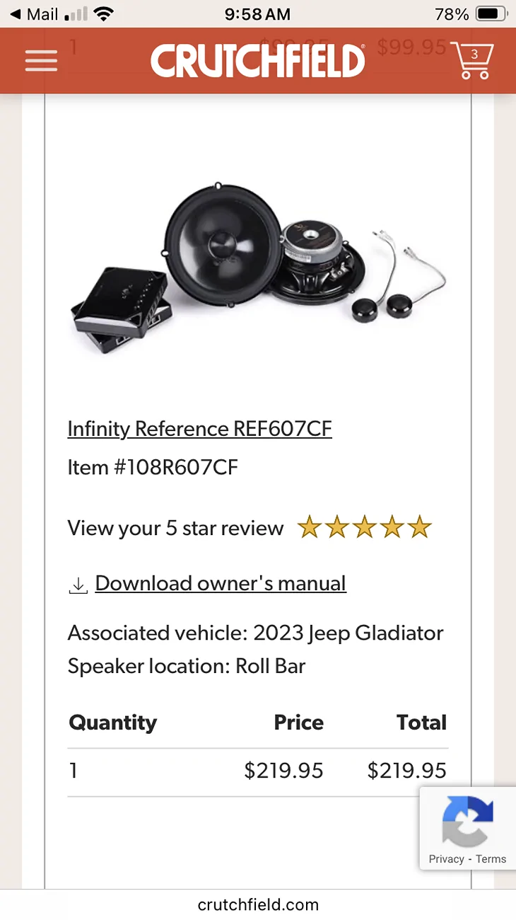

Does it matter that you had the Alpine premium system vs I did not? Or does yours have an amp? I’m starting to really consider the Infinity brand. They are twice as much as the Kickers I was looking at though
