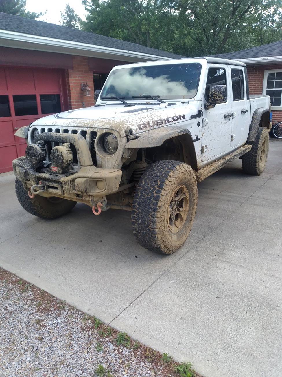

I scored some slick AEV wheels and want to put AT's on them and just keep my MT set with the trashed wheels for well, wheeling. I had Faulken AT's but they got so loud on the highway after 15-20kk miles. My general experience is that aggressive tread tires get louder as they wear. Anyone find ones that haven't? Looking at Toyo ATs.
I do tire testing, and for the price and 50k warranty, hands down Kenda AT2s. You can check the price on simpletire.com and then buy locally. I have over 30k miles, half on extreme trails, and they are awesome.
