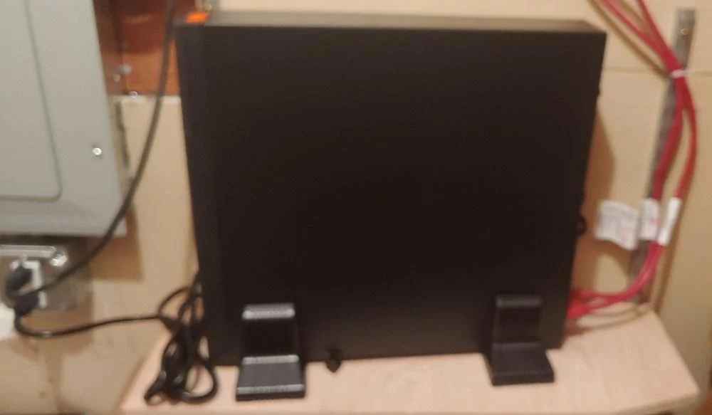

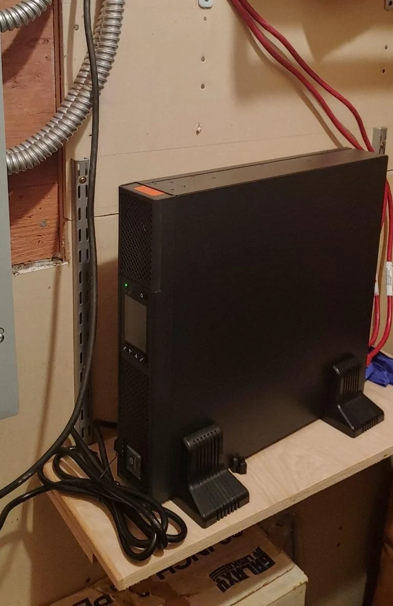

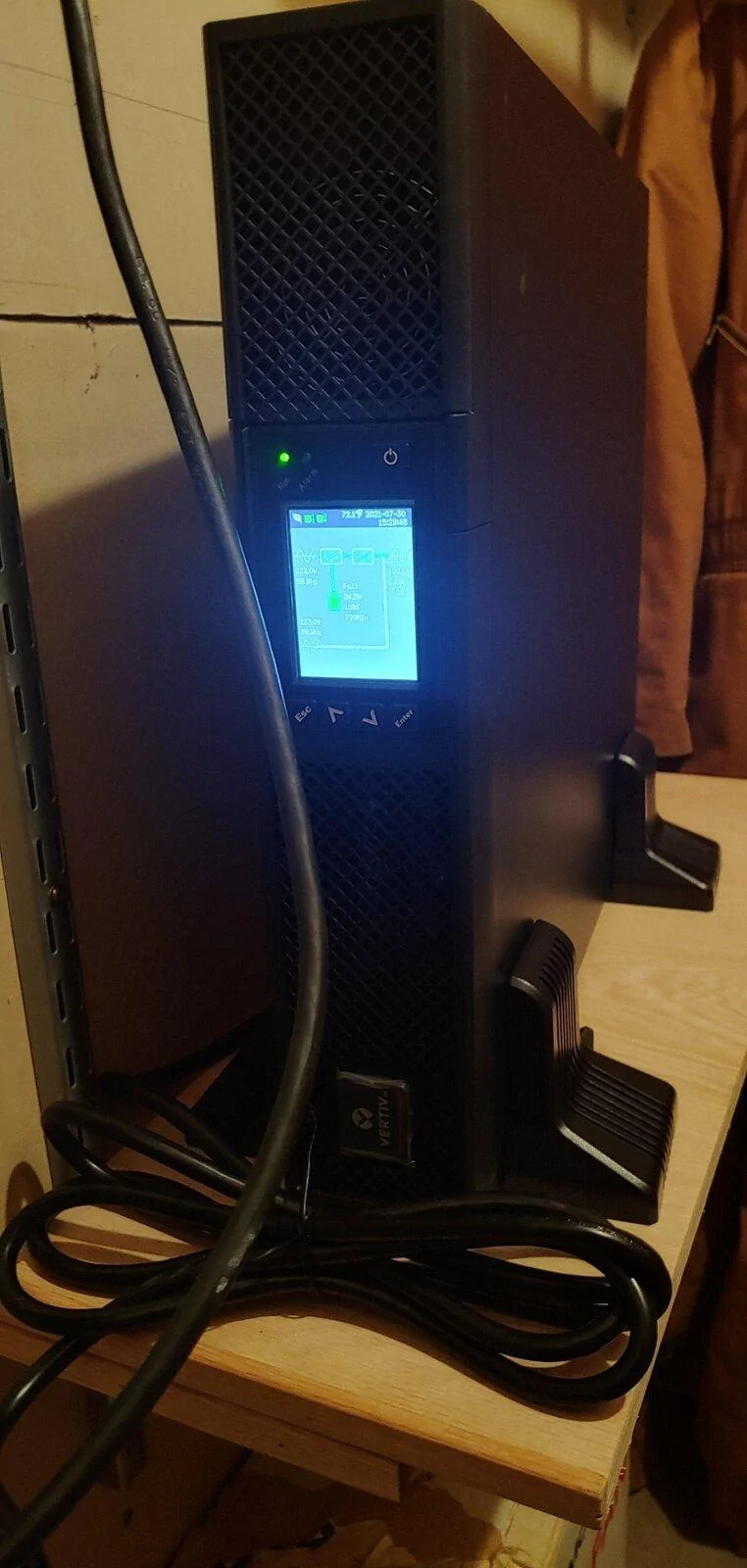

I bought the GXT5 1500 and in talking to the rep decided to get something to cover my Tablo (a Canadian compact DVR with cool features), Orbi router, Cisco desktopswitch, and a couple of other things on the entertainment center area. For that I just bought a Liebert UPS, not true sine wave since that equipment is much more forgiving and I was mainly concerned about our periodic hiccups that throw things offline now and then.
Got the GXT5 installed and working. The guy even brought it out as he wanted to see my wife's quilting machine and the IQ equipment.
It's set up now to cover the quilting machine, IQ system and her embroidery machine.
Problem solved - pure sine wave clean power stable voltage stable frequency.
