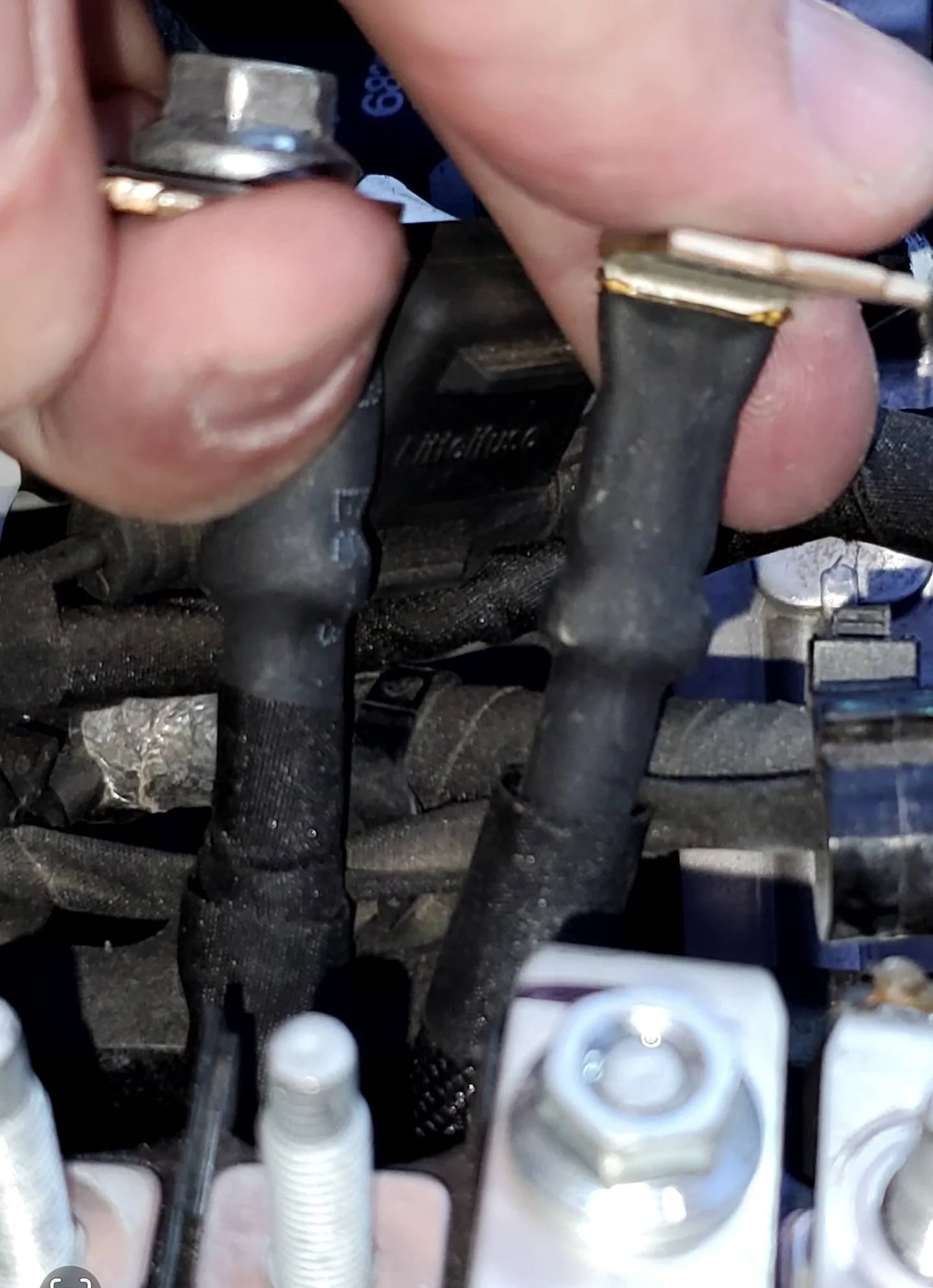

If you can pull 80 amps through it without blowing it, you have the 100 amp fuse.
On second thought, maybe you'd better not try that.
Yup - there's likely no visible markings without pulling it.
On the other hand, you have done much tougher things on that truck, much more challenging.
207
33,352
41,387
Tomorrow I'm gonna try a really bright light and camera angle...reference pic of where to look...
Wow,. that was quick.
But you have a 2021. Maybe it was a mid-year change?
Good thing you checked.
You could always sell that one to someone who has the base fan. You could recover some costs and they could save a bundle.
Yeah I'm just demoralized from the leaking rear window. Lol.
I've had the PDC out of the truck...should have looked then haha.
Nah thats a reference pic so I know where the markings are.
207
33,352
41,387
Whew, I thought damn, he's FAST! Got those nuts off and the wires pulled back and the fuse removed in like 2 minutes - and took a pic! LOL
In any case, good to check yours because we can only speculate as to the date the change was made, and whether or not they are doing like AMC did (and likely others). The parts book said for alternators - 'use xxxxx for replacement" meaning that it didn't matter if you had a 35, 40 or 55 amp alternator - if the dealer had a 55, use it to replace any alternator up to that size - AMC would reimburse. It reduced stocking costs to keep just one as a replacement.

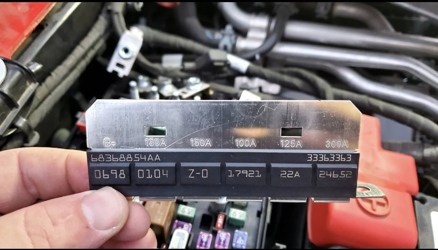

Part # location...reference I took from a video.
Jeep Gladiator Any issue putting the 850w fan on with the base alternator? Screenshot_20230118-211713_YouTube

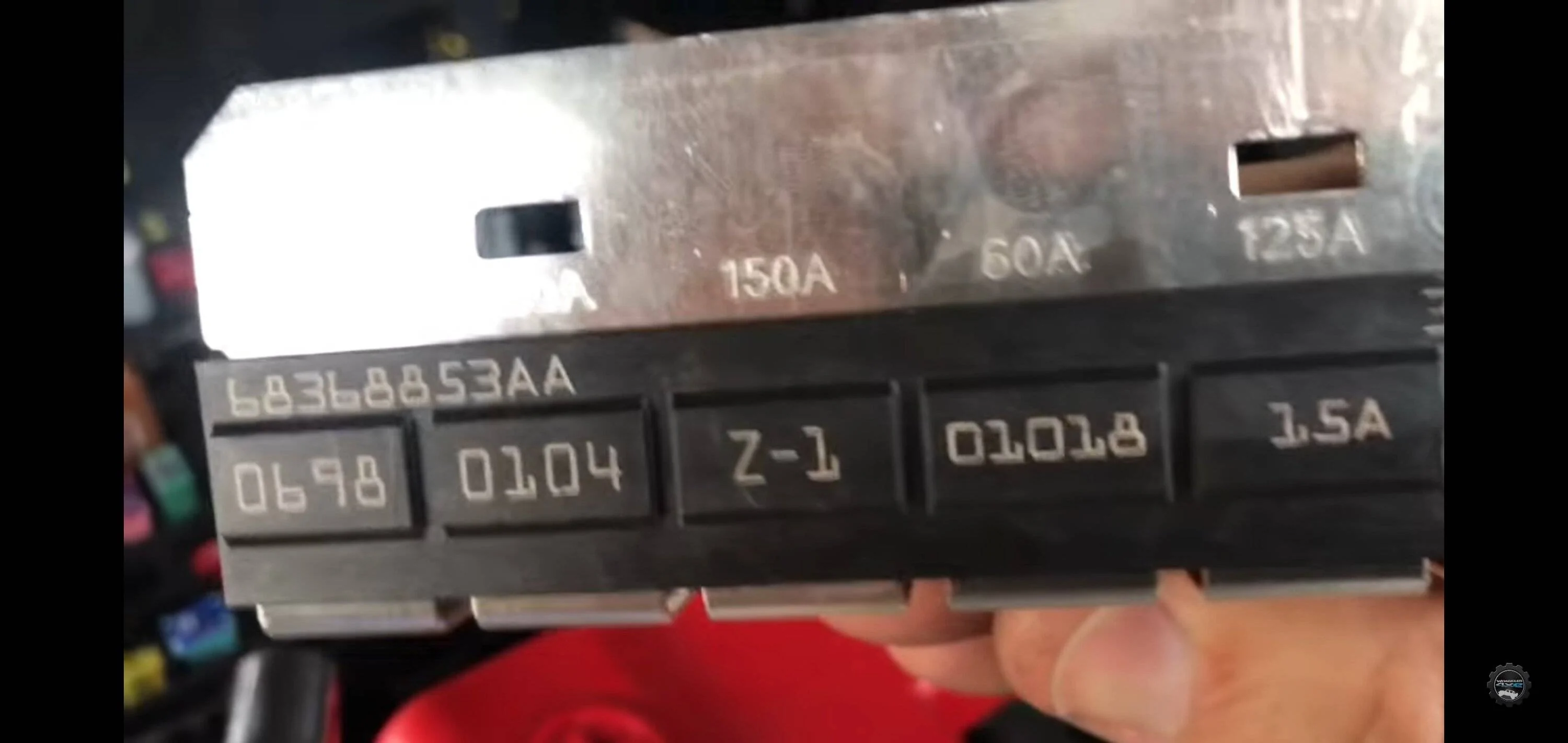

Hey I won one today!
100a Z5!
Jeep Gladiator Any issue putting the 850w fan on with the base alternator? Screenshot_20230119-172926_Gallery
Fan wire Z5 on right, next to Z6 which is 125a. Seems legit? Looks like all I have to do is install the fan. I will try it on the 180a alternator and see how it goes.

207
33,352
41,387
100a Z5!
You'll know if it can't keep the batteries charged............
