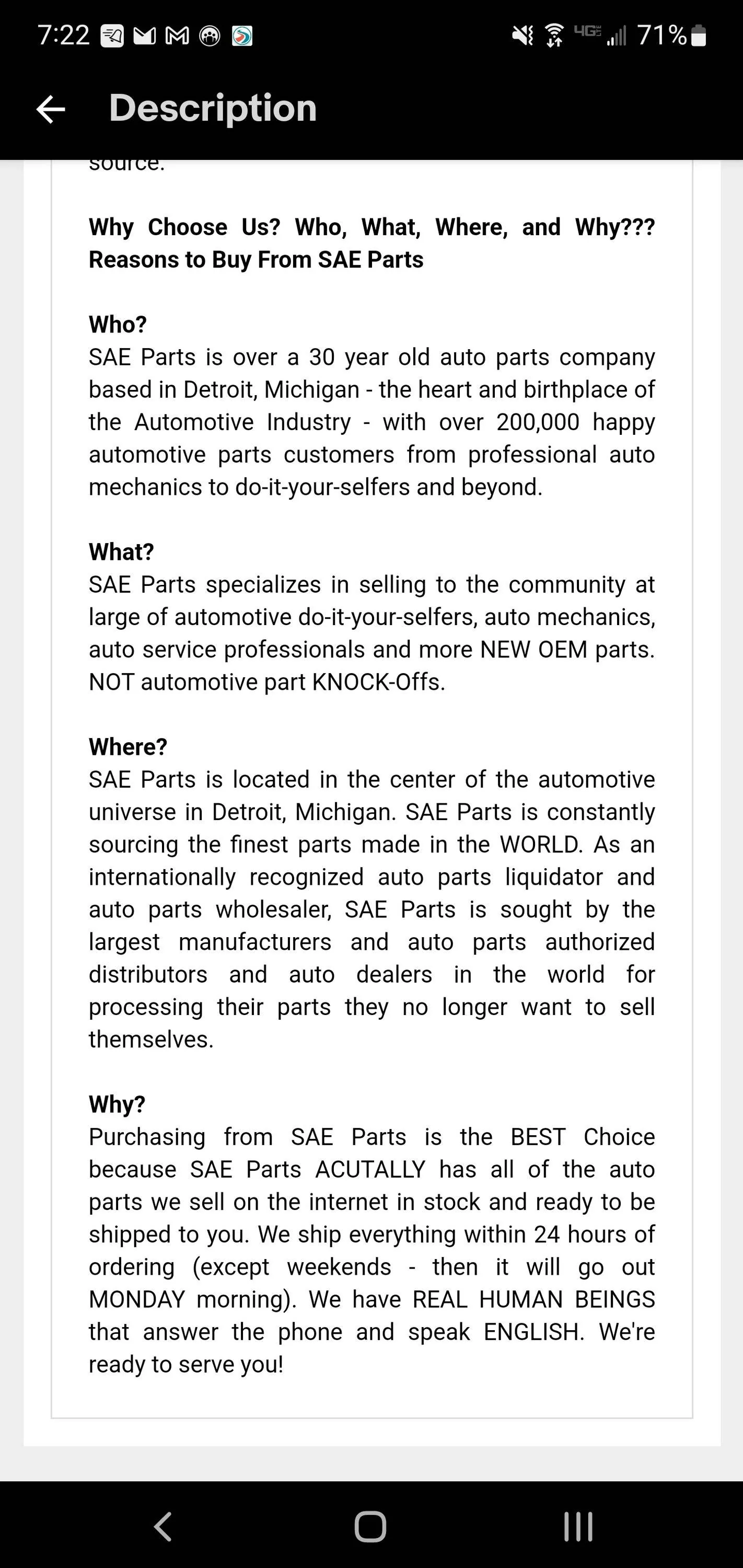

Might take a chance....seems legit.
Yeah, they may buy out closing inventory. Some friends of mine did that back in the 80s and are now making whale of a killing selling those parts for many many times what they paid for those of us trying to restore cars.
Dealerships go bust, parts inventory sometimes gets sold, parts stores go bust........... in fact O'Reilly's started that way if I recall - buying out bankrupt businesses.
It's new parts so if this is that sort of a deal, it's good stuff.

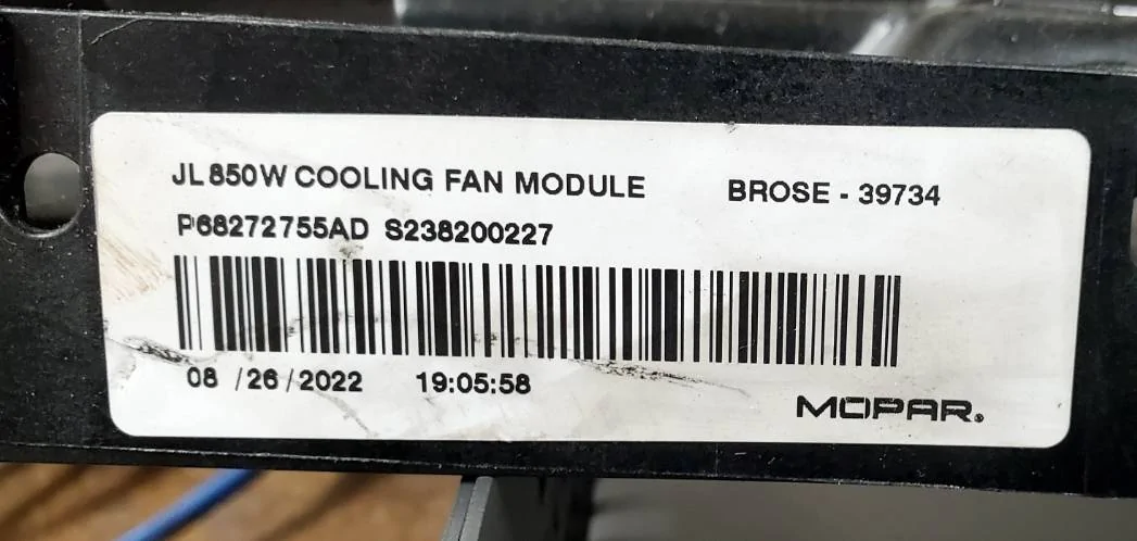

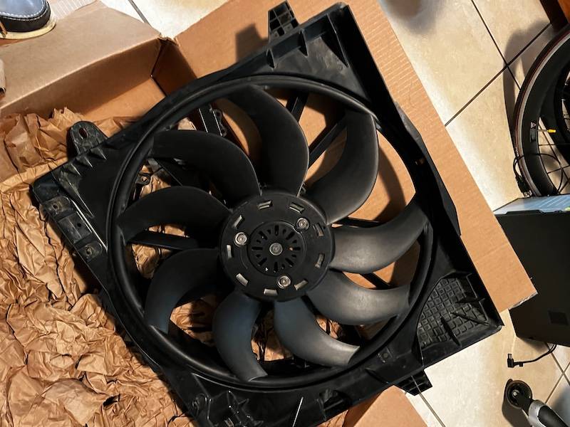

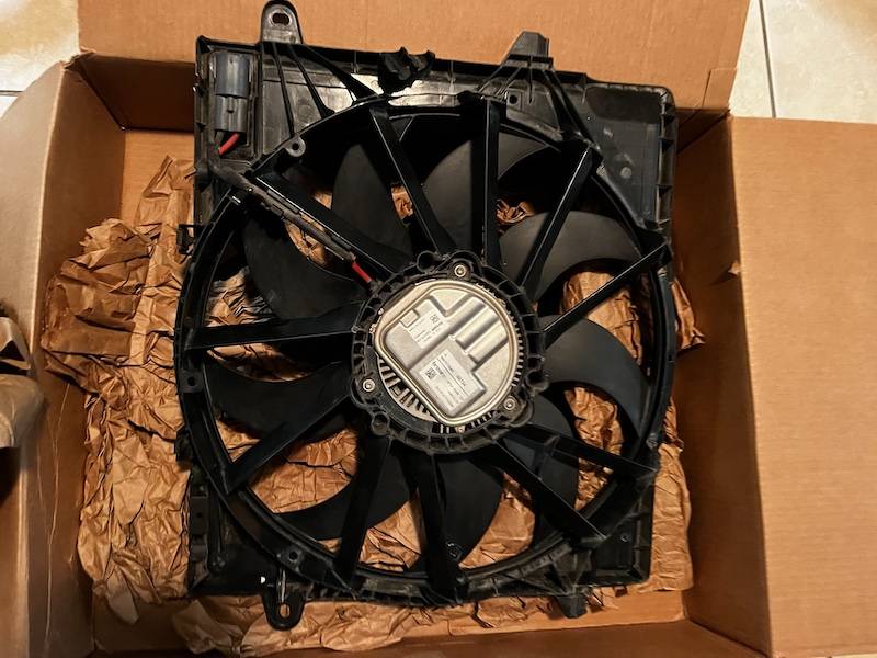

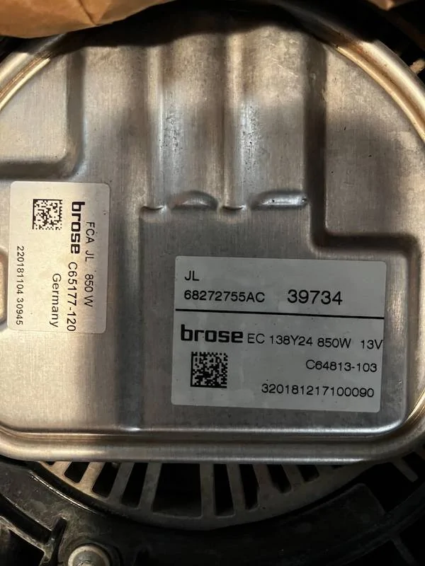

Fan arrived today... It was a take-off from someone that went with a Hemi conversion...
Nice....you're doesn't have a broken connector tab either like mine!

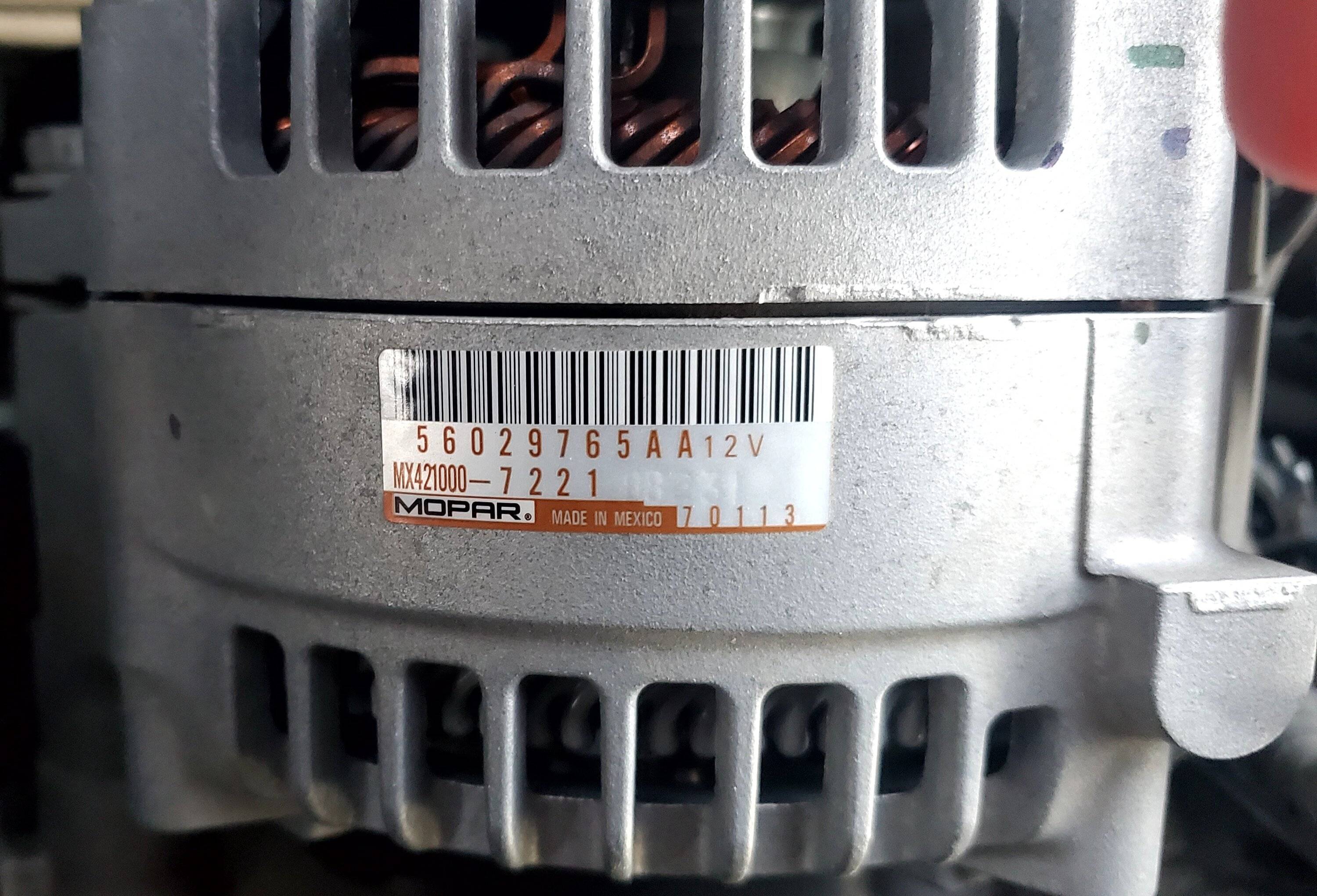

I only knew of the 180 and 240 alts. @ShadowsPapa mentioned a 220 in another thread and wow I have that one! I think no need for the 240. Saves me a couple hundred bucks! Thanks Papa!
Running out to check mine!
