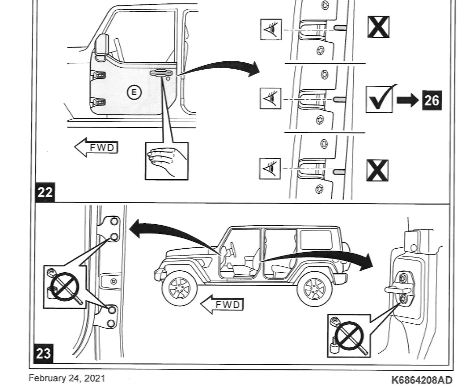

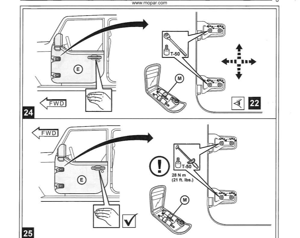

Don't you just loosen the bolts on the door, lift the door as much as you'd like, and tighten?
that is pretty much what the instruction in the boxes said for the factory half doors (I have a dual door group) first fitment I was supposed to adjust them, but I didn't and they were ill fitting all last summer, read the instruction one day when I was without the inter webs and early for something adjusted them the next summer work perfect
I will scan the instructions and put it on here

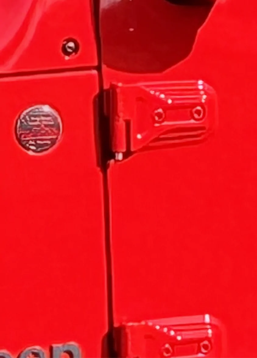

The body shop installed the hinges wrong. That sucks.
That’s what I’m thinking. And if the bolts weren’t painted I’d have no problem trying to adjust it. I’d hate to get the door adjusted just to have it look like crap because I messed up the paint on those bolts. Wonder if I could find a soft or non-marring torx socket?
The factory half doors Require you to adjust them the first time and are painted, full door are the same, absolutely no issue. The only issue you may find is if your body shop painted the bolt or hinges in
Please don’t do this. Adjust the striker on the door frame if anything. But if it was at a body shop, take it back and let them fix it.
in fact the factory manual says not to adjust the striker
here is the half door manual as promissed
