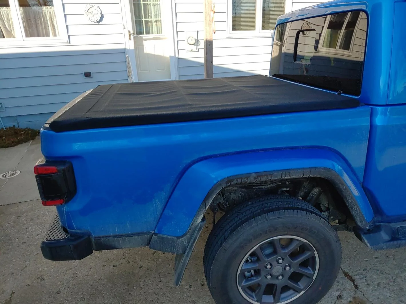

My dealer service department says, basically, "live with it - they all do that". Of course the same dealer said, "Jeep is wrong, the stick shift costs more than the auto transmission" and ordered my JT with the unwanted $600 bed coating option which I had to pay (sounds like the impeachment hearings don't it?) I'm way out here in West Texas and I went along for convenience so probably shouldn't complain.
180
29,578
35,175
I just got back from a dealer who offered to "take a look" - 20 minutes later, their bottom line was "can't adjust it, and look out there, that one does it, too" and it was sagging in the middle too.
I explained to them that people here have posted photos of the factory covers that don't sag badly and pool water and so on - but they said naw, wait till the weather turns, theirs will do this too.
They said there is no recall, no service bulletin and they have others on the lot like this so "live with it". I mentioned the others again that fit right and snug and they acted like they didn't believe me.
So, unless @JeepCares has any ideas, I'm stuck with a loose cover that sags quite a bit between the bars and with winter weather, rain, freezing rain and snow - a heck of a load on that cover, pulling it in and down even more.
This is just plain wrong for a brand new cover - in a year or two it will be even worse from the inch or so of water that sits on it.
It looked even worse than this pic when I pulled it into their bay this AM because of the water and ice on it.
What happens is that the weight of the water and ice pulls it down, not just fore and aft, but the sides get pulled in, too, then the sides won't lay down flat on the bed and it won't seal.
