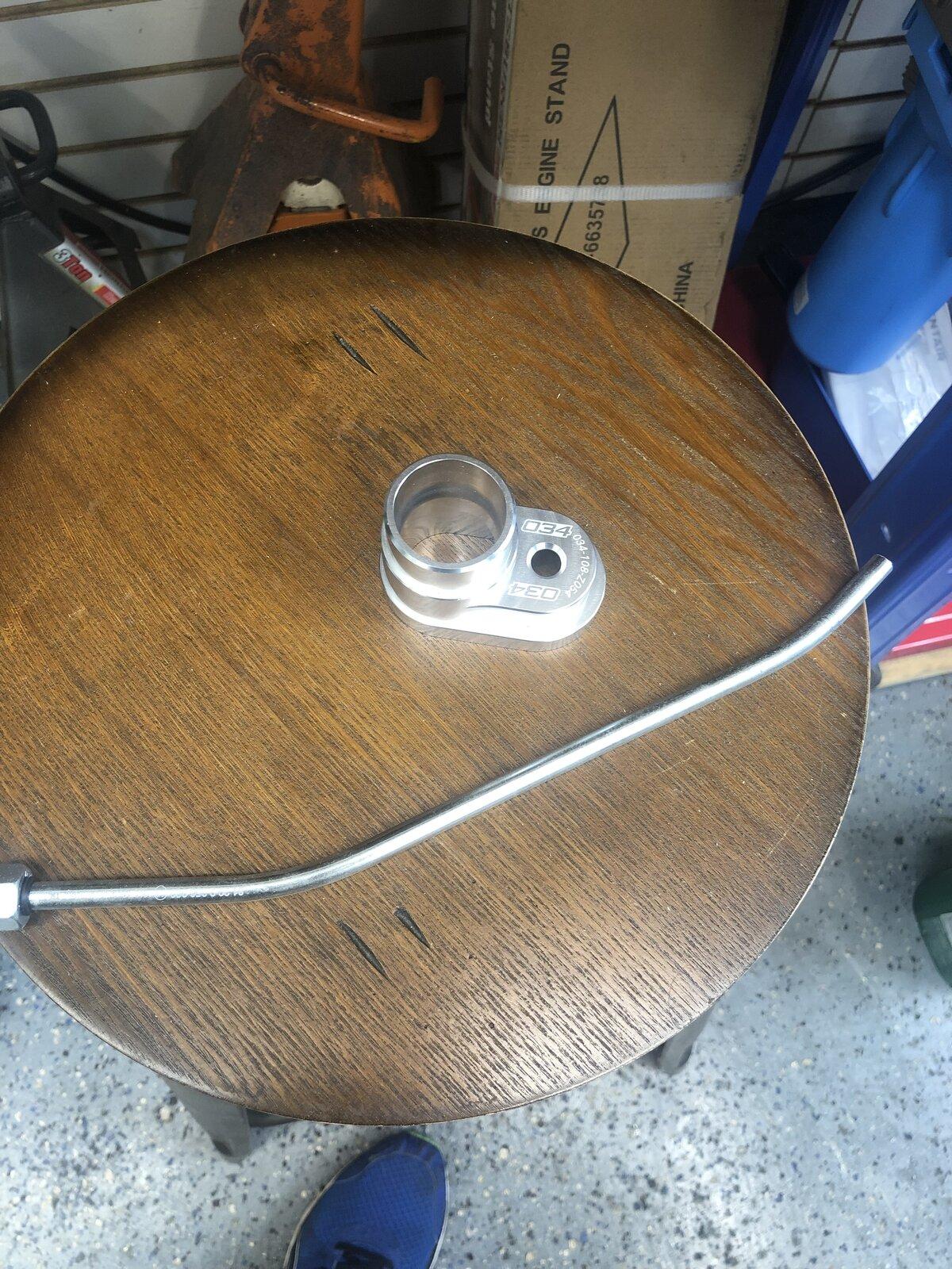

I used a harbor freight sandblasted and a bmw wand tool to blast the valves on our GTI. It worked great but I’ll have walnut shells in my garage forever, and that’s with a shop van hook up to a custom machined tool for it.

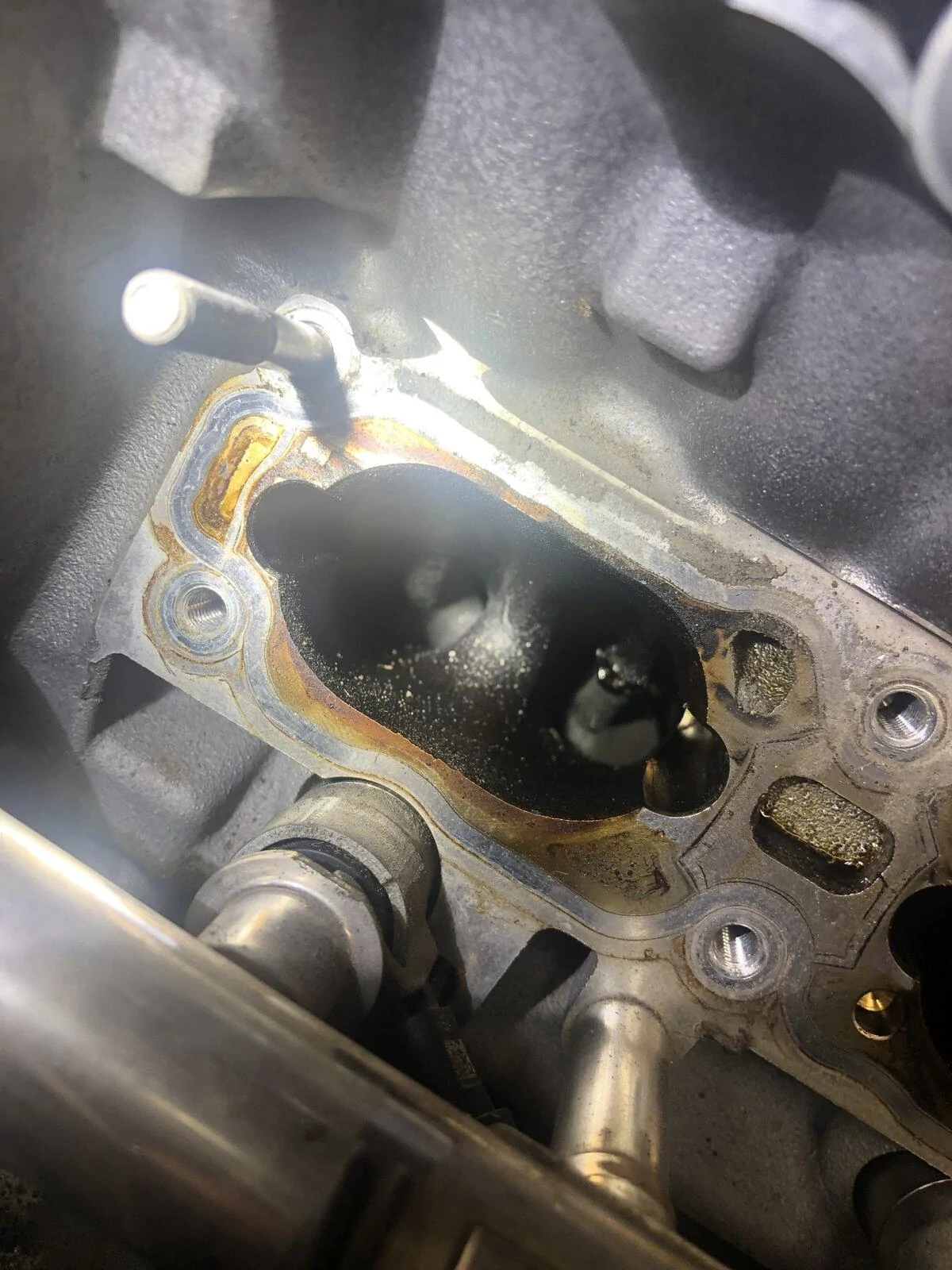

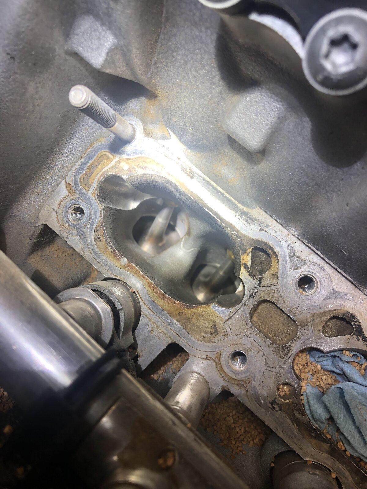

Before , after, the tools and my arm after it got blasted when the cheap sandblasted clogged up and back feed out the air inlet after disconnecting the sloppy air hose
You did that while the motor was assembled and in the car??? Not sure I’d perform that process for some soot cleanup… Reminds me of the old days of YouTube where someone suggested pouring sand in the intake of a running car to clean the intake (or was it to port/polish???) … anyways that didn’t work well, haha

Yeah in the car with the intake off, turn over motor till both valves were closed. Cleaned that port with the other blocked off and then moved to the next. This is commonly done and the wand tool I used is a factory BMW tool. Their tech do this service all the time as well as many others.
