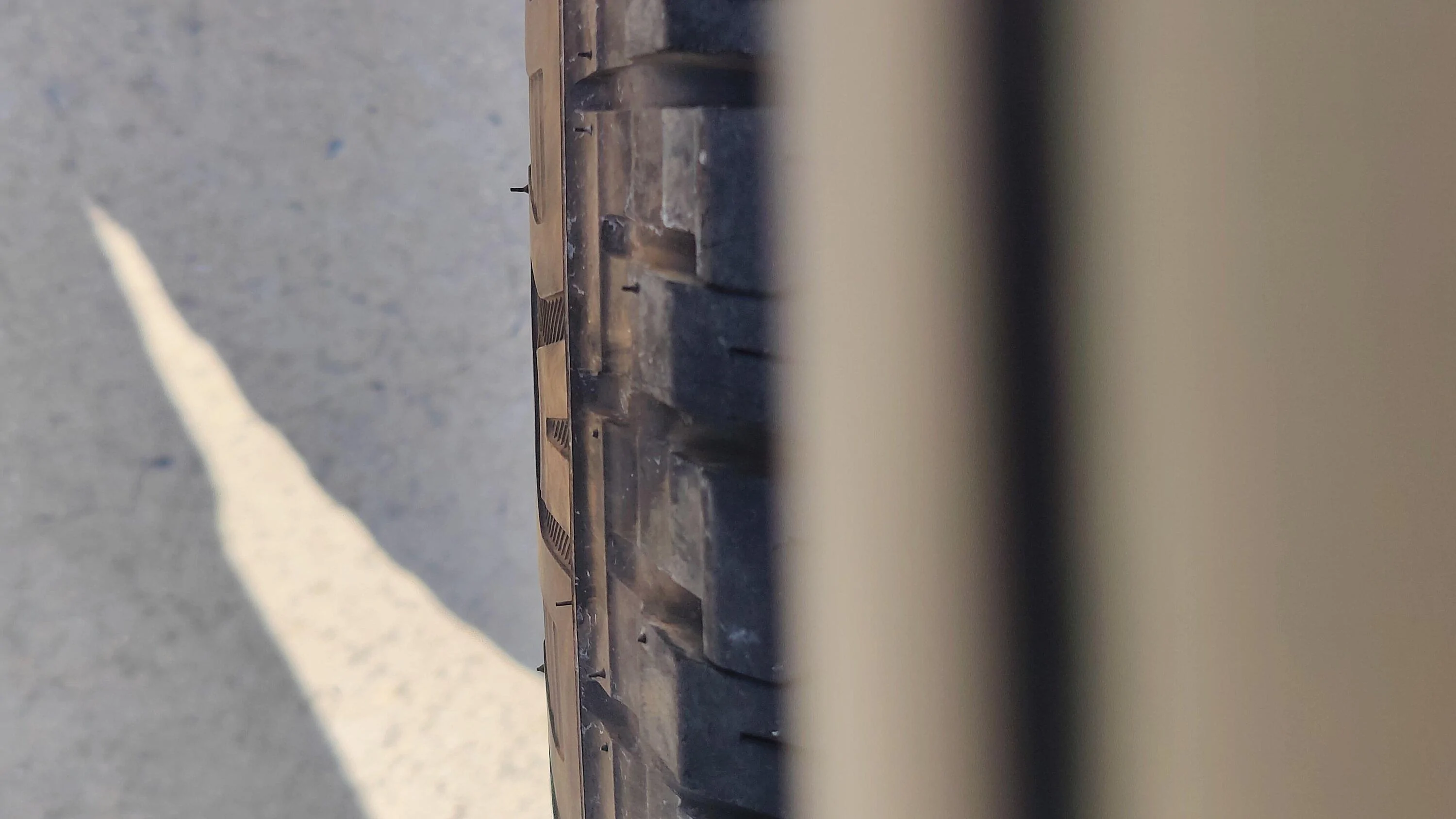

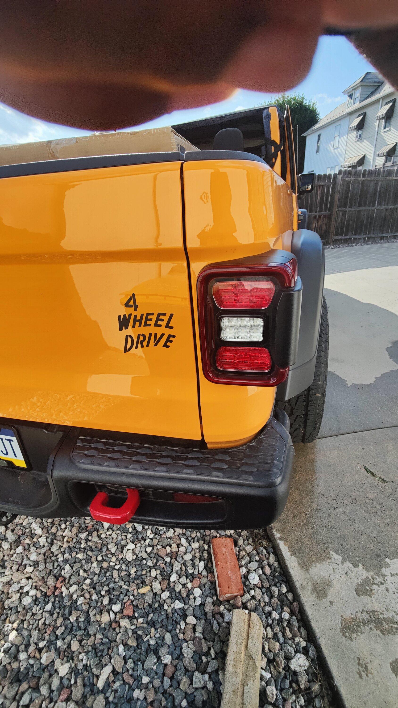

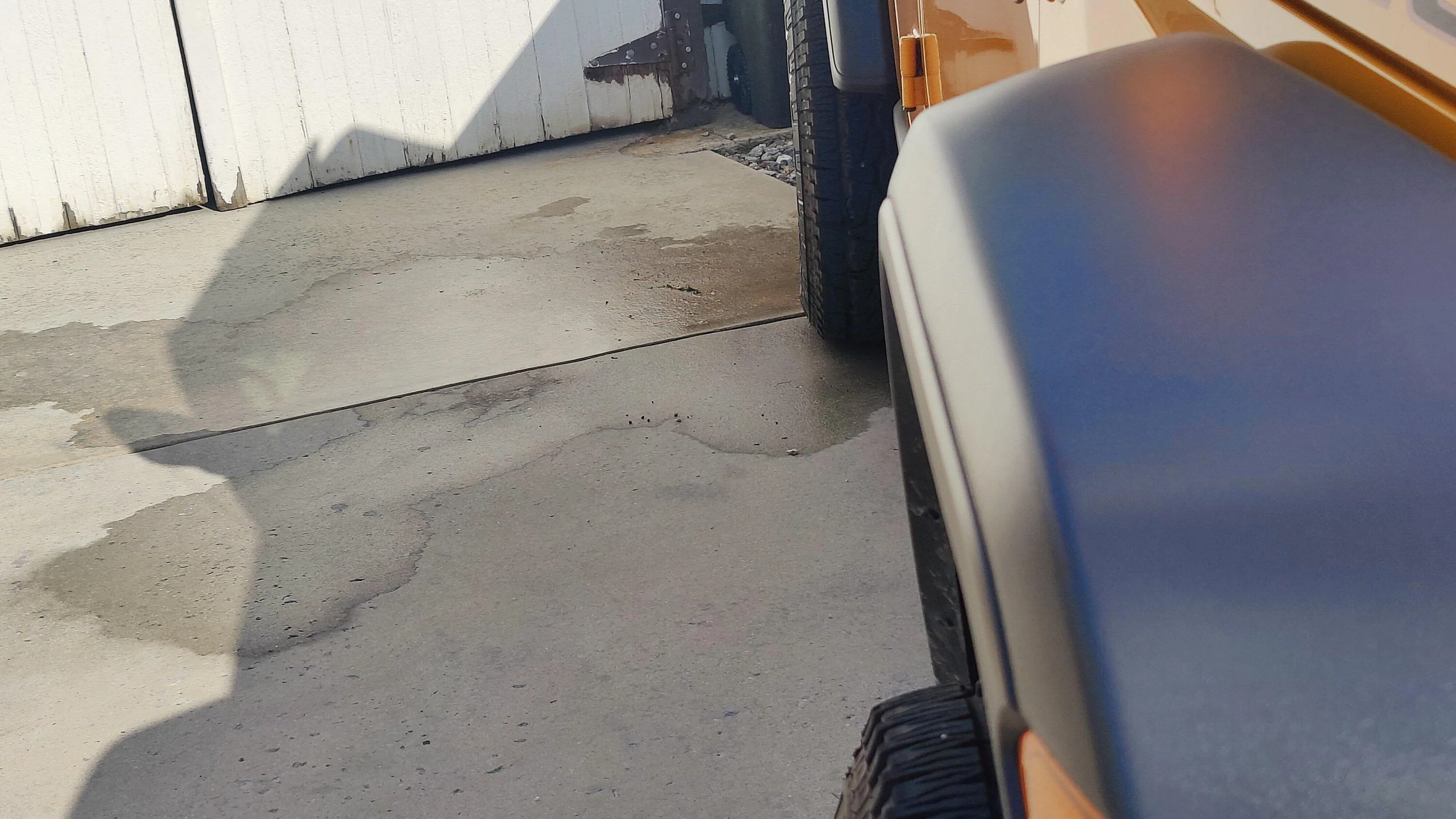

Here is 0 offset. -12 will stick out about a half inch more. I gotta get mine covered up with flare extensions soon. It's throwing mud all over my jeep.
Jeep Gladiator Anyone do staggered rims? -12 back, +12 front IMG20220801173629
Jeep Gladiator Anyone do staggered rims? -12 back, +12 front IMG20220801173618
Jeep Gladiator Anyone do staggered rims? -12 back, +12 front IMG20220801173703
Thanks for the pics! Oh yeah, I might have to throw some mud flaps in the cart. Good call
