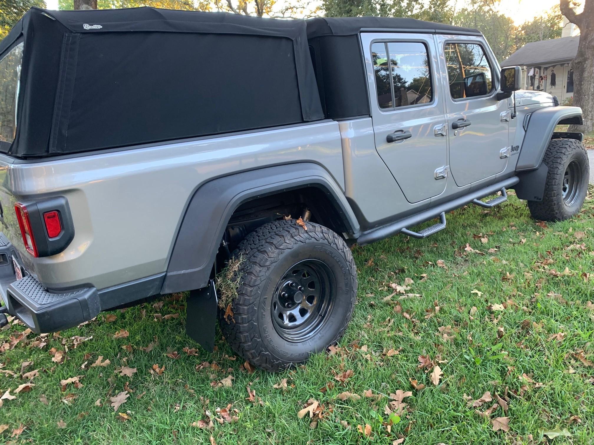

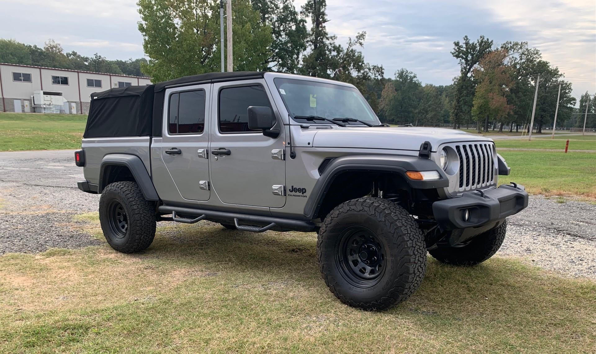

I see my truck's already been showed off here, but oh well.
I've installed the Twill topper twice now (had a thief cut through 3 layers of vinyl to get in my cab). my observations:
I love it, I love the look (specifically twill on twill). I love how it changes the proportions of the truck, and completely changes the appearance in a good way. It will make your tires and lift look little, though.
Regarding the panel fit and popping loose, you can slightly tighten the fit by moving the rails outboard 1/8" to 1/4" each. there's a limit to how much the corners will slide around in their mounts.
The biggest issue I've had, is the side panels are too LONG. the whole thing seems to be designed to pre-stress the frame and fabric to stay strong on the interstate (pushing back).
In both instances, I addressed the long side panels and corresponding mid-panel pucker, as well as side panels popping loose, by slotting the forward corners and moving them toward the cab about 1/4". this keeps the side panels flat and tight.
In my experience, its a few notches better than "better than nothing". its not bone dry, but we can now carry luggage in Rubbermaids in the bed, in a rainstorm, on road trips. I can carry strollers and groceries without things walking off in the parking lot.
I never imagined being a campershell and mudflaps kinda guy, but here we are.

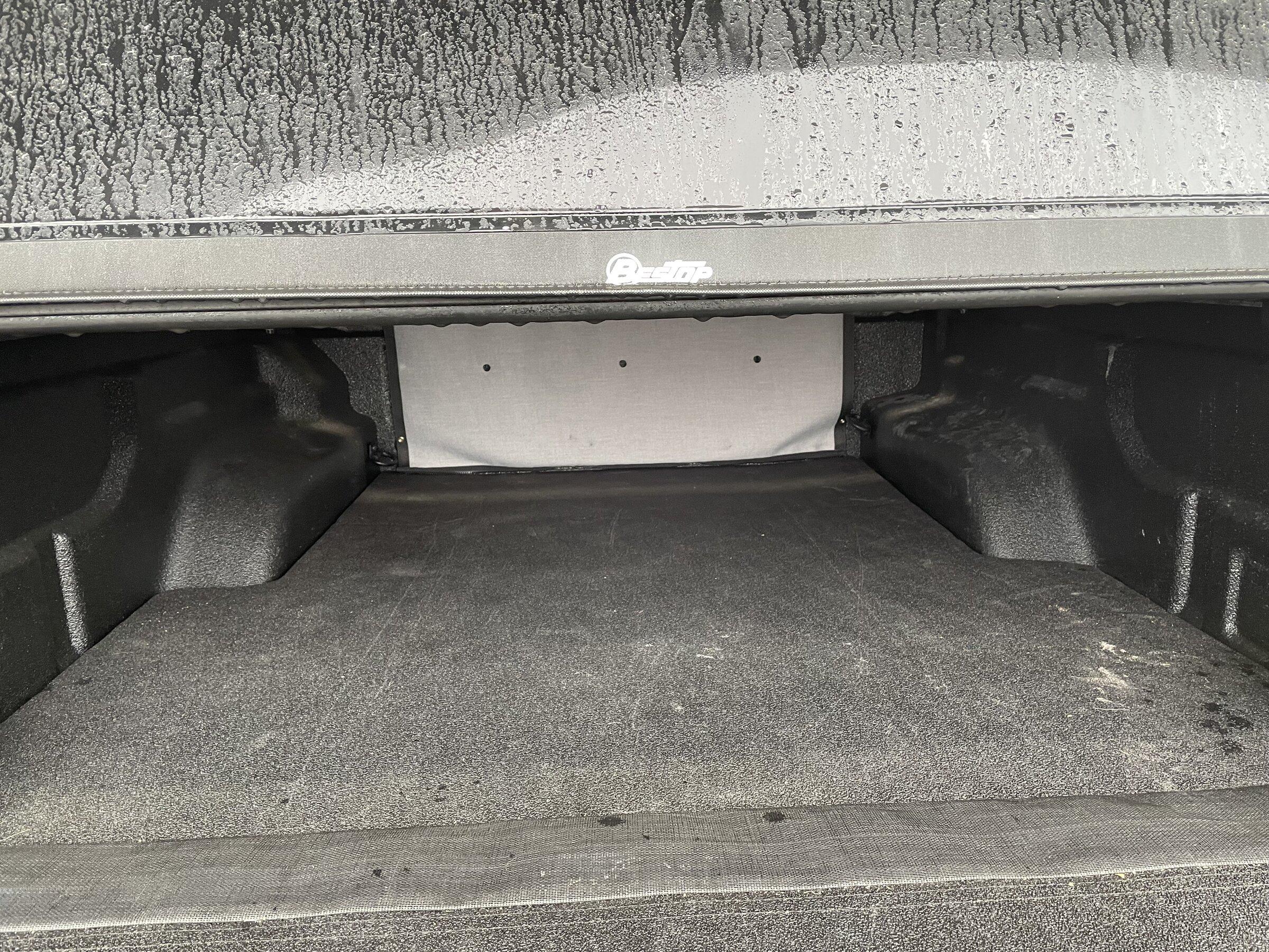

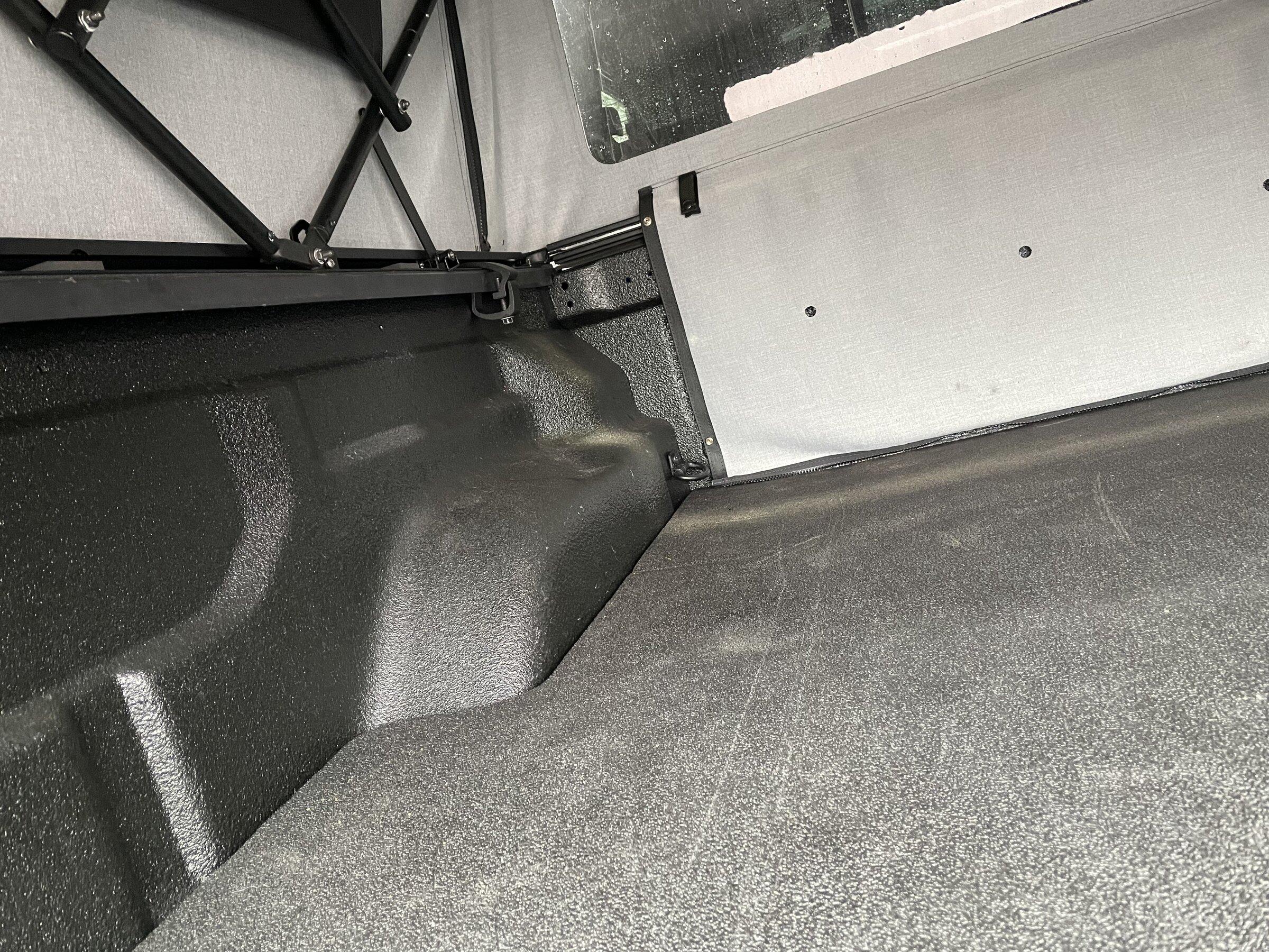

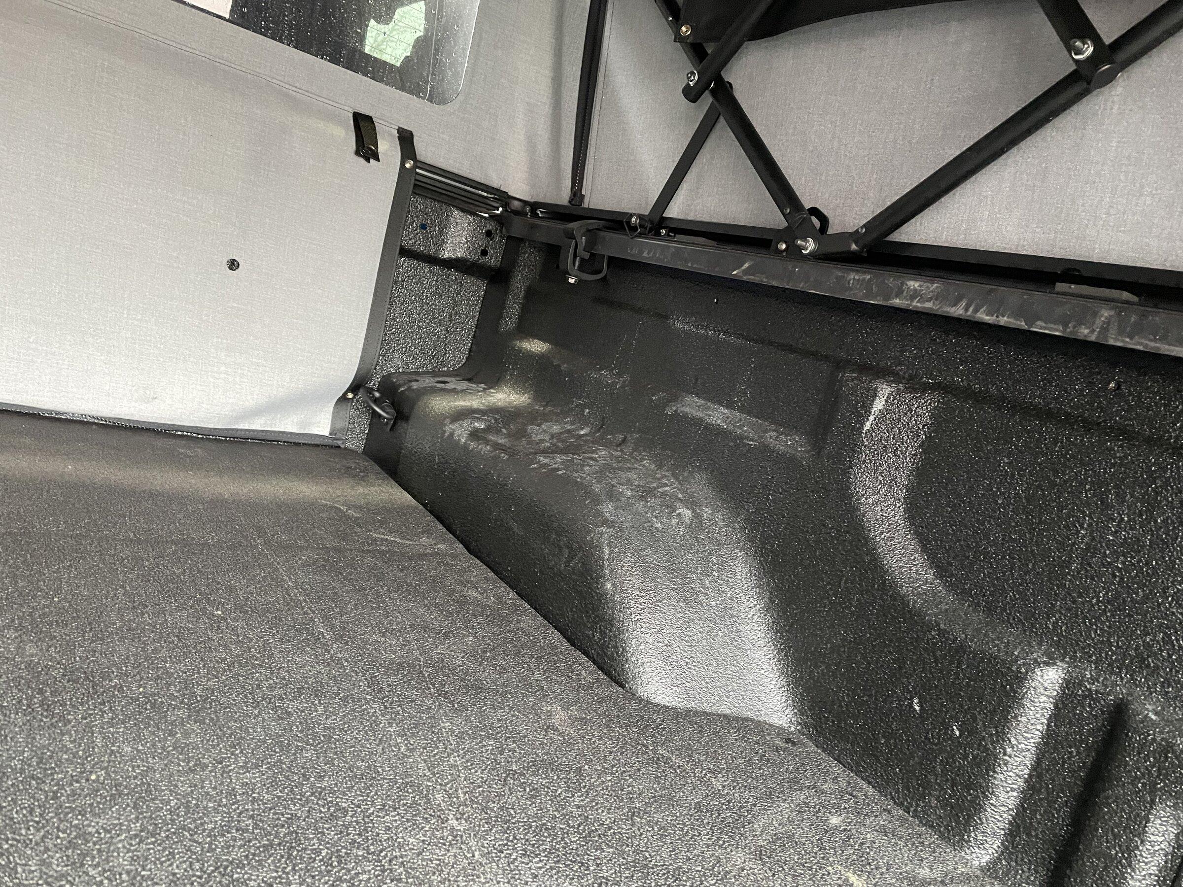

just wanted to update everyone my Bestop Super Top. It rained today and I wanted to show how much water comes in the bed… The few drops in the middle of the gate are from me opening the gate. The cluster on the right was there from the rain. Then the drop on the right side of the pic near the front of the Jeep was there too. No it’s not 100 percent waterproof. Here is the you pics:
BigKillaTDogg
Todd
Sep 26, 2021
72
54
Salt Lake City, UTAH
2021 Gladiator Rubicon Blue
Sales
I just wanted to update everyone my Bestop Super Top. It rained today and I wanted to show how much water comes in the bed… The few drops in the middle of the gate are from me opening the gate. The cluster on the right was there from the rain. Then the drop on the right side of the pic near the front of the Jeep was there too. No it’s not 100 percent waterproof. Here is the you pics:

Thanks for the update and pics!
