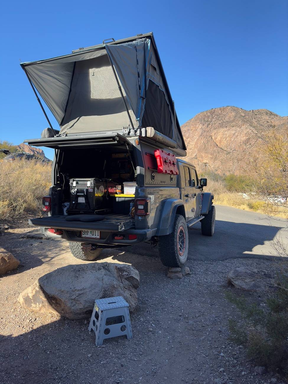

I have the Dirtbox Overland Canopy Camper on my Mojave.
I like most everything about it except for one major issue: the rear hatch/tailgate system.
I am not able to shut both the rear hatch and tailgate without locking ourselves in and no way to open the tailgate or rear hatch from inside the canopy camper.
  • On our last night of camping, we experienced very cold, windy temperatures and dry snow. I needed to close both during that situation and was not able to completely shut both without improvising a bungee cord rig to hold the back hatch mostly closed.
My question is, When you close both the tailgate and rear hatch while inside the canopy camper, how are you able to open them to get out?
The inability to do this is a severe limitation.

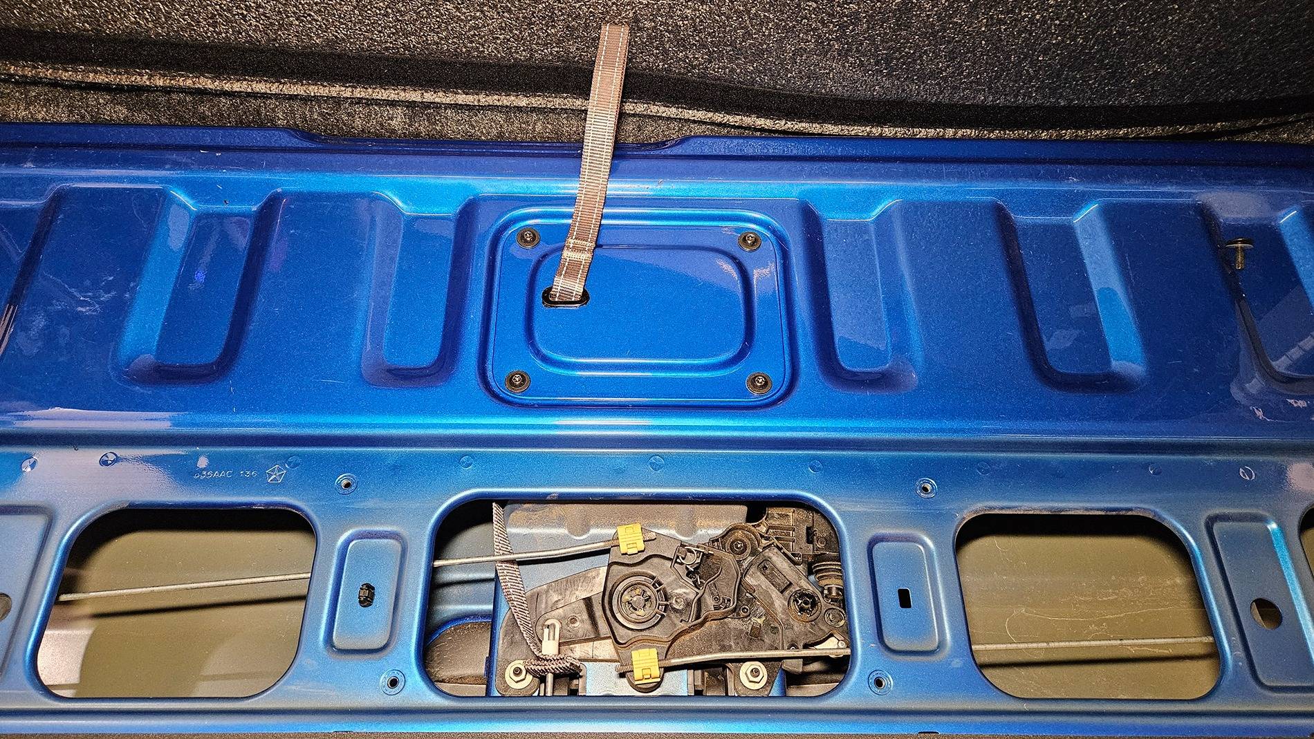

Jay Couch is the owner. It's odd that they aren't getting back to you, they seem like a customer oriented outfit.
Jul 24, 2023
Dahlonega, GA, USA
2023 Jeep Gladiator Mojave
I've got the same setup and I ended up buying a polyester leash, cut it to length, added a grommet with some stainless washers, and drilled that access plate to add an internal release. I've used it daily on a few multi-month trips and it's held up well.
I sit on the back of my tailgate at camp and there's a bedrug over the tailgate so you don't even notice the strap there since it lays completely flat.
